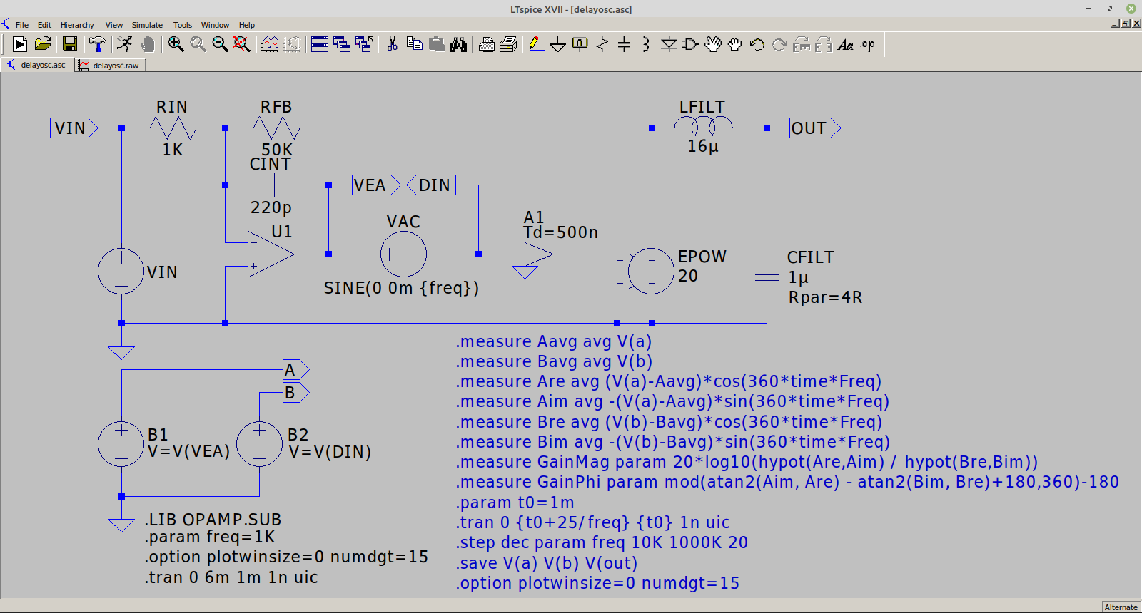

Yup. Sorry 10K to 1000K at 20 points per decade would be 41 steps. It does speed up as the numbers rise but you might try setting the minimum step size to a higher value,
.tran 0 {t0+25/freq} {t0} 10n uic -> .tran 0 {t0+25/freq} {t0} 100n uic
note that the t0 + 25/freq gives the number of cycles [25] each analysis runs for so 10KHz will take 1mS + 25*0.1mS times how fast your computer is and that time will go down as the analysis progresses.
Also try looking at V(out) whilst its running. The perturbation is only 100mV and the loop will act to try to keep the output at zero. For a self oscillating design that will mean that the circuit is operating at its highest frequency.
If you want to see the behaviour at higher outputs you will probably have to trick things by applying a DC input to the error amplifier to bias the output closer to the power rails.
Oh, and as you suggest simpler models may help but why not go cook a meal?

The idea is that the 100mV disturbs the loop but does not overdrive it. Again the loop will try to keep the output at zero so if you want to see the low frequency switching and gain in a self oscillating amplifier you will have to drive its output up with another DC source at the input to the error amplifier. It looks like your loop has gone unstable in the case of the red plot. You should really just be plotting the direct traces for a and b and possibly the output whilst the analysis is running in order to see how things are going. It may also be worth checking the nature of the waveforms at the point you use for injection. Ideally you want it to be as quiet as possible. Perhaps you can post a model for me to poke about with?

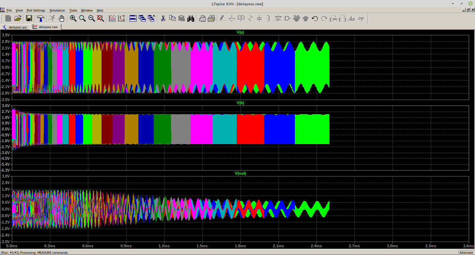

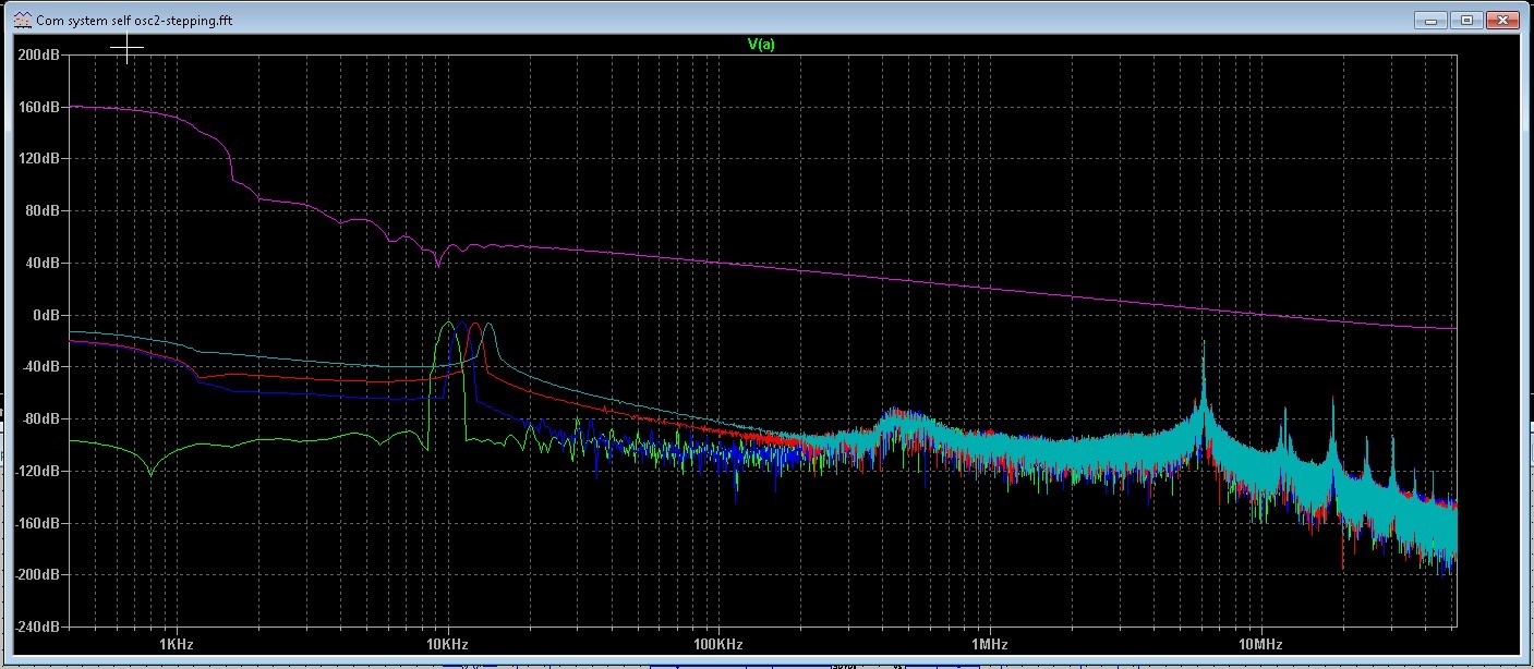

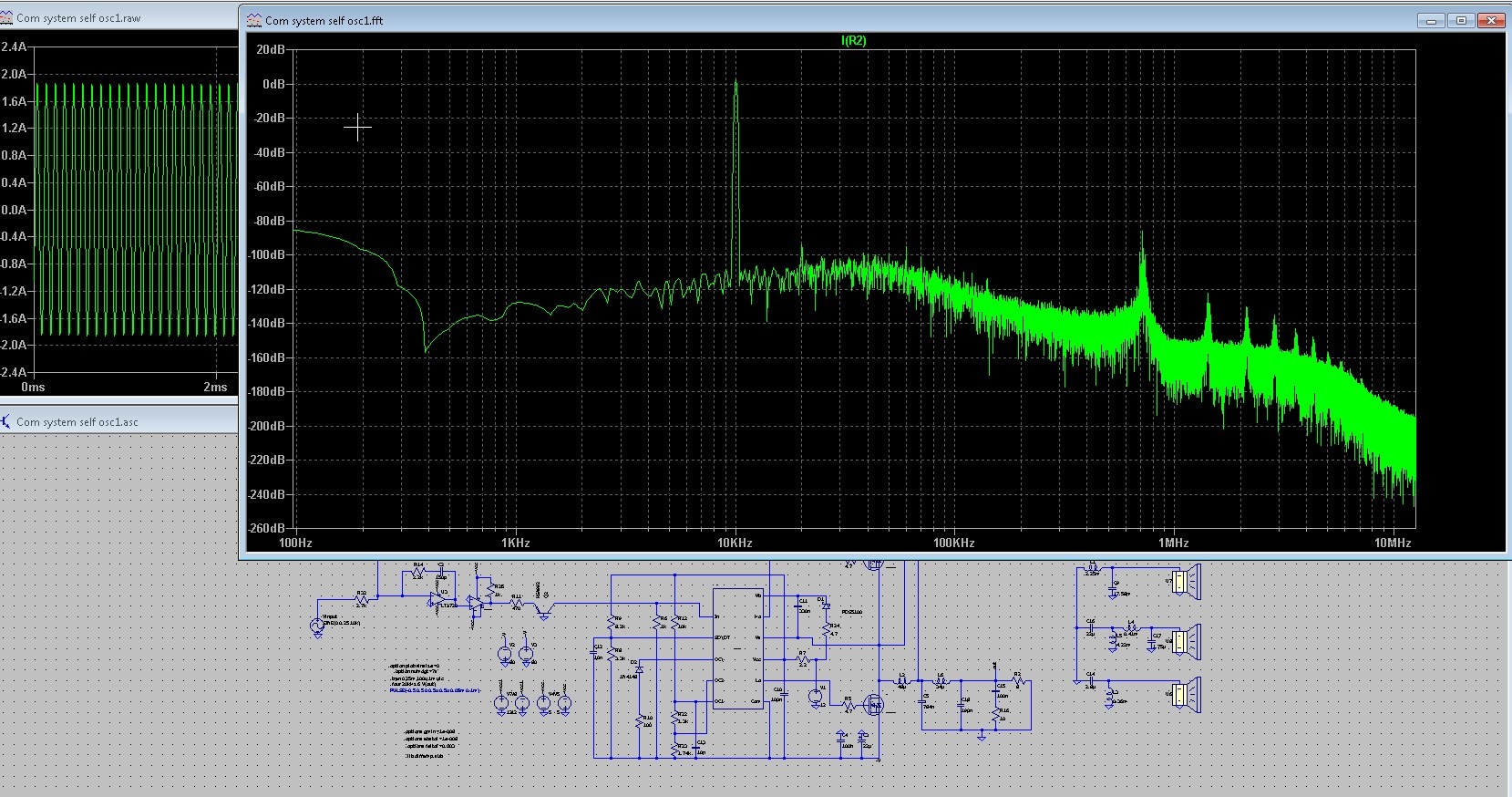

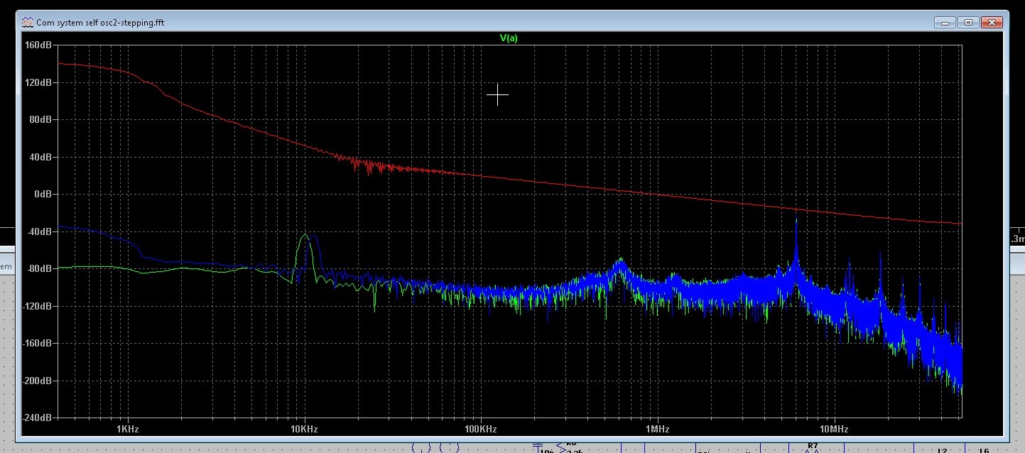

I did get now this when do longer sim.
For clearity, the purple line above 0 dB is because I did let it not run out, this line I get when I
am able to see the plot, all below are compleet runned, that is why you see it like this.
We have need for better sims and class D design tools. because of in time errors of these amplifiers.
OK, understood about the incomplete run. I'll have a look at your models tomorrow but all I might have is a faster processor. Time for bed!

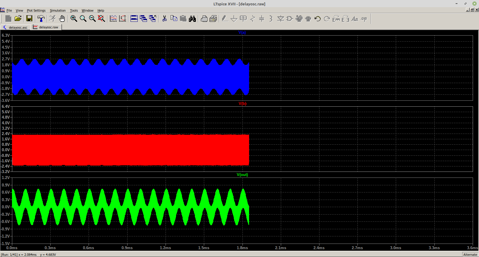

Update,
The 7 Mhz carrier looks like a second oscillation on a very high frequency, this can happen when feedback is somewhere cause a second fase where this happens, so somewhere higher it rises again above unity and hits a oscillation point. caused by the zero/pole integrator, I did put a zero into postfeedback to correct, put osc frequency also some lower, now i have speed I can say.. Also do restrict frequencions measured to two full cycles only, who seems to be enough, (I think).
This sim is quite usefull. I did see things I did not see first.

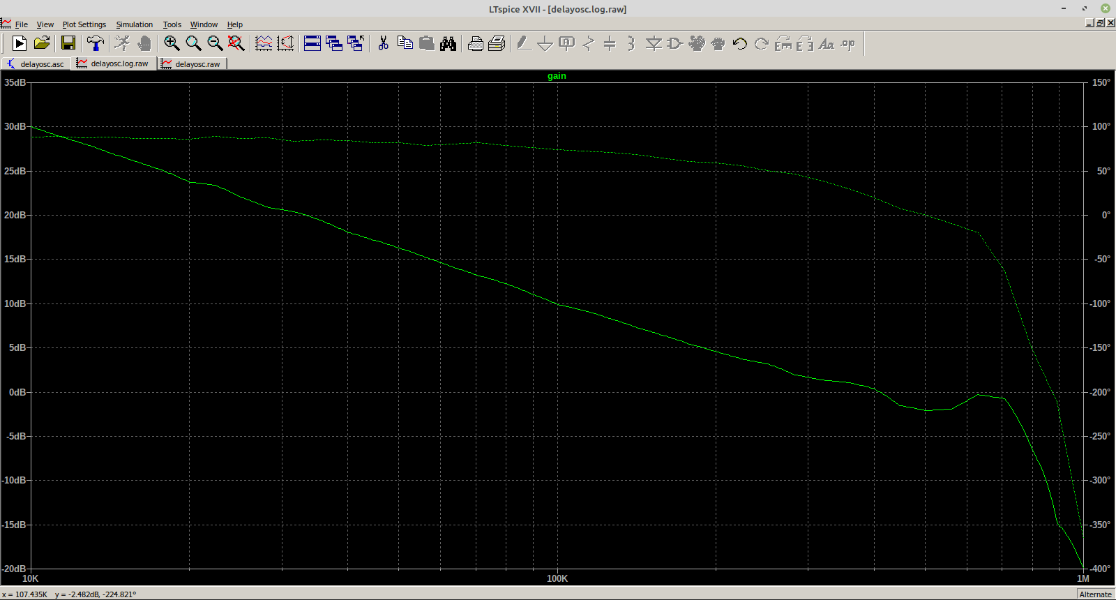

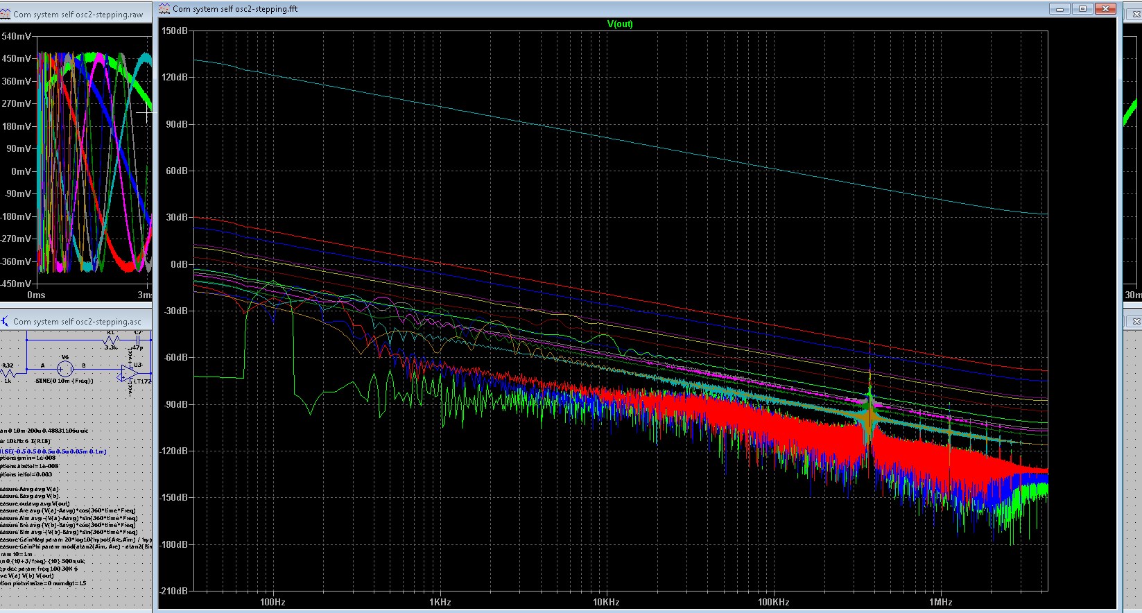

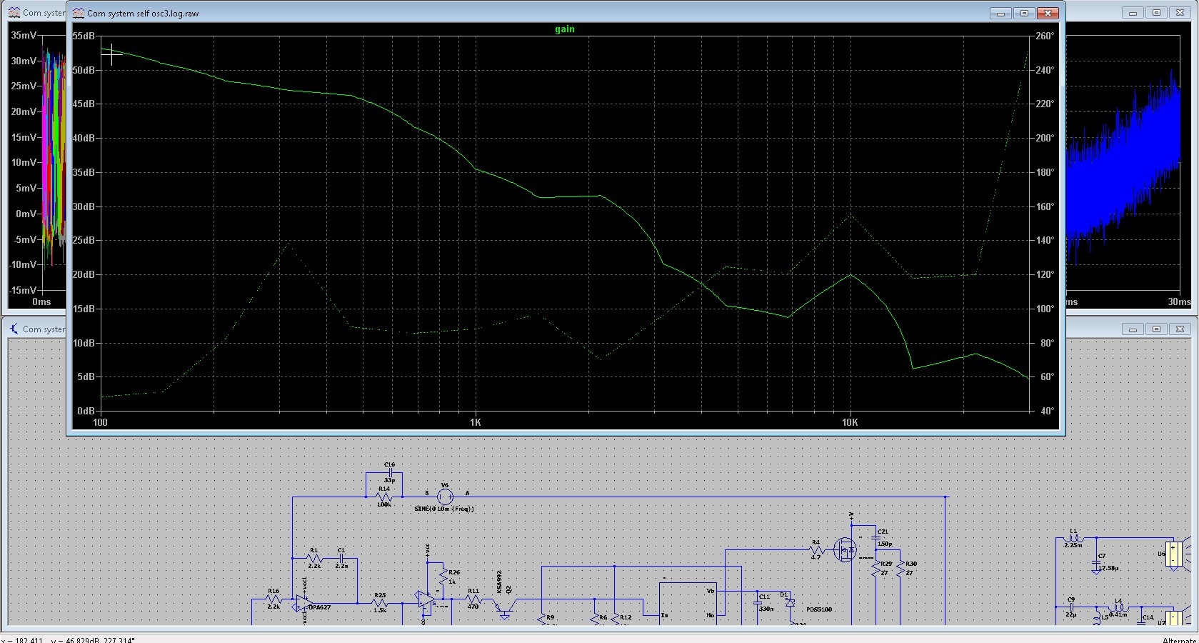

I have simplify the frequency's to test, now from 100 Hz to 30Khz.
here is the result I did see, after correct schematic to get no 7 Mhz oscillation happened, only the fundamental.
I see that gain is 62 dB and phase stays in save area if I read well, but fase is close to 180 degree, so need some more correction on lead circuit.

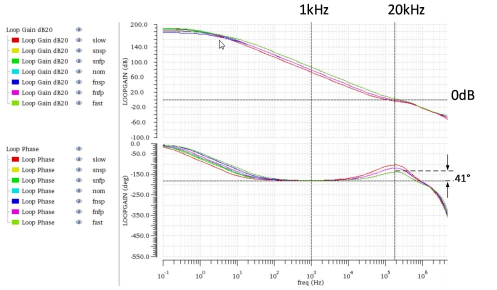

You're still driving it wrong. Go back and carefully read how Mike tells you how to do the analysis. Another version of the words is here,
https://www.analog.com/en/technical...-steps-in-generating-a-bode-plot-of-smps.html
You have to run the analysis to completion and collect as many points of data as you can. That means you have to be patient, not make up your own version and then look at the wrong thing.
Once the analysis is complete right click on the plot, select view, select view spice error log. Then in that text window right click, select plot stepped data and say yes to complex data. You will get another plot window. Click add traces, click gain. The bode plot of loop gain will be plotted.
Don't blabber on about the method as given only applying to buck convertors because buck convertors are used in the examples. It is generally applicable to any switching supply including a Class D amplifier.

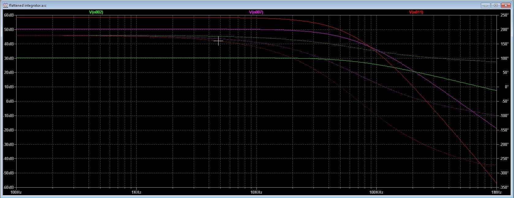

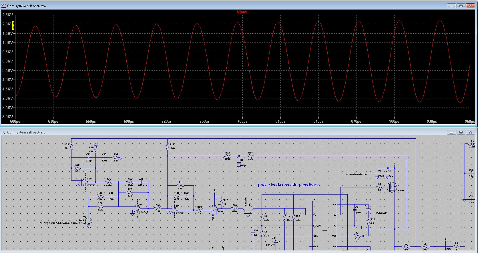

I did change some to look at what happens.
I have here also a open loop plot of a cascaded feedback branche. This go very fast.
but it has no complete feedback to see how stable it is.
On pic this is a cascaded feedback, I can see the open loop easely here above 50dB

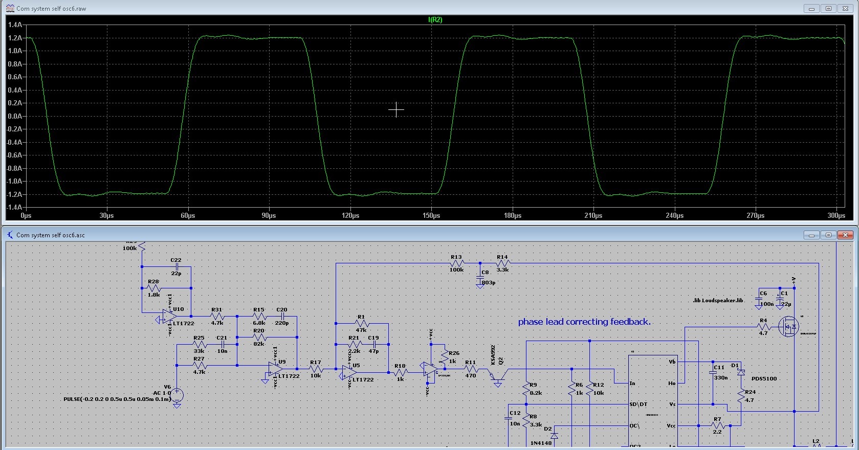

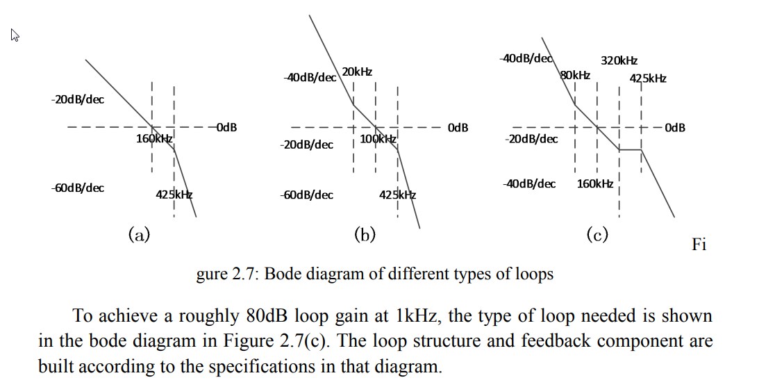

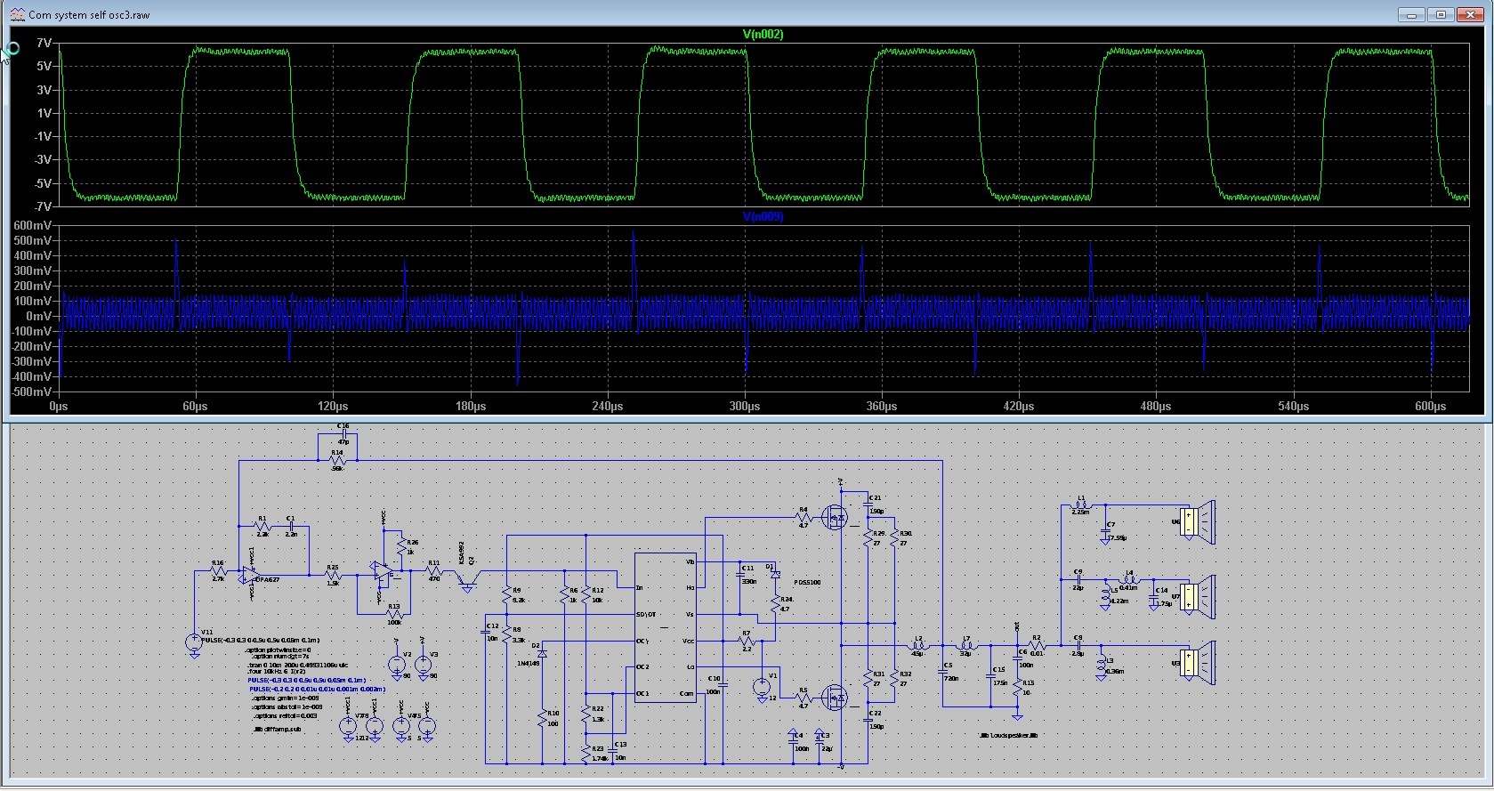

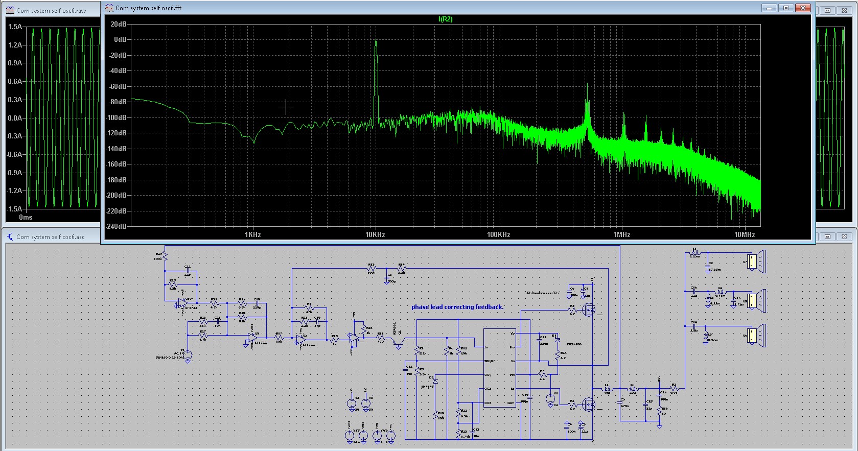

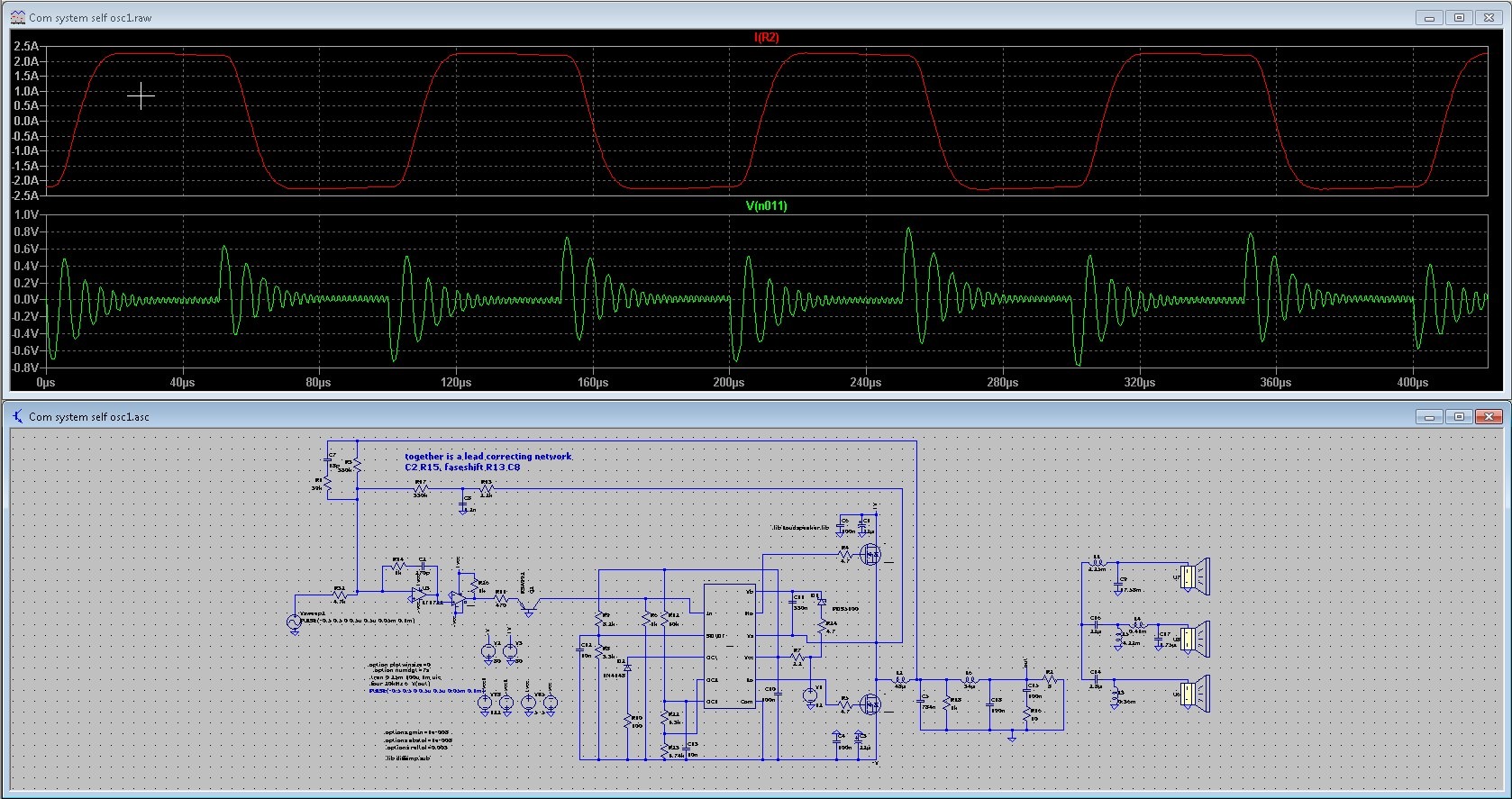

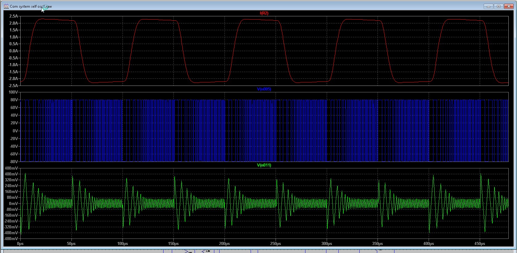

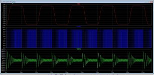

This outcomes I did not with that simulation model but with calculation and
square testing. I have stable system, even with open output and connected three way
speaker system in sim. The error correction response does well on pic 1, fast rise times as you
see triangle form error signal. Pic 2 I have
slow down the error correction response on the low pass filter getting slower rise times so you see
more sinusoidal error signal. Testing is on 10 Khz.
Pic 3 is sim distortions, on 10 Khz it gets to -100dB it can even better, but then stability
gets bad.
Compromises are really an important part of these designs, more, much more then with analog
circuits.

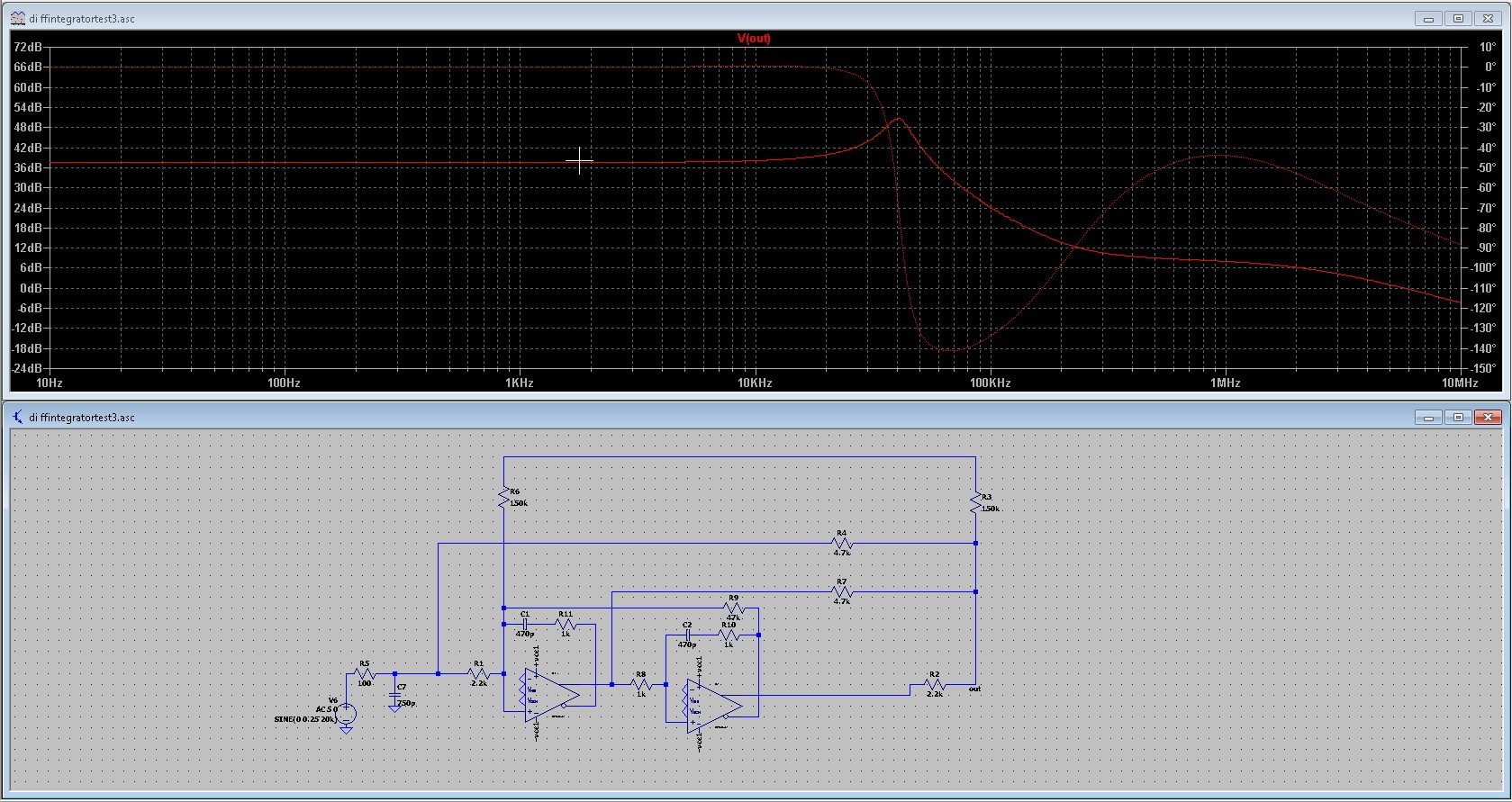

Here I have a version with only prepost feedback, have it very stable, even with open
output or connected inductive/capacitive load the square keeps very nice.
Now I can set the voltage source and a and b on the right spot to see what happens.

I have don this, now I can see that the gain go like it needs to do.
Start with 54dB and go to zero at unity.
Did use less frequency's as a fast test, I do restore original and do all tomorrow to see.
But as I thought, with a square test I can optimize also, I did proof, because it was stable
and low hd. But it is usefull I think.
thanks.
I see you finally got there so the following is probably superfluous.
It's self oscillating based purely on a delay in the buffer, A1.
I've lifted out A and B as separate behavioural sources which let you change VIN and VAC as appropriate to plot loop (VEA/DIN) and closed loop (OUT/VIN) gains.
This is the first run, of 41, for loop gain.
Note that V(a) has the perturbation imprinted on it. The loop acts to reduce this, at V(b), to zero.
After the analysis is completed.
You can see V(b) rising as the loop runs out of steam at higher frequencies.
Right Click. View, Spice Error Log, Right Click, Plot Stepped Data and say yes to complex. Right Click, Add Traces, Choose Gain.
The Loop Gain. Basically a first order 20dB/Decade roll off with 90 degrees phase shift due to CINT around the error amplifier.
As you suggest you have to suck it and see then make some choices as to how the analysis should be run. Particularly the minimum step time and number of points per decade and also how large you make the disturbance. Also where you locate the disturbing source. If you make things too relaxed then you will end up with noisy plots and this is likely to happen anyway by virtue of the nature of the systems you are analysing.
Again I am not really qualified to comment but if you produce an exclusively linear model of your loop and perform the analysis in the same way you will get a bode plot but the amplitudes will be scaled incorrectly because you have not included the modulator gain in the system. That arises from the comparison of the low frequency audio signal to the, attenuated, ripple signal at the switching frequency at the input to your comparator.
We have in class D some more needed to get the bandwidth right, so the feedback system is more complicated.
