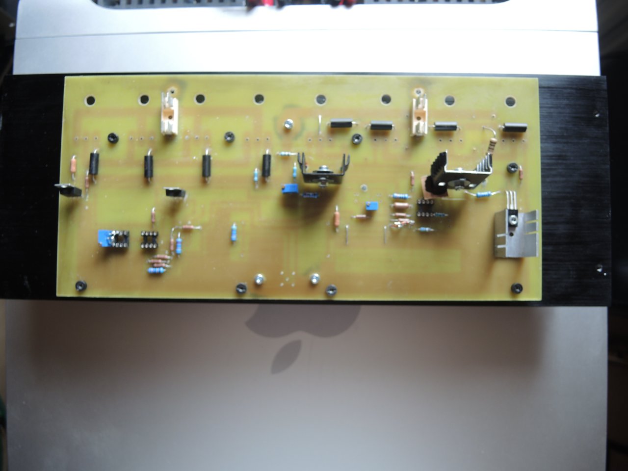

No, all I wanted is just to speed up the process of tapping this 20 holes /per heat sink.If you really want to get heavy into power tapping you could look into a tapping head like a Tapmatic self reversing, but they aren’t a cheap solution!
And these tabs hold more than I need.

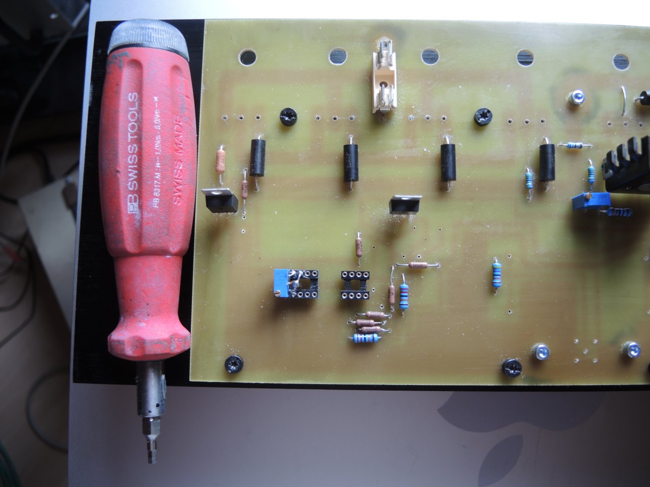

The Transistor bolts will be fastened with 2.0 Nm (nano meter)..using a Torque wrench (some kind of a screwdriver with a release clutch) when torque has been reached. So all Transistors are screwed down with the same torque, assuring heat transfer from transistor to heat sink to be the same for all. I think for any Multi Transistor Amplifier on the output it's very important that these are all fitted with the same torque or force, but especially for Class A, as here current is never switched off.

BIG sorry pics aren't sharp enough and I'm in a hurry.. went to bed 3am and now it's 8:30 and should be on my way to work.. but this here has priority..
I hope the amp gives his first sound today.. board hasn't been assembled completely..

The Transistor bolts will be fastened with 2.0 Nm (nano meter)....
The max torque for the TO-3P, TO-247, TO-264, etc. is 0.8 N.m, according to OnSemi, Renesas, Sanken, Toshiba, etc..
This is barely more than finger tight.
Also of interest, as shown by the OnSemi paper: minimum thermal resistance is achieved at half the rated torque value.
If I use that torque, then switching on the amp would create a nice firework,,, And it would not wait for next years August 1st.
I read some of the ON SEMI but it's quite misleading as they use KGF instead of Nm..
Anyway the tool I use, is adjustable 0. - 5 Nano meter.. for the bolts I use, I adjust it to 2.0 max 2.2 depends where the aluminum heat sink comes from.. and who made the TABS..
