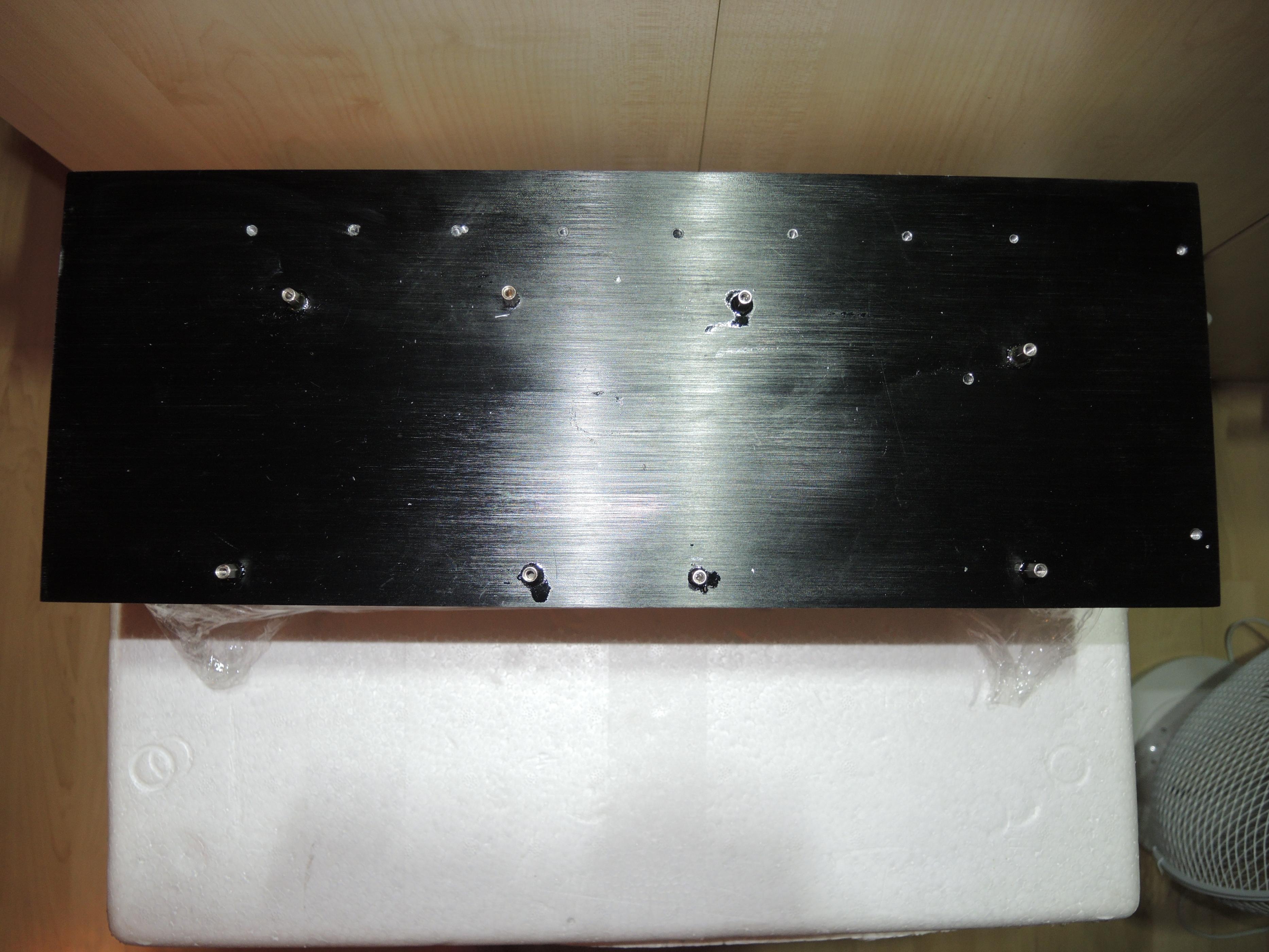

Now it happens that these day I need again tread some aluminium heatsink to hold 8 - T0264 Transistors, and also a large PCB with the size of 300x140 mm with a lot of component soldered to it.. So there are 8 Transistors that means 8 holes 8 times threading, and then also the stands for to hold the PCB fitted to the heat sink another 8. this makes 16 holes have to be drilled and 16 holes have to be threaded.
Take for one on hole a minimum time of 2.5 minutes to drill and to thread,
* any mechanic knows that this will not be enough time. * so then we have
16 x 2.5 minutes = 40 minutes, now we have two sides, left and rigth, so time doubles.. Again that would be fast, but I think 5 minutes for ome hole is average, so two pieces would take up 2.6 hours or 160 minutes. A lot of time..

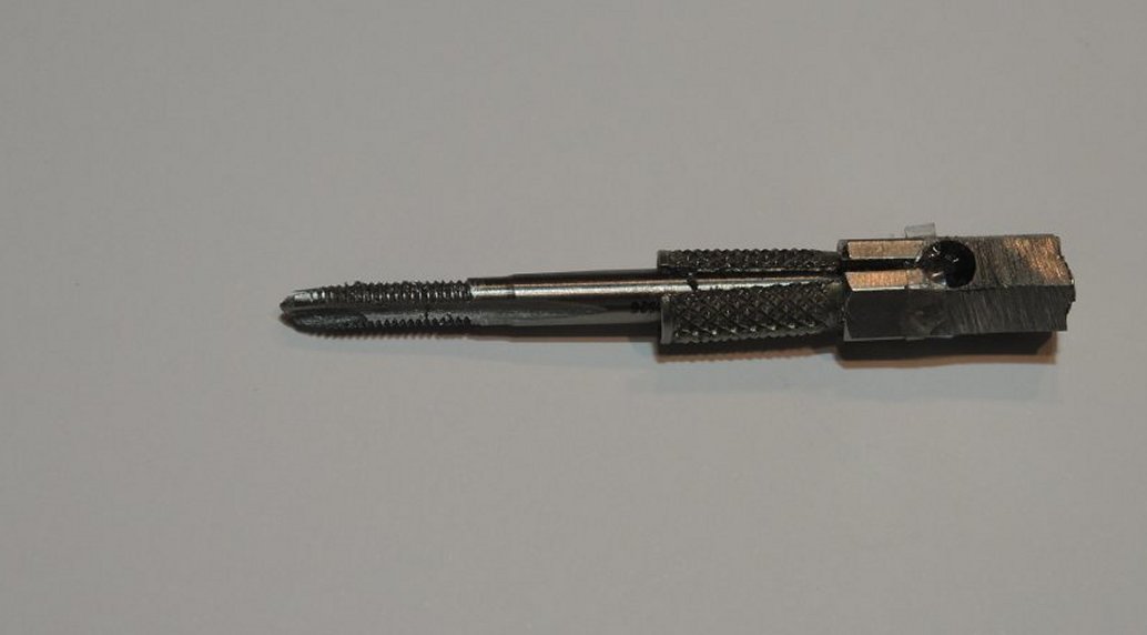

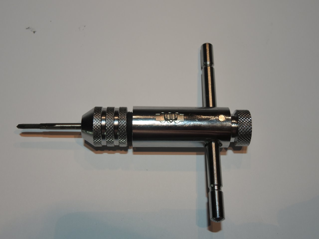

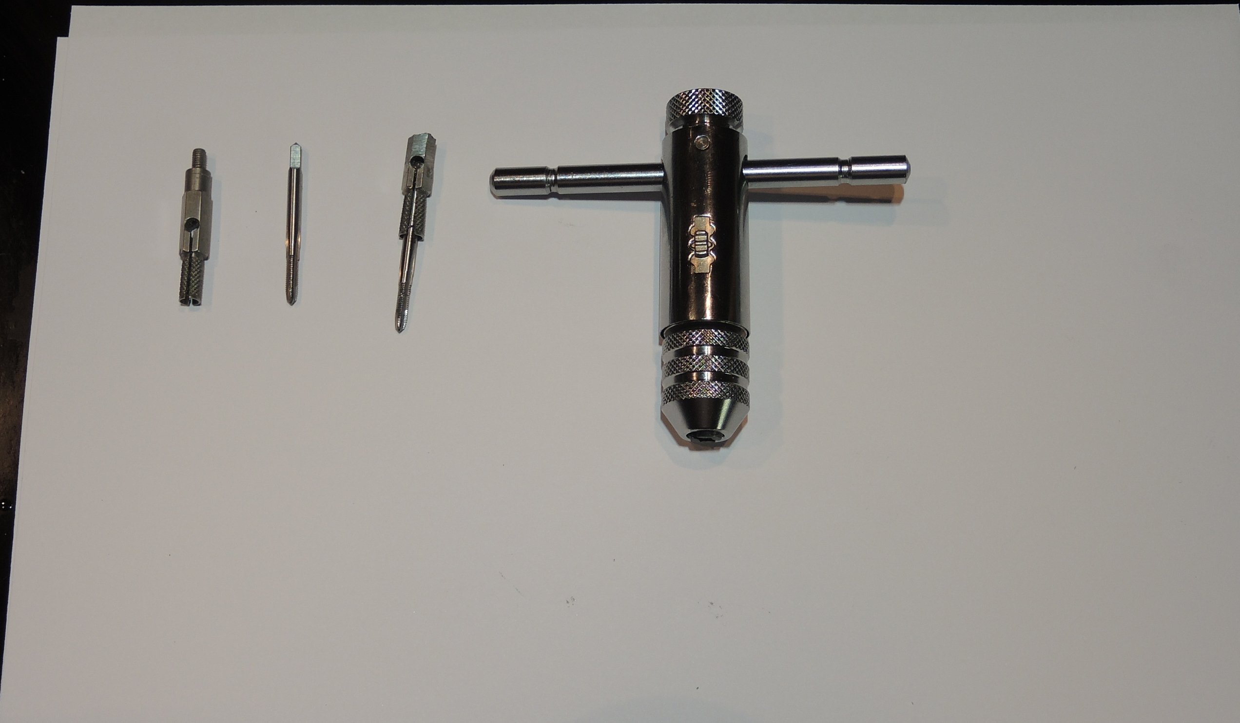

I made a VIDEO, just to show that this is real inexpensive and fast and can be done almost by everyone who has a hand for DIY..

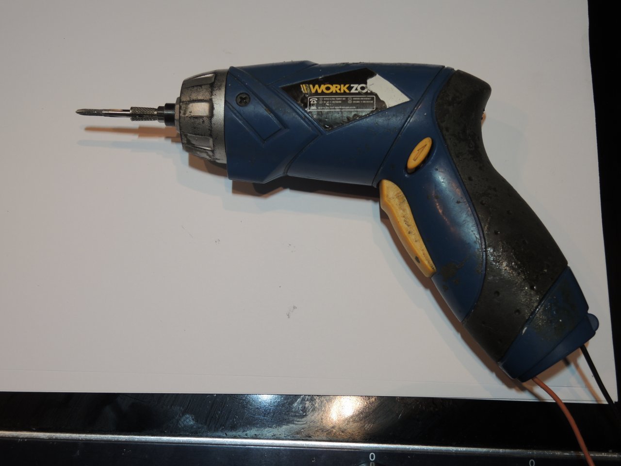

The Tool I use is this small hand drill, battery driven, to drill or to fix screws or bolts; I just modified and Steel bolt removed from MAC PRO to hold the Threadingdrill. Insert into the Hand drill and there we go.!
The rest you will understand if you look at the picture. Of course you will need some Cutting solution to drill holes or threading, but also this is inexpensive.. Lenox is the Brand Name I use, not to advertise this here, but it's rather cheap and good quality. This Heat sink time to drill and threading was less than 20 minutes. The thread are good to screw in aans out bolt at least a 100 times without losing the grip of the Bolt. So migth the one or other can make use of this.

I watched the video.
I'd be worried about breaking the tap for smaller size threads, like a 4-40 (which I guess is about a M3x .5 size.
I didn't have sound on, so not sure what size you were making. They looked like they would bigger then M3.
It does look much easier than hand tapping. I am used to tapping a little ways in, then backing out and cleaning, then doing some more.
Do the threads come out OK with this method?

Till now not one.. and I made already about with this at least over 100..You'll be breaking a lot of taps like that.
Do you think all the taps which are made in anything you buy, are made by hand.
Far away, hand made tabs are stone age..Sorry, but this is the truth..
May break the drill but shure not broken tabs..
Thanks anyway for the input..
If you do it by hand you can feel how much twisting pressure there is on the tap.
I know you can buy combination drill/taps for larger holes.
I guess it depends on hole size vs tap size.
A tight fit does need reversing, a loose fit not so much.
Trying to get a broken tap out of a heatsink is a pig of a job.
I use plenty of WD40 too.

I use this only for 3 -5 mm because the TABS ARE BETTER Than by hand..
There is no pressure needed. and if you look good then you see the drill going straight down.. less shaking than by hand, and about the time it's 10 to 1

That small battery driven Drill has a clutch, you can adjust to slip when to much force is in use.. this is about the same as the twisting by hand.If you do it by hand you can feel how much twisting pressure there is on the tap.
Again one more time for you, this Drill has forward and reverse, instant switchable. better that anyone can do by hand, because the operator need only to hold it straight that's allA tight fit does need reversing, a loose fit not so much.
These heat sink I tap here, the piece cost about 75 USD, I can assure you that I take real care not to have broken tabs in there..Trying to get a broken tap out of a heat sink is a pig of a job.

I think the reason the method shown works so well is that he is using a small battery powered drill, I would use a small portable screwdriver. I have a Black & Decker in mind, which is sort of weak. Again the reason it works **I think** is that this is not a power drill, its so weak that it provides just enough force to move the tap down and out of the hole without breaking the tap, especially if you get the clutch setting correct.
The question I have is how to do get the tap into the drill with a secure fit? Mine don't even fit the hand taps anymore?
