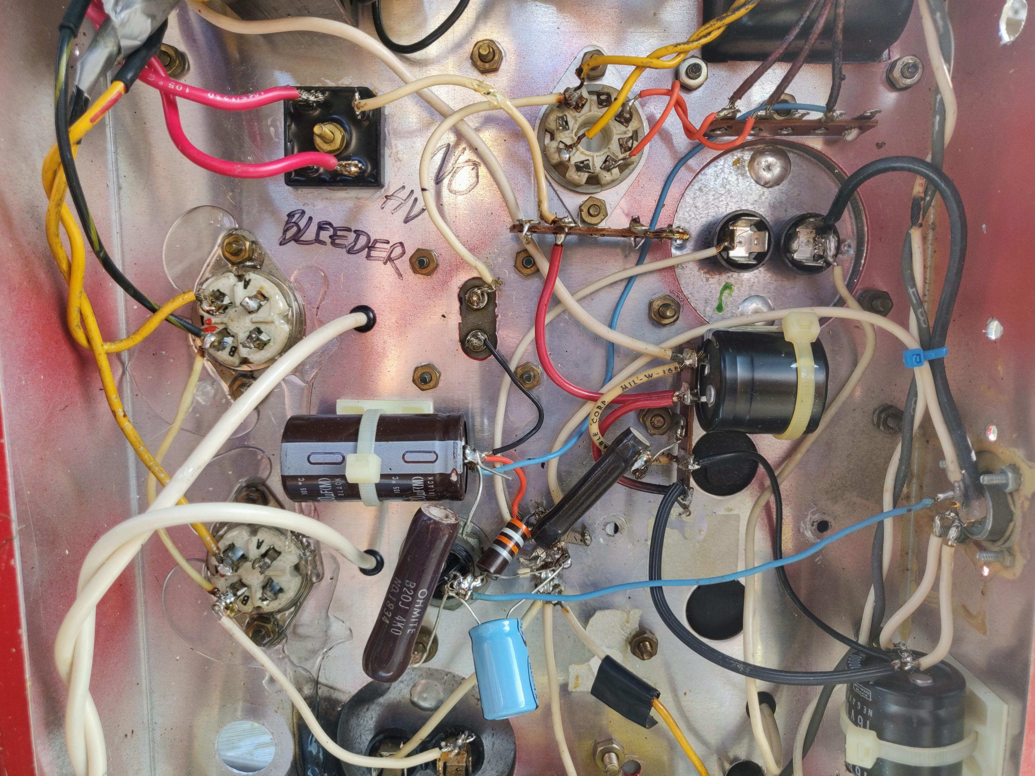

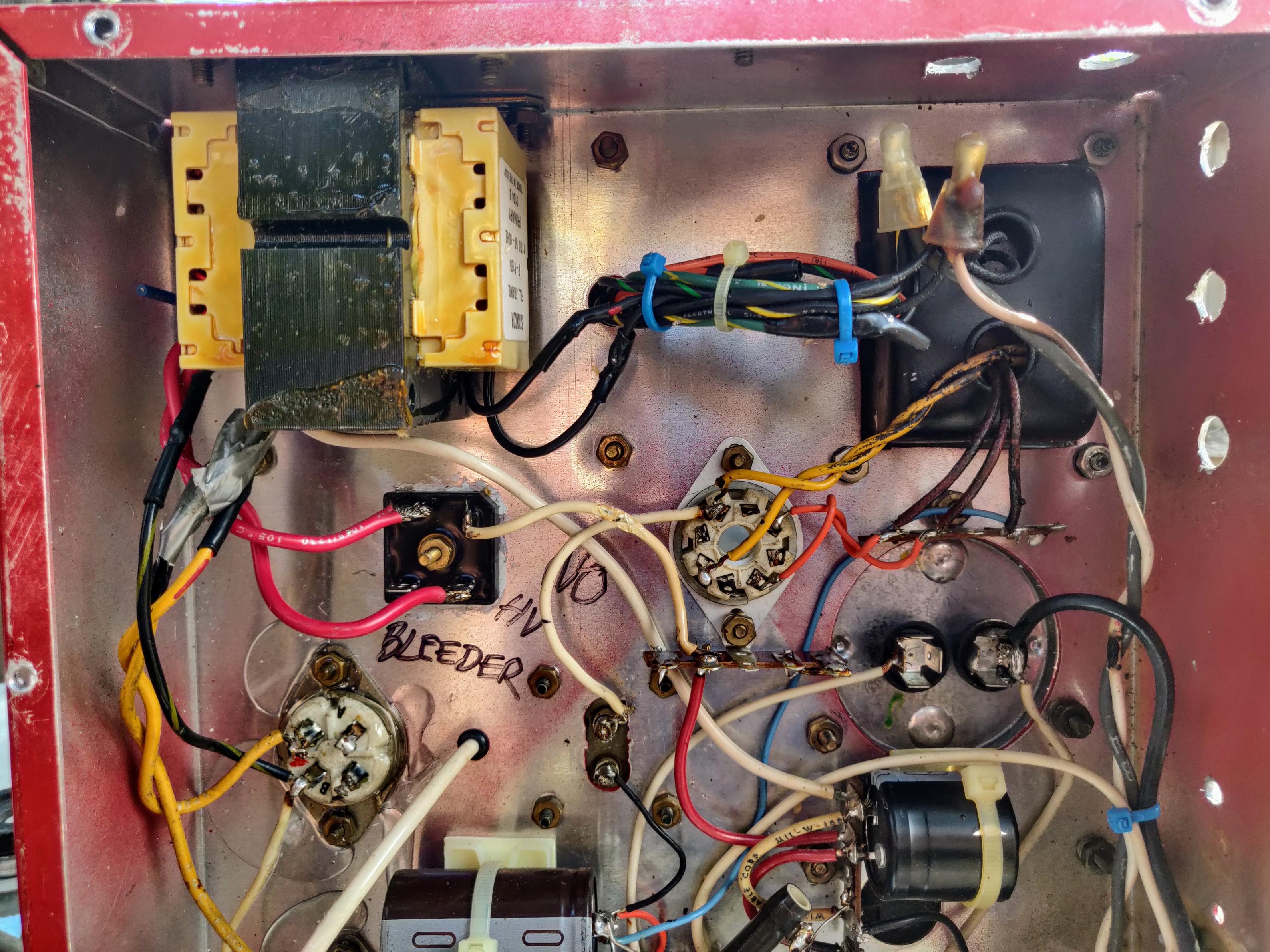

Hi all,
I picked this up today for the same price that was marked on one of the spare tube boxes. Those OPTs are hefty. I pulled the cover off and discovered a transformer underneath that is indeed that big, but potted in wax. As you can see, the PS is quite a mash mash of vintage stuff. Haven't seen many pairs of 3B28s. The HV supply is on a mechanical timer.
Based on a quick look (you folks know better than I) I see a half 6sn7 to the grid of half a 5687 to the grid of a 6sn7 strapped in parallel to the grid of the 845. A quick google suggests you don't see that topology every day either.
There are a bunch of receipts in the bag for repairs spanning 2005-2013. (The owner at that time, I think the second, paid $240 for a shop to build an umbilical terminated with electrical tape!). It evidently worked when sold to the third owner; a solder joint broke during transit; some idiot popped an 8sn7 into one of the holes; it didn't work; and then on the way to the shop he stopped fast and broke the power tubes. So he sold it to me. But the point is that it appears to have run for quite awhile and been modified and updated from time to time.
I know this topology isn't ideal. I also know the soldering is scary bad. (Folks say my builds aren't pretty or terribly safe, but at least I'm better than this!) I don't have time right now to re-engineer the entire thing. But, I could certainly clean up the bad joints; replace the scariest bits; toss in some cheap 845s; and if it powers up nicely (I've got a variac and isolation transformer and know how to do that), see if it works. (I also don't love the safety earth through the umbilical, thoughts?)
Is that a terrible idea? I know it needs a better topology to make more power. And that I'd be better off with a simpler 300B amp. But boy would it be a cool looking and heat-wasting way to make music!
Paul

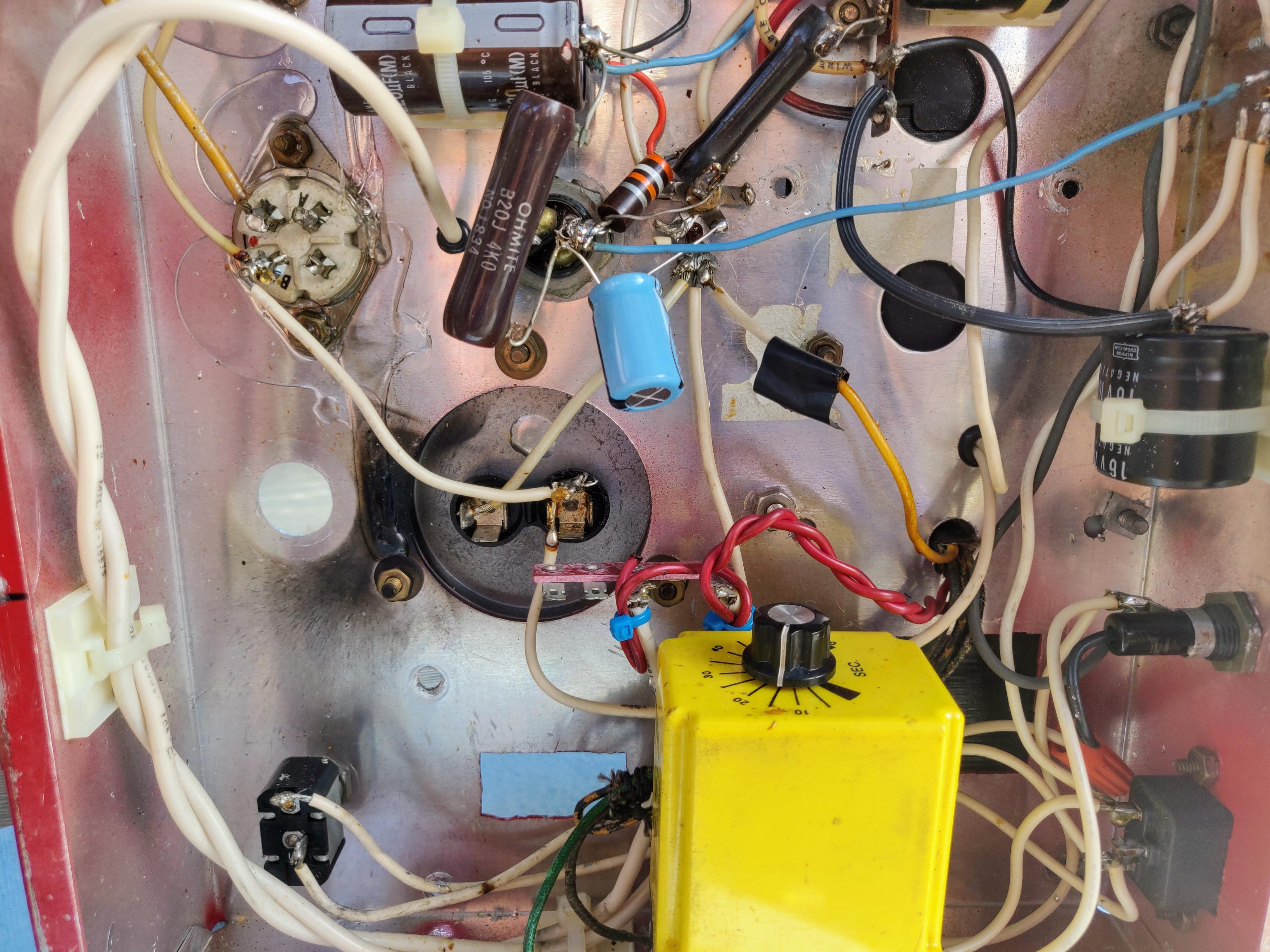

Here is the PS. I think, per the receipts, a shop rewired all of this. Doesn't seem like professional work ....

One of those crimp on wire nuts on the top right looks to be discolored from heat. Personally I would strip out that rats nest and do a rebuild.
See all those holes drilled around it? Those were drilled later--sloppily and after paint. So they knew it was a problem. Those two wires are melted together, so one of the things I'd clean up before firing up.

No HV bleeder... nice.
Isn't that neat? At least they warn you! How hard is it to add a safety bleeder?
Not a ton of power supply capacitance here. They used big old oil filed AC caps on top. The one that is labeled says 45mf 600VAC. The other one is missing its label, but the same size. Given that the HV parts are generally rated around 1000V, I'm hoping they kept the HV down around 800V. Only one way to find out ....
The 'lytics in the signal chassis are in the filament supply of the 845s. The smaller can on top the PS looks like a 'lytic to me, 4mf at 600VDC. Filament supply?
There's the chance here that because the previous bozo attempted to fire it up with a broken solder joint, a wrong tube, and whatever else, some aspect of the power supply is fried. If so, I don't think it'd be worth restoring as-is.

One other structural concern: the chassis is a little light for the OPTs, so it is bowing. The tag board, as you can see, is bolted the full length of the chassis, suggesting to me it is taking some significant strain. I really don't like that fiber being pressed into duty as a structural element, but for all I know, it can take some flex before problems arise. Opinions welcome.

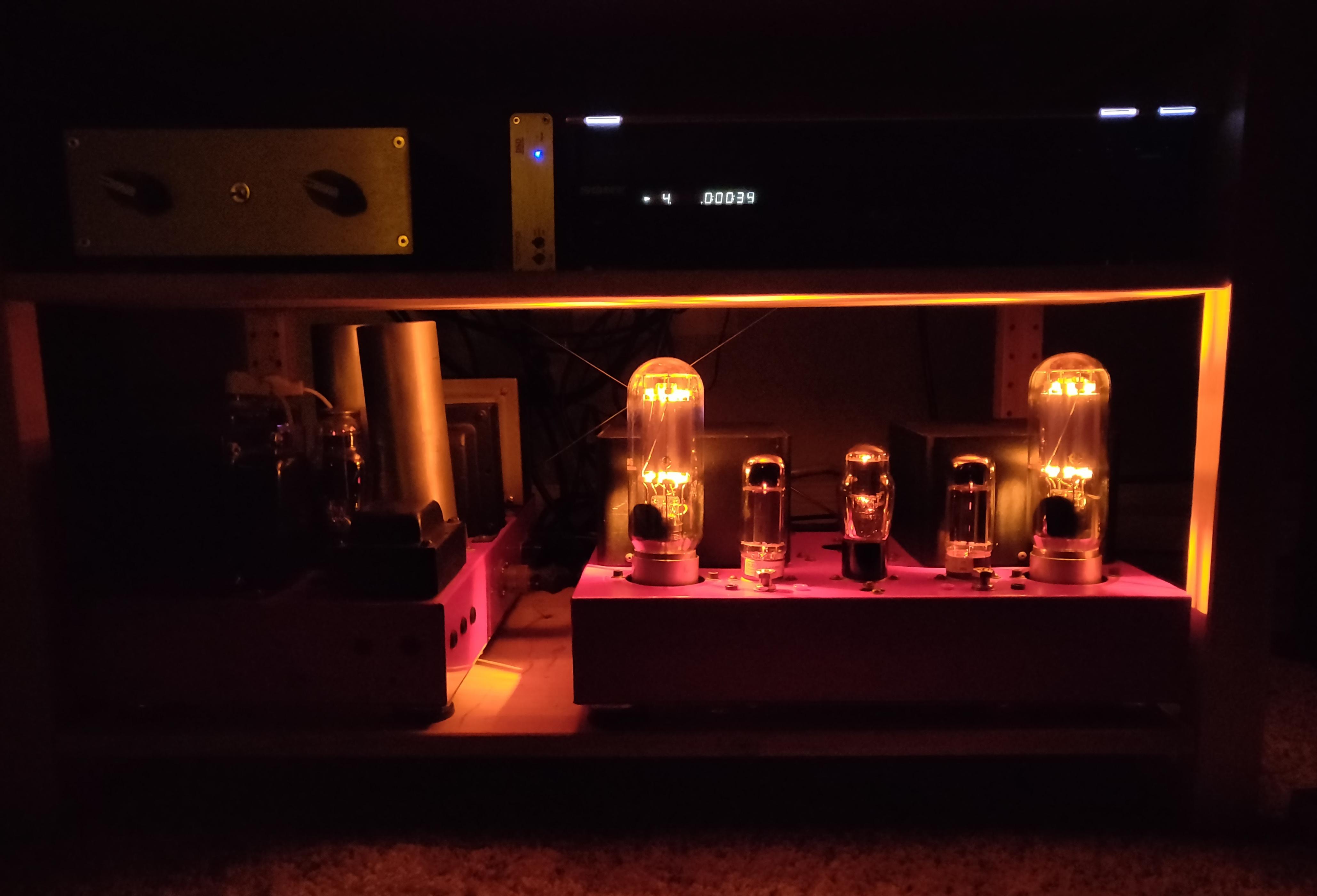

And now reborn!
I never got the old circuit to stop oscillating. I found a circuit here that seemed like a good fit for the PS and chassis layout I had to work with. After waiting weeks for USPS to lose and find parts again, and after some great help from the extremely generous Grover, it is alive and working well!
A little more hum than I'd like, but I've never had a truly quiet tube device, even with commercial kits. B+ ended up at 875ish, and biased at 80-85 ma, it is giving me a touch over 20 watts into 4, 8, and 16 ohms from the respective taps before visible clipping on the scope. Starts to roll off between 20-30hz on the bottom and above 23khz at full power.
Vocals are very compelling. It isn't as open and relaxed as the DIY First Watt F5 monos, but it needs some time and some tube rolling, perhaps. (Going to swap to 6L6 variants as even with only a buffer, it is much more gain than I need, clipping at 1.3-1.4V input.). The bass is more fun than the F5s!

The glow is crazy! I'm looking at some nicer 845s. I literally plugged in the cheapest ones I could find (like $80 for the pair) because I didn't know if I'd get it working. (One of the bayonets has since popped off!) Some of the new 845s have windows cut so there is even more glow!
One thing I really enjoyed about building this is having PLENTY of room in the chassis for Grover's simple circuit. Perhaps inspired by finding this forum back when Peter Daniel chip amps were all the rage, I've always tried to make stuff super small (even my previous two chassis tube amp and especially my current F5 monoblocks), which creates difficulty. This was easy with that enormous turret board!
