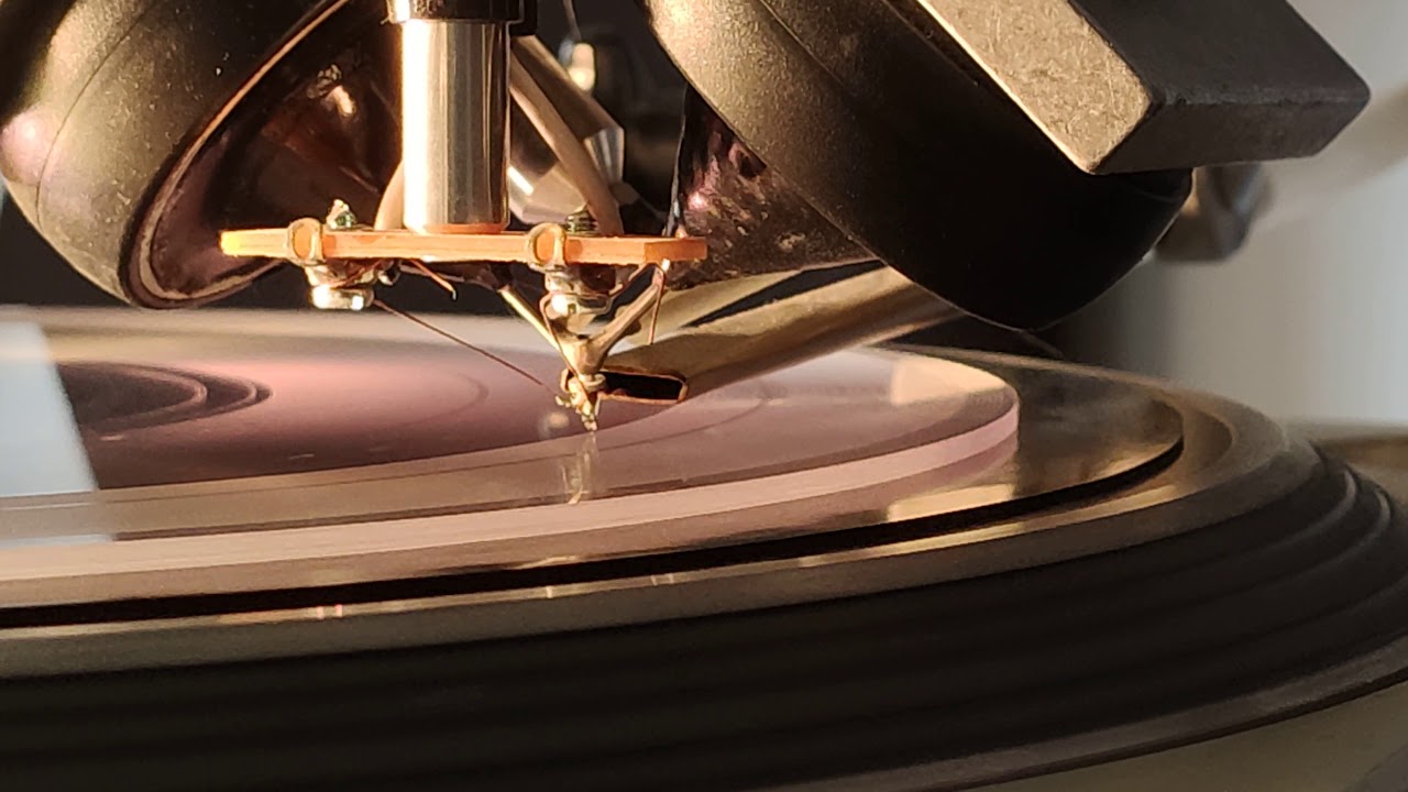

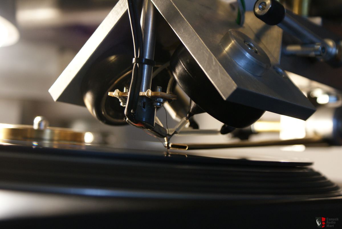

Thanks for the photos and info, Ray.
It is built as i imagined, not only because it is logical, but maybe the only way to, because the carriage with its inertia would not be able to carry out such rapid micro-movements.
The carriage proceeds orthogonal to the radius with the pitch decided by the sound engineer, while the cutting tool moves on the surface of an imaginary sphere, driven by the coils into the carriage head (the opposite will be done by our cartrige)
This is why, in the presence of such complex movements, in my opinion, it makes no sense to speak of H and V movements, and even more of different eff. masses.
This also confirms my idea that a small tracking error, that disturbs so many sleeps, is an almost irrelevant problem, especially with classic cuts. Unlike the stylus bending (some confusion around), due to skating on the pivoted and friction on the linear ones, which are instead immediately generator misalignment = distortion

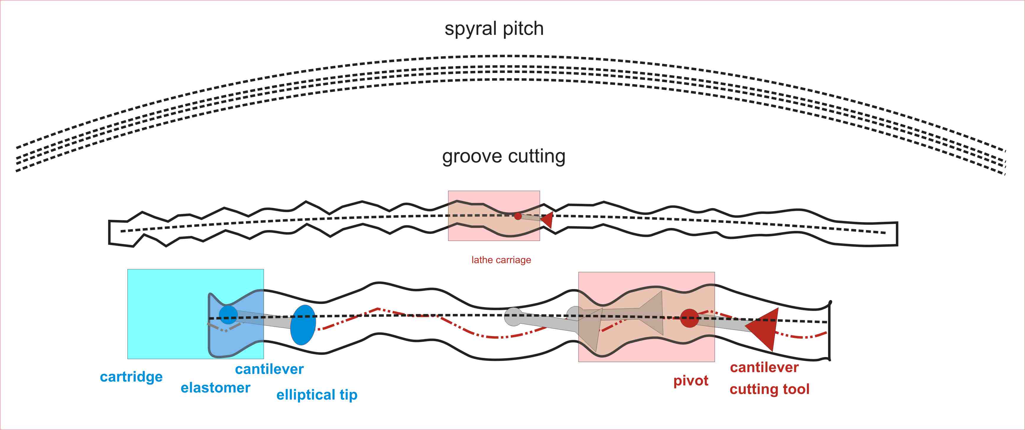

My naive question wanted to explore this hypothesis:
- the lathe carriage moves only horizontally, parallel to the radius of the disc defining the variable pitch of the spiral (imaginary axis of the real groove)
- the cantilevered cutting tool, attracted by the coils at 45 according to the electromagnetic signal, moves on an (imaginary) sphere by engraving the lacquer with a sinusoidal groove both in height and in width (stereo)
To do this, the cutting tool rotates with respect to its pivot by significant angles. This determines that the axis of the real groove diverges somehow, moment by moment, from the axis of the imaginary spiral.
To ensure that the stylus tip of our cartridge is aligned with the signal groove at the same angles as the cutting tool, it is necessary that, moment by moment:
- the head shell is aligned with the imaginary spiral in the same position as the lathe carriage head. A very difficult condition to achieve for both P TA and L TA and PL TA, due to the problems we all know even too well
- the cantilever has the same length as that of the cutting tool, in order to achieve the same inclinations, thus aligned with the center of groove (unfortunately there seems to be no established standards)
Of course, in order to replicate the movements of the cutting tool, in addition to the physical imperfections of the engraving, remains the fact that we have a passive movement vs an active one.
That such contraption could work is really a fascinating mechanical voodoo. Happy centenary Mr Blumlein, you were really a genius
carlo
hope the sketch could be clearer than my words- it's clearly exaggerated to evidence the geometric problems- practically, quote Doug, no possible issues, our problem is to get the headshell where it must. and the cantilever not bent.

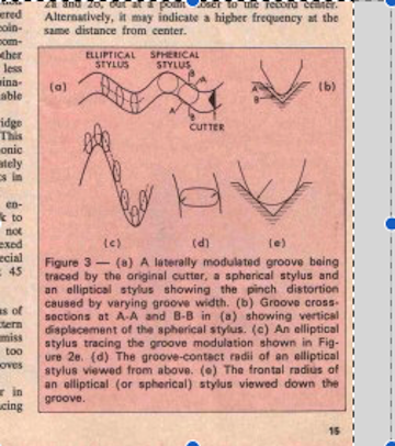

Indeed, if it did swing in response to the modulation, the pitch effect would not exist.
Not true. Although the chisel swings the pinch effect exists.

On reflection, I now agree. The pinch effect is solely due to the mismatch between the profiles of the cutter stylus and the cartridge stylus.Not true. Although the chisel swings the pinch effect exists.

What you are describing there is tracing distortion not the rather separate issues with tracking.

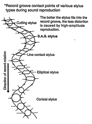

BTW: You really, really don't want the playback stylus to look anything like the cutting one, it would absolutely shred the groove wall.

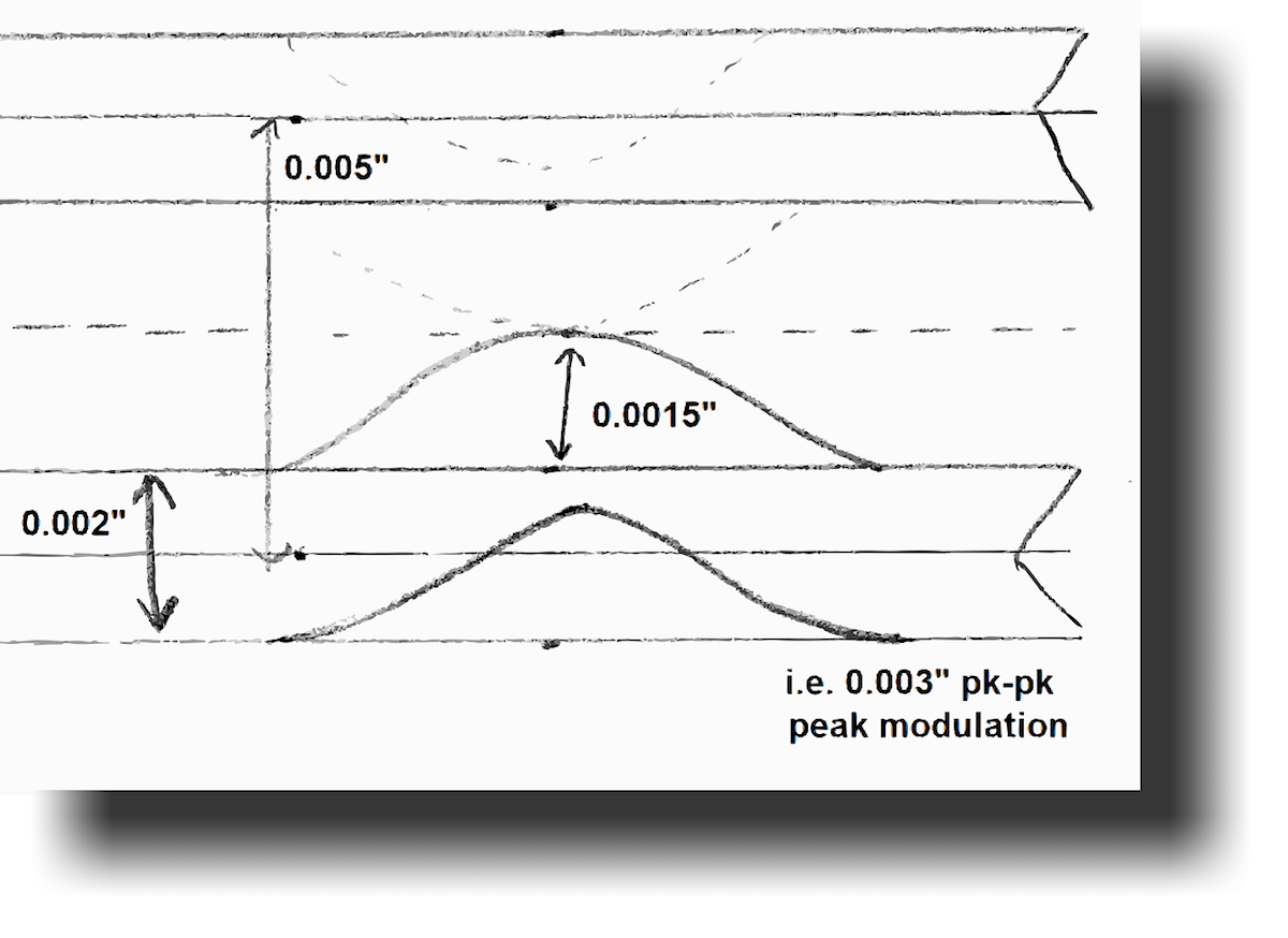

I've attached a couple of the ubiquitous illustrations of cutting heads and stylus types in grooves. I'm beginning to question their usefulness.
Obsessing over the geometric differences between the cutting stylus and the cartridge profiles in a random groove, is a distraction. There are far too many unknowns. Which cutting stylus and cartridge profile? Which groove modulation? Which cutting engineer?
Allowing the replay cartridge cantilever to sit tangentially to a locked circular groove at any radius should be the first order of business as Straight Tracker suggested in another thread. Even with this clear and simple aim, there will be impediments like imperfect stylus and/or cantilever alignment. This can occur with brand new premium cartridges and can also creep in over time with use. Then there are the LP imperfections.
The discussion over tonearm geometry in relation to cutting stylus geometry and cantilevers is analogous to designing a car steering by considering the following of random curves and humps without first getting it to steer in a straight line on a flat surface.
Hope the sketch could be clearer than my words- it's clearly exaggerated to evidence the geometric problems- practically, quote Doug, no possible issues,. # 45
My sketch could maybe mislead someone, sorry: my aim was to examine the thing just from a geometric point of view by highlighting that, even if it's commonly said that the cutting tool acts in parallel, this is not geometrically true since it is mounted on a cantilever rotating on a pivot.
This was shown altering completely the proportions: doing in real ones the cutting head (too big), or the groove (too small) could not be seen together on the same sketch.
In practice, as Doug previously noted, the cantilever length/sinusoid amplitude ratio - mm vs micron 1000:1 - is such as to make the problem irrelevant for sound reproduction.
But not for theoretical assessments.
carlo

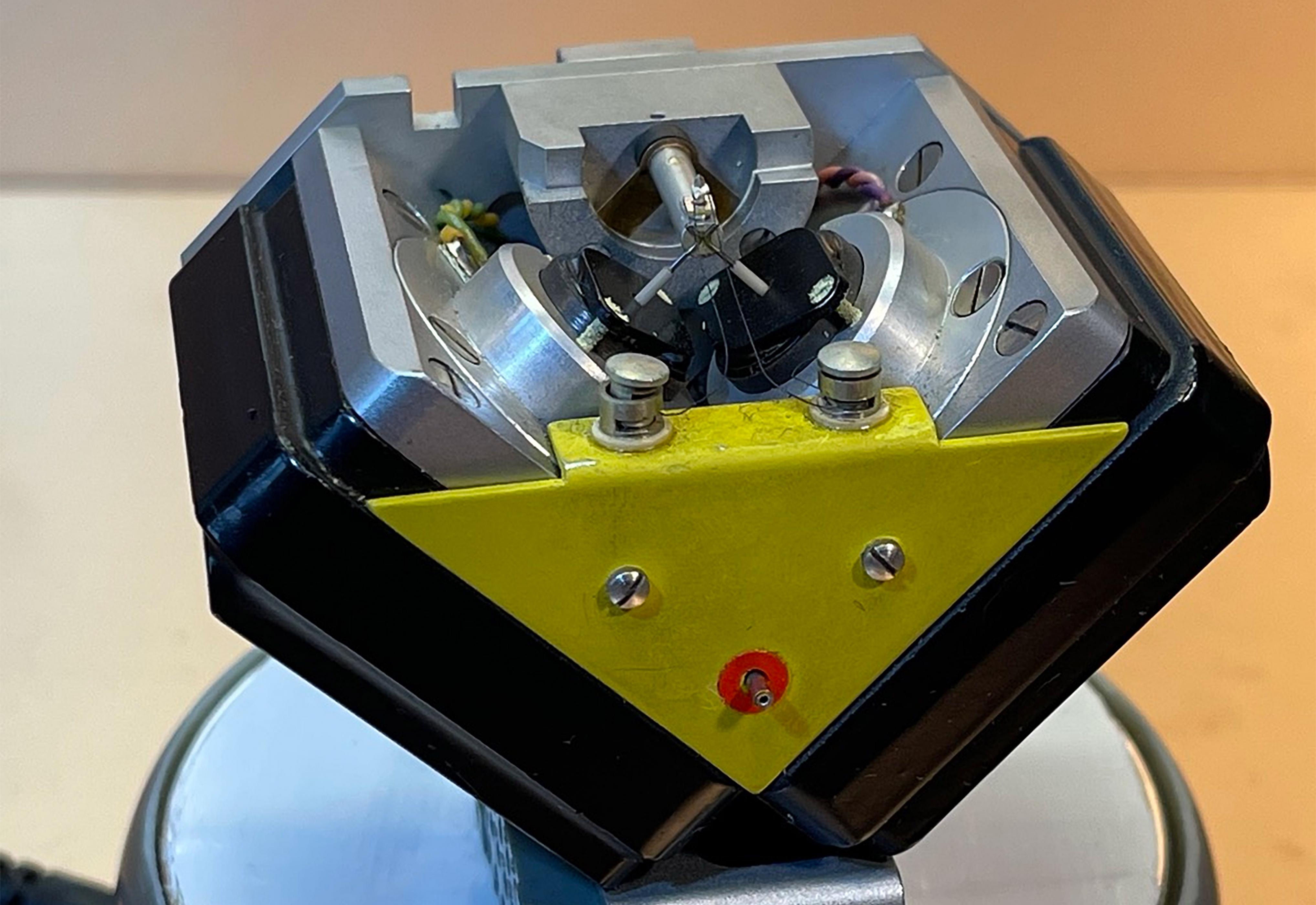

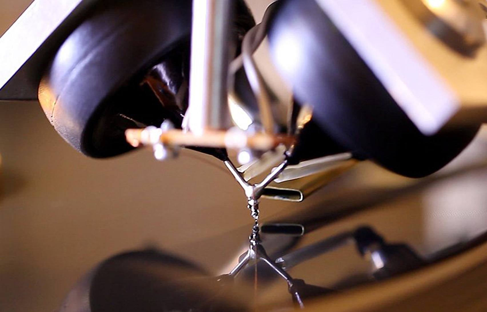

Hi guys. Look at the pictures. There is no pivoting cantilever in the cutting heads 🙁. Many more pics of the Neumann SX-68 NEUMANN SX 68 stereo CutterHead for Vinyl Cutting NEUMANN VMS Lathe | eBay
dagfinn said:There is no pivoting cantilever in the cutting heads
Hi dagfinn,
If you look very carefully at your first picture, you will see a massive half cylindrical metal block towards the rear of the cutter head. At the front of that block, you will see a "C" shaped half cylindrical clamp. Sandwiched between those two components, there is a spring-steel flexure that is connected to what looks like a cantilever. There also is an elastomer connected to the cantilever right behind the point where the flexure is connected. This is not visible but I think the rear of the elastomer has a metal stud bonded to it which is held in place by the plainly visible set screw. So I think the cantilever "pivots" if you can call it that.
Sincerely,
Ralf
