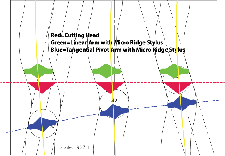

Is there a misspelling? The Blue figures should be equal to "Pivot Arm with Micro Ridge Stylus" as the blue dotted line travel across in an arc, which is what a traditional pivot arm does. There's nothing tangential about it.
It is not a misspelling. First, the drawing may not be precise. I tried to avoid the word, tangent because once you use the word, tangent, you are implying there is an imagined line that travels through the middle of small waveforms. These imagined lines are yellow in the new drawing. All the blue stylus are tangent to yellow lines. But in Ralf's reasoning, the stylus can't be tangent to the groove because the groove is a series of small waveforms. The blue dot line is Thales circle.
Any ARTICULATED tonearm based on the Thales circle should line up just like any parallel tracker or the cutting head. The whole point of this type of tonearms is to track like a linear tonearm. The diagram suggests there's gross tracking error. Sorry, this doesn't make sense at all.
I agree. As I said, the diagram may not be precise since I put emphasis on the waveforms and I also added a comment that the blue stylus is tangent to the yellow lines to avoid any misunderstandings.
What sense does it make to confuse the groove with the (low frequency) waveform?
What sense does it make to confuse the tangency of the cartridge to the groove (or concentric circle - no practical difference) with the "tangency" of the stylus to the signal?

My post was not about tone arms. I tried to show that the phrase "tracking tangentially to the groove" is a colloquialism and not an accurate description of what happens when the stylus interacts with a groove.

I used a conical stylus because it is easier to draw a circle than an ellipse.
If I had drawn an ellipse, the gross deviance from tangential tracking would not have changed.

You show the excursion due to the low frequency part of the signal. What does this prove regarding the tangent to the groove?
Hi alighiszem,
I got the picture of the groove at random off the Internet.
I have no idea if the groove represents low or high frequency content.
Due to the fact that the groove switches from side to side at the speed of audio frequencies, the stylus and the groove can never be tangent to each other.

Ralf, I mean the groove just being cut runs out from below the cutter edge so that it's tangent is perpendicular to the actual radius. Surely the axis of the cutter head is perpendicular to the actual radius, and the tangent of the groove at the cutter edge is along the line of the named axis.When a cutting engineer sets up the groove cutter, he sets it up so that its cutting face is coplanar with a straight line that intersects the center line of the platter spindle otherwise known as the radius.
If the playback stylus had the same shape as the cutter edge, and followed the same path with the same (zero) angle from the tangent, like an ideal LT system would do, there would not be any tracking angle error. I agree that stylus geometry (especially spherical) might cause phase error, but it is probably significant only at higher frequencies.
No it's not. The groove direction is that of the vector sum of the constant forward rotational velocity and the transverse modulation velocity. By the parallelogram law this is diagonal.Ralf, I mean the groove just being cut runs out from below the cutter edge so that it's tangent is perpendicular to the actual radius.
Which axis? The cutter head can move vertically and laterally and as explained above the groove direction is determined by the rotational velocity and lateral modulation.Surely the axis of the cutter head is perpendicular to the actual radius, and the tangent of the groove at the cutter edge is along the line of the named axis.
None of this makes any sense.If the playback stylus had the same shape as the cutter edge, and followed the same path with the same (zero) angle from the tangent, like an ideal LT system would do, there would not be any tracking angle error.
Actually it is more accurate to say it moves in two axes at ±45 degrees.The cutter head can move vertically and laterally

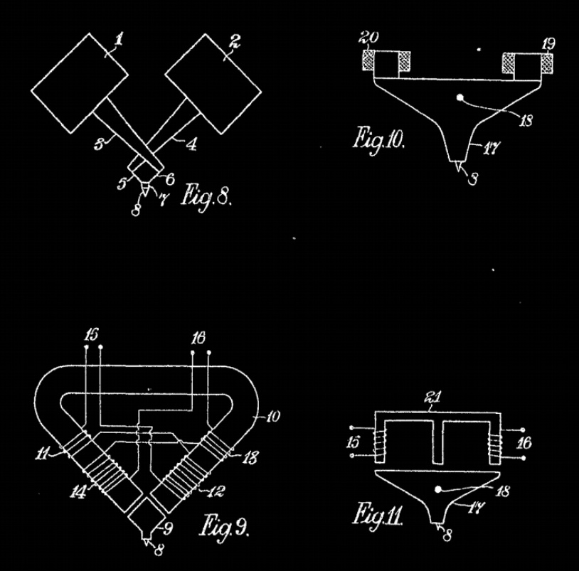

Blumlein patent - attachment

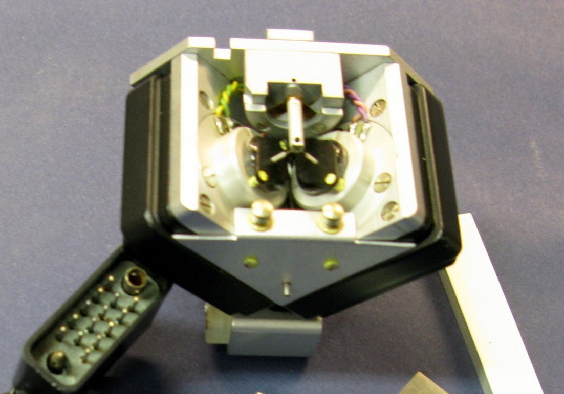

Have a look at these photos from my files. A Neumann cutterhead stylus is indeed mounted on a cantilever and is actuated by two coils, offset +/- 45 degrees. Here is a photo of a SX-68 that clearly shows the cantilever (with no stylus installed). The cantilever is anchored in a pivot or fulcrum and the stylus end is attached to the L & R coils:

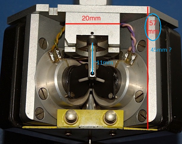

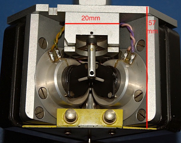

Next up is an undocumented photo that has some dimensions in red (not mine). It could be a SX-68 or maybe a SX-74, which is a newer version of the SX-68. I suspect that the dimension labeled “57 mm” in red is a typo since the Neumann spec sheet shows that dimension to be 45 mm. For the moment let’s neglect the error introduced by the photo having been taken slightly off-angle. The 20mm dimension appears to be about right.
If you scale the cantilever per the corrected dimensions, then the cantilever length works out to be about 11mm:

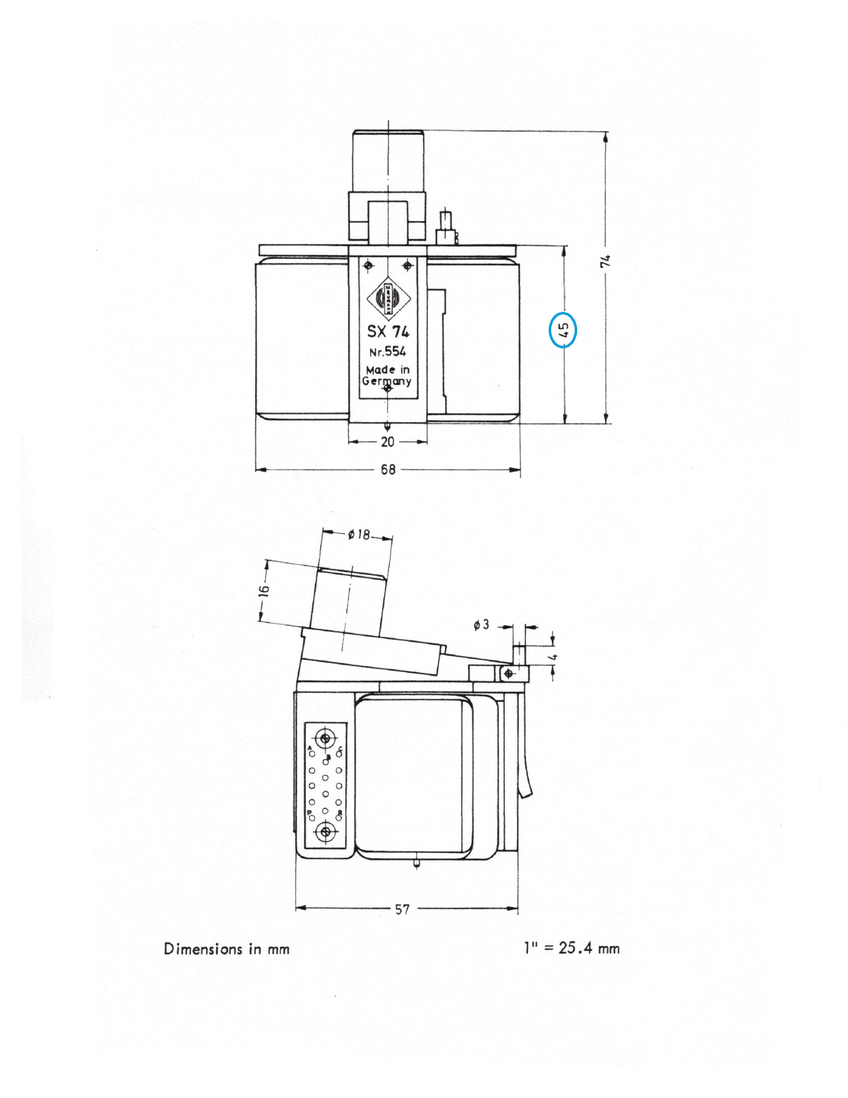

Here are the actual dimensions of a SX-74 from Neumann’s spec sheet:
So, the motion of this cutterhead stylus with audio modulation is in a sphere with a radius of ~11mm. Neglecting possible effects of spring-back in the lacquer and whatever else in the cutting process, shouldn’t the effective working length of the cantilever of a cartridge used for playback also be close to 11mm for minimum distortion? Most cartridge cantilevers I’m familiar with are typically shorter than 11mm, many by quite a bit.
