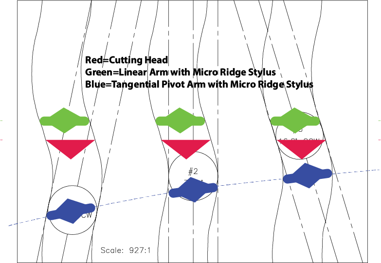

It is popular on the DIY Audio Website to use the phrase “tracking tangentially to the groove”, relative to discussions concerning tone arms.

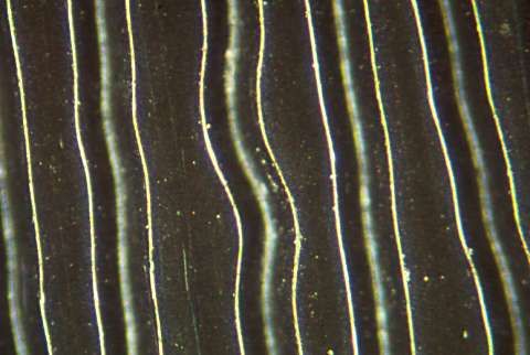

I spent Monday afternoon downloading a Microscopic view of the groove in an LP and then tracing over the middle groove with a spline and turning that into a PDF drawing to illustrate the gross inaccuracy of the above phrase.
I used the same groove three times to show three successive positions of the stylus as the LP rotates.
The first position of the stylus shows it to be tangent to the groove at an angle of 11.82º CW relative to the vertical.
The second position of the stylus shows it to be tangent to the groove at an angle of zeroº relative to the vertical.
The third position of the stylus shows it to be tangent to the groove at an angle of 16.8º CCW relative to the vertical.
Assuming that the tone arm mounting hole is located vertically above the second position of the stylus, it would have to relocate itself 2.327” to the right of stylus position #1 to remain “tangent to the groove” and it would have to relocate itself 2.327 to the left of stylus position #3, to remain “tangent to the groove”. My hat would be off to the tone arm designer who could design a tone arm capable of accomplishing that.
Illustration No.1 shows a record groove at a scale of 927:1. I picked the middle one because it was suited best to make my point.
Illustration No.2 shows the same groove three times with the stylus in three successively different positions as the LP rotates. Tone arm pivot to stylus distance is: 9.200”.
(I don’t dare mention variable groove pitch which would make matters worse)

Here is an illustration to explain tangential to the groove. I put the emphasis on the tonearms. When we say a particular tonearm is tangential to the groove, it means the stylus is conceptually tangential to a single spiral. If you want to dig it in depth, please see the diagram. Obviously, linear arm is the best.

about 0.5 milliradians I estimate, completely negligible compared to the accuracy you can actually align a cartridge or cantilever in practice.There is an angle between the groove spiral and true tangency to the signal (a concentric circle)
What your illustration shows is that the blue Tangential Pivot Arm pattern is exhibiting very high (unacceptable) tracking error.Here is an illustration to explain tangential to the groove. I put the emphasis on the tonearms. When we say a particular tonearm is tangential to the groove, it means the stylus is conceptually tangential to a single spiral. If you want to dig it in depth, please see the diagram. Obviously, linear arm is the best.
In theory, since tangential pivot arms are supposed to be tracking-error-free (as discussed in other diyaudio threads), the blue arm pattern should superimpose on the green pattern i.e., the Tangential Pivot Arm should be equal to the Linear Arm in terms of tracking error. Perhaps you are missing the point of this thread?
927:1 At that scale, isn’t that change in stylus angle rather than tonearm angle? How big an arc can a stylus swing through in highly modulated passages?
The diagram is exaggerated in order to illustrate my point. If you insist on the same scale as Ralf's diagram, it is not possible to discuss further.
You insist the groove is a spiral therefore you say tangential pivot arm should be equal to the linear arm in terms of tracking error. But Ralf says it is not single spiral. It is a combination of small wave forms. Therefore, a tonearm can NEVER be tangent to the groove.
Personally, I don't think it is necessary to think the groove is a combination of small wave forms. But I wouldn't say he is wrong because the groove IS a combination of small wave forms.

The scale has no effect on the angles being discussed.The diagram is exaggerated in order to illustrate my point. If you insist on the same scale as Ralf's diagram, it is not possible to discuss further.
Not sure how you came to your conclusion. Ralf and I are saying the same thing.You insist the groove is a spiral therefore you say tangential pivot arm should be equal to the linear arm in terms of tracking error. But Ralf says it is not single spiral. It is a combination of small wave forms. Therefore, a tonearm can NEVER be tangent to the groove.
You are of course entitled to your opinion(s). Doesn't mean you understand the topic.Personally, I don't think it is necessary to think the groove is a combination of small wave forms.
You said that both a linear arm and a PT arm should have no tracking error because in your mind, both arms are tangent to the groove. Therefore, there are no tracking error. This is why you are not talking the same thing. You are still thinking that the groove is a spiral, not small wave forms.
Is there a misspelling? The Blue figures should be equal to "Pivot Arm with Micro Ridge Stylus" as the blue dotted line travel across in an arc, which is what a traditional pivot arm does. There's nothing tangential about it.
