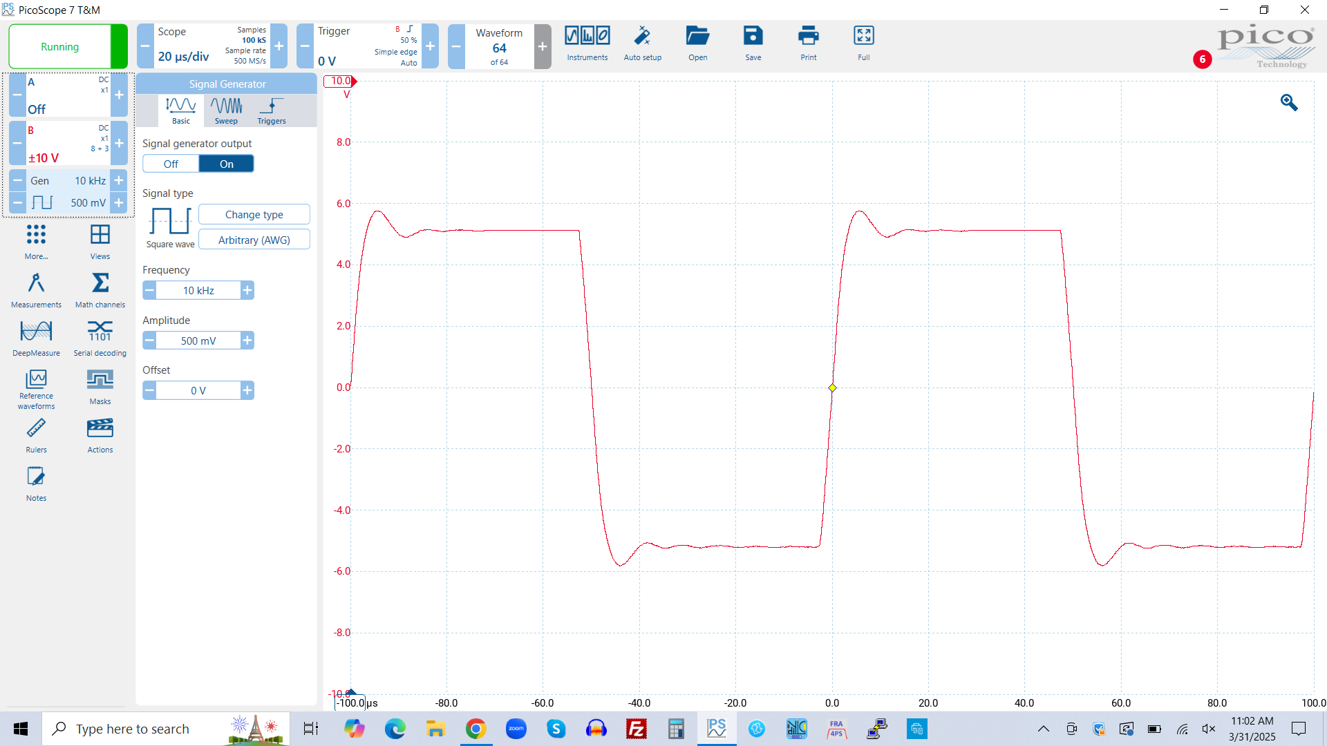

In my Williamsons I use a pretty agressive low-pass filter (1200pF + 1800 ohms in series) and a cap across the feedback resistor. The amps are stable unloaded, with .22uF across an 8-ohm load, and into a .01uF capacitor-only load. That's pretty good. A 10kHz square wave looks like this:
I like a little overshoot on the leading edge.

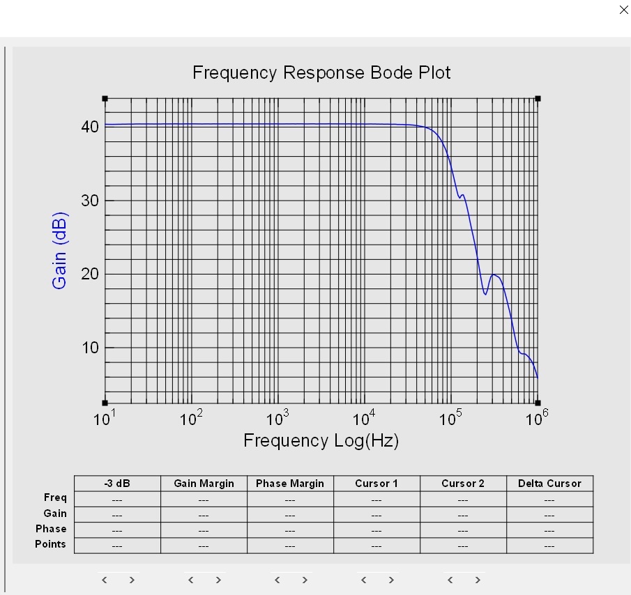

The frequency response looks like this:
Some will say, why add feedback to increase the bandwidth, then whack it back with a low-pass filter? My answer is because the more stable an amp is, the better it sounds across the normal audio spectrum.

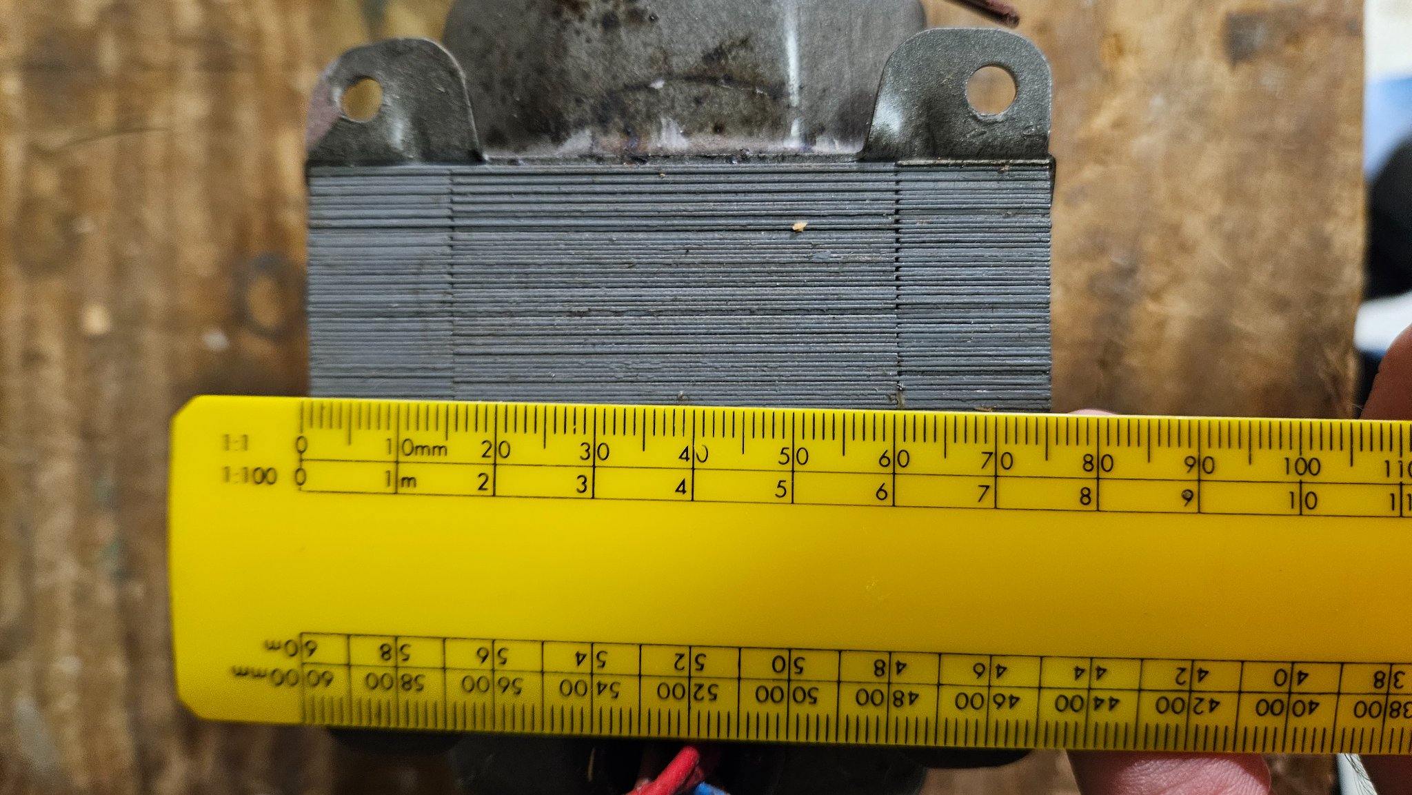

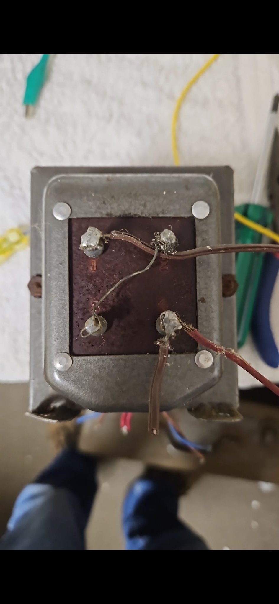

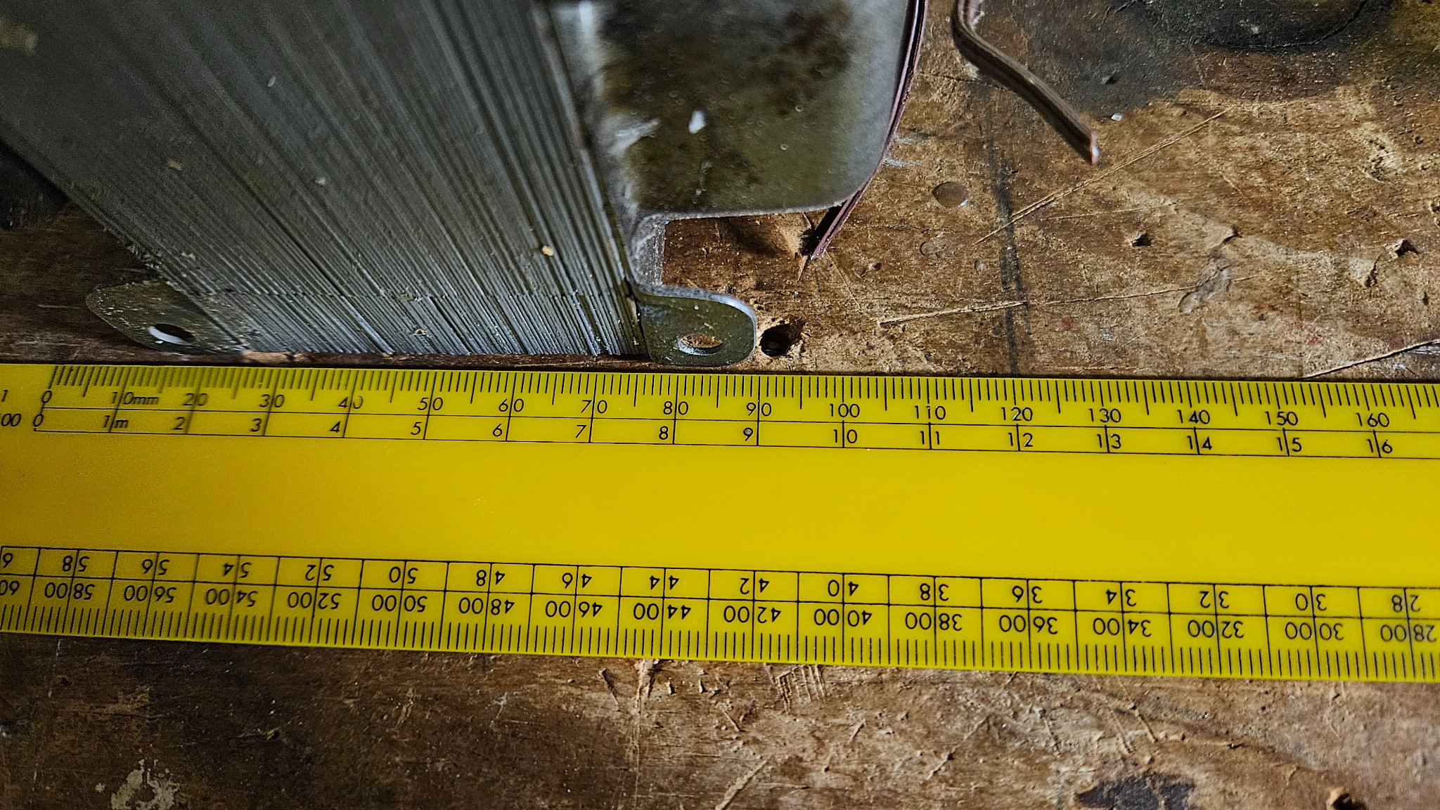

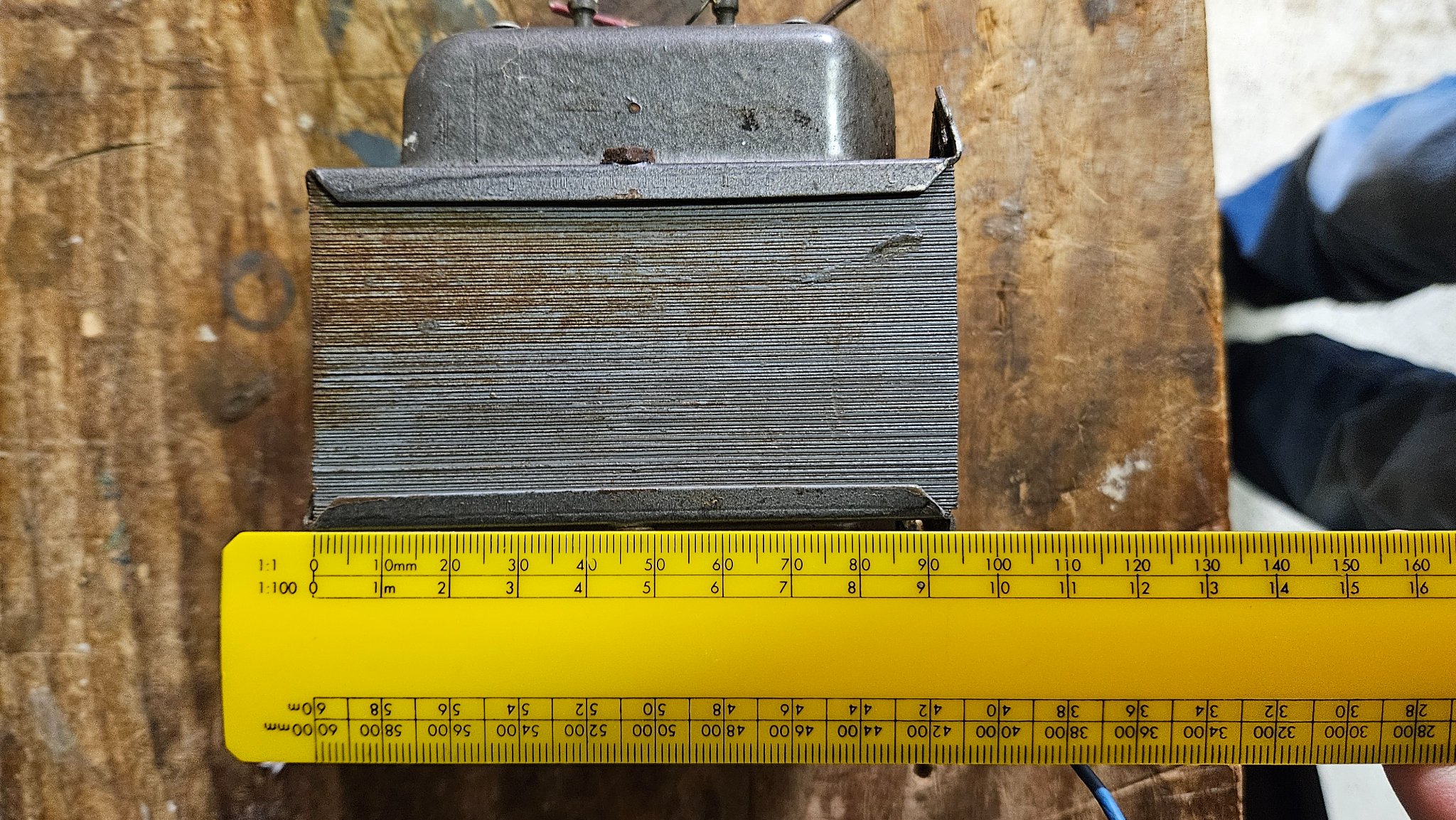

And as far as the OT goes, here is the photo. It looks a pretty decent size for a 12 W transformer, although I know relying on this is not an indicator.
