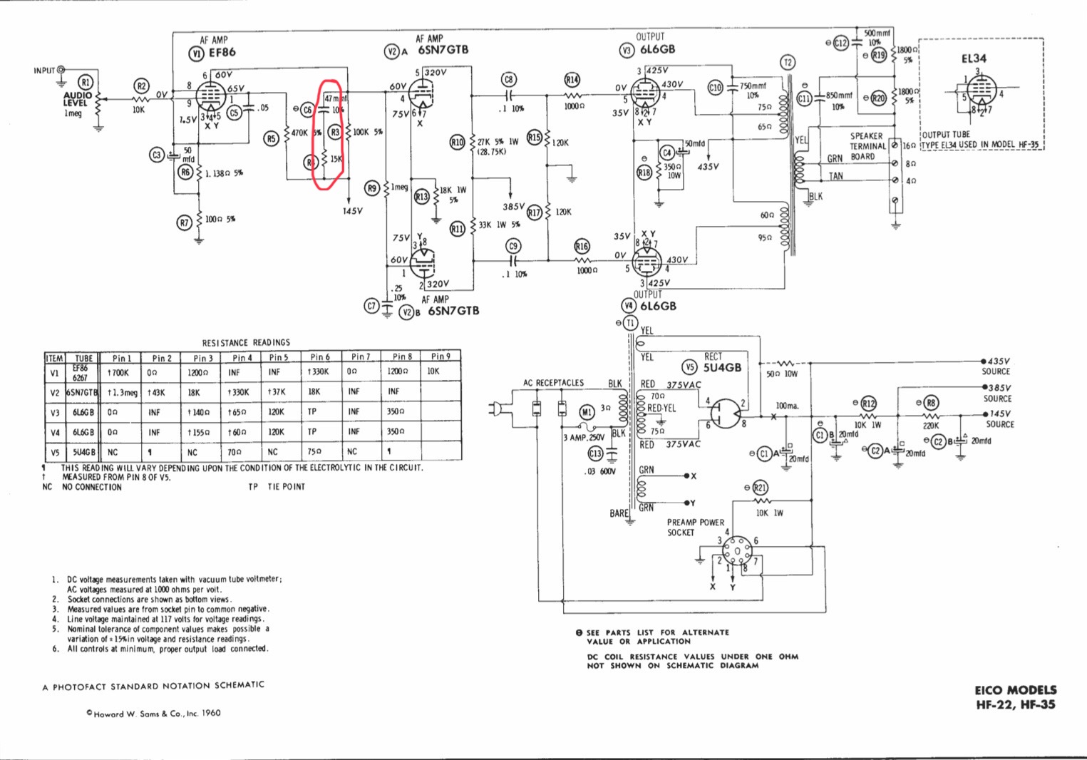

Im looking at building this Class AB1 cathode biased amplifier based on this design here.
I have most of the components on hand, including a suitable power transformer and pair of OT's.
I am making a few changes, I am using an EF37A/6J7G instead of an EF86 and using 807 tubes instead of 6L6.
Few questions, is the 750pF capacitor across the CT to anode on the tube to remove oscillations? I find its odd only one half has this, ive never seen this before on such a schematic.
There is also an 820pf cap going across for the NFB loop, how critical are the values for these capacitors?
I have quite a bunch of silver mica caps on hand but nothing quite exact, ive got a few 680pF and 1000pF on hand if they will suffice.
Here is the schematic and a rough layout ive drawn of the turret board.
Another issue im unsure will be a problem is i mirrored the layout, so have to cross some wires over, not too sure if this is a worry, you will see what I mean with the channel on the left of the image.
The phase inverter was not too big of a deal, as i just swapped over each triode section.
Im unsure about the path of the heater wiring, but its just rough, I will probably move the tube sockets around some more and I have not included the power supply yet, but all the transformers will sit behind the 807 tubes at the bottom of the image. The filter choke im hoping will fit under the chassis.

This is appears to be a mish-mash of a couple of different Eico circuits. The 750pF cap compensated for differences in winding capacitances in the output transformer of the HF-60. If you don't know what output transformer this was intended for and swap in different tubes, all bets are off regarding stability and possible oscillation
Also, an 807 will not tolerate that much voltage on the screens. Well, it might, but you're taking a big risk. 400VDC is the max they will tolerate in normal use.

Right, with the cathode voltage subtracted from the B+ the 807s will be okay. But you can't just apply the same feedback network to any output transformer. Without knowing something about the original transformer the designer used, there's no way to know what the feedback resistor value should be, what level of feedback was intended, or what the phase-lead capacitor values should be. You can't just move what's shown to the 8 ohm tap. Do you have an oscilloscope?
Ah, found it. It's an Eico HF-22:

That amp used a 6.6K Chicago output transformer. I have a pair of them in the shed. So for the same level of feedback (presumably around 20dB), you would use about 2600 ohms from the 8 ohm tap. But again, the 500pF and 820pF caps won't be correct for a different output transformer. I'd suggest a single phase lead cap across the 2600 ohm feedback resistor. What that might be will depend on having a scope and experimenting with different values to reduce whatever ringing might be present with your output transformers.
What output transformers do you have? Not all transformers will handle 20dB of feedback.

Also, the circled cap/resistor network is a low-pass filter to reduce the bandwidth of the amp and avoid high-frequency instability. Again, these may not be appropriate values for your output transformers.

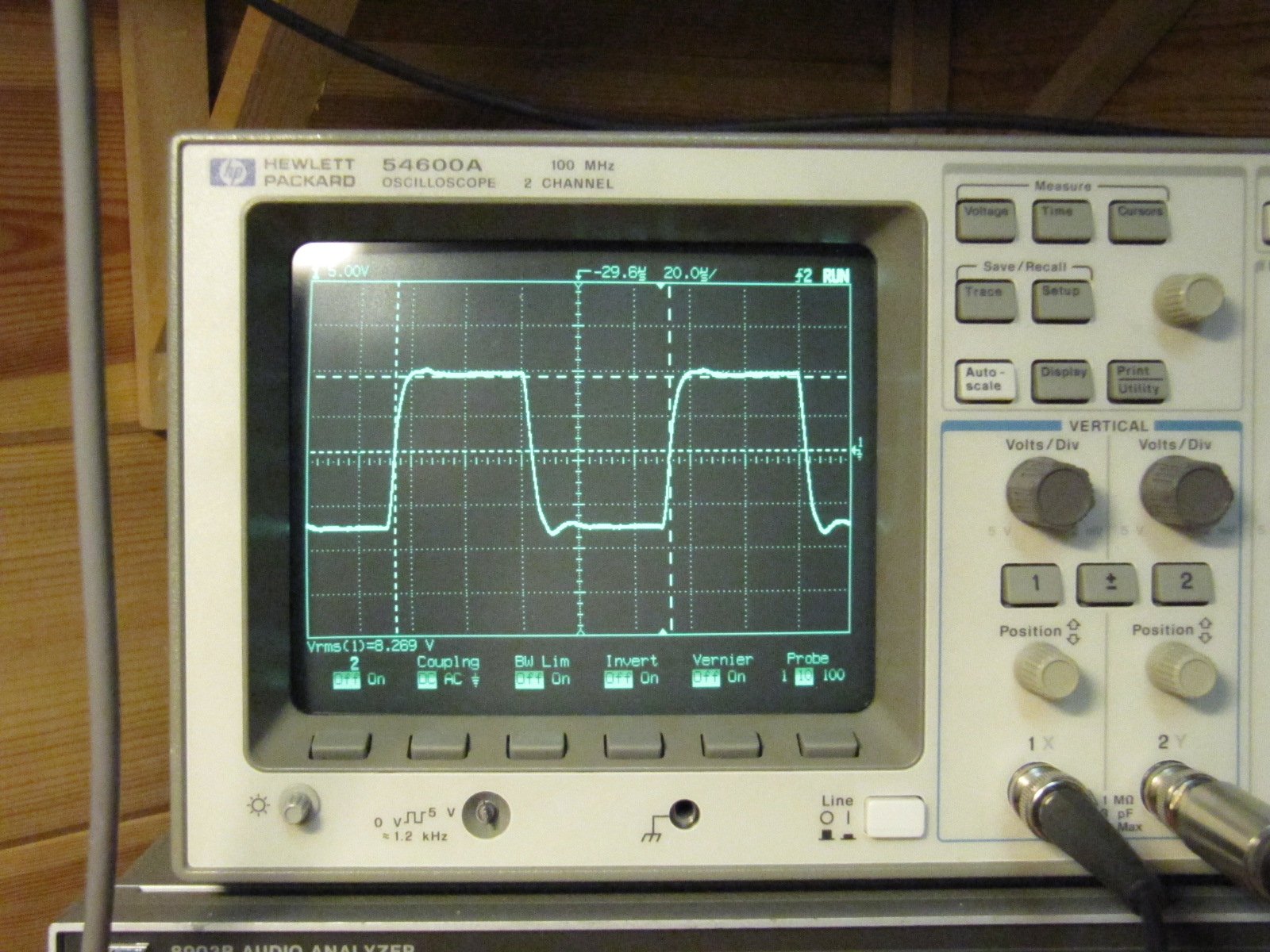

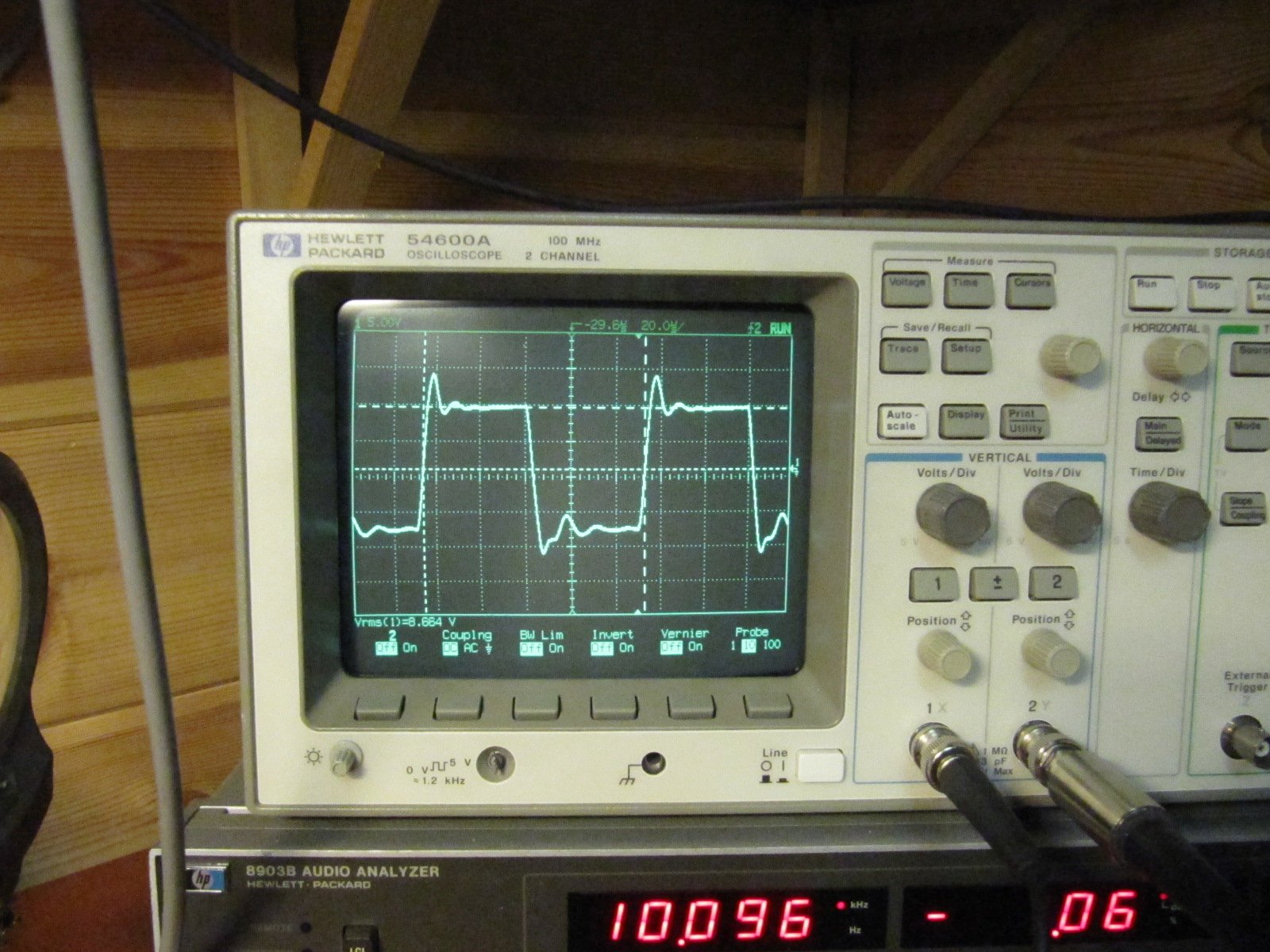

I think, the 750pF is too big value of capacitance for compensation (or the OPT is poor quality). The effective winding capacitance is a lot of smaller than the measured pri-sec value, because the voltage swing is not equal at all of winding surface. The 750pF (plus the trafo's own capacitance) can "eat" the high frequency power bandwith.The 750pF cap compensated for differences in winding capacitances in the output transformer of the HF-60.
Isn't too easy, unfortunately. Impedance-frequency curves can give help (half primary impedance at shunted another half primary and vice versa). You can tune with parallel capacity, until will be the point of resonance same. (Of course, the test must be repeat at shunted secondary too, and refine.) In practice is better the lossy (near-Zobel) compensation.
This is a method I would use to determine NFB-resistor and capacitor:Another thing I forgot to add, is my OTs dont have a 16 ohm secondary, so not sure how this affects the NFB loop, can I just connect to the 8 ohm instead?...Is there any easy way i can test the capacitance on this transformer?
At first, amplifier connected to 8 ohms dummy load, with GNFB resistor un-connected, feed such 1 kHz sine signal to input, that generates some 10 W (below clipping level) and monitor output with voltmeter and oscilloscope.
Connect GNFB with 10 k trimmer/potentiometer, which is set to max. resistance.
Adjust 10 k trimmer to the point where output level is decreased 12...14 dB.
This is safe and reasonable amount of GNFB. 20 dB is risky with not so perfect OPT.
Now you have reached correct GNFB level and trimmer can be substituted with correct fixed resistor.
Then feed 10 kHz square wave signal to input to generate some 5...10 W output power.
Monitor the form of square wave with a scope. There may be some ringing etc. like in the attached picture.
Then start to add some capacitance in parallel with the GNFB-resistor to get as good square wave form as possible. Like at the second photo.
That is all you should need to get properly working amplifier.

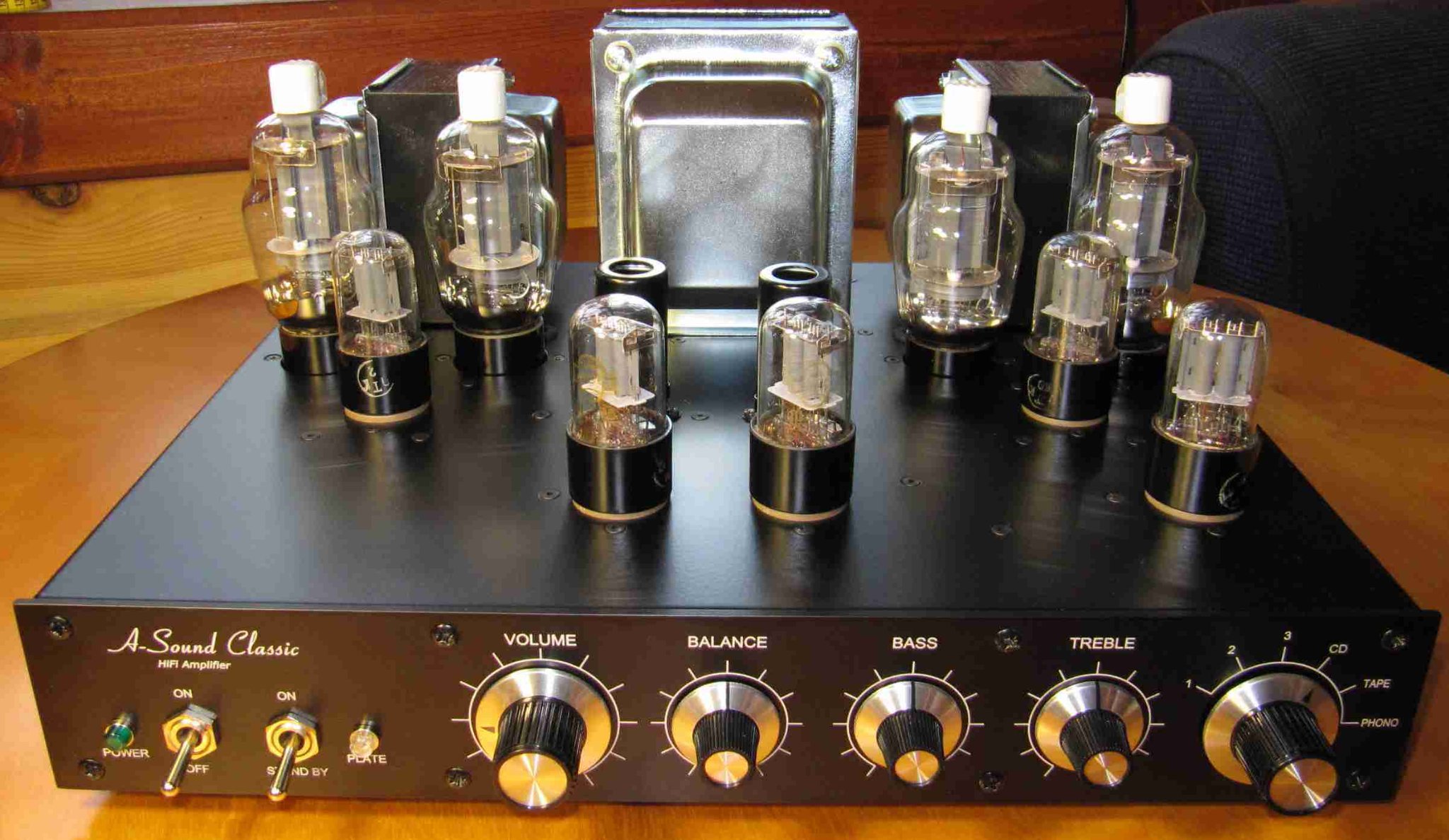

Concerning 450 V as +Ub. I have built many fixed bias UL-PP tube amplifiers with 807's having 450 V as +Ub.
During last 10 years none of these have been needed output tube replacement.
Attached the schematic of my amplifier.
