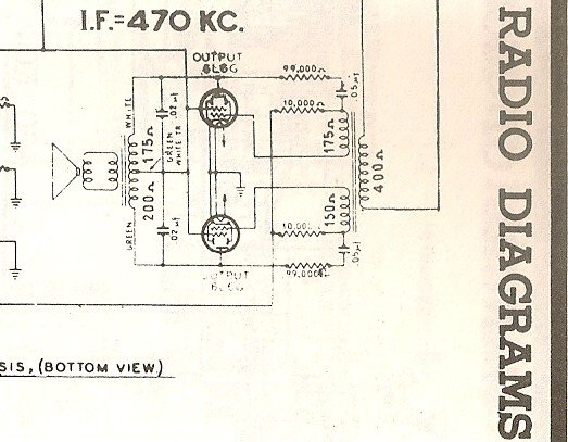

Thoughts on the old Schade PP series feedback?
if in 80 years nobody of the greatest manifacturer used Schade one reason exist.
I read the Deketh book pages 396 to 399 and only found issue with the load imposed on the driver stage for current Fdbk. What paragraph are you referring to?
UnSet fixes the loading with the Mosfet follower.
The problem I see with the usual resistive Schade scheme is that the N Fdbk current is being corrupted by the output tube grid drive voltage swing. The voltage across the feedback resistor is being varied by BOTH the plate voltage swing AND the grid drive voltage (with an INVERSION between them that causes 2nd harmonic distortion for each tube, 3rd H overall ). So the N Fdbk current is no longer purely proportional to the plate V. UnSet fixes that by isolating the tube drive from the N Fdbk. High gm output tubes could minimize the grid V effect, but they only came along late in the game.
Taking the "localized" N Fdbk back to the driver stage cathode or grids (crossed) fixes the corruption problem (more gain in loop minimizes drive V effect on Fdbk ), and that is what is seen in the classic commercial Amps using a localized loop (along with a global loop besides ).
Just curious if anyone has built/analyzed anything like the original push-pull series feedback IT circuit.
Used by Philco in their 38-116 receiver, 1938.
Circuit lifted from Beitmans 1926-1938 Most Often Needed Radio Diagrams.
The only circuit of this kind in a reference of 235.

I think the main reason you don't really see Schade's circuit used in commercial products is that there is a much simpler way to put series feedback around the output stage: cathode feedback.
A commercial amplifier designer can do some design work to determine how much feedback they want and then just manufacture an output transformer that has the right amount of feedback.
And then there are other schemes mentioned here that use some semiconductors.
I determined experimentally that even 100% feedback around the output stage didn't get distortion as low as I wanted, so I do series feedback to the driver stage cathode, also buffered by semiconductors, which prevents cathode current variations in the driver from contaminating the error signal from the amplifier output. I've never gotten distortion below .01% at 1W on my SET amp design, but I've come very close.

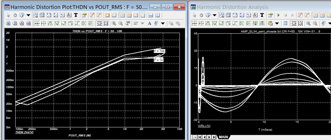

Quite an achievement. Looks good on a Spec A.
But any practical loud speaker simply throws that away.
Indeed. I was mainly after good damping factor and low-enough distortion, but the results of the circuit surprised me. The goal of the circuit was to get good damping factor without having the output transformer in the loop. It seems to work well.
At this point, I just want to get less than .01% just to say I did it.

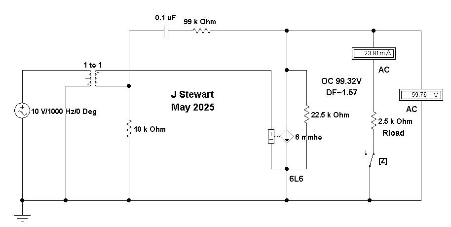

Olde Schade Circuit Simple Analysis
Reduced to SE, the basic circuit is symmetrical
And most DC parts pulled out.
With the NFB as is the DF calcs out to 1.57.
A real circuit would lose a bit of that as a result of OPT resistances.
With the common application of the day, loudspeaker in an open
back console the DF was a big improvement. But the bean counters
of the day would not normally approve. 🙂 🙂
