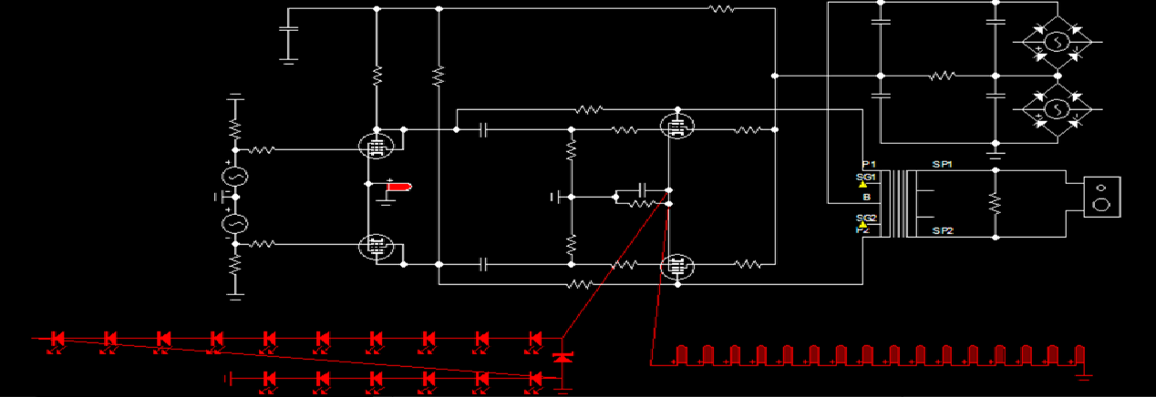

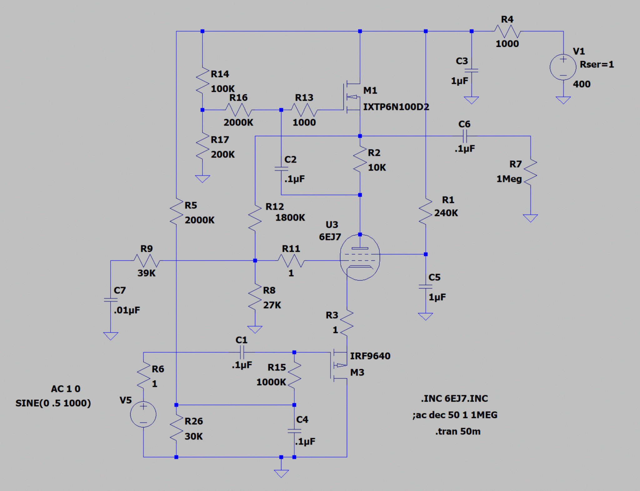

If you want to try to build it here is the .asc file. The coil on Gs is essential. Diodes D1 and D2 must be bridge rectifiers. The 27 1N4148 series is to be tried instead of the Rk 270ohm. However, some values should be adjusted based on the type of output transformer used, but it is the starting point.
I do not take responsibility for construction failure.

Have you built it?Here is the cct with 50% NFB.
In case have you check the performances?

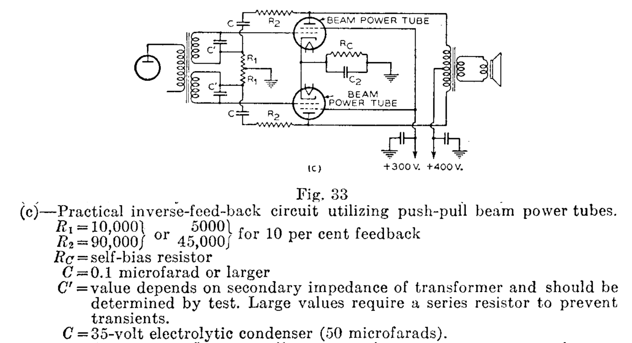

The idea behind this modification of the original circuit is very simple: by adjusting the ratio of the resistor values R 1 vs R 2 (R 1` vs R 2`) both first grids are brought to 0-Vdc potential, and in the same way the value of the local negative reaction from the anodes of the output lamps to the first grids is also adjusted at the same time.
ps, The advantage is that there are no more capacitors connected in series with resistors R 2, but there must be another negative voltage source, in this case it is a -300V source.
I noted now the value you put on circuit.The idea behind this modification of the original circuit
But I think is necessary to test on desk.
And seems to be little complicated including the trafo
Walter
If you mean a small driver transformer then IMHO it's not that complicated because no DC component flows through the secondary windings as long as such an output power stage operates in A1 or AB1 class, but as drawn there is certainly a DC component flowing on the primary side of the driver transformer.
No. Not this point , it is evident that no DC is presentyou mean a small driver transformer then IMHO it's not that complicated because no DC
I think the setting of a proper % of FB will be checked on desk to reach the best performance
AgreeDepending on the choice of the type of output beam power tetrode or power pentode of course various circuit values must be adjusted to optimal values, including the driver transformer, and of course everything here must be tested on a workbench with real elements.

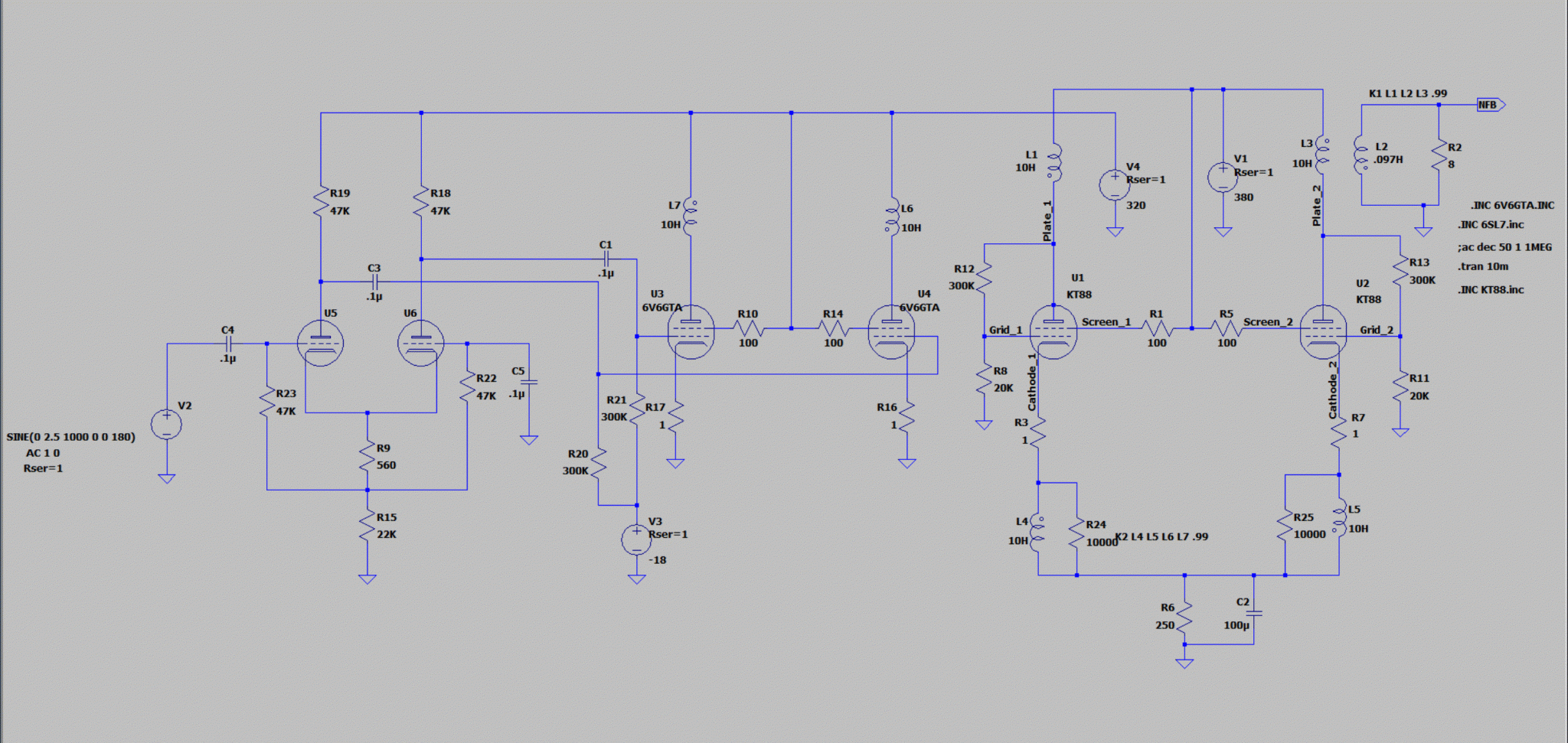

RCA in their handbook published very interesting push-pull amp schematic, with local feedback around output tubes, and around drivers: to anode and cathode of the driver. Perfect approach. I use something similar in my amps.This series Fdbk with an interstage xfmr seems to be mainly a conceptual scheme and not so practical. The classical amplifiers that did this shortened loop stuff just put a resistor from the output plate back to a driver stage cathode or grid (crossed). If that is too much N Fdbk, then just use a higher value resistor. Easier DC arrangement and easy drive capabilities, without frequency penalty or cost. .
Already manufactured an year ago before Schade publication.Used by Philco in their 38-116 receiver, 1938.
Circuit lifted from Beitmans 1926-1938 Most Often Needed Radio Diagrams.
The only circuit of this kind in a reference of 235.

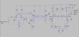

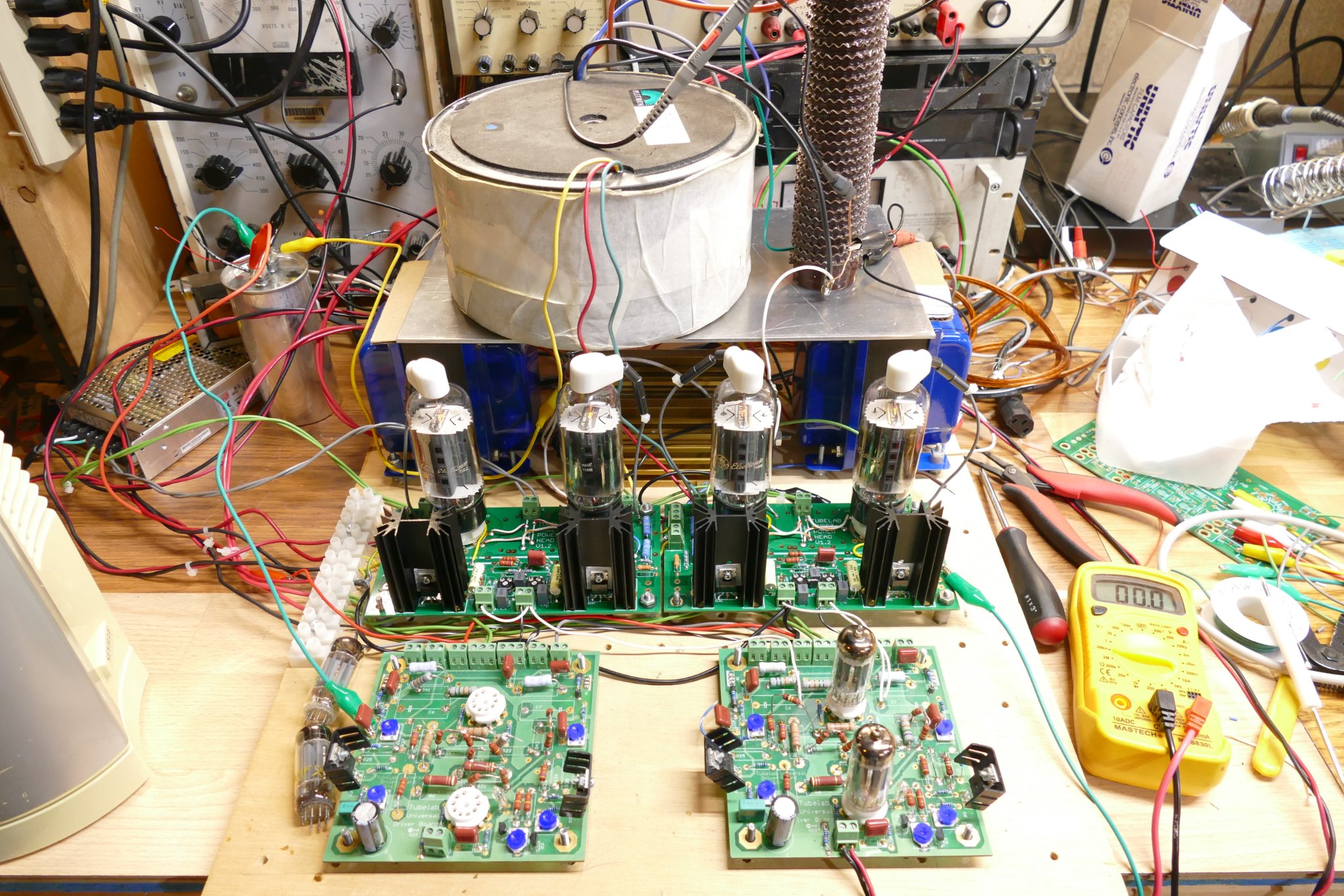

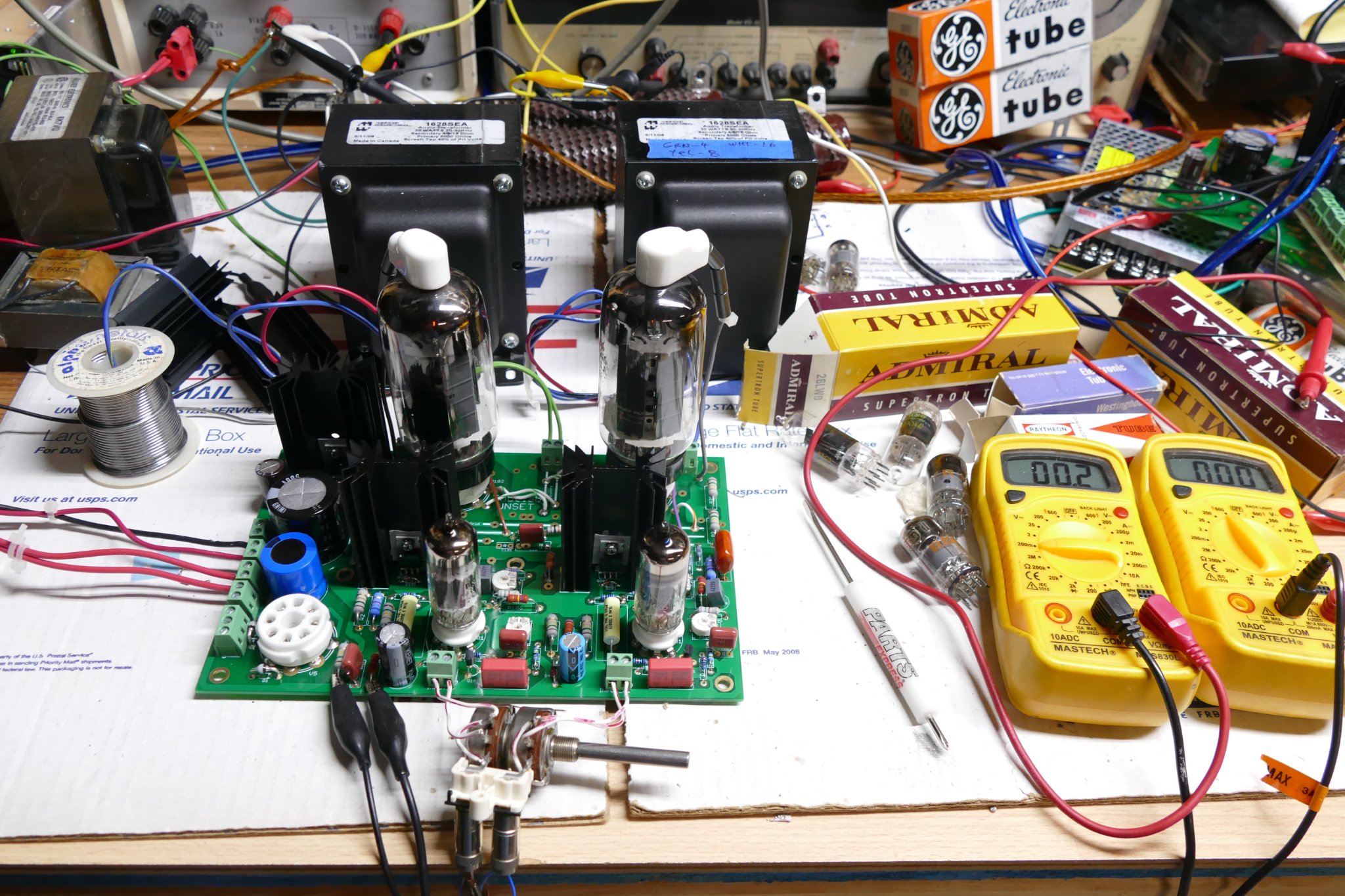

After I get the amp that I am working on completed, I am going to redesign my Unity-Coupled amp so that it consists of two stages only, a CCS-loaded pentode input stage and the output stage. I'll take feedback from the cathodes of the output tubes to the cathodes of the input tubes. It'll be my first nested feedback amp.RCA in their handbook published very interesting push-pull amp schematic, with local feedback around output tubes, and around drivers: to anode and cathode of the driver. Perfect approach. I use something similar in my amps.
My current project is also 2 stages and ~36dB of feedback from output tube plate to input tube cathode. It's a lot of feedback in one loop. I can't provoke any bad behavior but I don't know how much phase margin I have. Unity-gain bandwidth is ~17MHz, though, which scares me a bit. That was in bench testing and as I build I will have to adjust for the new phase response of the new layout.
But it is a lot of FB.My current project is also 2 stages and ~36dB of feedback
In my opinion the best way is to fix a minimum of performances in open loop then apply a low % of Fb to reach a reasonable value of THD, FFT spectrum, response.
