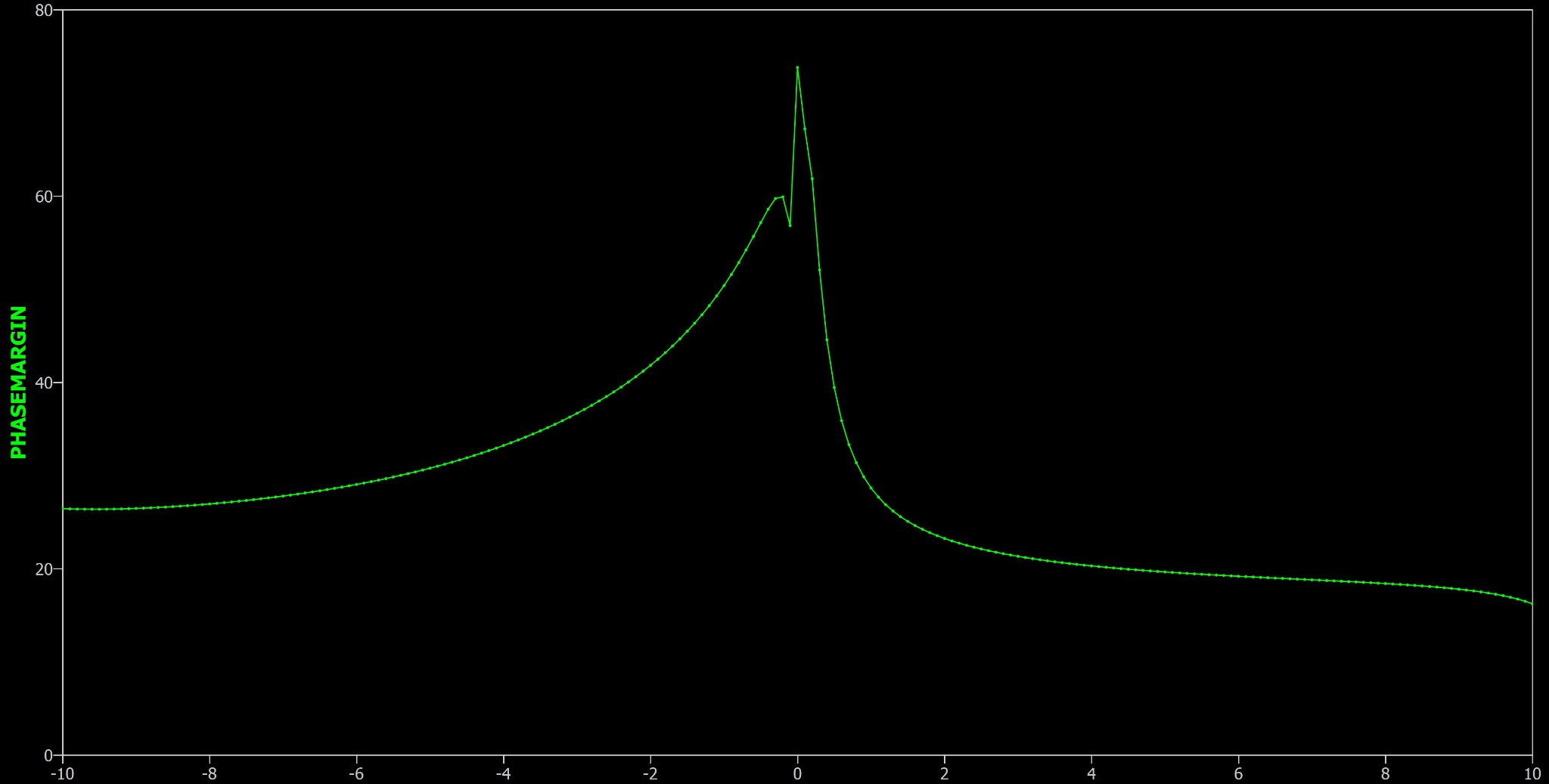

Actually, playing with the qspice demo files is fairly impressive. The Tian example allows for the stepping of many stability runs to yield a plot of the phase margin away from zero volts. Plotting -10v through 0v and continuing through +10v was very revealing. It ran 200 steps in 24 seconds. It reveals that the 164093-100w-ultimate-fidelity-amplifier has as little as 19 degrees of phase margin away from zero volts, whereas a Tian run at zero volts shows an apparent 73 degrees of phase margin for the amplifier. This is the circuit found at this link here at diyaudio
https://www.diyaudio.com/forums/solid-state/164093-100w-ultimate-fidelity-amplifier.html
See the attached plot of the phase margin at voltages from -10 to +10 volts as the bias point.
The demo duplicates the circuit. I wouldn't want to do it that way as I'd rather run the Tian / Weideman runs using a probe subcircuit which is stepped. I believe I can still do that as with LTspice.
