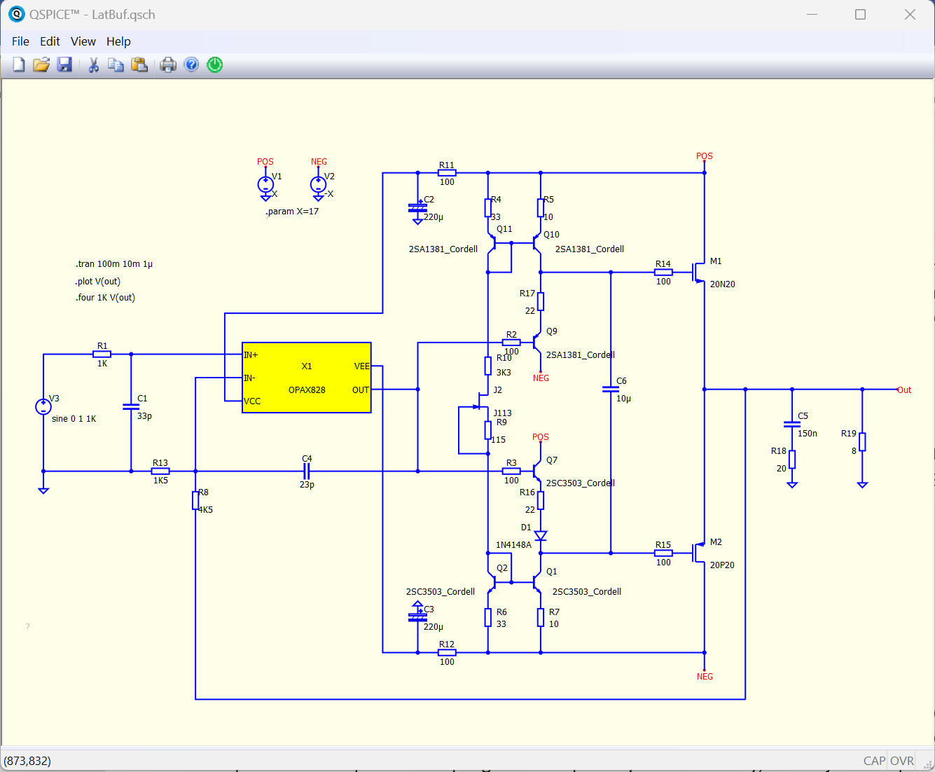

Just got my email and DLed and ran it, went to Open Demo, saw and opened AudioAmp.qsch and LOLed at the URL across the top.
Today, I took the plunge and tried QSPCE. First half an hour was frustrating, but after that point it was really an excellent experience in drawing new schematic. It is incomparably easier, better and faster than drawing with LTSpice. Adding any model through directive, builds symbol and embeds model into the file. So, sending your simulation schematics to someone else avoids any problem with missing models.
There is probably an option to add models to the system libraries, but I’m only several hours into QSPICE.
However, I was struck with the first bug found. I can run all demo simulations just fine, but trying to run my file makes QSPICE to complain that it can’t find file ‘none’. Reported that to QSPICE author.
My impression is that we can expect great things from this simulator.

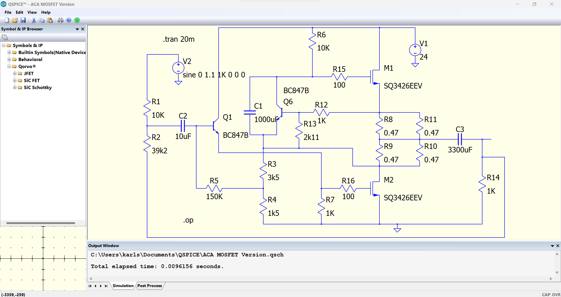

I've been having a play for a while now but its a steep learning curve. The interface for drawing the schematics is great though.
Here's the ACA. The folder has a bjt version as well:
(I will ask Jason if he can add .qsch files to the list of accepted file types)
Interesting, I was able to run ACA simulation but my file is still no-go and I can’t find why Qspice complains that there is no file to run simulation. My files are in the folder made by Qspice install procedure – Documents/QSPICE/.
Not really following you on that one. Clicking any of the .qsch files you have should open QSpice.

All files open without any problem. It is that Qspice complains, on already opened file when I press green ‘Run’ (simulation) button that there is no file or “Could not open file "none".Not really following you on that one. Clicking any of the .qsch files you have should open QSpice.
Edit: just found the cause. It was an opamp imported model causing the problem. I’ll have to try again.
If you want to make that rectangle into a "real" opamp symbol, this video will show you how:Today, I took the plunge and tried QSPCE. First half an hour was frustrating, but after that point it was really an excellent experience in drawing new schematic. It is incomparably easier, better and faster than drawing with LTSpice. Adding any model through directive, builds symbol and embeds model into the file. So, sending your simulation schematics to someone else avoids any problem with missing models.
It is a Qspice problem. The same TI operational amplifier model imports without any issues to LTSpice and simulation runs well.So that was not a problem of QSPICE at all.
