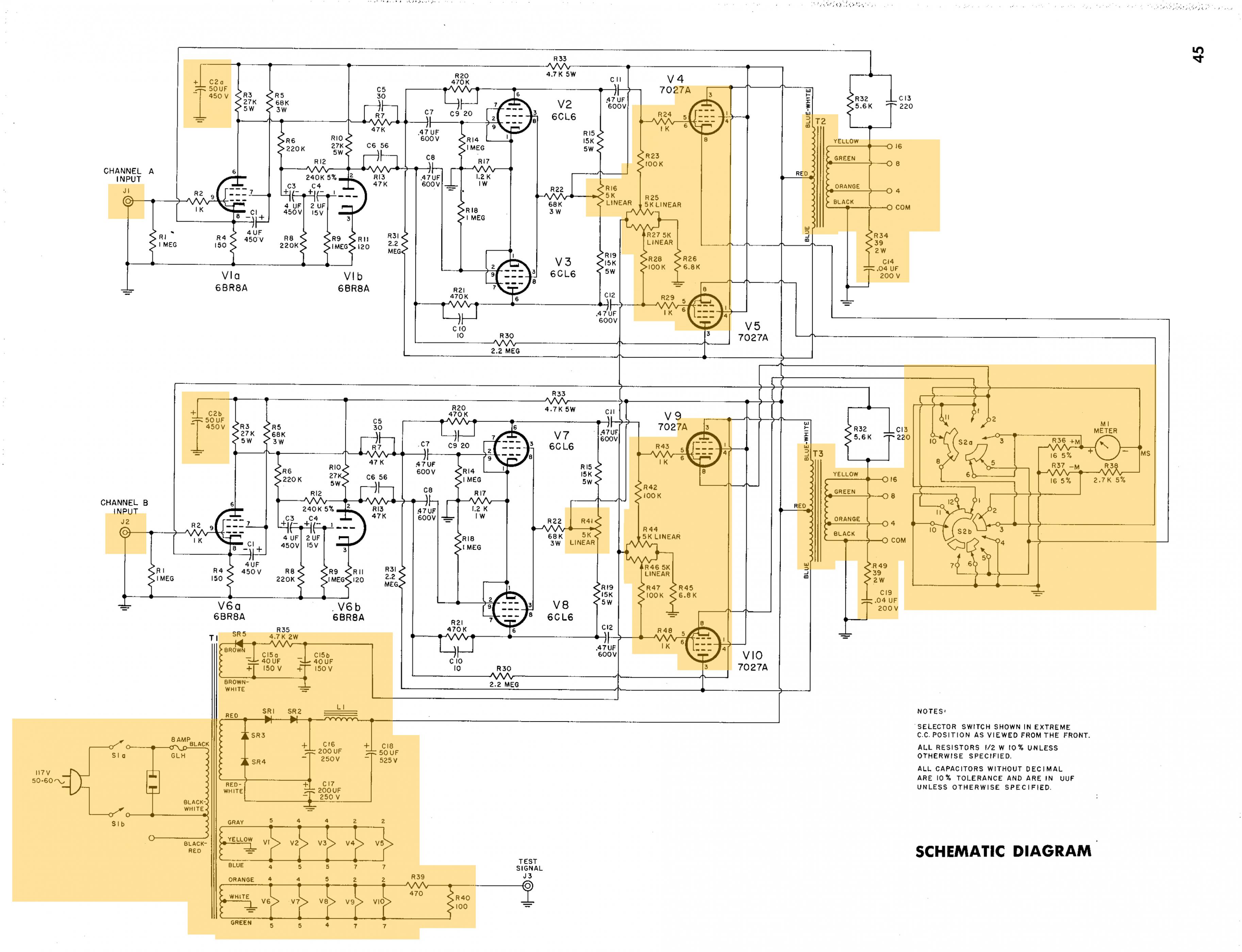

I'd like to see a PC mono-block board offered along the lines of the Lafayette KT-550, but for Sweep tubes. (pic below)
Probably fix that splitter. Leave an option for "shunt Schading" the outputs too.

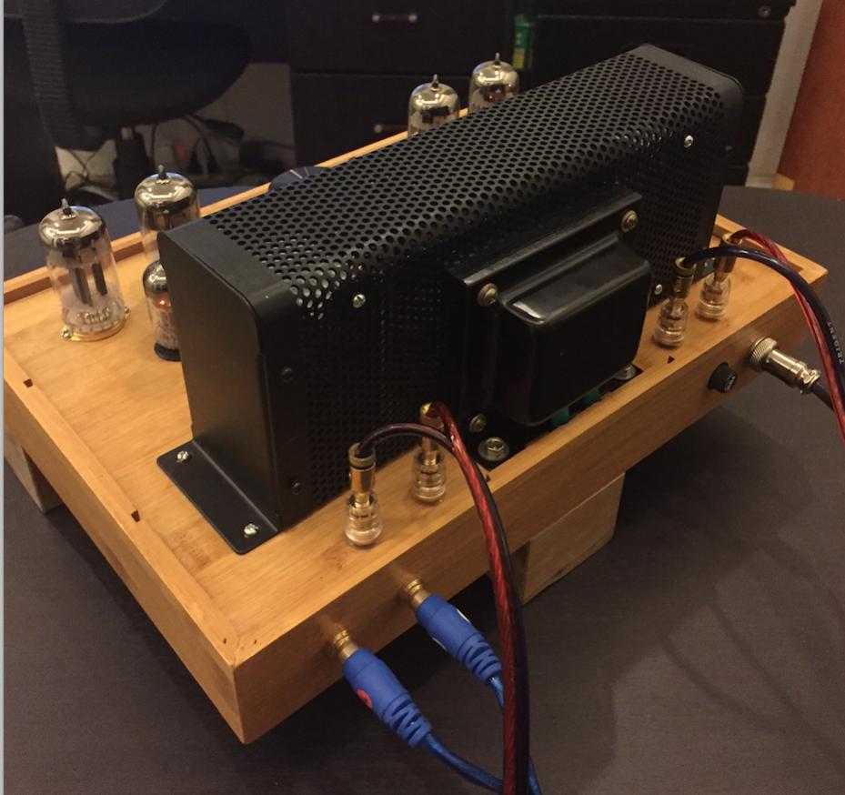

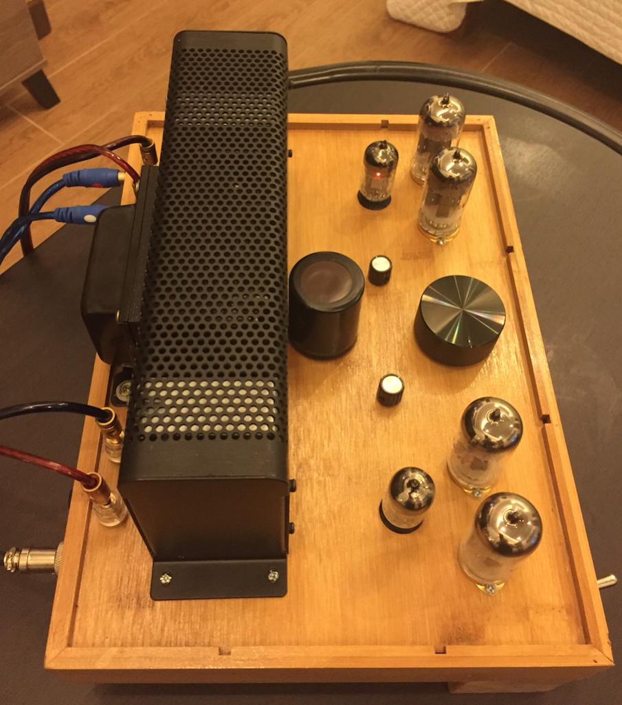

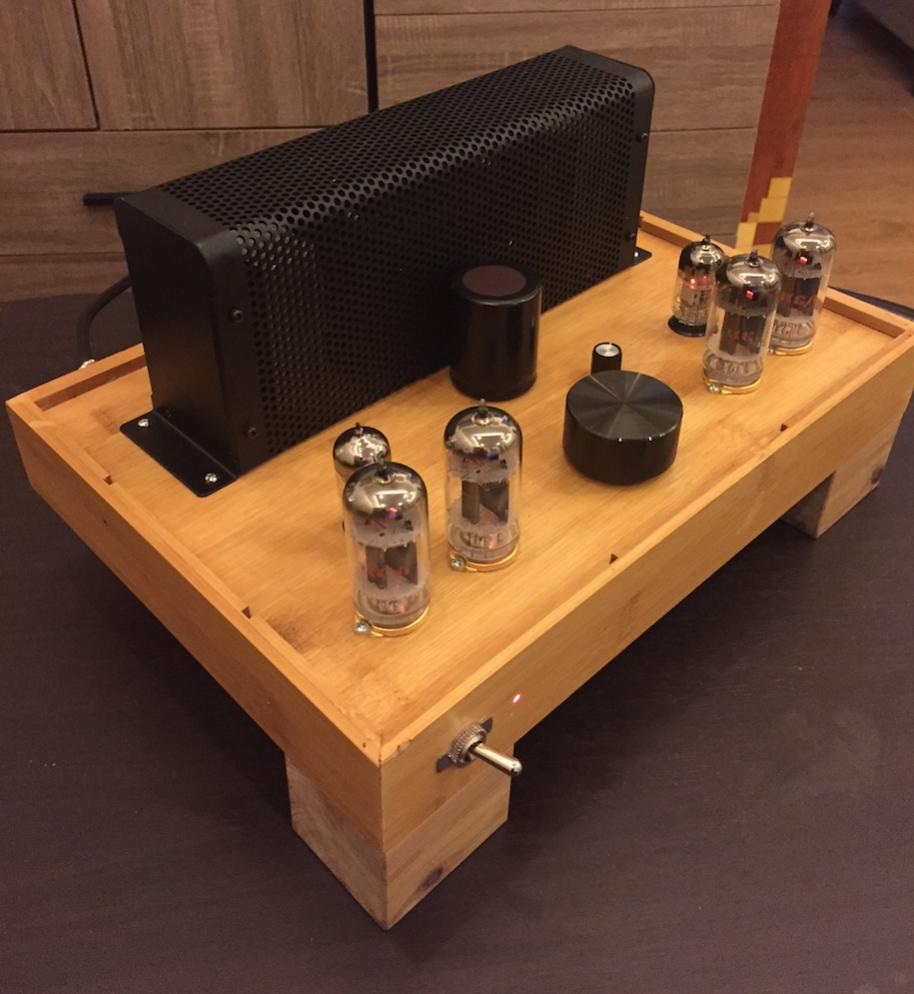

Finally finish my last build television vertical tube 10EW7 parallel amp with 6N2P for the tone stack, bamboo chassis. Just made all test and I am absolutely happy with the result, 6.7 watts x channel, separate power supply.
How it sound? Crispy, clear, sound stage incredible, open wide vocals, even at max volume where the scope reveal a clear distortion is very difficult to ear it.
I really push to the limit the second triode of the 10EW7 using the 10w plate dissipation to limit but the tube handle it very well, get just very hot but no other bad sign, now tested with all kind of music for several hours and I am really surprised by the quality of the sound...all the best to everybody

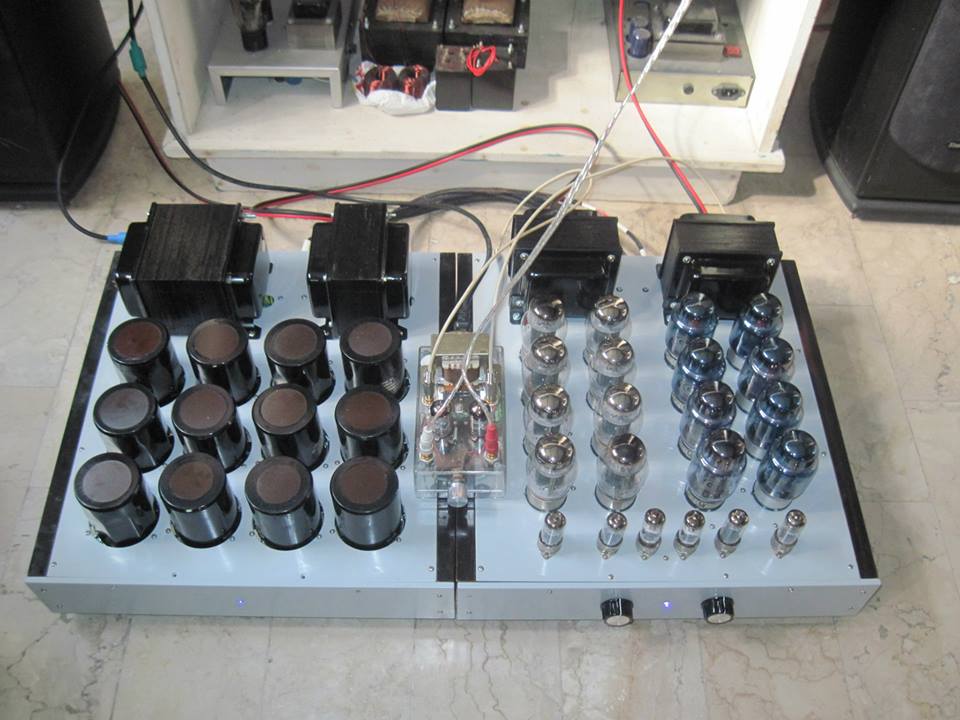

Not TV tubes though. KT88 triode push pull, AC coupled to a 6n6p LTP with tail CCS. Zero global NFB. Plate to plate with 100k resistors didn't do anything. I wonder how the schematic at post #1154 works with 300k on 6FY7 plates... I had to go down to 47k to see a subtle effect on low frequency extension.
So, maybe this makes sense?
Yes, sure for true "Schade"; is a potential divider local feedback.
With triode driver without cathode degeneration, I interpret being a normal voltage feedback with potential divider, one arm being the triode rp. Since triode distorts (and all active devices distorts), including its rp, we have all efects that smoking-amp has mentioned.
Series resistor with triode driver will add a linear term to that, but essentially is different than pentode (CCS) driver.
Interesting will be to test the cascode option. Distorts different than pentode stage, so perhaps other form of compensation/interatcion with output stage is possible (if some benefit is possible)... or not
And since 6n6p rp is very low, so it has to be the feedback resistor too? But then becomes a heavy load.

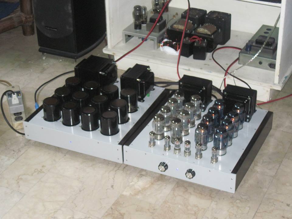

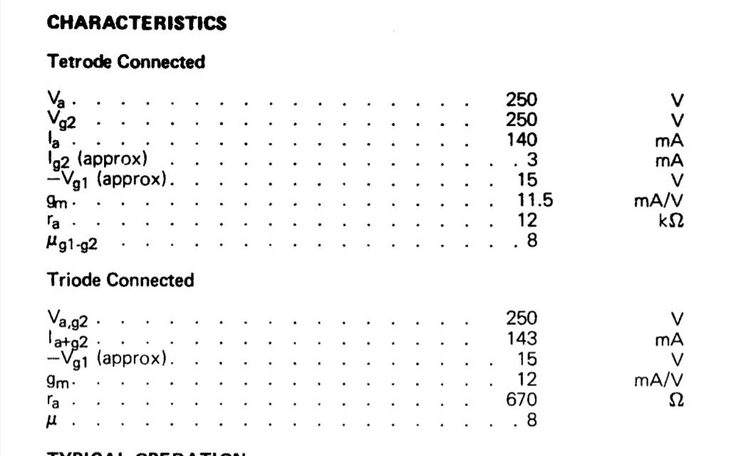

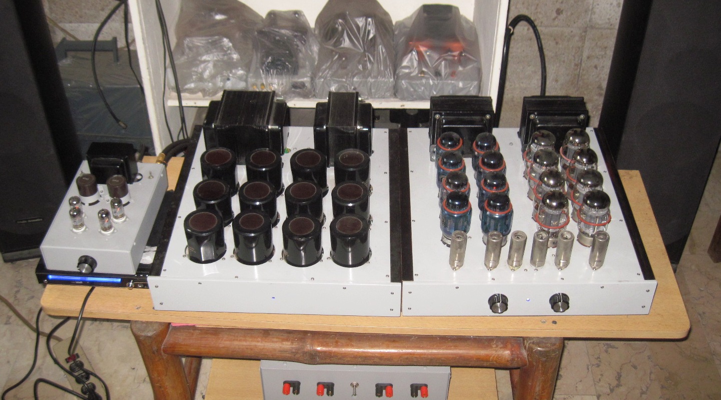

i have done a kt88 PPP triode mode many years ago.....with several of the kt88's in parallel, the combine plate resistance indeed becomes very low so that gnfb is not needed anymore...
Wow, what a beast.
Is this a real PPP (McIntosh style unity coupled) or what they nowdays call PPP?
Wow, what a beast.
PPP...no gnfb...not unity coupled, and yes from bob carver silver 7...
Erm, why? I'd not expect tubes' non-linearities to be cancelled just by paralleling severals of them 😕.i have done a kt88 PPP triode mode many years ago.....with several of the kt88's in parallel, the combine plate resistance indeed becomes very low so that gnfb is not needed anymore...

i know the issues paralleling tubes, if i had my way i would have just chosen a pair that can do the job and be done with it..
i am a fan of single pair of tubes to deliver power, like a pair of 4D32 for 120 watts, or a pair of QE08-200 for 300 watts....
but i was asked to work with the parts given to me, yes the owner game me all the parts and asked me, build me an amp out of all these parts...
and so build the amp i did...
there are other considerations, like if you triode wired a pentode, then plate resistance is lowered significantly, and getting then paralleled even more so...
and the biggest benefit that appeals to a lot of folks, you do not need gnfb at all, that i discovered in this amp build, while i did make a provision for that, after i heard the amp the first time, i knew i never had to connect the gnfb wire at all...
a look at the kt88 data sheets illustrated this...
