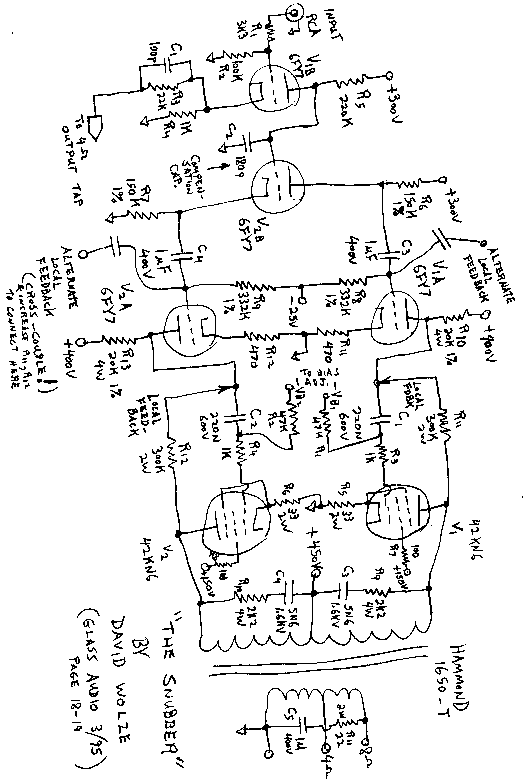

An easier to build "shunt Schade" Sweep amplifier (could use _LW6 tubes):

For a different OT impedance, it just means using a different B+ for the output stage. 5K is a little high for a _LW6 however, more like 1.9K to 2.4K or so.
A note on those "alternative local Fdbks" drawn in on the David Wolze "Snubber" schematic above, in post # 1154 , they won't work with a Concertina splitter, (as just found out recently in another thread!). Have to change the input stage to an LTP splitter (preferably with pentodes) to get equal output impedances to drive the low Z N Fdbks.
