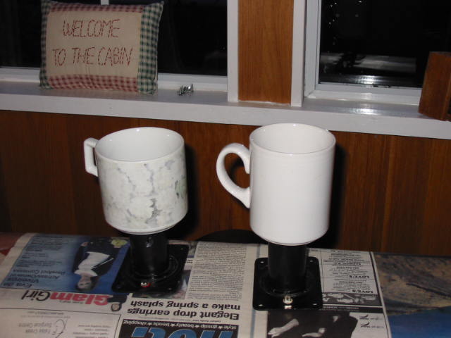

Here are the ports glued to the tweeter face plates.
Sorry sreten,
Had to do it for effect. Will likely change things after the drivers get hear (sic).
Cal

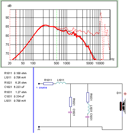

nice going Matt,
but that looks first order to me, which is fine
but I don't think the zobel should be needed.
Parallel notch filter won't work well with 2nd order
parallel filter, series filter is needed here.
Your notch filter looks a little narrow ?
🙂 sreten.
🙂 sreten.

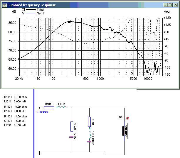

Well it is indeed a 2nd order i loaded up LSP to check the target I mean.
I suppose yes the C and the R in parallel will work as a zobel to a certain extent. But I have found that adding a small amount of resistance in series with the shunt cap in a lowpass adds a bit more "pull" to the filter removing small peaks in the xover region.
Eitherway why wont the parallel filter work? it works great in the simulation, removing the notch worsens the response. Yes you are right in saying the notch i a little narrow I have now altered the xover a little.
Gimme your opinion of the new filter, I have also sorted out the component values and got them to match standard values available.
Right the filter is 2nd order electrical! but with a resistor added to provide response shaping. This does not act a a zobel and the impedance shows this. Then there is the notch filter.
I can try for the notch filter in series with the driver if you think it is necessary, do 2nd order electrical and parallel not work?
Hi Matt,
A 6R to 8R damping resistor moves it very near to a
Zobel, even if the the capacitor is not a zobel value.
Generally (without the damping resistor) a shunt
RLC network does not work well in parallel with
the shunt capacitor, but as you've added a series
resistor to the capacitor things are different.
But I will point out due to the series resistor final
roll-off is 6dB/octave, its a first order with response
shaping not second order.
A parallel shunt RLC works well with odd order parallel
crossovers, which due to your series R with the capacitor
is what this is.
Series notch filters are needed for even order parallel
networks, parallel notch filters do not work well.
Still in terms of keeping it simple parallel first order on
the bass unit (with shunt RLC) and second order on
the treble sounds sensible to me.
If things look better to you with the added parallel RC
then fine, your helping and I certainly don't want you
to think I don't appreciate this.
🙂 sreten.

Oh im certainly not thinking that you dont appreciate my help im also learning too and just asking questions about things to further my understanding.
This seems to fit in with my latest speaker which used a RCL on a tweeter with a 2nd order highpass, the RCL was used to tame a peak in the trebble response but opon measuring the finished speaker the peak was still there, even though it was not as bad as if the notch was removed. I had thought it could have been to do with component tollerance, a small change in the capacitor value does indeed alter the notch frequency quite cosiderably. So I had thought it was that, sounds like it being 2nd order could have also influenced the final result too.
Just out of interest how do you use a parallel notch filter? Im assuming you mean the electrical configuration is the RLC in parallel with each other and then placed in series with the driver, before the filter?
I've tried numerous attempts at getting one of these to work altering values by hand, letting the LSPcad wizard have a go and letting the system optomiser run, but nothing seems to be able to work im removing the res peak. Is there some kind of special way of using these?

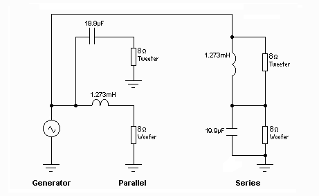

A series notch filter (all components in parallel) needs a fairly
high resistance to work well. They are not cost effective as
the the components carry the full signal, and generally are
avoided if a parallel RLC can be substituted.
Generally for resonance suppression above crossover a parallel
RLC suits odd order parallel c/o's and even order series c/o's.
🙂 sreten.

Parts arrived this morning, so this afternoon I kicked off a little early and started to assemble. Well, the holes didn't line up with the woofer, so I had to modify the baskets. Then she wouldn't fit properly so I had to notch the lip at the top of the cabinet. Then I went down to Home Depot, got some brackets for the tweeters and well, the holes didn't line up so I re-drilled those and bolted them on. Drilled a hole for the wires and well, I couldn't fit the wires through without squashing the connectors. I didn't want a great big hole in the top of the cabinets, so I flattened and then straightened them back out.
I have the original XO being used with no resistors on the tweeter.
Now about those ports:
Open, they sound like absolute (insert bad word here)
Stick a cork in them and these little things made me smile. It doesn't really look like a small A7 like I might have hoped, but so what. They sound just great!
Here's a pic at this stage,
Cal
Cal
Ok, a little correction. I had hooked them up to the test leads and I forgot I was running it through the 1.5mH cap soldered to the driver. I started to actually listen to a couple of songs and where is the midrange? Oops.
So now they are running through the original XO with a 5.6 ohm in series and a 7.5 ohm in parallel after that. Moocho Goodo.
I just listened to Bruce Cockburn at about 10 watts and I was impressed.
Just need some corks to fill the port holes. Duct tape just doesn't cut it/😉
Cal
