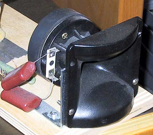

My next thought is to mount a woofer in the box, use the existing tweeter face plate to mount a port tube and then mount a very small horn tweeter to the bottom (which now becomes the top) of the cabinet and make a little version of my Altec A7's. I looked at PE stuff but I can't see anything small enough. Like this:
horn tweeter
Unfortunately, the tweeter horn has to be 4 1/2" or less wide.
I can always run resistors to tone it down.
Any suggestions?
Cal

Cal Weldon said:Oh oh, things are getting strange around here.
horn tweeter
Any suggestions?
Cal
IMO you can't reflex small speakers, they just fart on low bass,
the port sizes you need to use render them next to useless,
due to velocity induced "blocking".
Try modelling driver excursion limited power handling in WinISDpro
(freeware) and you'll rapidly come to the same conclusion.
Still think the ali bass unit and Sonance is your best bet.
You could try posting a request for confirmation of the crossover.
🙂 sreten.
