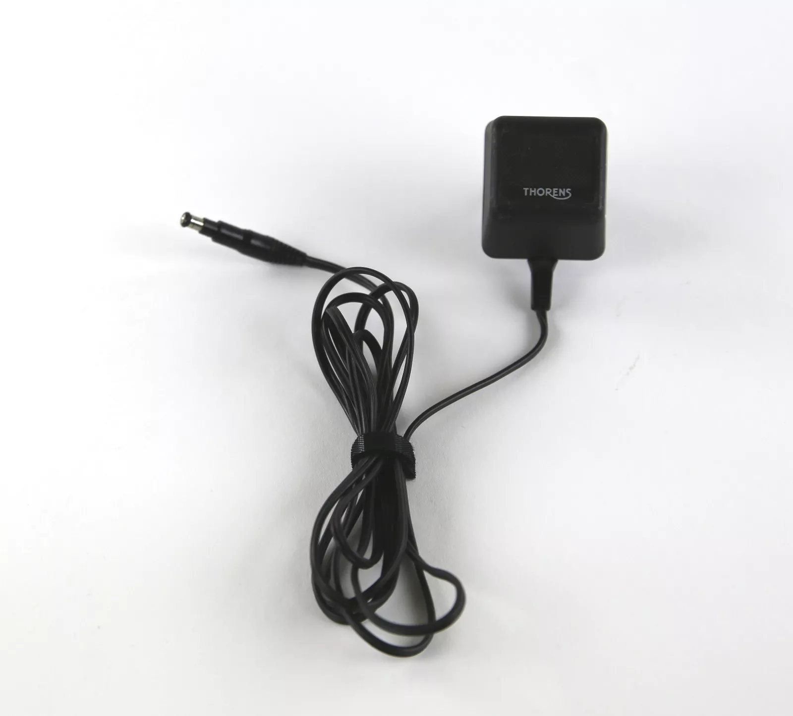

There are different power supply versions over the world according this service manual for TD316-318-320-321 and Phantasie: - go to
https://archives.doctsf.com/documents/afficher_document.php?num_doc=106001&num_fic=1
(on page 14)
discovered under
https://archives.doctsf.com/documents/index.php?num_serie=56&marque=1296
1) order code 4 150 083 (Euro 220V 50Hz)
2) order code 4 150 078 (Japan 95V, 50/60Hz)
3) order code 4 150 077 (CSA 120V, 60Hz - maybe a miss print - it must actually be "USA" for the United States - maybe not, if CSA stands for Canadian Standards Association - so I think)
4) order code 4 150 064 (UK 240V 50Hz)

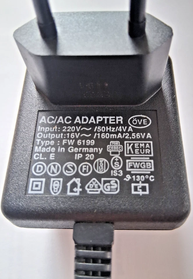

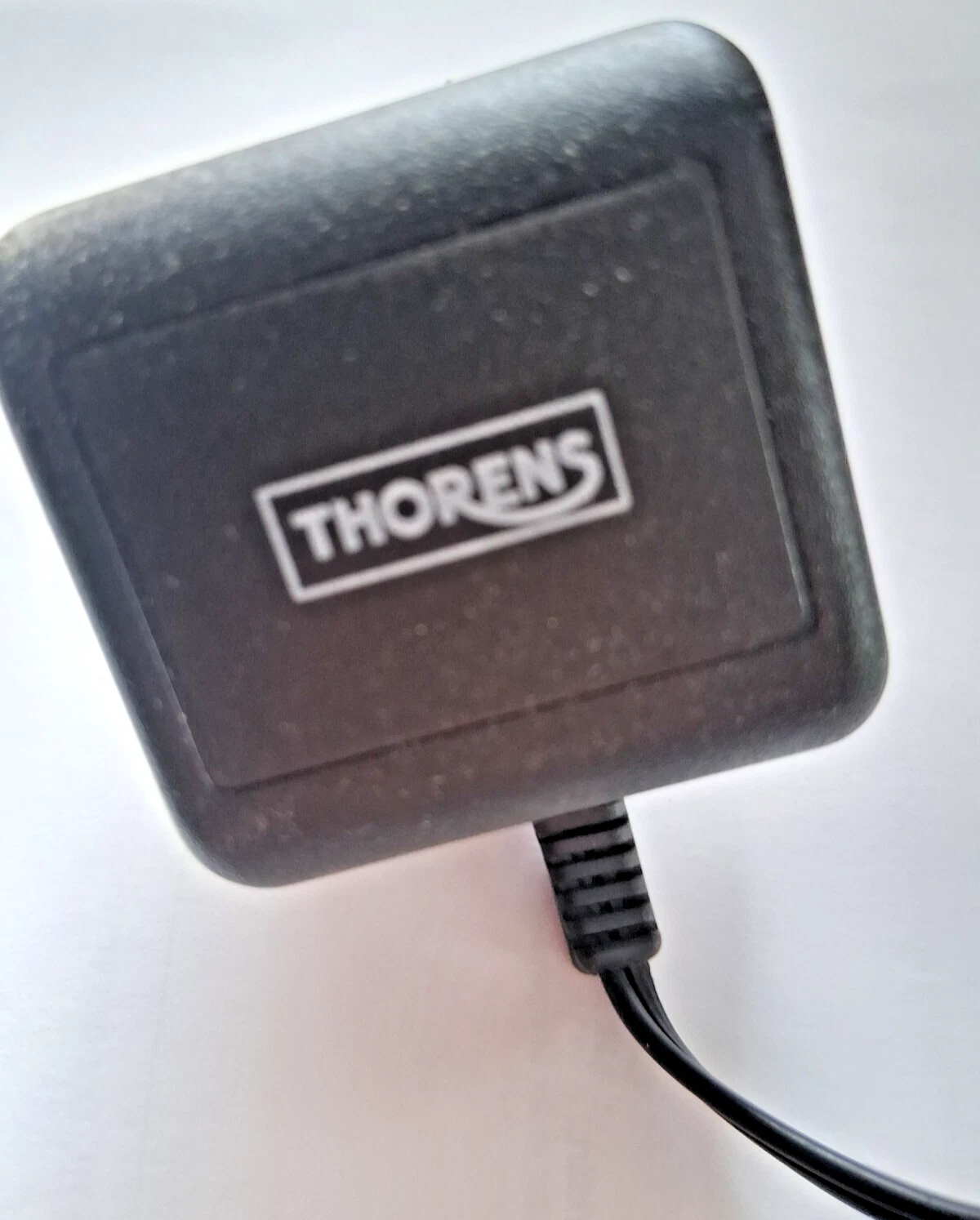

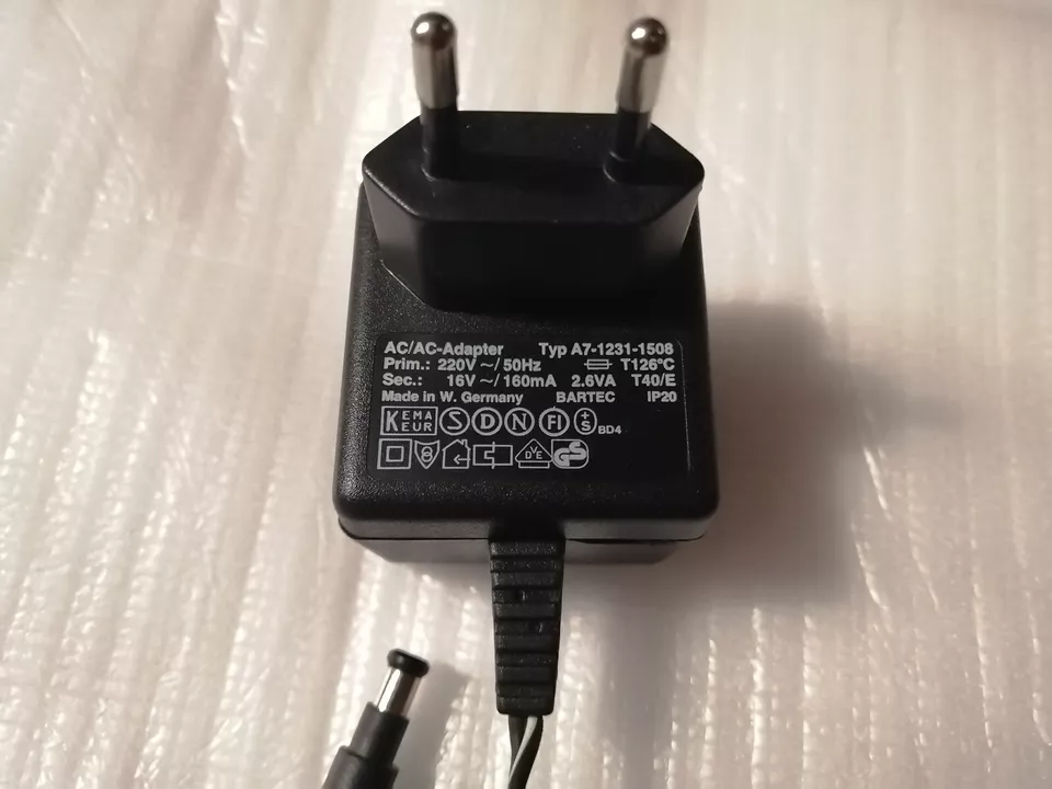

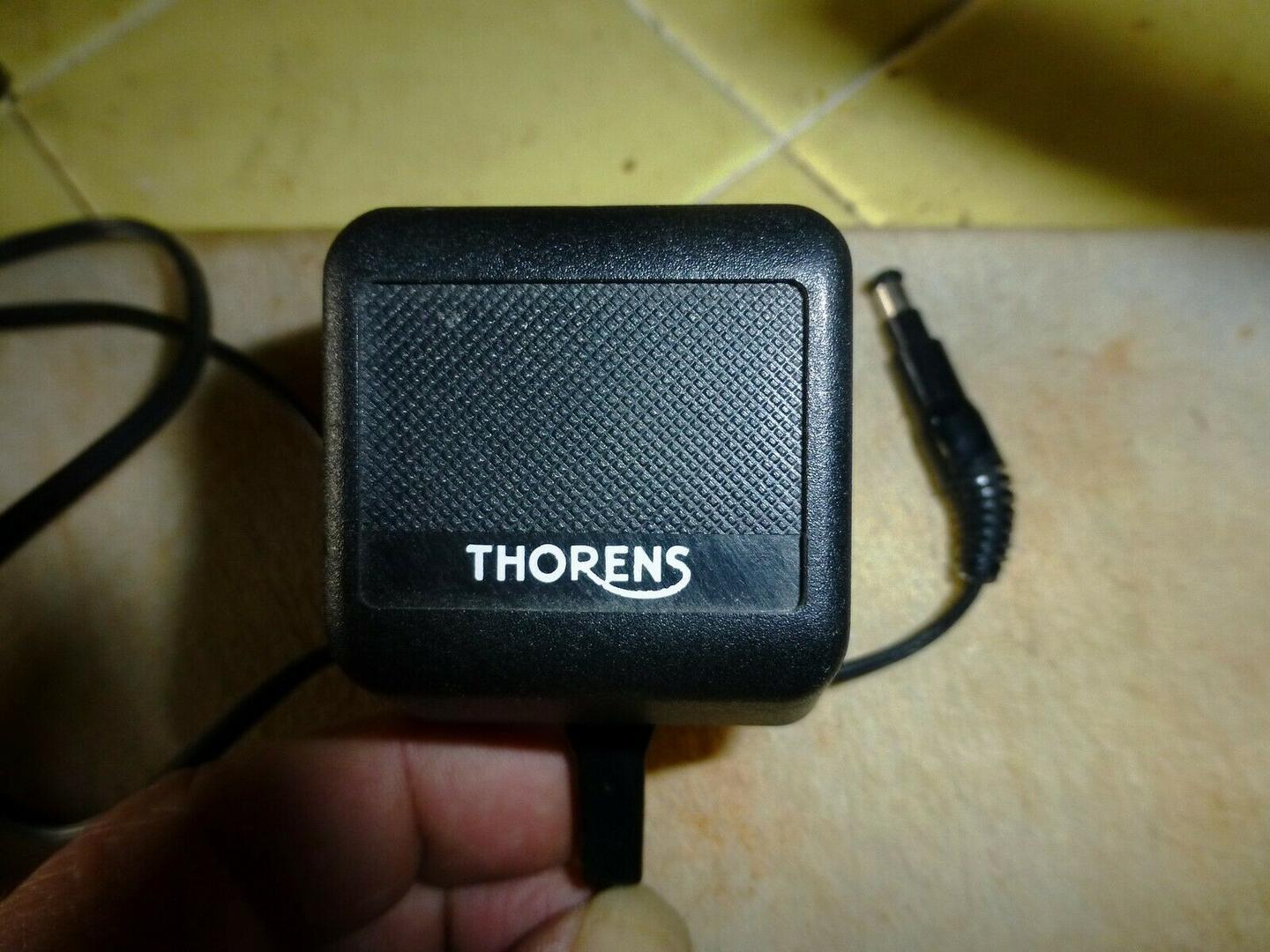

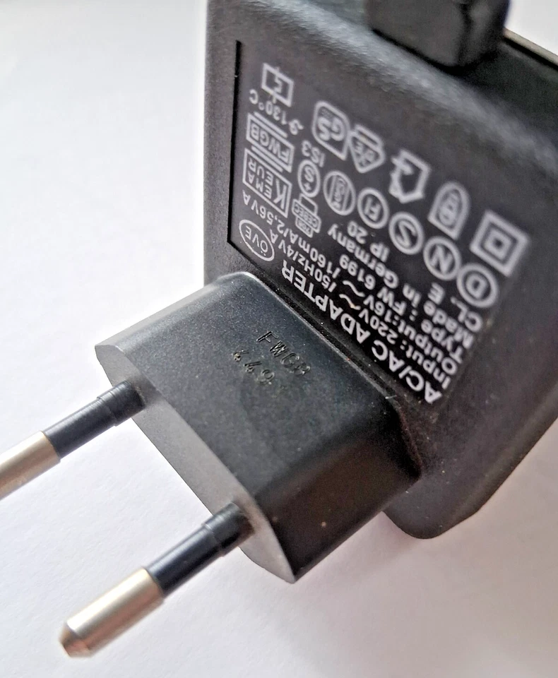

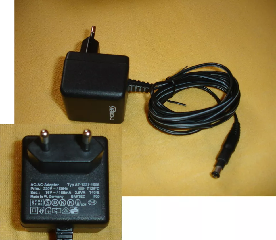

Even on the genuine Thorens versions of these plug-in power supplies are not to read this Thorens order code (at least concerning the European versions) - but instead the Thorens order code this:
1) FRIWO (German Brand for power supplies) Type "FW6199", 16V~/160mA (actually it must be "Series FW6199", because under this series were many other voltages available)
2) BARTEC (also German Brand for power supplies) Typ "A7-1231-1508", 16V~/160mA
All this versions for 220V~ input.

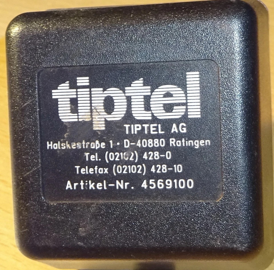

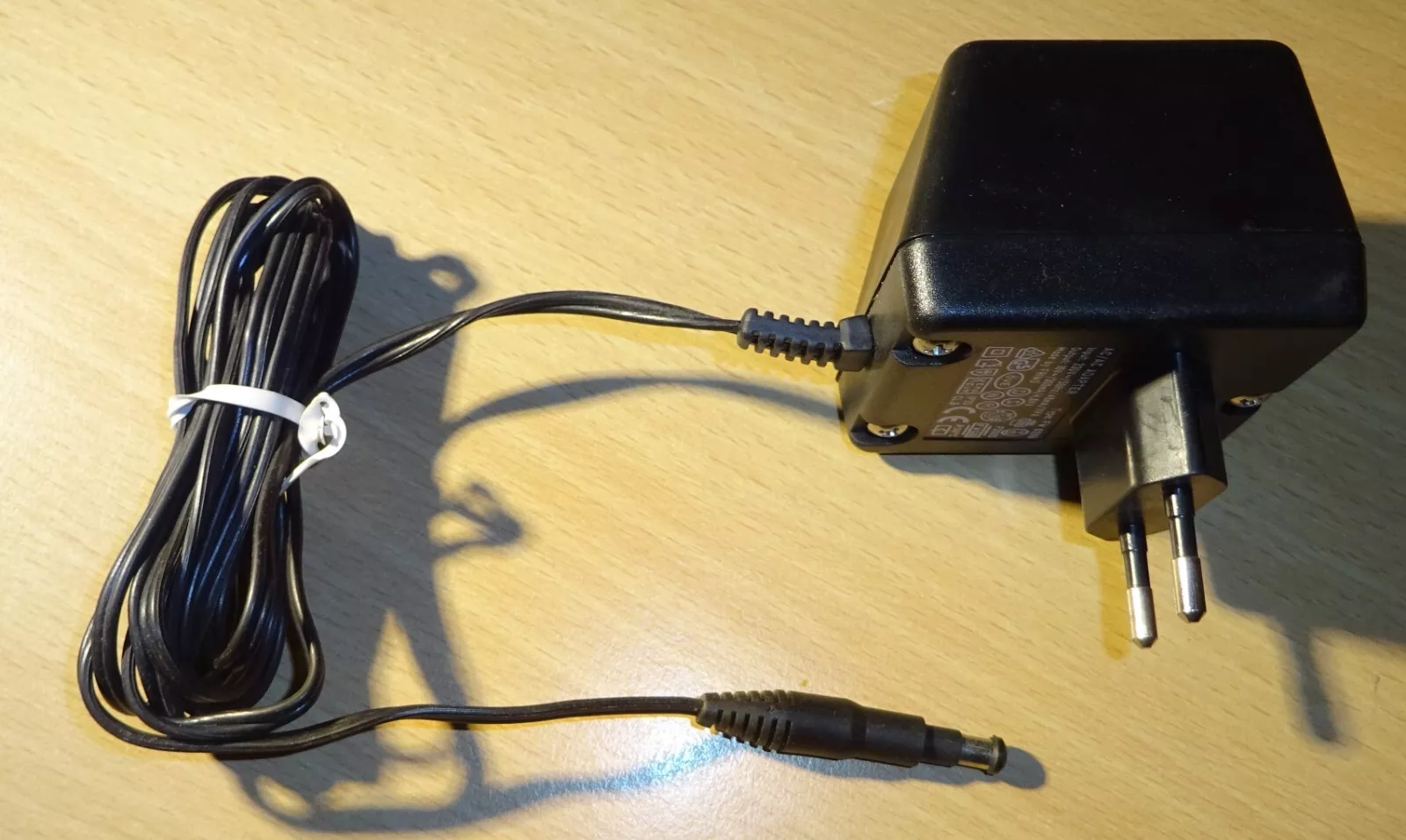

Because a friend of me want to have no cheap copies from China and no SMPS version as replacement I tried to take a closer look at this versions.
I discovered thereby that even the 50Hz transformer versions manufactured in Germany are sealed rather than screwed together (go to image 1-6). This has the disadvantage that if a thermal fuse blows or there are contact problems, there is no way to repair it without violating safety regulations.

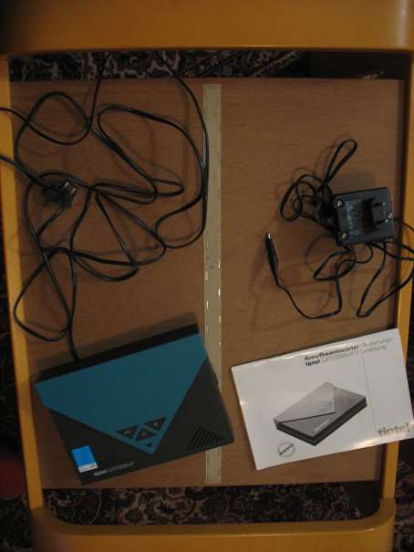

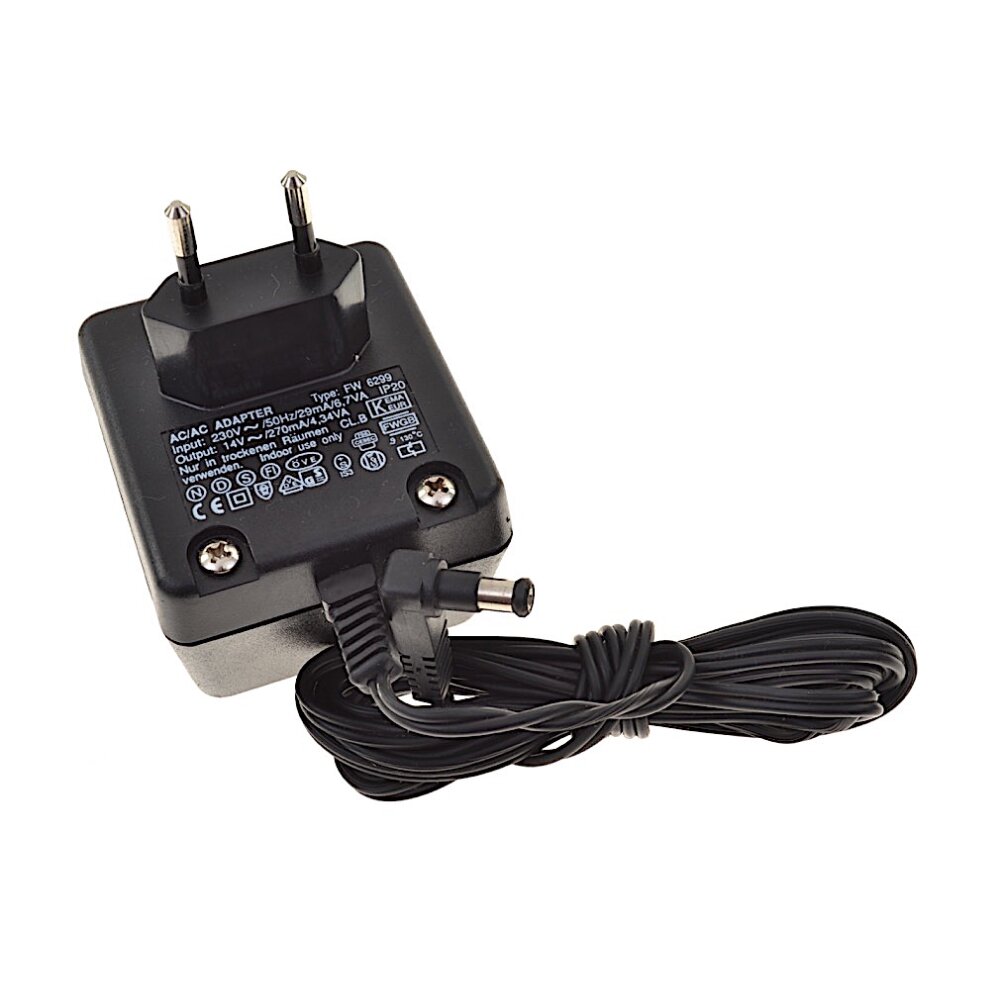

By chance I noticed that there is also a screwed version from FRIWO (series FW6299 order code 4569100) with the same voltage, but with a higher maximum current delivery capacity, which is more of an advantage but in any case not a disadvantage (made for TIPTEL "LETTERA-F")
However, the different voltages in stopped mode (i. e. without load) must be taken into account on TP1 - see service manual for TD316-318-320-321 on page 9 and schematic diagram on page 10+12. As long the main capacitor C101 (1000/25) behind the rectifier unit GR101 was replace by a higher voltage (I recommend for C101 in general a 63V version include a bypass WIMA MKS between 0µ33 and 0µ56 resp. 330n-560n) there are no issues to expected.
OTOH - due the fact, that the input voltage of the FW6299 version is 230V~ (instead 220V~ of the FW6199 version) go to image 7-11.
the deviations in voltage to the mentioned values in the service manual are probably not too great.

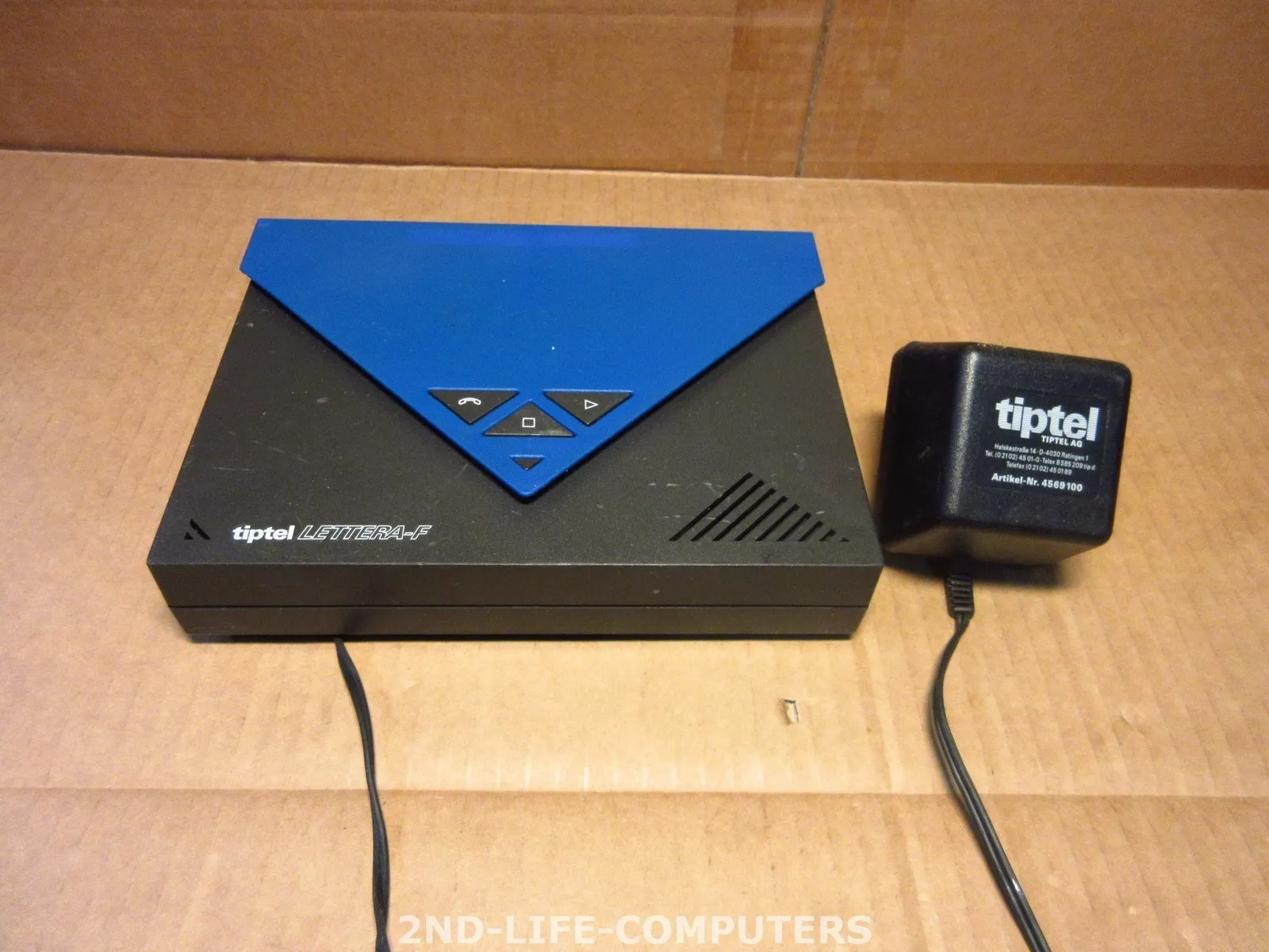

I ordered one for him in a 16V~ version from screwed FW6299 series in used condition and he had good experiences with it (same version as in the attached images). Actually this plug-in power supply version is original made for this answering machine: Tiptel model "LETTERA-F" - go to
https://www.lipinski-telekom.de/fil...06-21_Anrufbeantworter_Tiptel_LETTERA_F_V.pdf

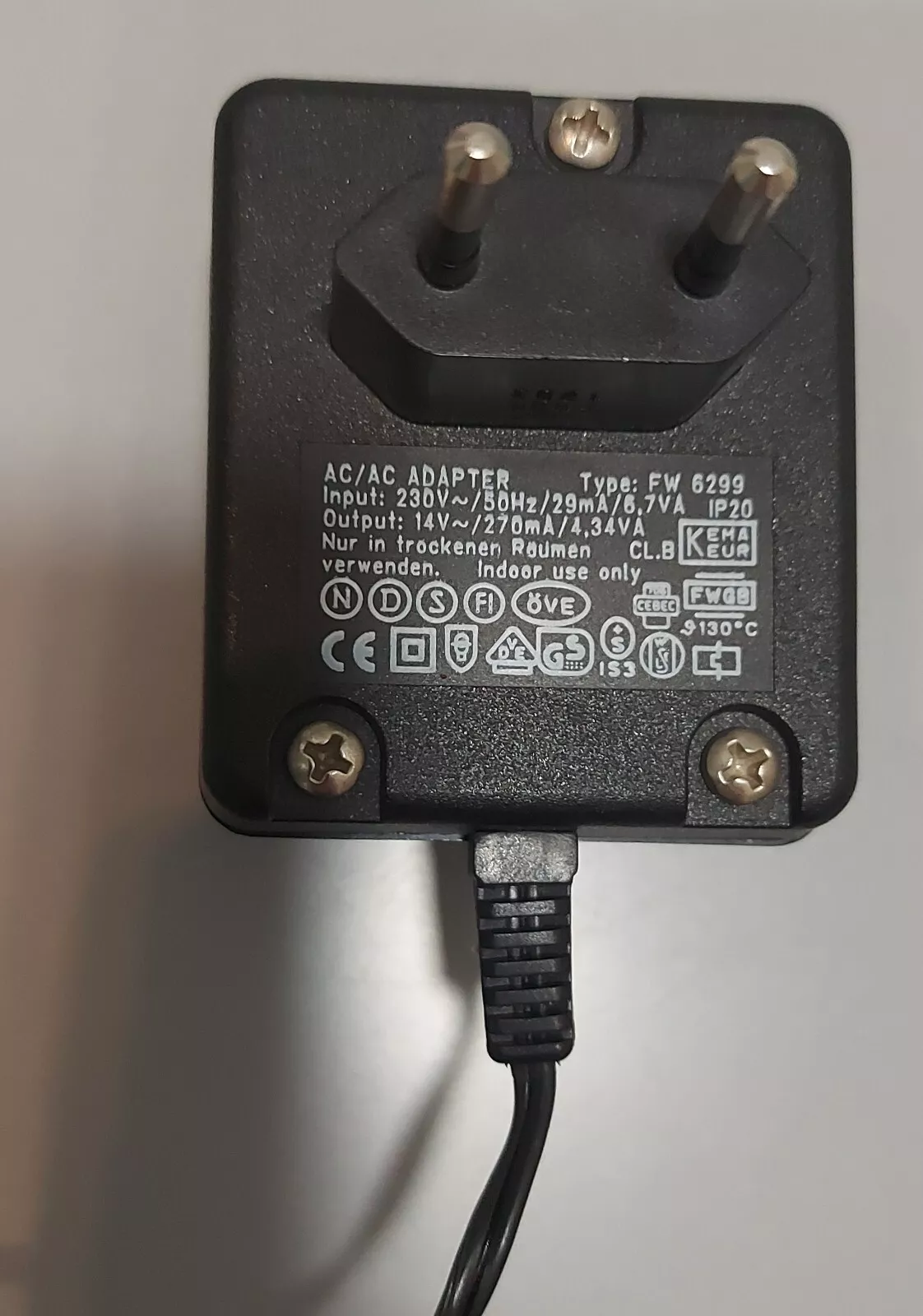

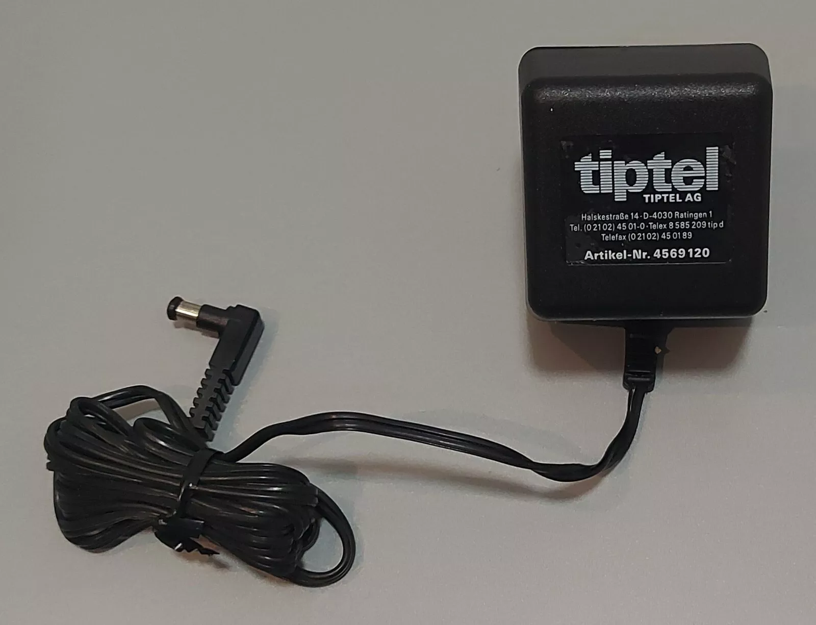

Due the fact, that there are offers of the complete set-up are cheaper, it is sometimes better to looking under this naming instead under FW6299 and 16V~.
Next time I will check a 14V~ version (also series FW6299 order code 4569120, made for Tiptel 270 cord phone go to image No 12-15) and after this I call here the measured voltage values on a TD320.

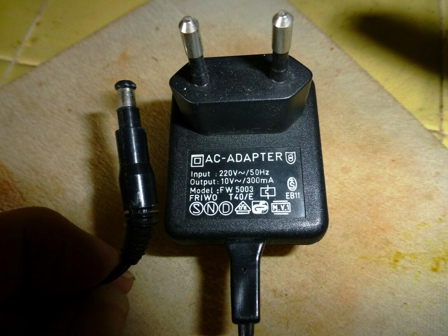

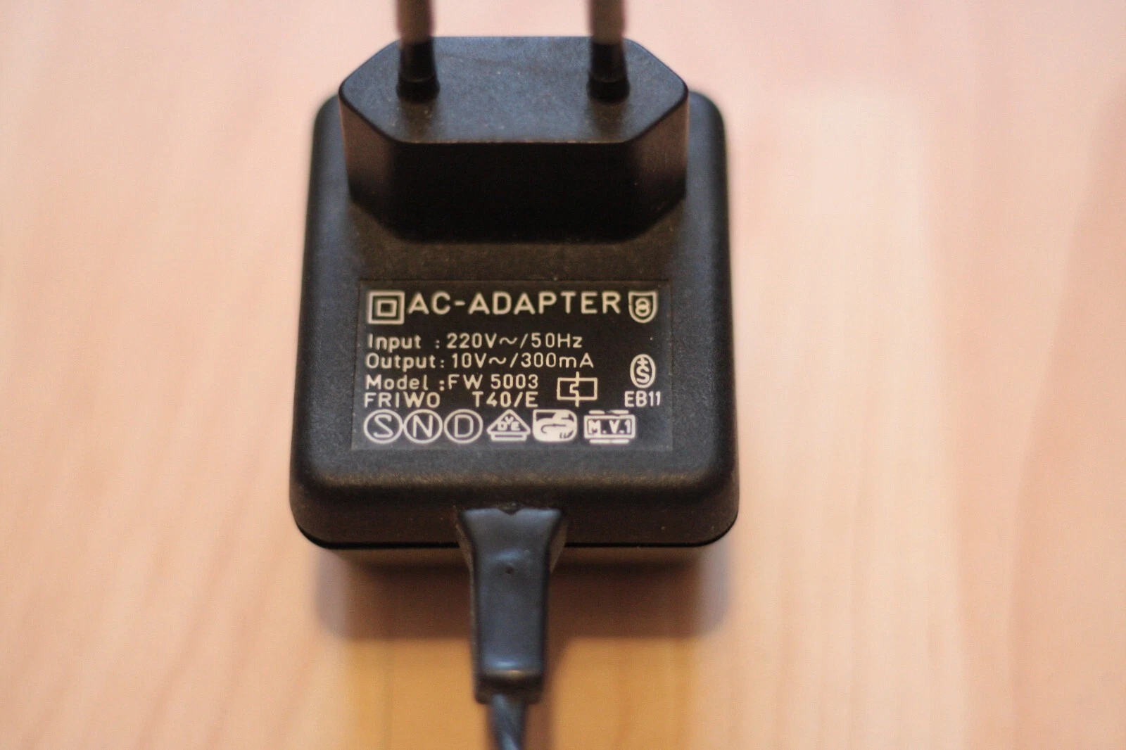

THORENS TD 146 (50Hz: 4 150 060 FW5003 10V~ 300mA, 60Hz: 4 150 077, page 8 - page 24 show voltages on testpoints)
THORENS TD 147 (50Hz: 4 150 060 FW5003 10V~ 300mA, 60Hz: 4 150 077, page 8 - page 24 show voltages on testpoints)

I don't understand, why for the TD146+TD147 the power supply sticker of FW5003 show only 10V~ although the service manual mentioned higher voltage values (Thorens order code 4 150 060) - check out the attached images No 16-19 and this images under

The Thorens power adapter is simply an external transformer. There is nothing else inside the box (maybe a thermal fuse). It outputs AC, not DC.
Chinese AC-AC wall-warts also have nothing except a transformer inside. There could be no SMPS inside an AC-AC adapter.
