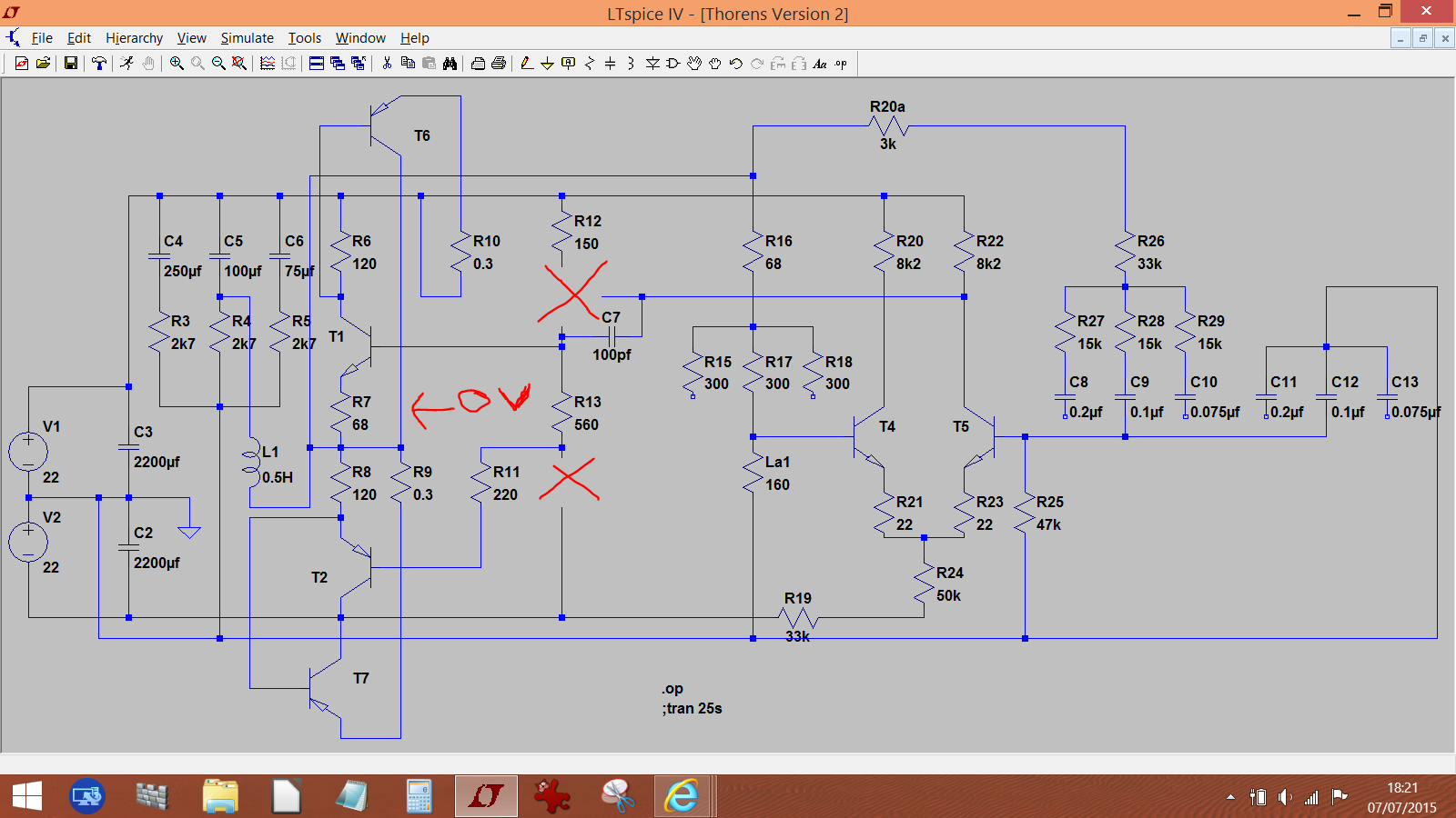

Thorens 125 MK1. Help me please repair this PCB.
OK.

We now check that the output stage is OK and we begin by removing T3 and R14 as shown here.
Then check that the plus 22 volts is present.
Check that the minus 22 is present.
Check that the voltage on R9 is zero.

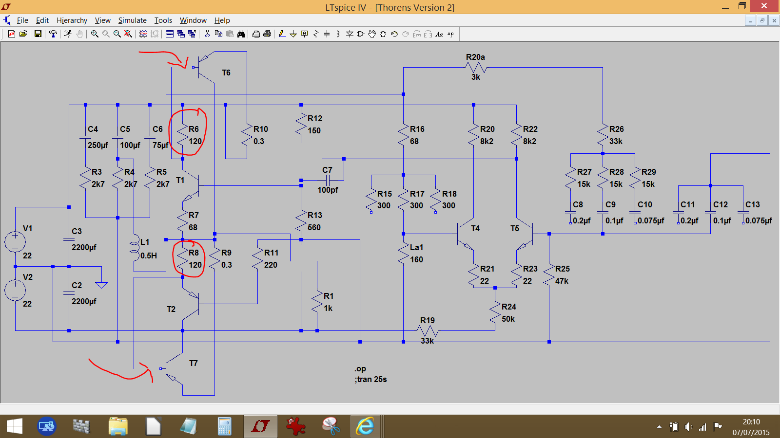

That's much to high. Keep everything just as it is and isolate T6 base and T7 base as shown here and then measure the voltage again.
The voltage on R9 should now be zero.
If it is not then leave things as they are and measure the voltage across R6 and across R8 by placing your meter leads across each resistor in turn.
Those voltages should be near zero. If you get to this point and there is voltage across R6 then T1 is faulty or there is a short on the board itself.
What is happening at the moment is that 22 volts is being fed to the output, and so we are isolating parts of the output stage in turn to see why.
C3 minus to R9 after T6 T7 bases isolted now 15.6V
Interesting 🙂 You would get around 15 volts if T1 is conducting.
I have 4.7V across R6 and 0V across R8
Again, those are the readings you would expect if T1 is conducting.
T1 was replaced by me with the BC147A resistor. It's not a failure here.
😉 I want to be sure on that.
There are three possible ways T1 can be conducting and drawing current through R6.
1/ Its simply faulty.
2/ Its fitted incorrectly and some of the leads are mixed up.
3/ C7 is leaky and turning T1 on.
This is how we determine what is happening.
1/ Remove T1 and check that R9 voltage is now zero.
2/ Also confirm that voltage across R6 is now zero.
If those are now correct we test the transistor.
Lets get to this point first and if all is OK then I'll tell you how to test it.
