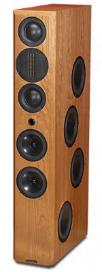

I'm running a pair of COINCIDENT VICTORY II's. Looks like the speaker in the picture but without the side firing woofers. They are rated by manufacturer at 97db and an easy 10ohms. But they are probably more like 93-94db. They are very electrostatic sounding with very nice balance through range. Except below 50hz or so.
I was thinking of building a stereo pair of Thor's using an external amp to power them with the Behringer to send appropriate signal. What do you think? I've found few proven DIY subwoofers I could tackle that seem to fit the bill. I wonder if anyone has reverse engineered the Entec subwoofers of past that had 3 woofers in a box. Those were supposed to be awesome.

If you want tight detailed (fast)bass then the Thor should fit that bill.With the shelving EQ used by SL it has a low Q therefore a shallow rolloff resulting in low group delay(good transient response)and in room response should extend below 20hz.
