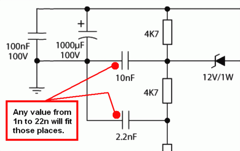

Hello All,
I am having problem with the PSU made by alexmm for DX Turbo amplifier. I can't find in the store the 4.7nf/100 and 100nf/250v capacitors. They only have 2.7/600v. I am not sure about the 100nf/250v. Is there any substitute for this parts? Need help.

Hi Julius, we cant say substitute the value but believe only the code is different in some other countries.
4.7nF is equivalent to 472, and likewise..
0.47uF = 474
0.047uF = 473
0.0047uF = 472
Hope this can help.

Bypass capacitors are not a critical value and you do not need to worry about them...
...even if you remove them the amplifier will continue to operate.. the reason of those capacitors existence, installed in paralell with electrolitic condensers and usually into the rail lines, is to give your a very low impedance patch to ground if some oscilation starts.... as electrolitic condensers are also inductive because of the coil construction inside, the capacitors connected in paralell will conduct high frequencies to ground beeing blocking, stopping, the oscilations as soon as the start... alike big mouthes and big throat that will "eat oscilations".
The electrolitic condensers will conduct high frequencies to ground too....BUT... they will present some resistance because internal construction is alike a coil... and the capacitors of smaller value, not beeing constructed as coils represents a very low resistance to those frequencies... they are alike a short circuit... high frequencies... when appear into their positive terminal (not the ground one) are eated!
You can use 1n, 2n, 3n, 4n, 4n 6n till you reach 1uf.... and why not more than that?... because size and price only.... as all them will present a very low resistance (capacitive reactance) into the high frequencies, where the oscilations use to operate....so.... put the one you have at hand... they do not need even to be the same value... they can be different...if you have 6, then you can use 10n (103) into the number one...... 22n (203) into the number two... and this way you can do without worries... even the removal can result good if your amplifier is not "oscilation addicted" circuit...and Dx Amplifiers are stable and not oscilation addicted one..... and my care about the inclusion of those capacitors helps the amplifier stability... they are there "just in case".
The output 100n can be substituted also from 82N to 220N.. also the zobel in series resistance can be substituted..from 4.7 ohms to 22 ohms... depending the capacitance selected by you.
No big magic folks...electronics has tolerance... plus 20 percent and minus 20 percent is normal.. and in some cases circuits will tolerate much more than that... the bypass capacitors is one of this cases.
I have to check that other capacitor, i do not remember where the unit is used..but for sure you can use there 2n.... or values till you reach 22n (223) without problems too.
100n is 0.001uf
22n is 0.022uf
4.7n is 0.0047uf
