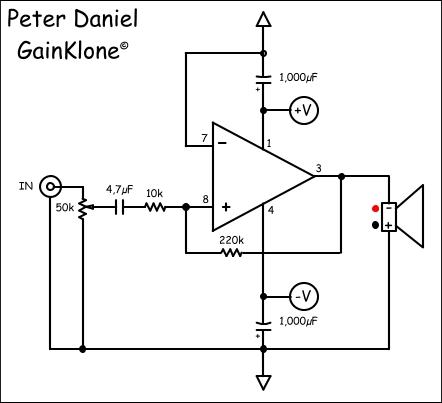

help please.
just finished my first channel of my gainclone using an OPA548. i used the datasheets to get the pin layout and i have triple checked my connections.
the problem is, i get -v on my output. this voltage is equal to my supply voltage (20v) im lucky my speaker was disconnected. my heatsink is at -20v but its not touching anything. the current limiter pin is connected to -v.
can anyone suggest anything i can do/check?

Matttcattt said:here is the circuit i am using.
Where did you get that?
That's an edited version of the one I did for Peter for the LM3875. Whomever edited it has the + and - inputs on the amp reversed and the pinouts on that schematic do not match the pinouts on the OPA548.

MatttCattt, just checked out the data sheet and the OPA548 has the metal tab tied internally to V-, so you need to isolate the case from the heatsink unless you want your heatsink at -V which isn't a good idea.
And the difference between the pinouts of the schematic you gave versus the OPA548 should be changed to the following:
Pin 1/Pin 5
Pin 3/Pin 6
Pin 4/Pin 4
Pin 7/Pin 1
Pin 8/Pin 2
Where Pin/Pin = LM3875/OPA548.
Check your wiring against this.

i found it on this tread, i changed the inputs but forgot to edit the pin numbers

my gainclone is just a test so the heatsink at -20v is ok.
i have checked my wiring and it is correct.
