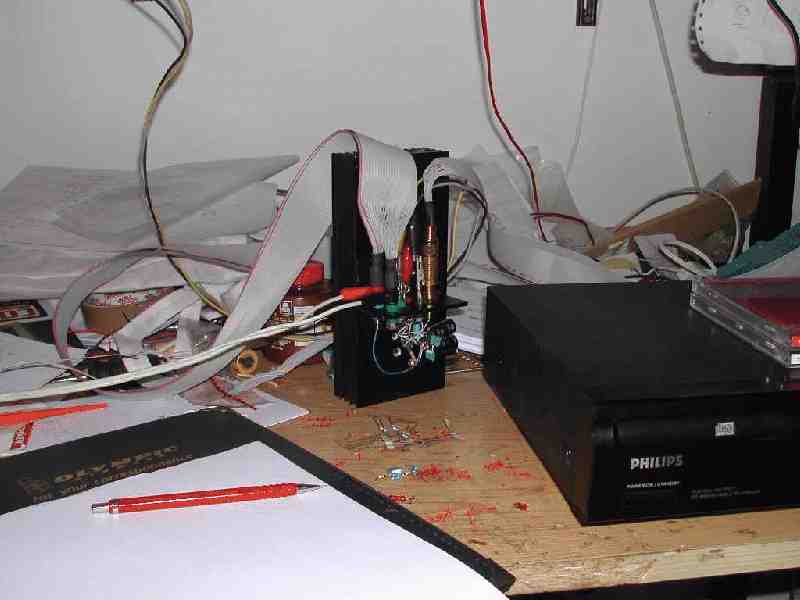

Dear fellows
I had claimed that i spotted dramatic differencies in sound due to resistors directionality ("This is not just another gainclone" thread, page 47, post# 698). Suggestions for repeated and reversing testing from Bobken, open doupt from MRehorst, and my own uneasiness with the subject findings, pushed me into more testing. I used various setups (one LM1875, later two LM7815 amps and special connectors for attaching the resistors), but as the testings were progressing, it became clear to me that-as Bobken and Fedde have also marked- the important think is to isolate one variance from the others. So finally, i settled for a single, fixed, compact "jury rig". A TDA7294 (more detailed sound compared to LM1875), inverted [Rin=12K, Rfb=120k,Vin+ tied to grnd. stabilised +/-15VDC, 1000uF//0.1uFper polarity], mounted on a big heatshink with all the connections to the outside world firmly attached to an aluminum angle bolted to the heatshink. No loose connections or moving cabling anymore. I started probing the feedback resistor first. I was soldering and desoldering it directly on the applicable IC pins, with listening tests in-between. Soon I found out that my listening memory is short termed, at least as some very critical details are concerned, so i had to shorten the time (approx.3 minutes) between testings. I opted for a DPDT switch for to switch btn two resistors in the feedback path. Now, time between testing was approx 3 seconds. I was more confident for my judgement now. The following resistors were under (sighted) test:

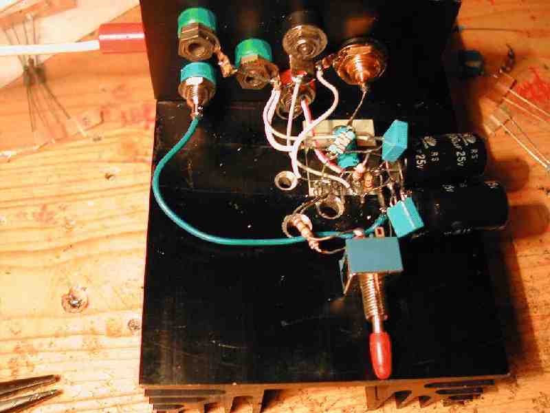

1. Single 120K 1/4W carbon film 5% resistor (two pieces, A and B).
2. Single 120K 1/2W carbon film 5% resistor (two pieces, A and B).
3. Single 120K 1/2W metal film 2% resistor (two pieces, A and B).
The test patern was as follows:
ll Test No ll Resistor in Switch Position x ll Resistor in Switch Position xx ll
ll a. ll 1A ll 1B in opposite direction of 1A ll
ll b. ll 2A ll 2B in opposite direction of 2A ll
ll c. ll 3A ll 3B in opposite direction of 3A ll
Each of the above abc tests was intended to discriminate the directional effects (if any) for each resistor type. Listening material was intentionally limited to 3 minutes sections of 2 particular musical pieces. List: Piano Concerto No1 (Boris Berezovsky, Philarmonia Orcestra, Hugh Wolff, 1995 Teldec DDD recording), and Korngold: Concerto for Violin and Orchestra in D major (Gil Shaham, London Symphony Orchestra, Andre Previn, 1994 Deutche Gramm. DDD).
Each test was comprised of 20 comparisons (switch position changes), 10 for List and 10 for Korngold.
The results did not confirm my previous claims, at least they did NOT support any dramatic directional effects. This is all that i can expect for such a test. It left me with a marginal preference for a particular direction -the same for all three resistor types-but generalisation and confirmation requires blind tests and a great number of resistors, sampled randomly from many sources at different times ect, ect.
This test gave me the chance to compare the "sound" of the three resistor types. I can say that for the particular setup, the 1/4W carbon was the least discriminating. The 1/2W metal, seems to be the most detailed. The 1/2W carbon gives the impression of having more "body", not much away from the 1/2W metal in terms of clarity.
I tried some more tests with long listening intervals and different music material, the results of which, didn't contradict the above claims.
Then i conducted some more tests:
Single 120K 1/4W carbon film 5% resistor, direction x, against
two 240K 1/4W carbon film 5% resistors in parallel, direction x. The parallel combination seems to give marginally more detailed sound. This, may be due to power sharing (douptfull, as voltage drop across resistors was approx. 3mVpp), or due to partial randomisation of the resistors properties.
Two 240K 1/4W carbon film 5% resistors in parallel, direction x,against
two 240K 1/4W carbon film 5% resistors antiparallel. No difference perceived.
These two last groups of tests (conducted following the protocol of the initial tests) were repeated for the carbon 1/2W and for the metal 1/2W. Same results, no difference.

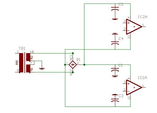

Well after reading you guyz talk about your gainclone's. I think I am sold on the idea. But me being a tube guy, I am not very familar with SS stuff. So I have a few questions regarding Peter Daniel's schematic. First off what are the capacitors rated at? 25v or 50v? The 4.7 signal cap? I am also curious if any of you have tried more expenive paper in oils or the new jupiter caps. I am very fond of them in tube gear, but maybe you do not like the tube sound.
Next the power supply is confusing me. So Peter you are using one power transformer (22-0-22 @ 400VA) for both channels, right. But I am not understanding how it is layed out. The secondaries are then led to a bridge rectifer then into a 2000uf cap? What is the rating on the power supply caps?
If you have time can you draw up the power supply for both channels. Help out a beginner in the middle of all this information. Thanks

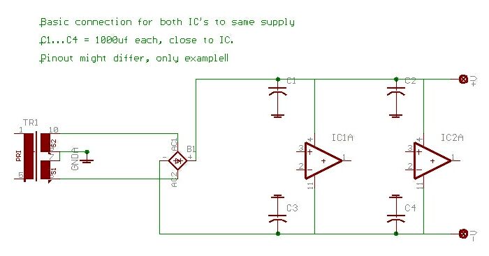

Hi Guiness

Here is basic PSU connectio, option 1:

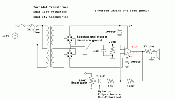

Peter Daniel said:
If you use the schematic below: 50k log pot at the input, 4.7BG N coupling cap, standard BG caps for PS filtering (4,000u in total), 400VA toroid (double 22v secondaries) with 8 discreet hexfred diodes (separate bridge per rail, both channels share rails, separate wires from PS to amp, 8 total), no bypas, no filtering in PS. Resistors - Riken 1W for 10K input and 220k, 0.5W Holco for feedback (Holco worked well here, Riken might be good too, but I didn't check it yet). Chassis should be solidly built as well. Check my example here: http://www.diyaudio.com/forums/showthread.php?s=&threadid=9112&perpage=15&pagenumber=35.
If you built the amp with those parts, I can almost guarantee that it will equal or better most other commercial offerings, regardless of price. How's that?😉

Re: Moving DC Blocking Cap
Peter,
I’d be interested in seeing whether moving the DC blocking capacitor directly to the input would change the sound. It seems to me that a small gain in offset would be worth a try if it does not affect the sonics in discernable ways.
I would try to keep all the components at the input side (4.7 uF cap, pot, and 10 K resistor) as far away as possible from those at the output side, including the 1000 uF bypass capacitors, which carry highly nonlinear currents from the class-B operation. There might not be an entirely satisfactory way to do this while keeping a tight layout, but the idea is to minimize the inductive and capacitive coupling between the output and the input.
I agree with you in leaving out the 220K resistor from the noninverting input. It is too high a resistance to hang at the input node, and it makes the noninverting input more susceptible to undesirable capacitive coupling. The need to keep the impedance low at the input would certainly override the concern for DC offset.
