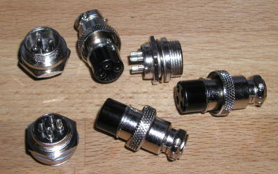

Those are really nice connectors I buy at local store. I need 4 pins (2 rails, 2 grounds) and I didn't even look for suitable Neutrik connectors. The ones I'm using are smaller, they seem more robust than XLR, non magnetic and they don't look like signal connectors. And what's most important, they sound really well.

Here's the pic of those connectors. I was looking through pages of Digi-Key catalog and couldn't find anything suitable. Those I found in my local store. Unfortunately they had limited stock and I bought them all. They expect to restock in 2 months. Anybody knows another source for them?
Peter Daniel said:Here's the pic of those connectors. I was looking through pages of Digi-Key catalog and couldn't find anything suitable. Those I found in my local store. Unfortunately they had limited stock and I bought them all. They expect to restock in 2 months. Anybody knows another source for them?
Those are your basic CB microphone connectors. I believe Radio Shack still carries them.

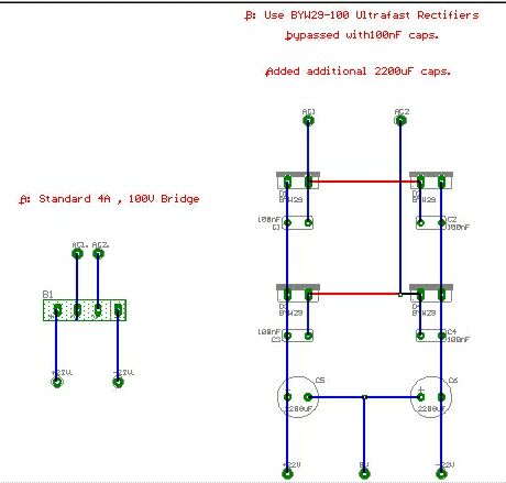

Seems like this is almost the official GC thread, so I just post this here:
After using my GC , from Peter's circiut, I did the following to the PSU and found that it was a deffinate improvement. The sound became more transparent and gained in clarity .
The origenal circiut is from Maarten:
http://www.euronet.nl/~mgw/diy/amps/uk_geenkloon_2.html
I replaced option A: with B:
