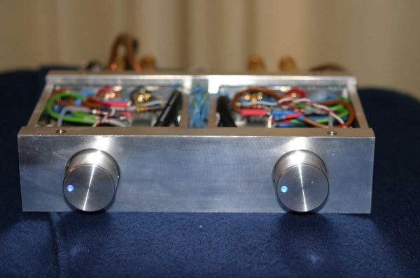

Scribble said:Love how those LED illuminated knobs turned out
Yeah, like them myself as well. Í have both channels working now and I'm running the prototype around the clock in order to test this setup.
Maarten
Very beatifull maarten, I've been visiting your site as well but'i'm still in the design phase of my gainclone.
Question: I would like to build a monoblock configuration, so with the transformer in the same box.
I know of the drawbacks but think they might be solvable if taken care of properly. The power section will be separated with a thick steel plate from the amp section and the volume switch will be at the back in the amp section wit an extended rod.
Additionally I've found these transformers. The are magnetically shielded and have additionally a shielding coil between the primary and secondary windings;
http://www.schuro.de/preisl-v-rkt-ms-sw.htm
has anybody experience with these type of shielded transformers in one box with the amp itself and with what results?

Frank, i honestly don't see those leds going anywhere in a hurry. Besides they're blue which we didn't have in the seventies - their coolness factor more than makes up for the sound 🙂

Just wait until your spouses see the purple LEDs... If it came to LEDs vs speaker placement, I'll sweeten my deal anytime with a little colour.
