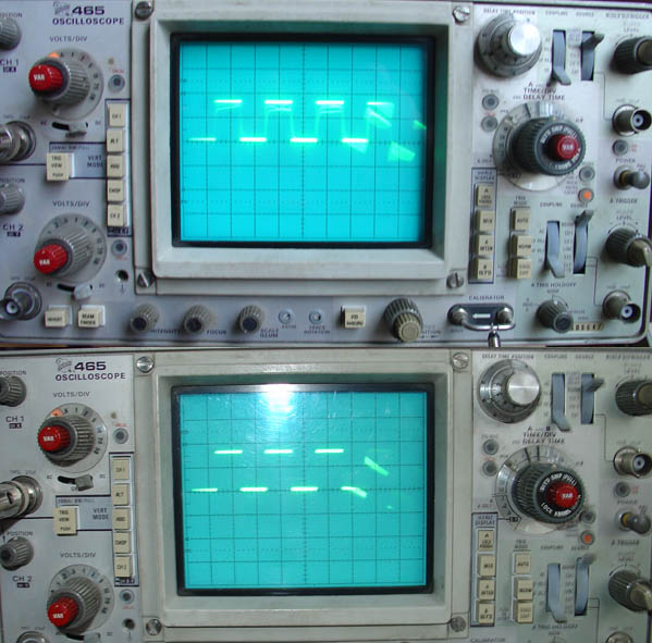

Finger-touch waveforms will generally not be clean. Can you get spiky peaks on the top? How does a clean AC waveform (like the secondary of a heater transformer) appear?
Measuring the 25V outputs off the trafo on my gainclone, I can get something that resembles a waveform, though it looks more like the matterhorn than a nice sine. I also tried sending a 500Hz wave through my system and measuring the positive on one of the input and output terminals, and it is picking up something, but I can't get it to look like anything recognizable.
Does the 'scope produce a pair of straight lines with the inputs switched to "GND"? And at any setting of the volts/div switch?
Does the scope have "focus" and "astigmitism" functions -- you can twidle these as well.
If you short the probes together you should get a flat line. This scope also has a "ground" function on the vertical control panel -- if this is engaged and the line isn't flat then you've got a problem with the vertical amplifier.

I can get a square wave but it's very finicky and has a weird distortion at the right side- see the pictures attached below. The effect is a little hard to capture on a still but these should give a sense of how it looks. I can move it around and the amplitude doesn't change but if it moves much away from the center it loses definition completely.
With the inputs set to "GND" I can't get a flat trace- I get a sawtooth-like trace as seen in my earlier picture a few posts above.

Ah yes, HF roll-off, a well-known problem whereby the signal falls off the end of the horizontal deflection ramp.
Sansbury: You are still murdering your tube. There shouldn't be any penumbra around your trace. The general rule with 'scopes is that if you can see the trace it's a tad too bright. (Lower brightness significantly helps focus.)
PS Don't take the HF roll-off comment seriously; I haven't a clue what would cause that very strange effect.

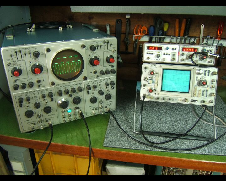

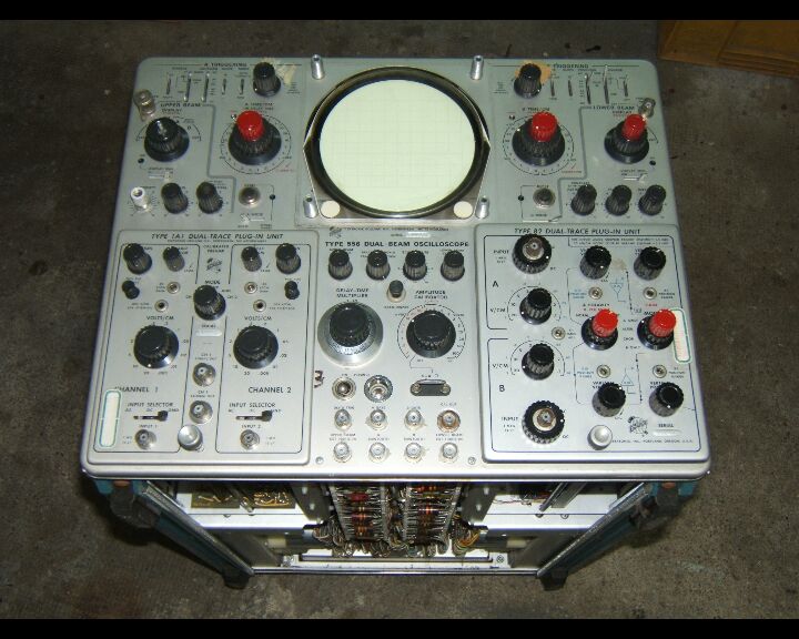

On my bench David and Goliath. Both are excellent scopes, but I have a little preference, despite the SIZE, for the 556 which can display 2 signals out of frequency or phase. You can even display XY on one channel and everything on the other AT THE SAME TIME !

audioquest said:On my bench David and Goliath. Both are excellent scopes, but I have a little preference, despite the SIZE, for the 556 which can display 2 signals out of frequency or phase. You can even display XY on one channel and everything on the other AT THE SAME TIME !
Also excellent to heat up the garage in winter.....

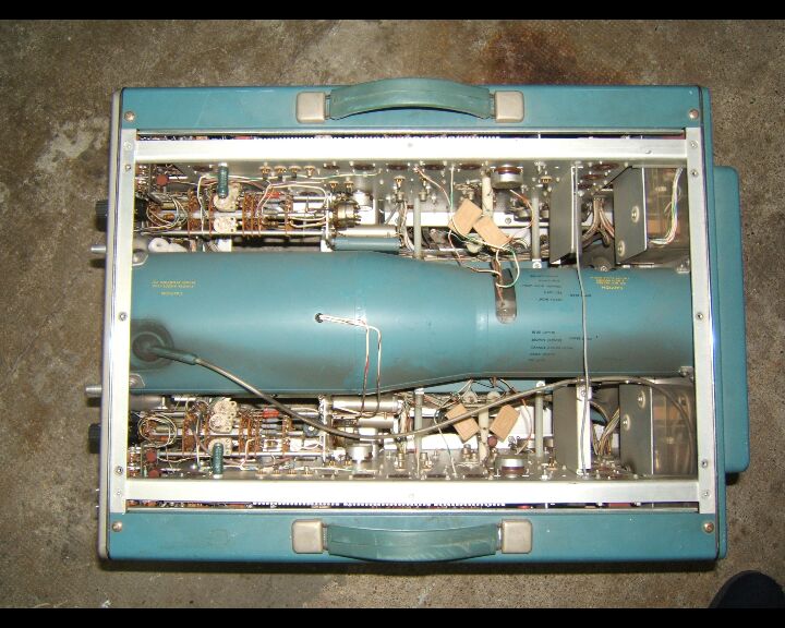

Now that's a rare bird. Hope your CRT never goes bad, 'cause the 556 is using a dual beam tube. Thats TWO electron gun assemblies in the same bottle. A rare and expensive tube today!
You are absolutely right, but I had the chance to find 2 556's ( vandalized , no tubes and missing parts !!! ) from which I rebuilt one. So I have some spares on hand including a second CRT. These scopes are fun to work with and easy to repair if no essential part broken ( i.e delay line or delay trigger...), they also are very cheap on the second or third hand market , user's manuals can be downloaded free of charge on BAMA and I encourage everyone to put these pieces of electronic art back to service.
Here a pic of the original scope shape.
