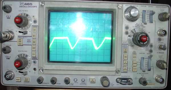

The 465 would be my choice; best way to check it is with its own calibrator and a 10x probe. Make sure the square waves look good (you might have to adjust the probe's trimmer) and that they're the right height.
Go for the 465, but check: Most importantly, look at any signal (the square wave from the built-in calibrator will be fine), make it about one large division high and use the shift control to move it up and down the screen. If the amplitude changes from the top to the bottom of the screen drop the 'scope like a hot potato. Changing amplitude indicates a blown output transistor in the "Y" deflection amplifier, and the hybrid containing that transistor is no longer available, so you're stuffed.
I too am for the 465's
Make sure it has a letter after it, the B would be the best
and even better with a DM too. They came with a multimeter
or a counter attached to the scope..
Also check to see that it does have 2 traces and that the
trace is strong. Touching the BNC connectors with get
a wave and easy to check that way...

The Tek 465 is a nice scope, but it does have one problem ... crt failure.
The lab that maintained the scopes where I once worked kept a stock pile of spare crt's for all the scopes. The 465 - 475 series went through more crt replacements than any of the other models. The older 454's seemed to NEVER throw a crt, maybe they didn't push them as hard brightness wise.
Mind you the scopes saw a LOT of use (and abuse) so take it with a grain of salt.

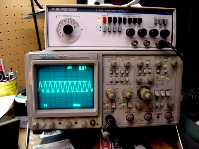

nuvistor said:Tek 2215 show up on eBay regularly for < $100, 60MHz with delayed trigger, a budget analog scope from the early 80s, works fine for me.
I am glad that your 2215 works well, it obviously hasn't had to take a bounce in an undergrad physics lab. I think that these are best avoided unless you can see it up close and personal.

How do you notice when the CRT has failed? As I recall, the 465 and 475 had particularly soggy CRTs anyway. My 485 had a nice sharp CRT before the EHT supply went west.

The old Tek scopes still have one thing going for them -- they are much, much quieter than the digital ones which go for a couple thousand bucks -- yes you may only get 25 MHz of bandwidth but it isn't going to send all sorts of digital artifacts all over the room.

I was recently reminded of this when I used a Tek 2245 that although an analogue 'scope, had a micro-controlled interface (you know the kind, twiddle a wobbly knob and wait for something to happen). There was clock noise on the trace at all times...

Tek 2445 $255 off of ebay
4-channel 150mhz way overkill for audio.I used one like it as a stand-a-lone scope in the F-15 EW test station on a daily basis . While I was in the Force. And the price was right!!
The cursors are real handy no calculator needed for time/freq conversion and provides a digital readout for voltages as well as time and freq.I'm lazy..........

OK, so I picked up the 465 along with many assurances that I could bring it back, full refund, no questions asked anytime in the next two weeks. Unfortunately I fear I may need to test the validity of that warranty.
Upon powering up, I get the following- while messing around with switches can make it do a variety of things, none of them seem "quite right" to use the technical term. Just to make clear, this is with one probe attached, but not connected to anything.
Of course, I don't really know how to use this anyway, so maybe I'm just not doing it right, or maybe it's a small thing to repair, assuming I had any idea how to do so.
Suggestions?
