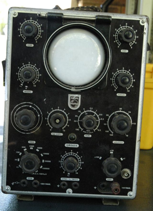

my next project is restoring this old beast.
a 30kHz single channel Philips CRO. That's right, kilohertz... next to useless but how quaint!

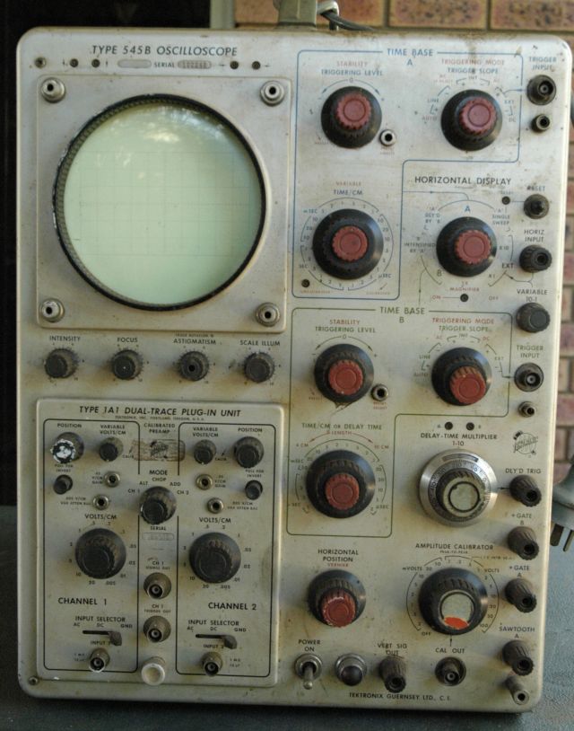

If you see anything like this avoid it, a great bit of gear if it's working correctly but it has 2 handles for a reason - they are extremely heavy. There are about 30 tubes in these, they only last for so long too.
that screen is about 5 or 6 inches across.
Looks like a great buy but you need a real smart old-timer tube freak to fix it. - any volunteers??
Quaint indeed.

OzMikeH said:Looks like a great buy but you need a real smart old-timer tube freak to fix it. - any volunteers??

OzMikeH said:If you see anything like this avoid it, a great bit of gear if it's working correctly but it has 2 handles for a reason - they are extremely heavy. There are about 30 tubes in these, they only last for so long too.
I had three of those fresh from government surplus a couple of decades back and I referred to them as a 500 watt fan forced space heater with an o-scope screen to monitor their performance.
I wish I still had them today as a source for tube amp parts!
