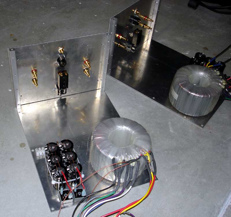

thinking about the UCD modules.
and the power supply:
(not fully hooked up of course)

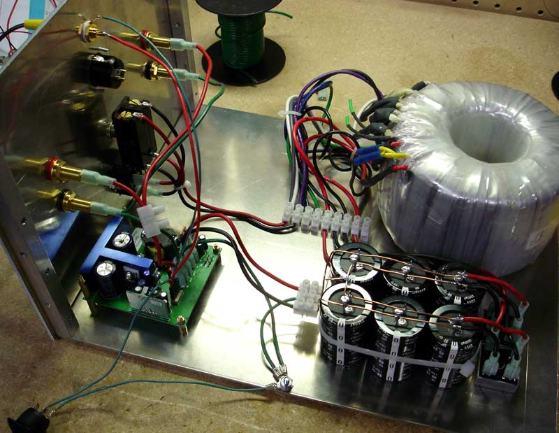

well, here comes the bad news. it plays music, but there is a nasty little hum/buzz coming out of it. its pretty small, but still unacceptable to be in my main system. i need to track it down. i saw some threads on here talking about it. i havent really tried a whole lot yet. i have attached a picture showing the setup. the wires are messy, i know.
basically, i have a pretty standard linear supply. nuetral and hot lines come from the inlet, go into the transformer (thanks guys for helping me figure out the wiring), then out with the primaries to the rectifier bridges, then to cap bank. from here, i have tried two things. ground directly to a star ground on case (as seen), and i have also tried directly to the amp. it was worse without the star ground. the RCA hack ground goes to the board and so does the ground for the binding posts.
there is LOUD noise if i get my hands anywhere near the power wires or the input wires... if i get my hand within a foot or more of the input wires, there is a LOUD buzz... is this normal for these types of amps? i have read a LOT on these, but i didnt read anyone specifically say if theirs was dead quiet or not. most people expect a slight buzz or hiss, but i like my stuff to sound the same with no signal as it does when its off. i like a black background. is this possible with these, or is there just too much noise?
or maybe im doing something wrong in the hookup. see atached picture for any suggestions. i did move the transformer like a foot farther away with no chance in noise. the noise increases when i start getting my hand closer, touch the heat spreader, touch the case, or get my hands close to any wires. also, the hum is VERY loud when nothing is connected...
(p.s. - i dont have the heatsink attached to anything right now. im running it for less than a minute at a time or so, and with VERY low signals. it will have a heatsink)
I have 3 UcD modules in each of my two chassis and have zero noise/buzzing problems. I suspect that you may have a ground loop with your wiring scheme. You appear to be using single-ended inputs. Did you tie input pins 2 & 3 together? Also, make sure your outputs are isolated from the chassis.
as SOON as i saw this post, (i was researching possibilities), i JUST thought about the single-ended thing. i DIDNT tie 2+3 together. ill try that right now and see if that does it...
thanks!
uh oh...
i connected the signal ground to the -signal (J3), and NOTHING changed. it was the exact same buzz, maybe louder. i even took the RCA jack off the back panel completely to make sure it wasnt touching (it wasnt), and that didnt change anything.
one thought, i dont have the earth ground connected on the IEC inlet. could that help? i usually lift it to solve any potential ground issues.
Don't know if this slightly blurry photo might help. Pins 2 & 3 both go to input signal ground (not tied to chassis ground). Pin 1 goes to input positive. I have supply ground tied to a star ground point on my chassis and also have the AC receptacle ground tied to the same point.
well, i tried a few things. i modified the star ground to now include the earth ground on the IEC inlet.
that did nothing...
BUT, i tried what you said about shorting the input to ground, and now its silent... there is NO noise coming out of it at all. but, its really really noisy if nothing is connected. i made a cable awhile ago that is an RCA interconnect that is shorted out at one end, just for this purpose. and when i disconnect it, the amp hums again. when its plugged in, it stops humming and is silent. is that normal?
thanks for the help!
edit:
i re-read what you said about having a ground loop at the source component... im not quite sure i understand how to fix this. i had the earth ground lifted before and that didnt do anything. how else could i have a ground loop issue? also, the humming/buzzing happens with NOTHING connected, just a bare amplifier without an input. even if i just disconnect all the input wires to the jumpers, it still buzzes.
....hm, your setup is wrong;
- remove the star ground.
- ground the circuit ONLY at the cinch gnd tab to the chassis ground.
- use a screended wire, or at least twist the wires.
- when you like to use an asymmetrical connection connect -symmetrical to gnd.
Better to use;
- use symmetrical screened wires.
- use a symmetrical input XLR, whereby pin#1 is connected to chassis.
- make an asymmetrical to symmetrical cable whereby at the side of the cinch the screen is connected to -symmetrical, and then to the GND of the cinch.
When proper wiring you will have NO hum and NO noise.
Jan-Peter
done.
this confuses me a bit... by "cinch" tab, i assume you mean the quick-disconnect tab on the UCD module itself? that connects to chassis ground? where is chassis ground? doesnt that imply i would have a star ground?
by "screened" i assume you mean shielded. where do i need to use shielded wires? everywhere, or just on the signal wires?
i got that part. i connected pin 2 to pin 3 at the RCA input jack. i dont use balanced connections (my processor doesnt have them), so i will never need an XLR jack.
Better to use;
see above. ill just keep 2 and 3 connected.
you kinda lost me there. im still not sure what you mean by "cinch". but i am guessing you mean a shielded cable, where the shield is connected at one end (the UCD module end) with the shield connected to - input, and ground to ground, and signal to +input. right?
Jan-Peter
I can only hope so!
but i am still confused as to what my grounding scheme should be... i have covered the asymetrical (XLR, single-ended, whatever you want to call it) issue. i have grounded (or connected) pins 2 and 3 together at the RCA jack ground tab.
but im still confused about how to ground the actual module and the chassis ground thing. i am using dual primaries and dual rectifiers. should i connect the 0V taps together and just use a single rectifier? how should i go about wiring this thing up.
mac said:
Looks like you've got JP to help out. I'm sure he'll be able to get you up and running. Good luck.
i sure hope so! thanks anyways.
Cinch is RCA.
The best is to connect chassis ground at the input RCA connector. In you picture you can solder a small wire from RCA GND to the nearest screw. In this cas you have ground the amplifier at the input side. Twist the signal wires, and connect at the UcD180 the -symmetrical to GND of the UcD180.
Jan-Peter
