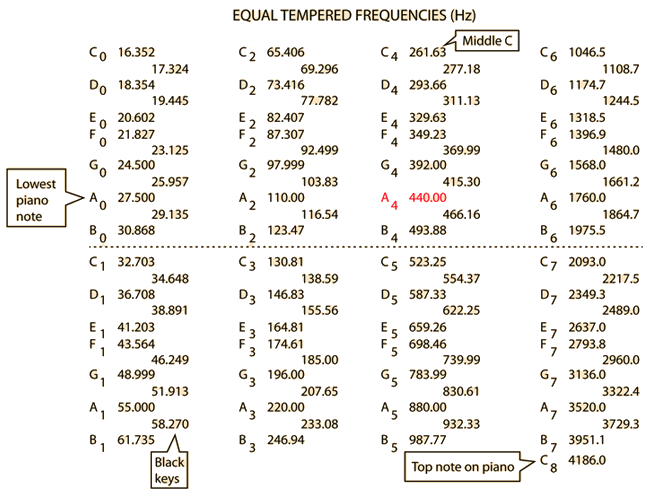

When I tap my diafram with a brush I get a tuning of 51.913 hz in reference to my piano . sound valid?
What are the unsupported dimensions of your diaphragm?
Is the HV bias applied? Resonance will drop with increased HV bias.
http://www.diyaudio.com/forums/plan...agm-resonance-change-hv-bias.html#post1884466
If you don't have measurement equipment, you can determine resonance by player a slow sinewave sweep(from 20Hz up) thru a woofer placed a few inches from the diaphragm. It will be really obvious when you hit the diaphragm resonance as you will hear the diaphragm start moving in sympathy with the woofer.
5.3" max span between diaphragm supports (.062 d/s)

Bolserst, the 51.913 hz is a free air resonance that is produced when tapped with brush, unmounted. the open area is 10"x30" , I took this measurement so I have a reference when I heat shrink the rest I build so they sound the same. Thanks Al
