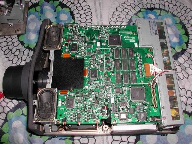

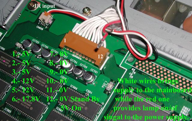

Dissasembling this model is very easy. First of all when you take of the upper cover you will find the motherboard. From the motherboard to the power supply unit there are to cables, one containing 12 wires (11 white and 1 red) and anothers with only two pink wires.
The big one brings supply to the mainboard trough the white wires and sends the singal from the mainboard to de power supply to turn on or of the lamp depending if it is on or in Stand by mode.
Something annoying to me was the function of the pink wire. It connects directly to the lamp supply part. Just next to an optcoupler (P621). It always has 5V in it (coming from the mainboard) no matter if the projector is on or of.
Here is an image of the projector without its cover. There you will see both cables I was talking about.

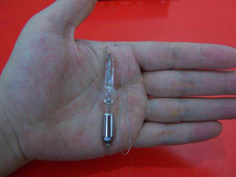

The lamp it uses is a MH one, rated 150W and 65V.
As all the ones comercially available are above 90V, I thing you wont be able to use the original ballast. If you do it it will be going to be at your own risk.

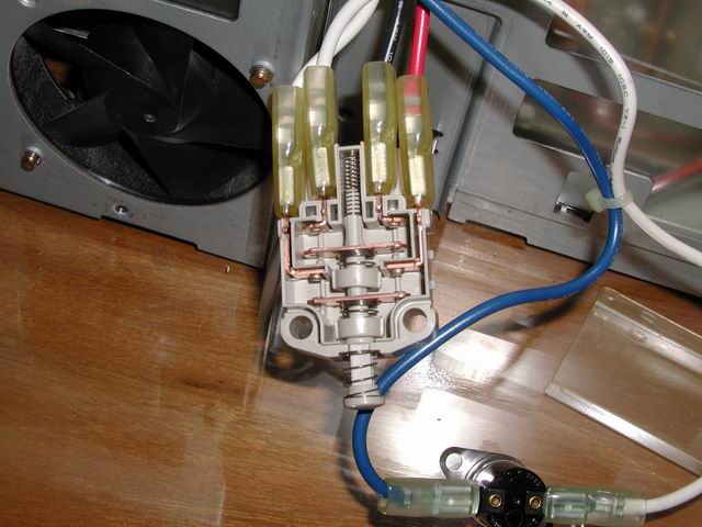

There are two things that you may need to fool in order to get it work without the original lamp. The first one is the interlock switch. This one connects the power supply to line while the lamp cover is in place. You just have to bypass this connecting its wires together if for some reasoung in to retrofitting process you put that part away.
The second one is for the projector for not trying to start the lamp. And for that you will only have to disconnect the red wire from the mainboard connector.
Thats all, now is your turn to find out wich lamp to use.
Here goes a photo of the interlock switch opened.

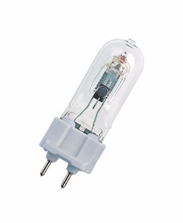

The first option I see here is to try to fit the new lamp inside the projector. For this as we are limited by space we can only put a small 150W lamp. Here in Buenos Aires I was able by now to get three or four models, all of them very similar with each other:
Philips CDM-T 150W/942 (100mm long)
Osram HCI-T 150/NDL (105mm long)
Osram HQI-T 150/NDL (84mm long)
I saw many of you here choosing the Philips or the GE model, but none of you with the last one. Did any of you try this lamp?? Here goes a pict of it.
The last lamp from your list seems to be a good choice. People stripe the outer envelope (dangerous, always wear glasses!), check this thread:
http://www.diyaudio.com/forums/showthread.php?s=&threadid=42610&perpage=10&pagenumber=1
Or, perharps better, you can order a real projector lamp from YWH. Price about the same as Osram HQI-T 150/NDL, but it's supposed to be better, maybe even would somehow fit your projector without much work.
Regards

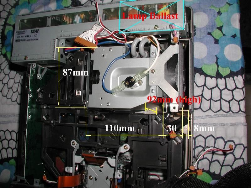

Another advantage of this model, is that it has inside a light box. Other commercial projectors doesn´t have this box, the lamp cage just fit to the projector case. That measn that with the ELP-3000 you can make a clean light box extration and make a new one for the new lamp. You can also gain more space by taking 30mm of the lamp fan space that face the projector side (you can put it outside).
All of this, with its sizes, is in the attached picture. This measeures represent the box size itself and the space that can be gained by moving away the lamp fan.
