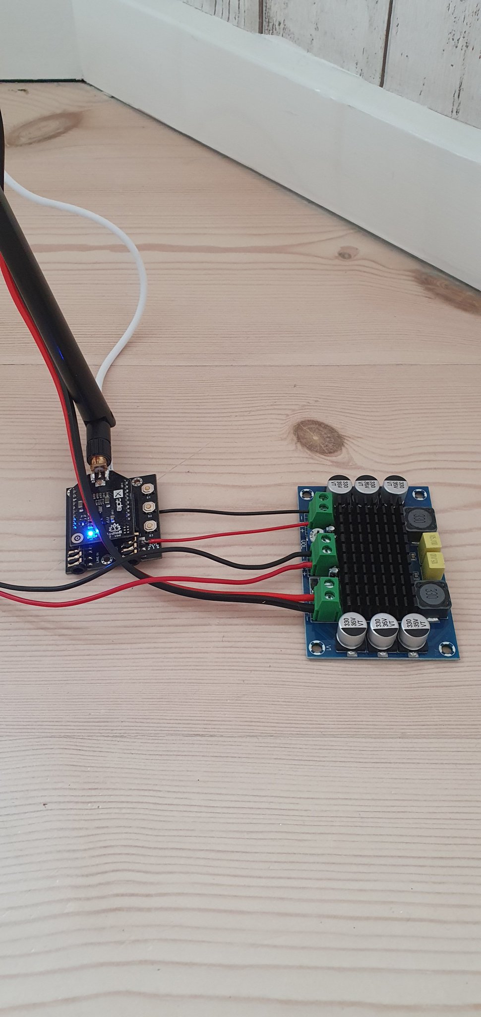

Hi Mattstat,
Long time no see. Just want to tell you that this little TPA3116D2 amplifier board solved all my distortion problems 😁 Paired with a small versatile Tinysine Broadcomm based BT module with AptX HD, TWS and Partymode.
Your freind,
Ole
