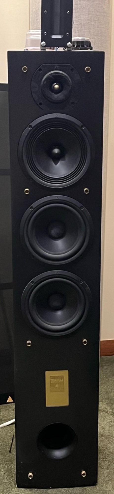

Well I came up with a replacement mid - perfect shape. This fellow who I knew back in the late 80's had a pair of Pro Ac Response 2's set up and my Celius after the midrange went in sounded quite bad in comparison (Ribbons good, mids and lows - meh). Going to take my ribbons off, put the OEM tweeters back in, tighten it up, and give to my elder son for his basement system. Then concentrate on two more simple projects - Pro Ac Tablette and Cizek 1 restorations, while I look for a plan to build a knock off of something really good like a set of Response 3.5's, or the BMR Philharmonics. Thanks to all, and carry on.

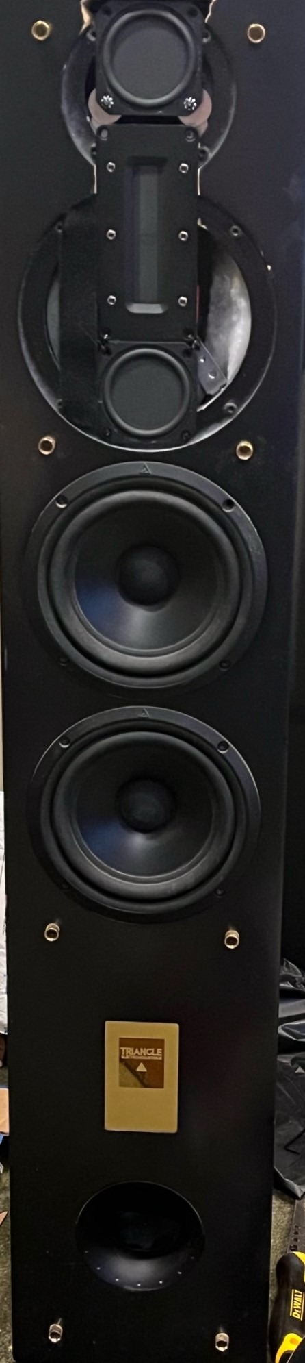

I could not let my mods on this go at that. I took out the mid and tweeter, cut open the box in that area and mounted two BMR mids - the latest 2.5": Tectonic TEBM54C30-8 2-1/2" BMR Full-Range Speaker 8 ohms hooked in parallel vertically flanking a ribbon tweeter (Fountek Neo-X3.0).
I;m using the existing xover for the moment. I'm going to erase the traces of the bi-amping capability and use the existing pieces to wire as detailed by System7 in post #38. I believe the mids (not including the boosted low range from the open cabinet is maybe only 2 db less than the stock driver - of course I'll measure, but I may need some adustment to get the xover.box flat.
The two included pics are: 1: the way that they have been for some years. In my formally huge room at about 14' away the ribbon being so far from the mid resolved itself OK (the existing metal dome isn't hooked up). In 2: I've got the MTMWW alignment. The mids and tweeter are a bit too close to each other, so in nearfield (4') - they don't sound disembodied, but start to sound a little crowded at 7.5'. Also there is a ton of Sonex and batting behind the mids/tweet, and the tweeet is wrapped in 4 mm felt, but, the lower part of the mids is leaking thru the gaps in the cabinet. Since all that hides behind the speaker grill, I think I will cut the front mostly off, and anchor two two long open braces to house the properly spaced drivers (nice that the screw holes line up so nicely), and put the mids in an enclosure which is spec'd at .2 cu ft.
Also the 2nd harmonic on female voices, violins, guitars seem to exist in 3D space better than the the stock speaker, a result of going from the 6.5" stock mid in part I believe.
Comments?

Looks like the BMR Philharmonic Towers keep the MTM in a tight vertical. I assume figuring the lobing of a ribbon is more likely the closest edge of the ribbon to midpoint of the mid, which at 4k is 3.39" which is close to what they and I have (and can adjust to meet). But the Tower from woof to mid looks like 1/2 a wavelength but on the monitor looks like a 1/4 wavelength. Interesting and thats as much as I can go - 1/4 wavelength.
I don't want to build the little .2 cu ft enclosures for them, but I can't leave them in the cabinet naked, so I'm thinking of having them sit in a small front only baffle with a thick piece of mohair or whatever they did with the mid-woof of the DQ-10. I;m cutting the front of the top portion of the cabinet (WAF), leaving the female pegs for the grille, and also having to cut the top of the speaker to protrude the top mid up an inch or two to get the 1/4 wavelength for the mid -> woof. Im also going to get the xover up above the woof cabinet, since I foresee lots of tweaking
The two BMR's won't play as loud as the old mid, and they are getting stressed at the bottom of their range with the nominal 400 Hz crossover @ 12 db. If I keep the 2nd order, I will have to slide it up in value, or do a 3rd order. changing the cap for the mid is much easier.
It is exciting and positive change because subtle cues and inflections are coming thru. I don't listen above 94 db peak, and usually lower so the volume issue shouldn't be an issue.
