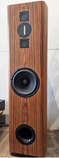

I've listened to ribbons like these:
635372d1505410707-classic-monitor-designs-mtm-scanspeak-raal-ribbon-selah-audio-jpg
They are good. Better than most domes. In fact I am starting to think I hate ALL dome tweeters! 😀
Your speakers actually don't have ideal characteristics for A Fountek X3 Ribbon, which IMO, best sits between two midranges in MTM for ideal dispersion. But you crack on, my friend. Glad you got back to us. It is all, after all, experimental. 😎

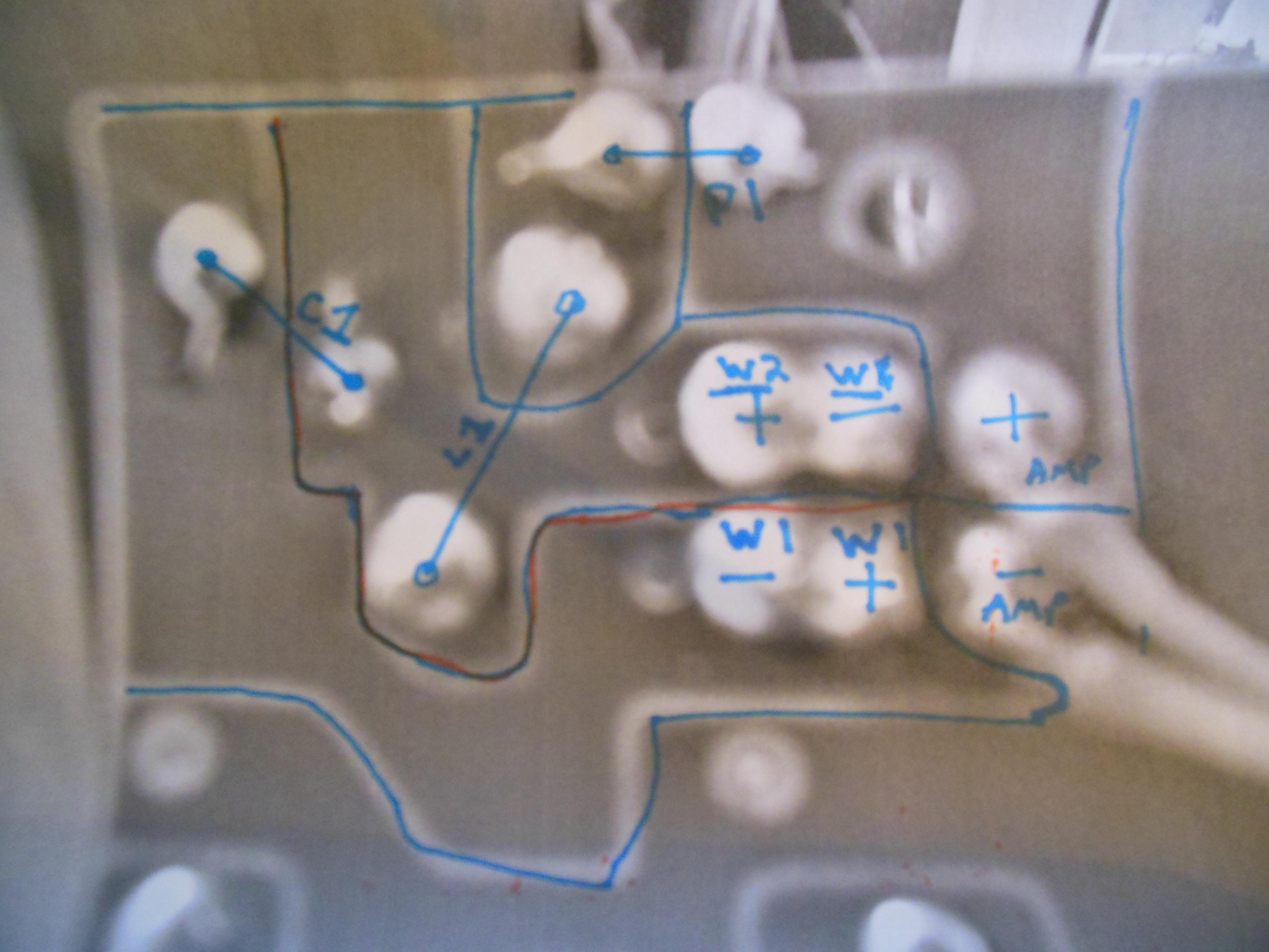

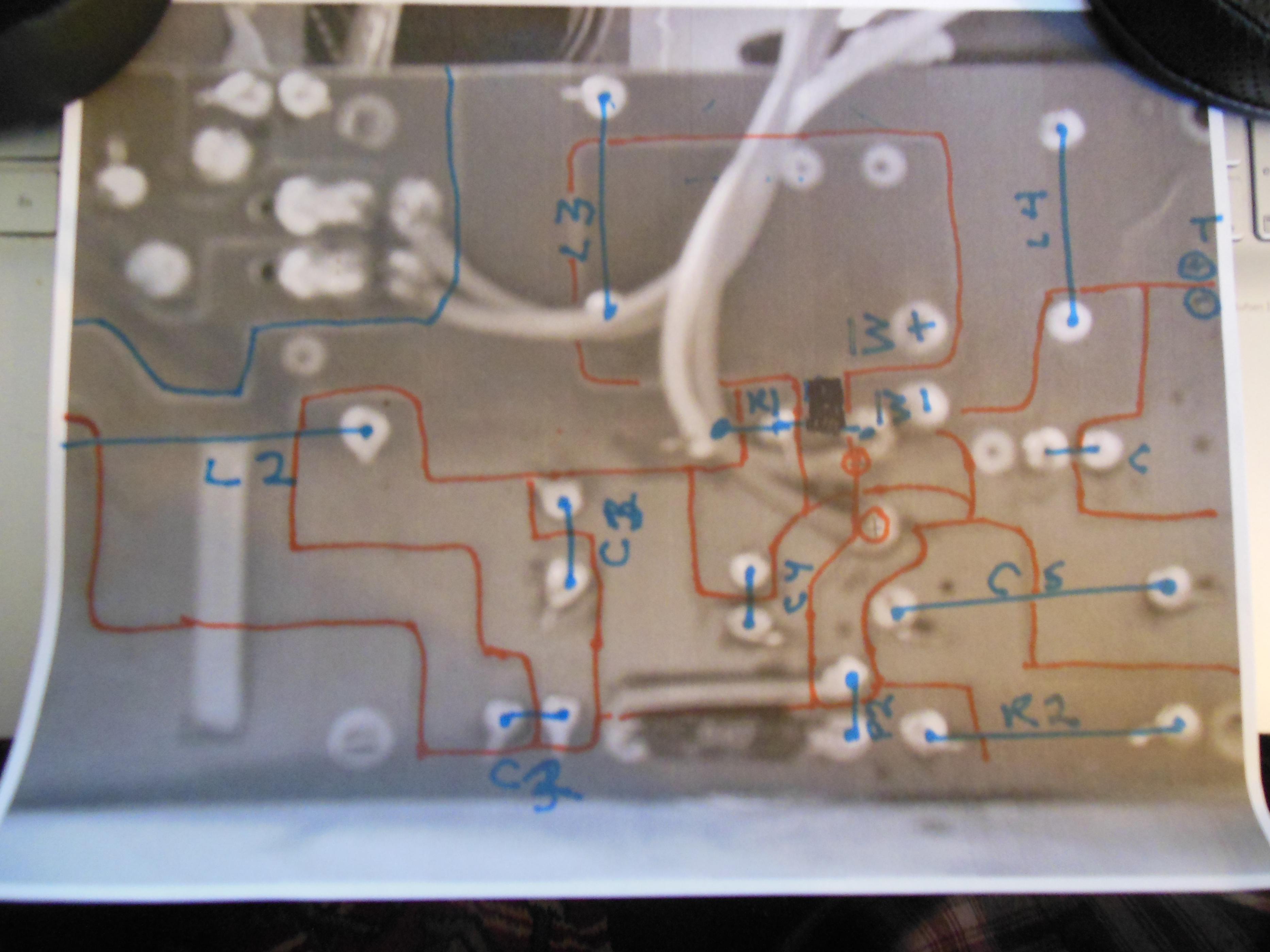

Thanks. They are set up for bi-wire, but I never liked them that way. And I do have the earlier crossover which I don't believe have been described before. So, I'll yank the back facade off, and try and map it out - in December. Maybe you guys will be able to suggest some changes.
I've been thinking about redoing the crossover on a solderless breadboard with screw posts so I could change items in and out very easily, and ditch the solder. The current board is short so it's stuffed. If it was 3" longer it could be thinner making for an easier fit.
This is the portion of the PC board that deals with the "bass in" part of the biwire signal coming from the amp. I get the flow to the cap, and one connector of the inductor then to the woofers out (push pull ?), but the P1...?
See page one for the key to the values. Mid/tweet shortly.
Also I lifted and cooked a pad (used the cooper wire make a circular pad trick), and damaged 3 others the last couple of times I made changes to the boards, i want to to go to a solderlesss set up with crimped terminations on pegs so I can make changes quickly and without trouble (probably mount the new breadboards externally)
R1 5.6 ohm (mills 5 watt)
R2 1.0 ohm (mills 5 watt)
P1 .75 ohm (mills 5 watt) (P=thermistors - tested the value from them at 72 degrees, and replaced)
P2 .62 ohm (mills 5 watt)
C1 47 uf (Nichicon DB-GB 100 v)
C2 " " "
C3 22 uf Aeon 250 v
C4 (see C1 values)
C5 4.7 uf Clarity Cap 250 v (bypass Jensen .01 uf 3k v (NOS))
C6 15 uf Aeon 250 v
L-pad: still testing values

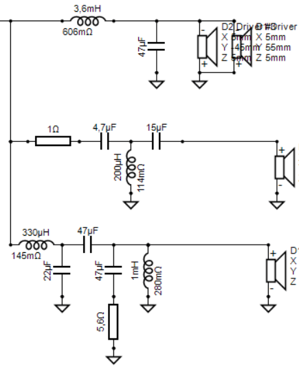

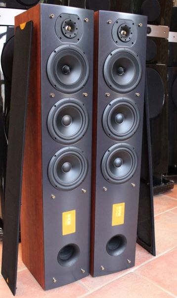

Sorry for the necromancy, this is the original schematic from the celius 202. (plus thermistors for bass/mid/tw)
For further improvement, because they have almost no bass at all, from my side is recommended to also pad the midrange a little. Originally they have only padded just a little the titanium tweeter and none padding to the midrange. The speaker has great midranger -you will read about the excelent midrange at almost any review- but no bass at all and a very hard for my tastes highs.
The titanium dome tweeter is something unique. Some love it, some hate it. I hated it, so I sold it.

...back. One of my mids voice coil/spider was misaligned. Could not fix it. My idea to replace it is:
Add two Tectonic TEBM54C30-8 driver (new - 4 @ $54.13 each) per speaker in an MTMWW vertical alignment with my Fountek X3 ribbons - per System7's writings. I chose the BMR mids because an earlier BMR mid is in the BMR Philharmonic which I think is quite special, and they are physically small which is necessary to get them into my speakers above the woofer, and still get the MTM alignment. I'll have to remove the original mids and tweeters to make room, and fashion a plug in baffle to mount the drivers on, and then in to fit the same space. its behind the grill cloth so doesn't have to be perfect looking.
The BMR is 8 ohms 85.5 db 1 w/1m. If I hook them in parallel it will rise to 88.5, but not drop under 4 ohms which is required. still not a match for the 92.5 of the tweeter and woofer, so I will have to decrease resistance to the mid xover to get them close. I will also have to fashion/buy enclosures for the BMR's.
My crossover is 12 db at 400 and 4k, not nearly as steep as the Philharmonic, but reviews seem to indicate they can handle my load.
Sound reasonable?

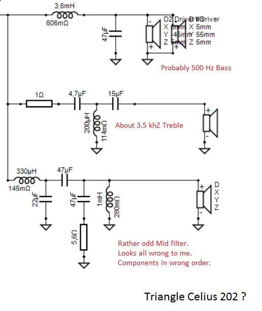

Hi Walt, you asked me what I think... LOL
First I am uneasy about the schematic that "vassilis1984" showed us:
Seems to match your cap and resistor values, but the mid section looks unlikely to me!

A complete rebuild into something resembling a splendid BMR Tower looks VERY tricky.
Looks like 4 ohm BMR fullrangers as mids, possibly wired in series.
That's a 8 ohm Scan 22W bass unit and a RAAL ribbon it seems. You could use other drivers, of course.

Be interesting to know what the midrange driver impedance or DCR is, but I can't see it helps. There is something odd going on somewhere.

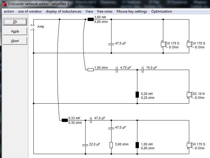

I just did a sim of the crossover with any old 6" woofers, and I got a rotten impedance minimum of 2 ohms due to the mid filter.
I don't make this up!
Just ignore the frequency response, which is driver dependent. I couldn't fix it without losing components, though I didn't try a notch. 😕

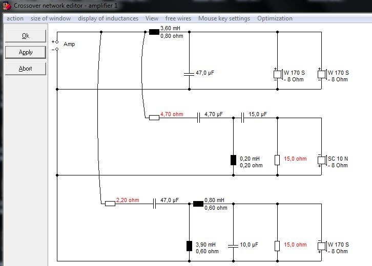

Just for interest I applied some established principles to the "questionable" Triangle Celius 202 speaker.
Without knowing too much detail... LOL.
My new overall crossover is something that the esteemed Mr. Troels Gravesen could have designed:
Fair bit of wriggle room on resistor values and level (marked in RED).

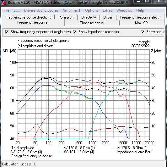

All smooths along nicely with Mr. Troels' approved BBC frequency response slope:
What is not to like! Much better impedance. No escaping the 4 ohm bass impedance of parallel basses, here in closed box. No getting away from the 5kHz breakup of the 6" midbass.
You will hear that breakup.
The 15 ohm resistors are cheap impedance correction, an idea I nicked from Gilbert Briggs at Wharfedale.
But that is how I would do this particular design. 😎
