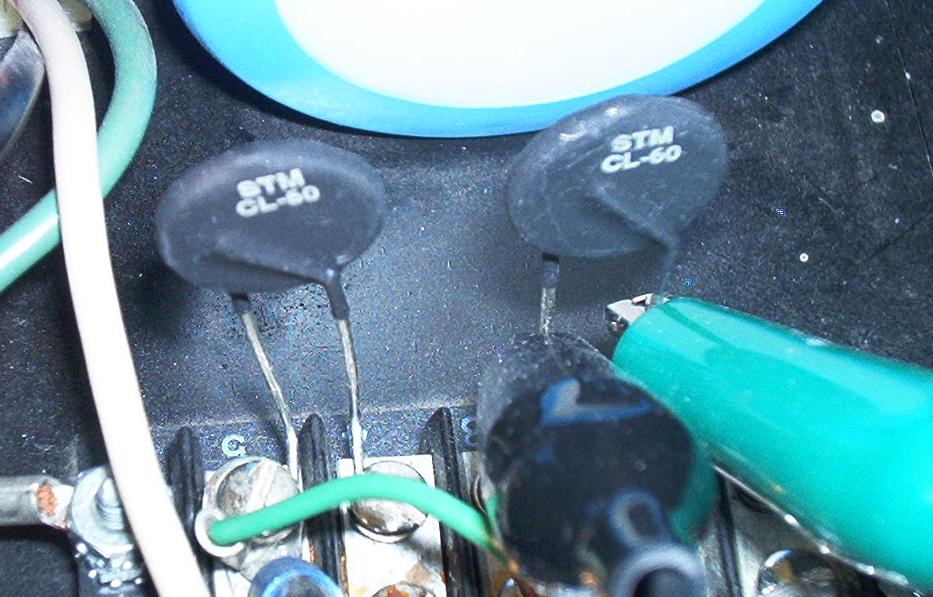

I'm using a pair of CL-60's and I measured them just over 10 ohms prior to installing them before the transformer, like 2 months ago.
I checked them with my multimeter immediately after power down today, and found that they measured around 2 ohms.
I turned off the amp and after like 5-10 minutes, they slowly reached up to 5 ohms but never returned to the original measurement.
It took like 6 hours for them to get up to about 5.7 ohms. I tested an 8ohm resistor I had lying around to see if something else was off, but my multimeter measured it just fine.
Is it normal for these devices to go out of spec?
The next thing I tried was leaving the multimeter connected across the thermistor, turned the amp on and turn up some music for a minute or 2. I got a voltage reading (slightly varying) of approx 2v AC. (us voltage 120v)
Any thoughts or input on this would be appreciated -thx

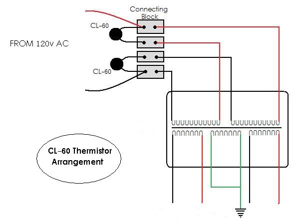

They are current inrush limiters. I am using them on the dual primary windings going into a PS Audio 200c.
Known ratings: 200w x 2 @8ohms/1000w x2@1.5ohms
Transformer: Hi-Pot tested @ 2.5KV, EI type. 2pair of primary windings fed from 120v US, 3 pair of secondary: +57/-57, 0/0, +57/57. The large capacitors are 10000uf x2 per channel.
I wanted to lower the arcing at turn on for the Relay = Magnecraft W199AX-9(40A).

You mean 57v ac x 2? (57v ac give about 80v dc)
What is that shorted secondary winding 0/0? There must be a mistake here.

Apologies, my vocabulary in electronics is limited.The 2 pair of windings prior to rectification would be +57/-57 volts AC. The center pair is paralleled and goes to a chassis grounded bus-bar. Indeed this would provide 80vdc after rectification (75vdc is needed for each channel). I think I'm saying this correctly?

Well that makes some sense, but according to that GE link on suggested usage, based on capacitance, I would need like 2 per cap = 8 x CL-60's. Then again, my arrangement looks nothing like the model. The arrangement I'm using is like the Nelson Pass burning amp, prior to the transformer, not after rectification.

Thermistors on primaries are enough.
The inrush of an EI transfo is not as huge as the inrush of a torroidal one.Though yours is really big. (it must weigh a ton)
When the amp is at idle or playing not loud, the current drawn is little, that is why the thermistors do not really heat.
Yes, unsolder one to measure it.
A condenser of about 0.01uf /250v across the contacts should reduce the sparkle.
Thermistors in primary windings makes the transfo surge smaller, avoiding to blow the main fuse.
Thermistors in secondary windings avoids overloading the rectifier when caps are charging. It is sometimes used in class A amps where capacitor values are high. Which is not your case.
When i say 2 cl 60 in series, it is to make the resistor larger, not for current purpose.
I took out the thermistor and re-measured it. As it turns out the device is fine, I didn't account for paralleled resistance, which is why I got the low reading.
When I measured resistance across one, I was actually picking up the parralelled resistance of both.
I think they heat up just fine at Idle, dropping resistance almost instantaneously.

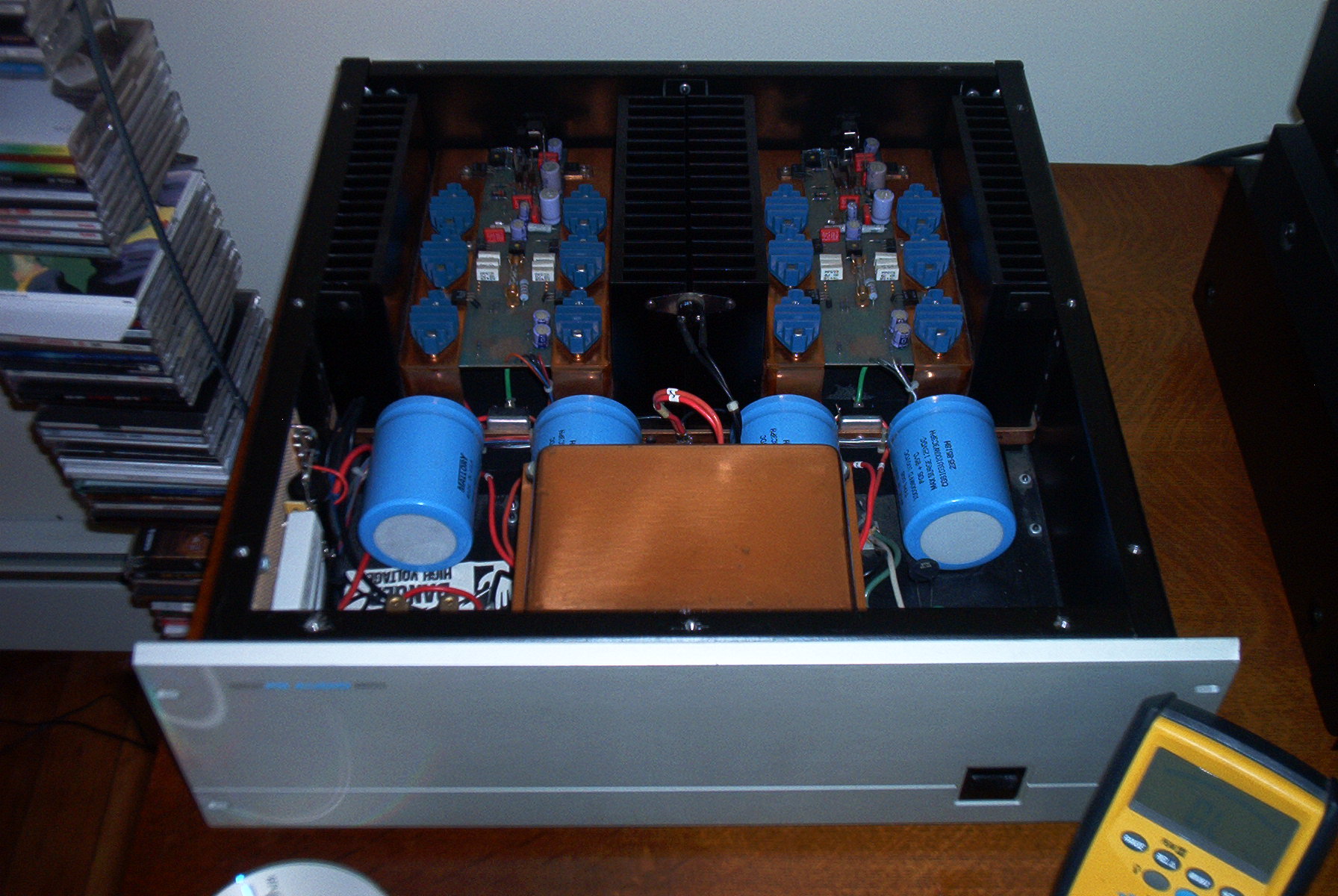

And yes, the transformer is pretty huge for this type, weighs almost 30 pounds.

The thermistors simply replaced the screw down jumpers on the distro block, so I just made the ends into tight eyelets and screwed them down in place. They sit in place just right
Thanks, it's kind of cool looking I think. The sound is extraordinary.

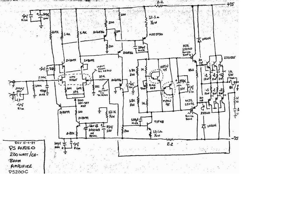

I don't know whats possible with a 2SB600/2SD555 combo x 6.

Ah I dunno, somethin still seems odd. The schematic is for 1 channel, so that their are actually 3 pairs of 2SB600/2SD555. You said they we're 150w devices, which to me means what 6 x 150 = 900w/channel? I've seen them spec'd out at 200w each which might make sense as an absolute max but I can't imagine the amp would last long used that way.
So the 1000w x 2 might be truly optimistic but not very realistic as you say.
But then again I don't know what any of it means 100% -lol
peace
Taking into account that speakers are reactive loads and the possibility for the heatsinks to get warm, I would evaluate about 150w/ 4 ohms/ pair in order to stay within SOAR limits.
