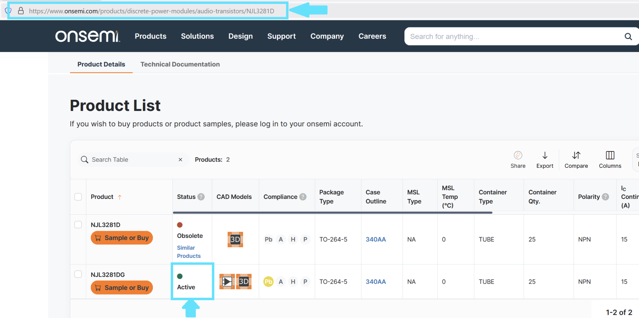

I also checked the manufacturer's website, onsemi.com , and they are shown "Active Production" there.

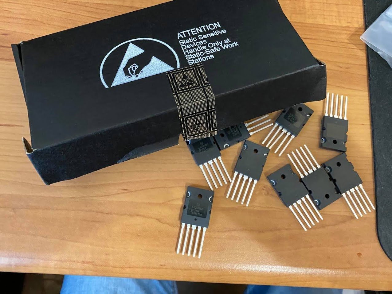

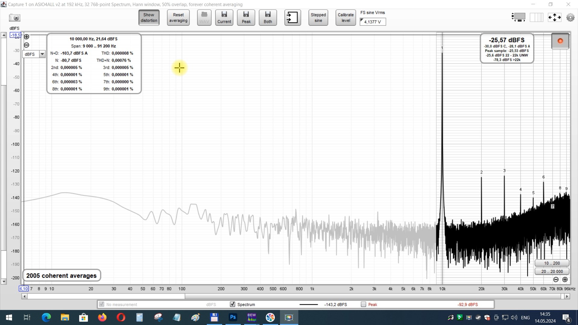

I bought 25 of the NPN and the PNP , date coded 2024, a few months after the discussion here and after I failed to get responses from OnSemi or the end manufacturer I wrote to. I've done a lot of work with them since, culminating in a good working amplifier and a lot of curve matching of parameters for future designs. I'm preparing a 'missive' which I'll post here when done. I definitely echo Bob's words above.
Reactions: mlloyd1

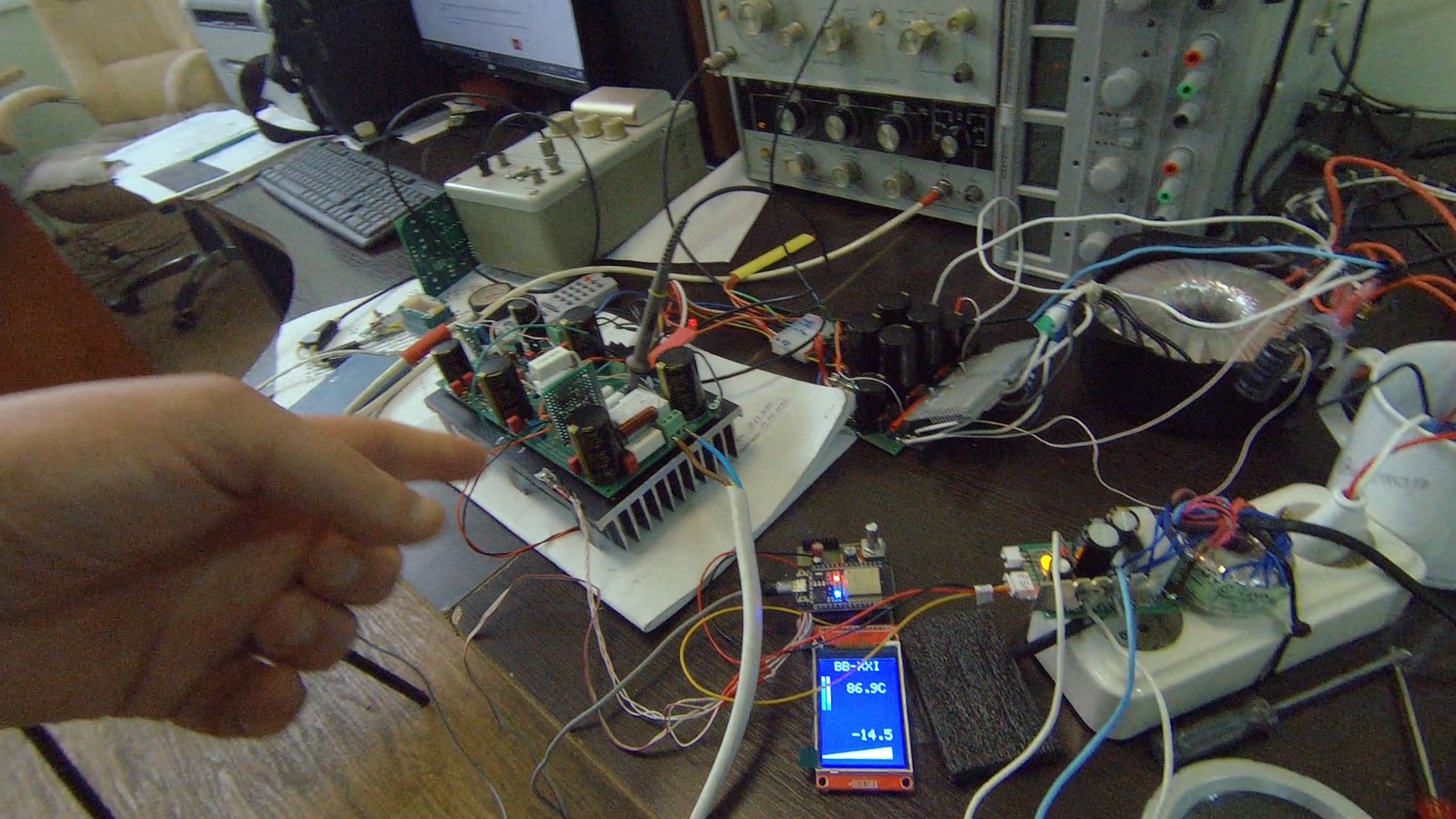

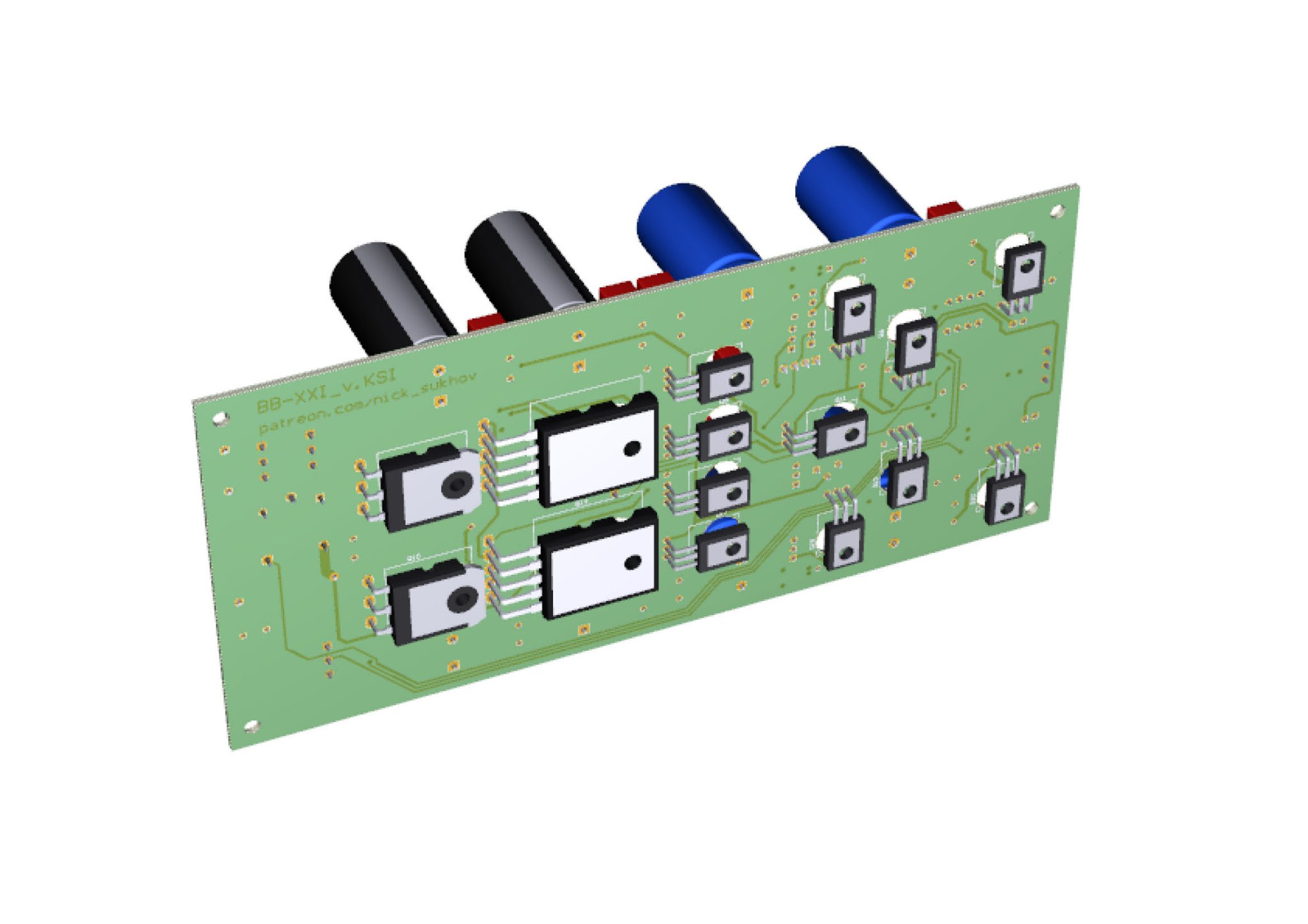

Thank you Bob for this advice - I had overlooked that.
The use of SAP/STD darlington versions may have been the main reason for the unreliability of the amplifier models in the previously mentioned thread and the replace by single transistor versions like NJL3281DG and NJL1302DG provides the wanted reliability.
Adding the driver transistor in the form of free wiring should not be too much of a problem.
