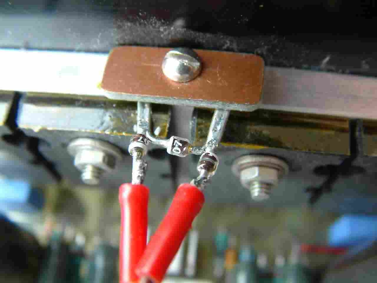

1) select an epoxy package diode like the 1N4004 with a (guess) 4 C/watt "physically direct attach" thermal conductivity
2) slip teflon insulation tubing tightly on the diode interconnect leads
3) put high-conductivity epoxy glue around the diode
4) Wrap the bipolar output transistor collector output metal lead around the diode_body+epoxy (Clamp until hard)
5) use low electrical resistance, low'ish thermal conductance tin wire to attach/thermally_isolate this collector+diode lead to the PCB.

By gluing a diode connected sot23 transistor to the Collector lead of the output device, right next to where it exits the package.Using diodes, what is the best way to mount them next to the transistors

Having the diode monolithically implemented on the same die would have been great, but breakdown and isolation problems intervene. In practice, the sensing diode in the ThermalTrak is mounted on the same copper header as the power transistor die. This still gets it much closer thermally to where it wants to be. Attaching diodes to the case of the power transistor is better than to the heatsink, but a far cry from the thermal tracking performance of the ThermalTrak diode.
