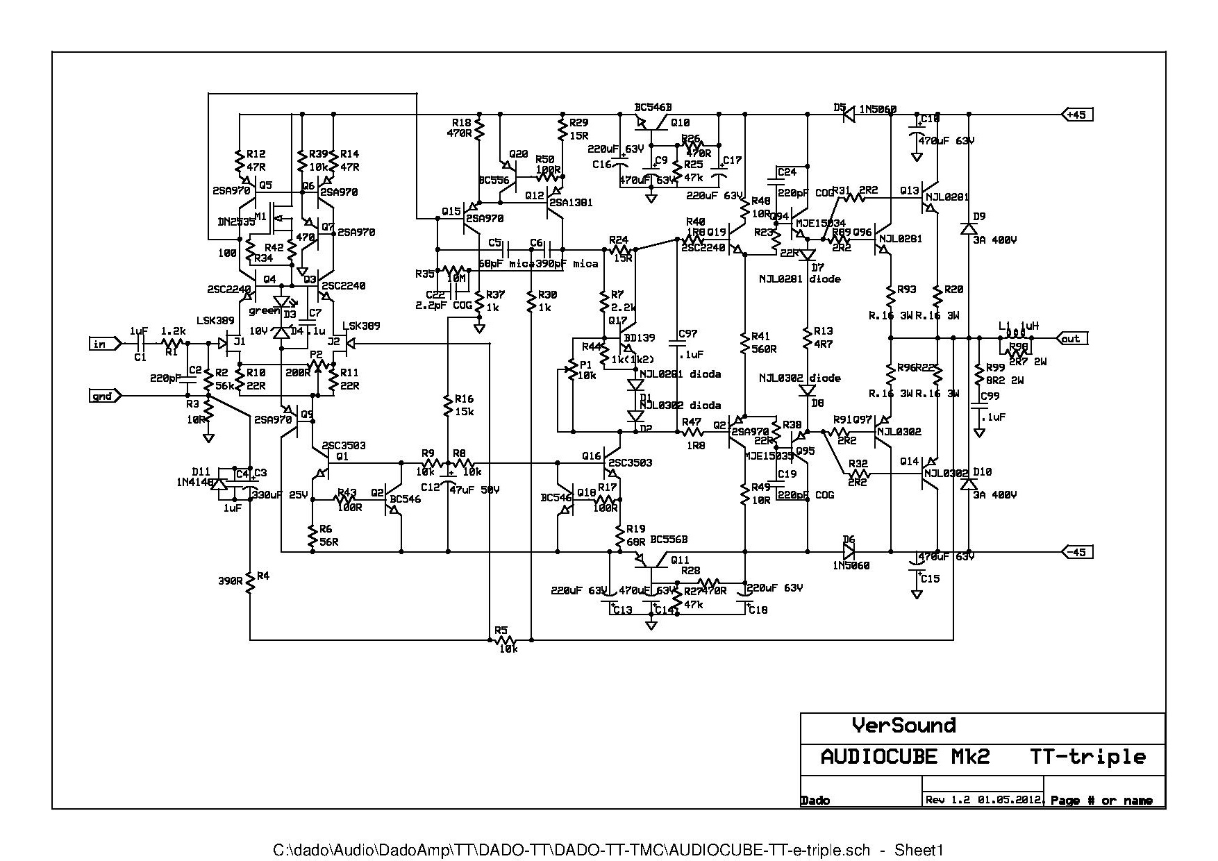

I replaced D4 LED with 10V zener, and now there is about 10V source-drain, better working point for LSK389. I could not hear any difference between previous version(3V source-drain) and this one. It did not increase noise, I put my ear close to the loudspeaker and heard nothing.

this is not the usual way to define noise.It did not increase noise, I put my ear close to the loudspeaker and heard nothing.
Of course not, I will measure it, but to compare with previous version is good enough. A pleasure wile listening is a goal.
But a very practical. 🙂
You can also compare amplifier. Take a 25 kHz sine signal and play it at full force. I think that you cannot hear the 25 kHz signal, but the rest like noise and hum.
I did measure Signal to Noise with 8 ohm load:
Signal/noise = 109dB reference to 1 w output power.
I used my audio milivoltmeter with 1mV full scale and it barely muved and showed 10uV so it coud be that this result is not very accurate but good enough to show that this amp is very very quiet.

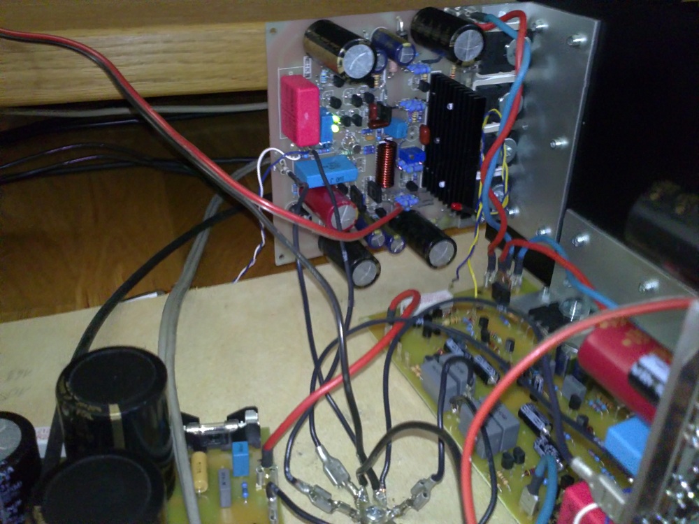

During this measurement I noticed some very small 2MHz oscilation(cca 0.5 mV pp, but only vith the load connected(that was not showed on the milivoltmeter as it works up to 100kHz). It looks that it is provoked by the feedback from the output wires passing over PCB. It not influences the sound(at least I coud not find any) but I intend to change internal loudspeaker wiring and use shielded one, but not sure what to use for that kind of the current.
dado
Twist the speaker wires. The flow and return must follow the same route for the whole route.
Yes I know that is important, I used a loudspeker cable for that. The problem is that the loudspekar PCB output is in some distantce from common power ground were the loudspeaker ground wire is connected and in that part the wires are separated. Attached photo shows that before I put the into the box but the loudspeaker connection is very similar.
dado
I think the return route of the speaker cable must follow the trace route that the speaker output current follows and then continue on to the final connection at the star ground (Main Audio Ground) This would require the Return lead to follow the underside of the PCB to be as close as possible to the trace that carries the current.
Note that if this is not done both the flow current trace and the return current cable will both affect the low level circuits in their vicinity.
It will easier on some PCB layouts for this to be achieved. On some PCB layouts this "following" may be close to impossible. That would be a failing of the PCB designer to recognise that currents flow in loops and that the "loop area" of his traces will affect the performance of his PCB design.
