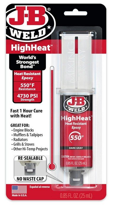

JB WELD two-part high-temperature epoxy will do the job and THEN some. The work must be clamped. Thermal transfer is exceptional into steel, copper and aluminum. The problem is, it is a one-way ticket. If you want to undo the bond, you will destroy some portion with a grinder or such.LM1875 TO220 packages in a small, lightweight board. The large heatsink I have is more than adequate for thermal dissipation for the amp, but it is not drilled and I don't have the tools for drilling and tapping to be able to screw the LM1875s to the sinks.
I see thermally conductive adhesive glues and even adhesive tape advertised. If I supported the weight of the boards in the case with standoffs, would the thermal adhesives do the job of conducting heat effectively to the sinks?
If you want it to bond faster, apply heat during the set-up. Or wait overnight.
You get metal powder filled two part adhesives, that has been used as thermal adhesive for a driver on board LED bulb circuit by me.
That has to be broken to remove, the lamp circuits are very cheap here, about 10 Rupees for a 220V / 9 Watt unit.
I would use a less permanent method on a chip amp.
Work around is to coat the chip with a release agent like mold release spray, or waxed paper, so it will not stick, the adhesive will work as a gasket, filling gaps.
In fact, the red high temperature silicone adhesives used for head gaskets will also work, and are easier to take apart.
