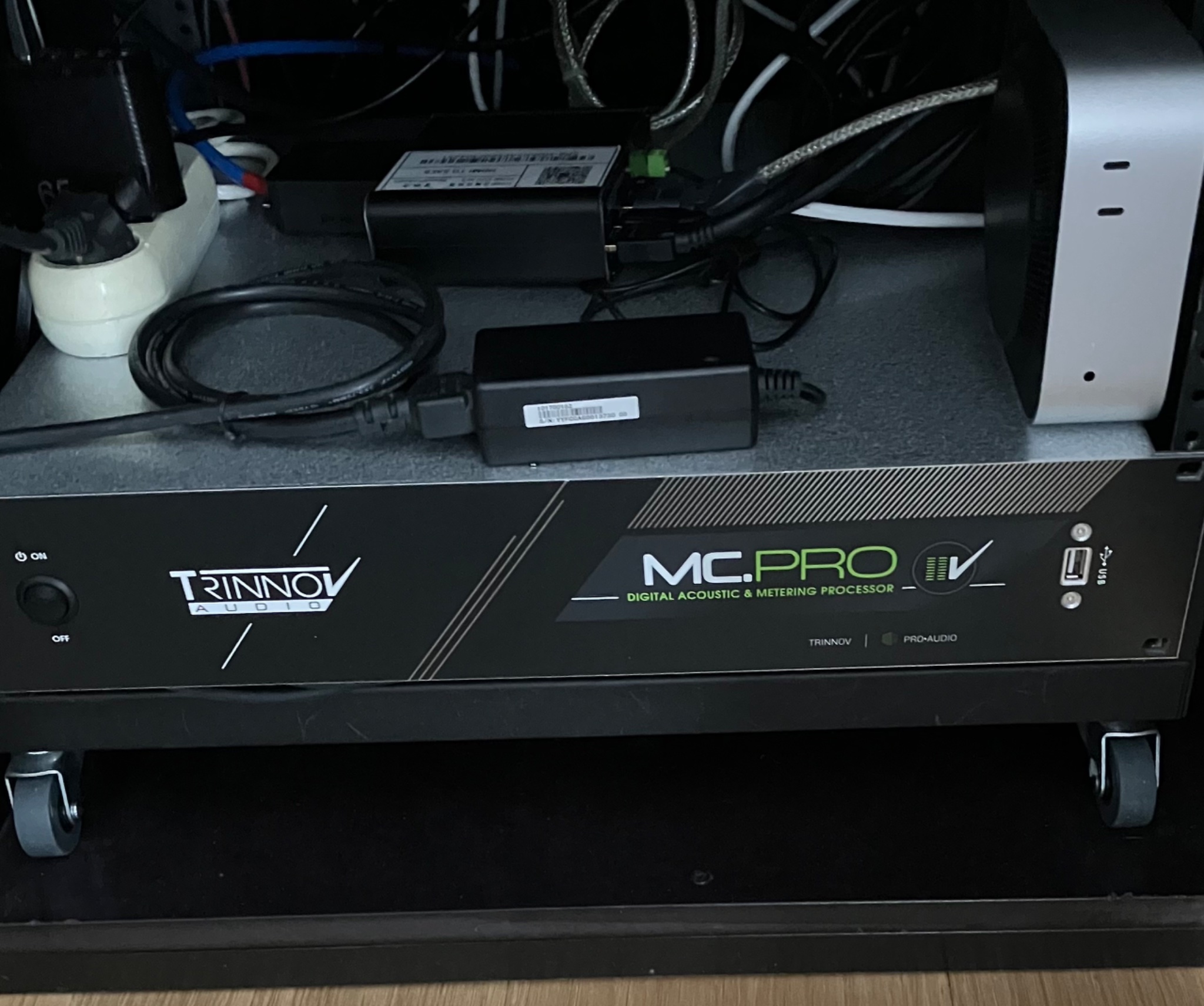

Hi @yulen, I’m interested in purchasing your Black Box and I’m wondering if it will accept an HDMI eARC signal from my 77” LG B4 OLED?
If so I’ll connect it to my Tannoy Ellipse 10 iDP & TS212 iDB 5.2 studio monitor system which has 3x stereo 24/96 AES/EBU XLR inputs.
I’m new here and I don’t seem to have an option to private message you, feel free to message me to discuss if you’re able to, thanks 🙏🏼
