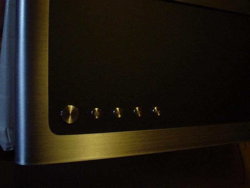

Okay.. time for a new update. Been a while since the last one but I don't have much time to work on this project at the moment as I have moved to a new town to sudy. But on the weekends I usually take a trip home to work on it, and this is the work so far. I took some more pictures this week but I forgot the memorystick with all the pics :wallbash:. But I guess this will be enough for so long.
This is how the buttons turned out. The power button has not been mounted on the picture yet, but it is fabricated. The original "power" (1/0) symbol was to hard to do. I tried different symbols but the non of them loocked any good. So the power button will be totaly clean without any symbol. Also the "menu" symbol was changed to a ( - ) sign.
(tft power / left / right / menu)
(CLICK TO ZOOM)
(CLICK TO ZOOM)

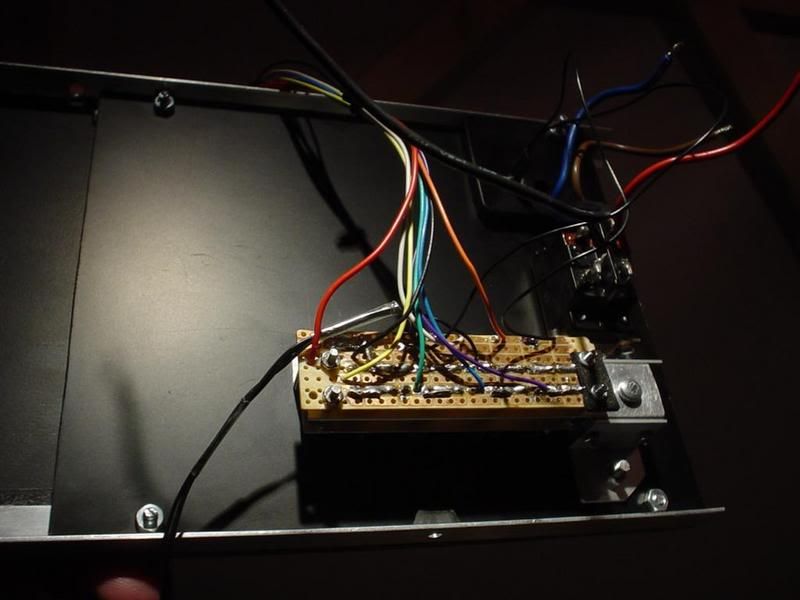

The button electronics needed a makower to fit my design. I don't think I need to say witch one is the "new". The black little thing in the middle is the IR-sensor with holder.
(CLICK TO ZOOM)
my soldering pen isn't the best, but atleast it works.
(CLICK TO ZOOM)

This is the "airhole" for the fan that will cool the TFT display. The electronics on the side is the 240v-->12v converter, to power the TFT and the fans.
(CLICK TO ZOOM)
Kind of hard to see but this is the mechanism for the front mainpower switch. Mounting it as it is suposed to (in horizontal position) would have been impossible because it was blocking the bottom fan. So I hade to create this little "angle". Forgot to take pics before putting it all together but when you push the button(the larger cylinder) the original switch is forced upwards (to the right in pic) and it turns on/off.
(CLICK TO ZOOM)

Bit of dark pic of the buttons. That larger button is the mainpower (pic #2) for TFT and LAMP. It turns on the lamp and tft at the same time.
(CLICK TO ZOOM)

Time to fire it up..Hope I got the wiering right.
IT WORKS!!... First time ever I have been so happy to get a blue screen. It shows that the tft and all the wiering works. The blu led is lit when the whole projector is switched on, the red one is lit as long as there is a power cable connected and the main power switch on the back is turned on. They are not as bright as in the pics, and they are stealthed to not be vissible when they are turned off.

The internals at the moment. Most cables sorted out..but there is a little bit more tidying up to do. Btw the heatsink on the light box is removed temporarly...it created a little mis fit with the lid.
(CLICK TO ZOOM)

FINALY.. I have got some result pics to show.
the image is projected on a white wall.. It is relly not the best option. I would rather have used my projector screen that I made a couple of months ago, but I dont have acces to that at the moment, because this is just a temporary home. So It will have to do for now.
The image size is around 70" i would guess.. you got a cd in the uper right corner in some pics to get a feeling of the size.
The resolution is 800x480 on the screen but my desktop is at 1024x768 on these pictures so thats why there is a little bit of blur on the closeup shots of the text.
There will be more pictures to come. But this will do for now 🙂
Was hard to take good pictures that gives a tru image of the brightness. But I think these where most "relistic" ones.
