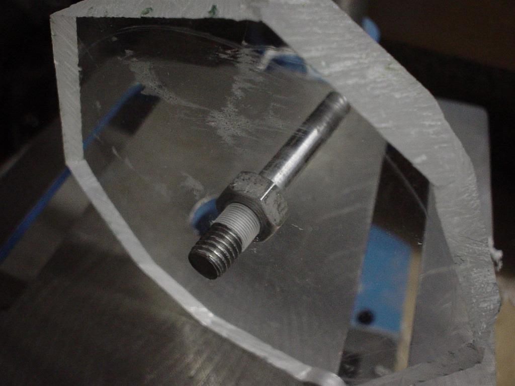

Here is the 13mm plexi I got for free. It's from when we rebuilt at the supermarket I was working in. Its a cashregister "booth".
(CLICK TO ZOOM)
(CLICK TO ZOOM)
cut a piece and drilled a hole in the middle that is threaded and inserted a cut of bolt.

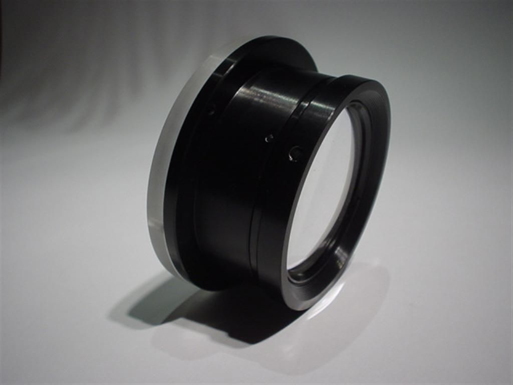

I have also made a second smaller spacer for the triplet lense in the same way.
(CLICK TO ZOOM)
triplet lense with small spacer.

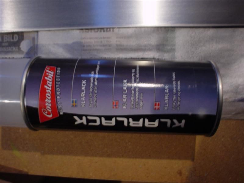

one question... what kind of transparent spray did you use to give the brushed aluminium surfaces the grease-resistant finish?
You wrote it was a spray for this special purpose - but i didn't find such a aluminium protection spray in my local stores.
Do you have the name or any idea where to get such a spray?
Perhaps I could also use normal transparent spray.

The Spray I used was a clear-coat spray for aluminium car rims. It feels a little bit thicker than normal clear coat but I'm not shure. The brand is "Corrostabil" and it seems to be one of their sprays in the "rust protection" series. I guess you will find something suitable in the car spray shelfs as those sprays seem to be a little bit more heavy duty. Try different clear coats on a spare piece of alu or whatever you will use it on. I think I tried 3 different types before I found this one.

Thanks for the spray img 🙂)
Will try to find it ... or sth like it.
