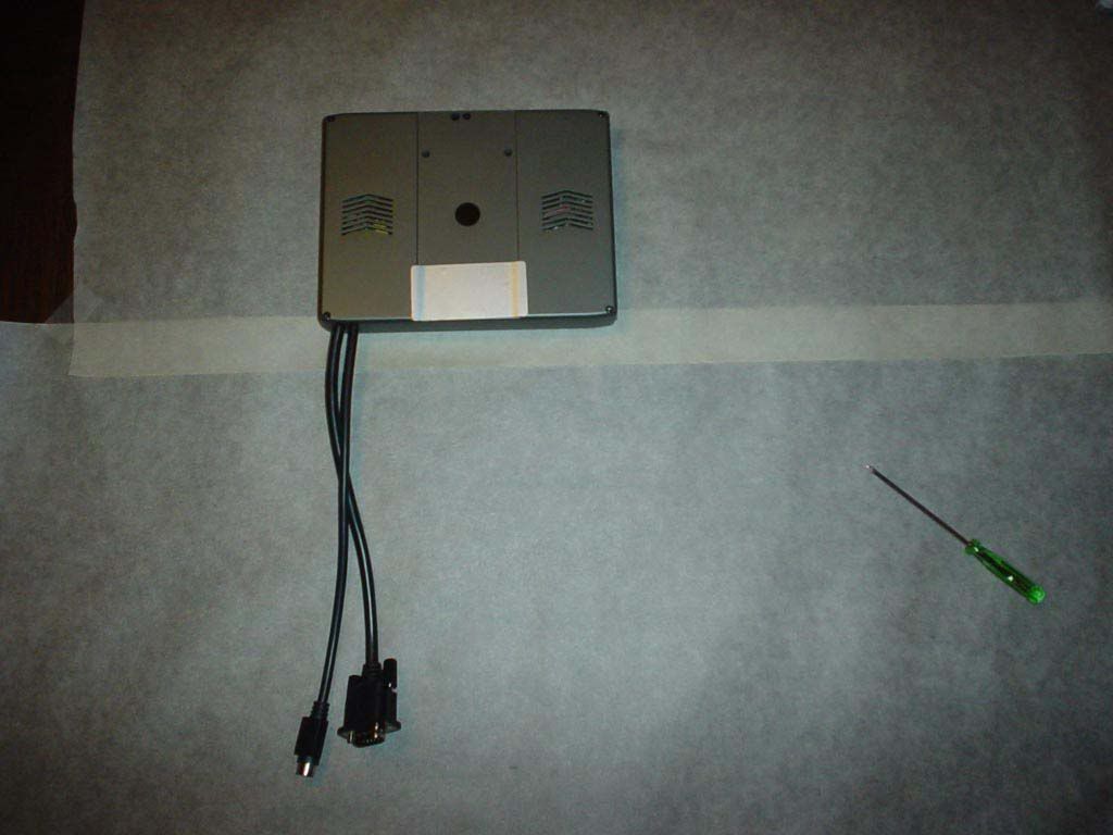

Time for some pictures of the 7" TFT and the TFT holder.
The native resolution is 800x480 but it is able to handle 1280x1024 interpolated. That means that the pixels are 800x480 but compared to normal TFT displays you can use a resolution higer than that. With hig resolutions like 1280x1024 you get a slight blur , but it works great with 1024x768. All the text on a web browser is readable.
Further data:
- PAL/NTSC standard (SECAM is not supported)
- 400 nits translucences !
- 200:1 contrast !
- 30 ms response time !
- 12 V input - 1000 mA
- Widescreen format
- over OnScreen display adjustable (AV1/2 and VGA)
The response time is claimed to be 30 ms. That normaly means a slight ghosting but I can't see any ghosting what so ever. Ben playing Counter-strike source , car games , and watched Fast motion action movies and I can't se any noticable ghosting. Hard to see any differense compared to my BENQ-FP567s with 16ms.

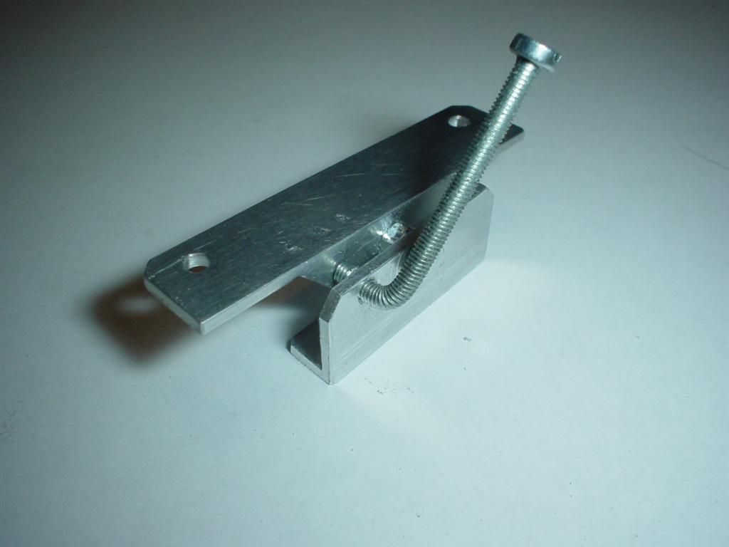

The mounting bracket again, but i need to moddify it a little bit to be abble to create my TFT holder.
(CLICK TO ZOOM)

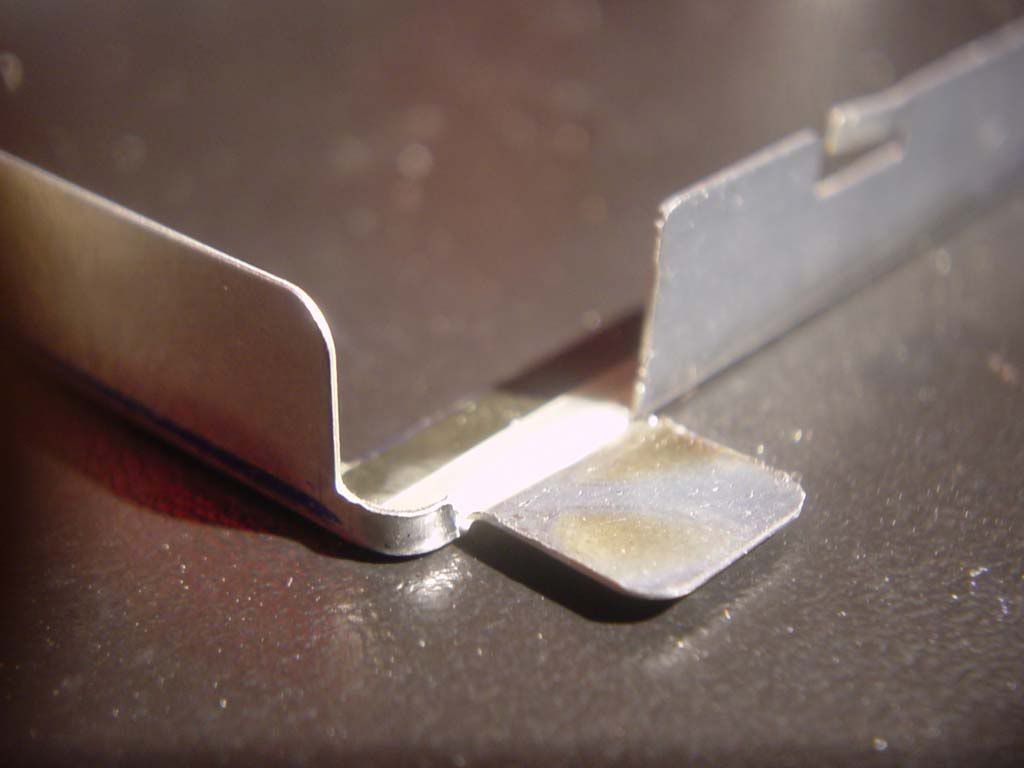

Made 1 cut with the dremel and bendt a little piece of the frame.
(CLICK TO ZOOM)
This was made in each corner and holes where drilled.
(CLICK TO ZOOM)

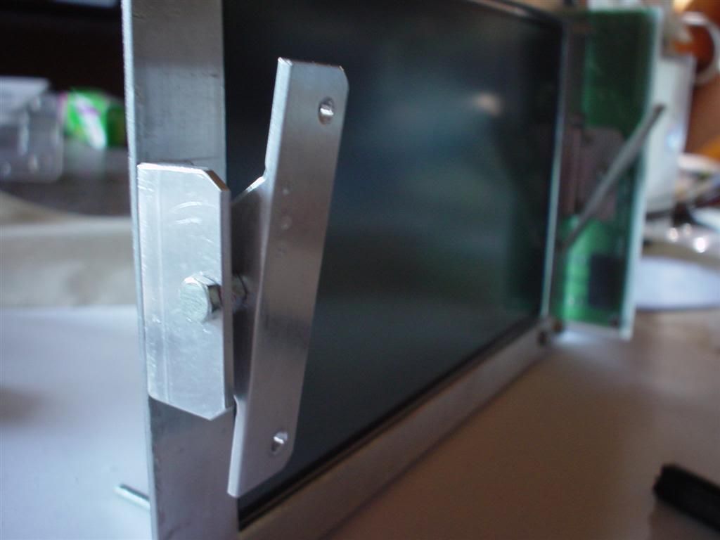

..attached to the mainframe and marking out where to cut.
(CLICK TO ZOOM)
(CLICK TO ZOOM)
Here you can se the controllercard supports. One for the larger one and one for the smaller. It is made out of some of the plexi I got for free. These parts are from document holder so I didn't need do create the bends by myself. was just lucky 😀
(CLICK TO ZOOM)
(CLICK TO ZOOM)

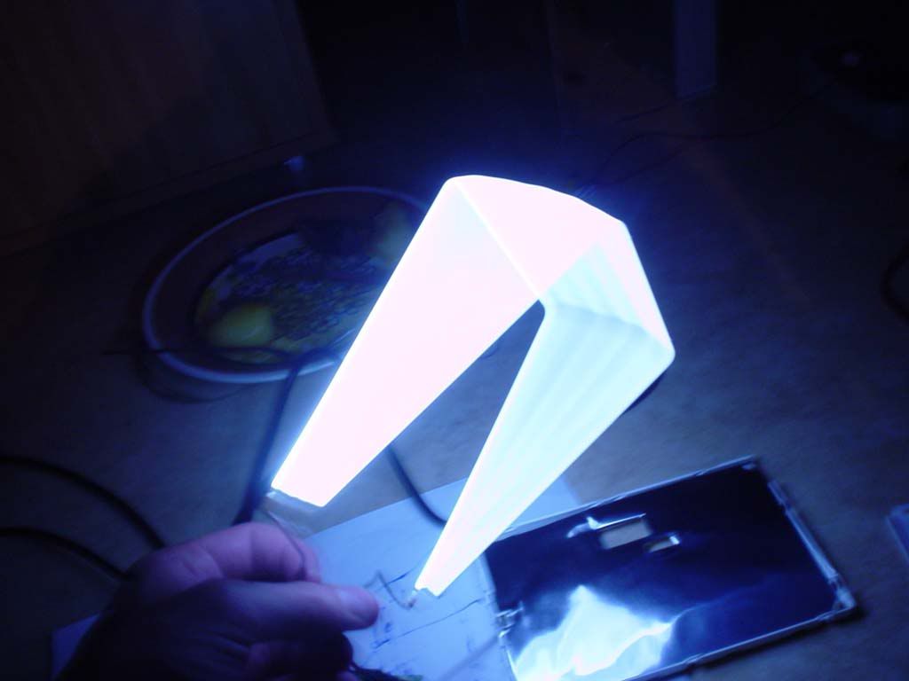

a little bonus... here is the backlight CCFL. You bet I got some ideas for this in my future projects....
(CLICK TO ZOOM)
Bzzzzzoooomm....bzzzooom....almost makes me feel like Luke. 😛
(CLICK TO ZOOM)
(CLICK TO ZOOM)
(CLICK TO ZOOM)
(CLICK TO ZOOM)

Here is my keystone mechanism. One on each side. These will hold the Front fresnel lens and allow me to tilt it.
(CLICK TO ZOOM)
(CLICK TO ZOOM)

To be able to lock the lense in different positions I bent this M3 screw to a 90 degree angle and drilled a hole that I threaded to M3 size.
(CLICK TO ZOOM)
And..voila.. This works as a lever...turning it, it will press the top L-bar and it will stay in the desired position.
(CLICK TO ZOOM)
