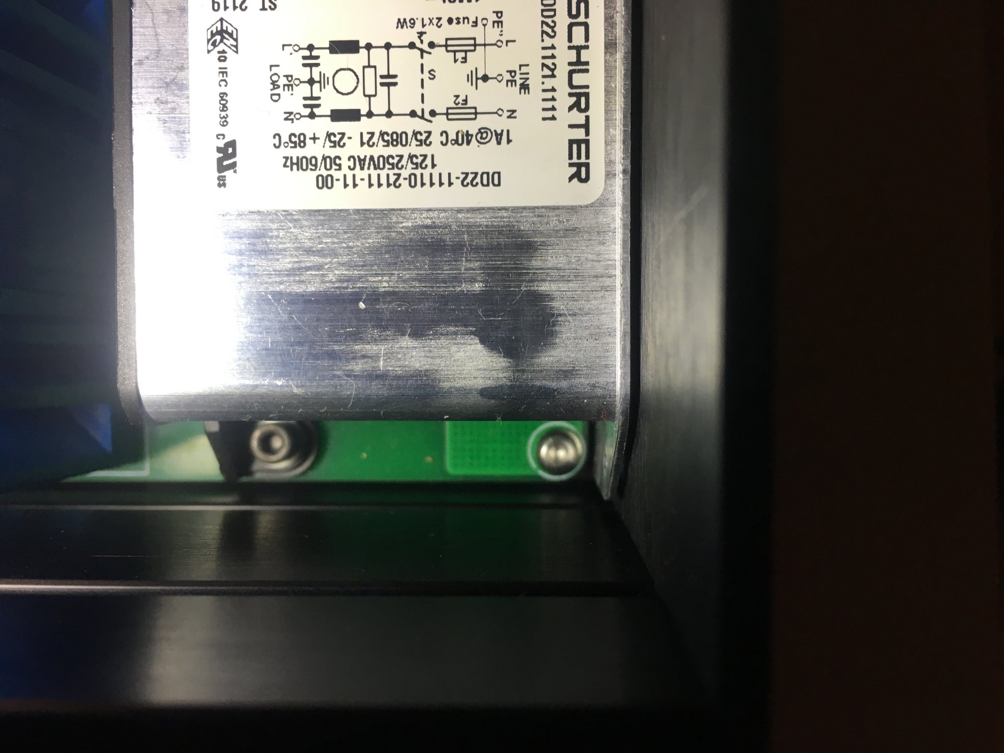

Don’t forget to connect the chassis metal (floor plate) to the earth ground wire. Sand away the black anodization and attach a crimp loop connector with screw to floor panel and connect at the screw on the
main board as you have now.
Yes X, thanks for the note. The only point to the chassis that I have connected is the spacer of the screw in the photo. I have sanded the black paint off the base and tightened the hex spacer so that it is "nailed" directly into the aluminum base of the case. I have also checked it with the continuity tester. I think this is what you were referring to.
Greetings
Greetings
That is the only point I have earth ground chassis connection also. My Yarra main board connects to chassis ground via a single wire connected to the ground tab of the IEC metal housing. I prefered this rather than using a metal standoff connecting the MB to chassis.
Ok - good you have connection. I think for safety, electrical code in some regions require a dedicated wire from IEC ground tab to a lug or screw on chassis ground as screw or stand-off alone is not as reliable if it ever became loose.
Yes X, I think what you explain is correct according to regulations. But since the aluminum creaked, when the hex standoff dug in, I don't think we need to worry about that connection failing. It is true that if I had to do it again, I would surely include it in the initial construction approach (according to regulations)
