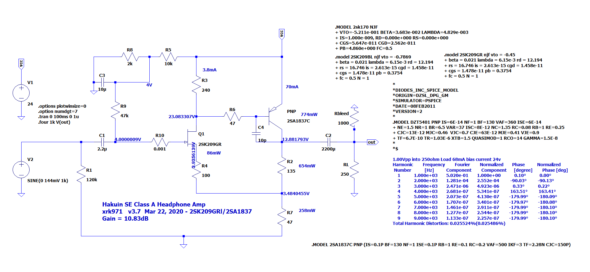

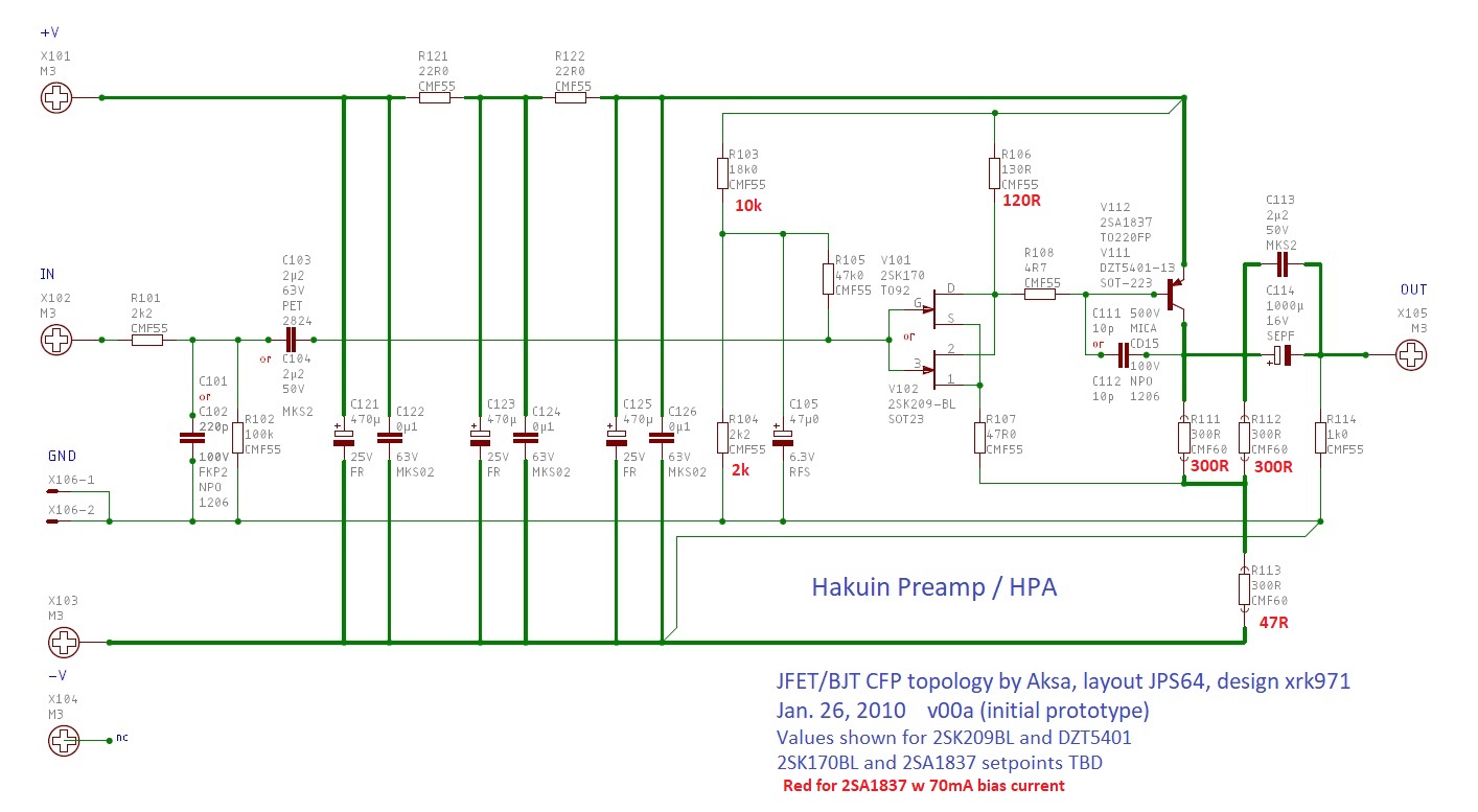

An LTspice model for the 2SK209GR is not available, but I talked to Keantoken who said that it is close enough in shape of response to BL, just vary the Vto value in the model to drop the Idss down. So I changed it manually to get aboiut 4mA Idss vs 7mA Idss of the BL. This resulted in the following resistor setpoints that changed: R3=240ohms, R4=100ohms. This gives about 10.83dB gain and similar harmonic profile and THD values as with the BL. So now we can go crazy and buy 100 tape roll of the GR's for21.5 cents ea. You will have enough for many projects to come.

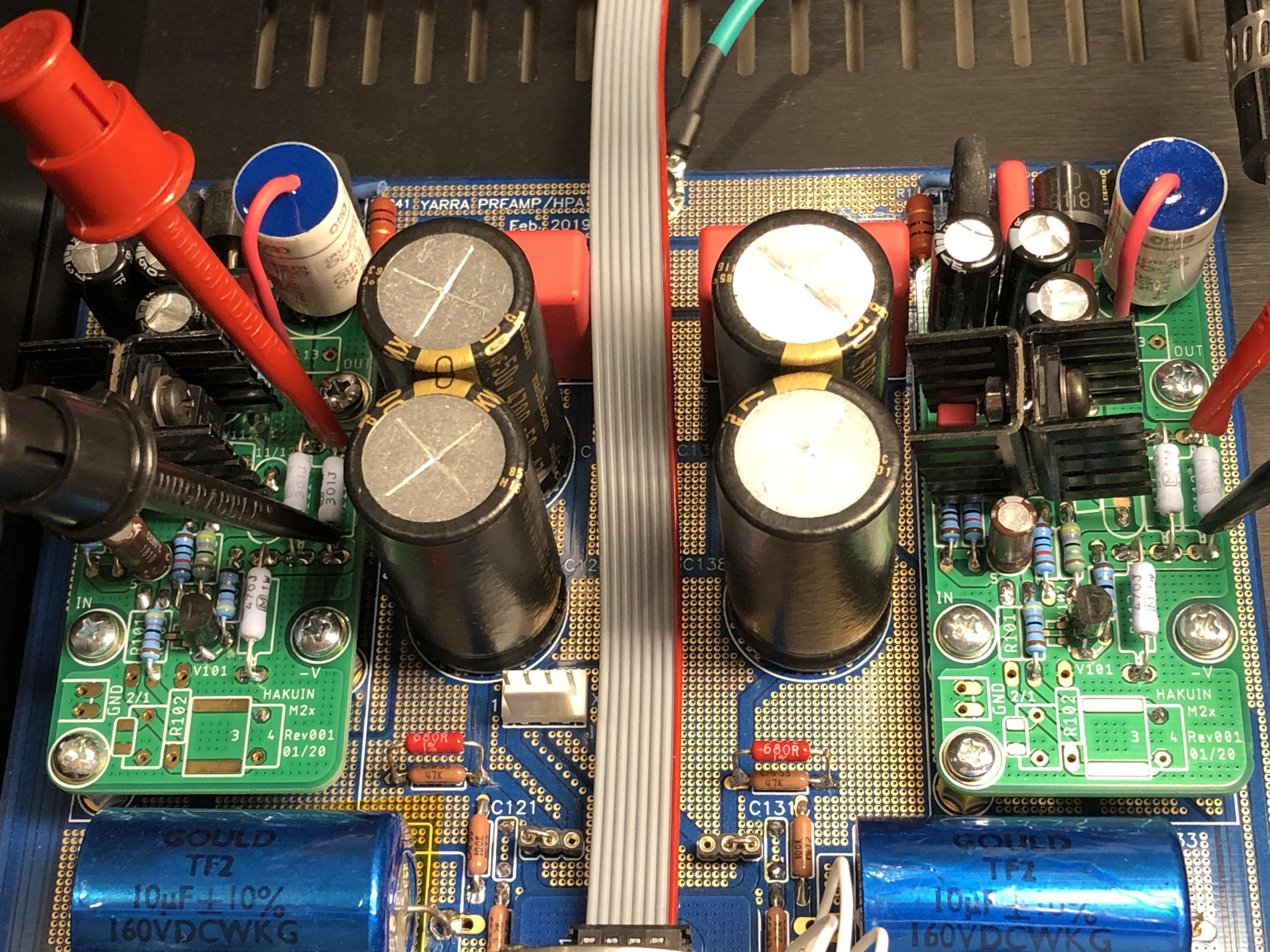

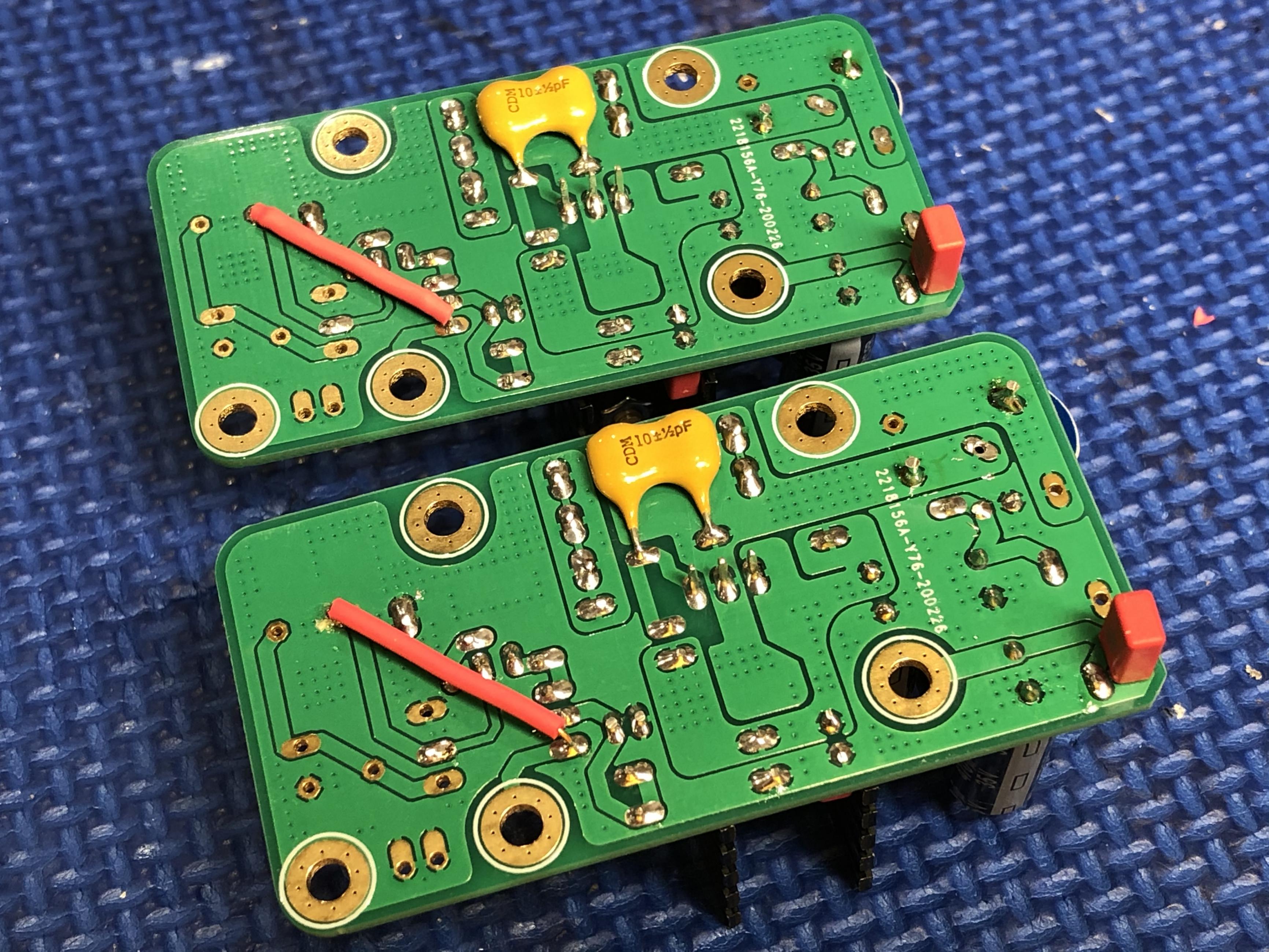

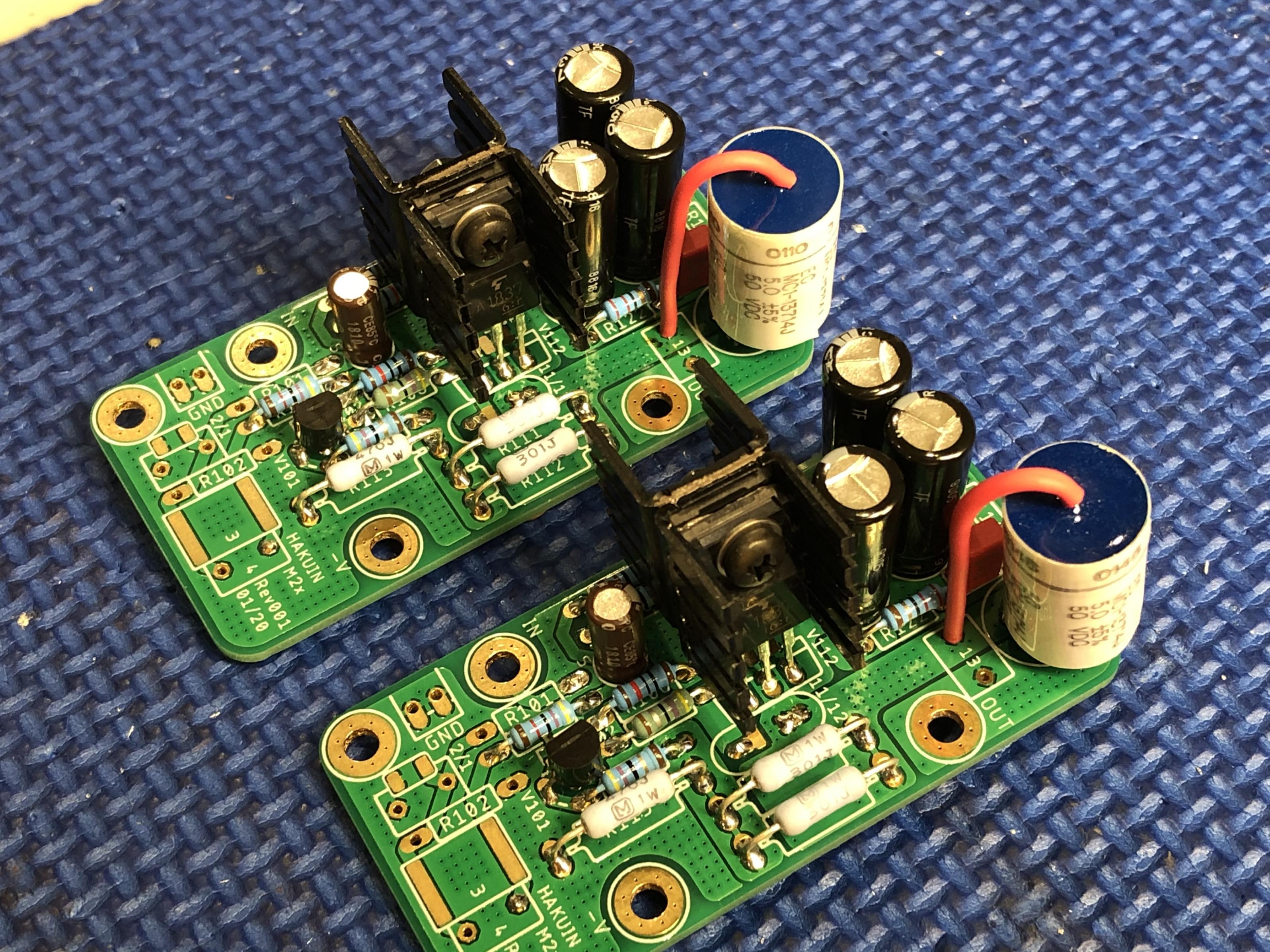

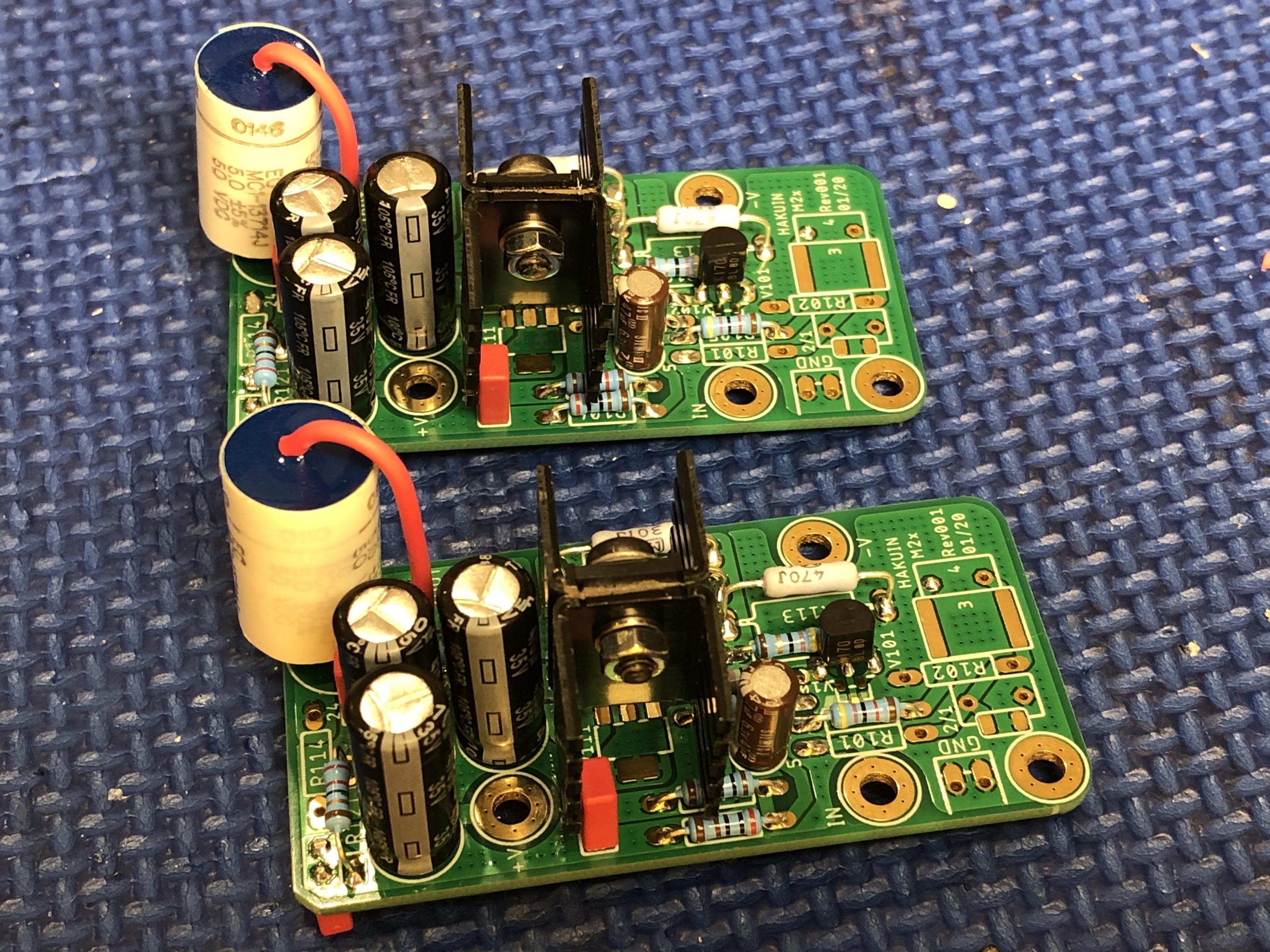

So to keep busy during this spare time, I went to work on the Hakuin M2x boards. I used the exact Mouser cart from post# 1224. Since these Hakuin modules will be used strictly for preamp duty in the Yarra, I eliminated a few redundant components the main board already has. I used the adjusted resistor values for an all ‘Vintage’ Toshiba edition. (Right on GaryS 😀)
Yarra rail voltage is 28.5vdc feeding the Hakuin, after its onboard CRCRC the voltage drops to 24.5vdc. Voltage across R112 is 11.9v, that’s good for a tick under 80mA bias. I strategically placed a few components on the underside of the pcb to allow clearance for the 2SA1837 heatsinking and to give R121 room to breath, it gets a bit warm.
C113 and C114 were not populated at first because the Yarra main board is cap coupled. But, I noticed a slight DC spike when powered on and off. Installing a 5uF film cap in C114 totally eliminated the DC spike and offset is now rock solid hovering at 0mV.
First listening impression is this circuit is extremely quiet with a deep black background. The Yarra/Hakuin preamp combo is now in my main system so it will be getting a heavy workout in the coming weeks 😀

Note that depending on the value of the bleed resistor you are driving, a 5uF cap at C114 will have a bass extension response equal the 1/0.7RC time constant. A 5uF cap negate any big 2000uF cap you have downstream in the main board to nominally, about a 5uF cap value.
DC drift without the 5uF cap just means that the time constant of the large cap is so big, it drifts over time due to the bleed off resistor being slow. You want that time constant to be of order 1/10second or 10Hz.
Assuming a 1kohm bleed resistor and 5uF cap, that will have a 185Hz for a -3dB point. You will notice soft rolled off bass.
I would suggest at least 100uF cap for 1k bleed resistor to make sure -3dB is at 12Hz.
But if your bleed resistor is 10k then you have 29Hz F3.
I think that maybe the best thing to do is have no output caps on the main board and let the daughterboards each handle AC coupling in their own. That way, DC coupled amps like Melbourne and WB18 can run unfettered by any cap induced bass fall-off.

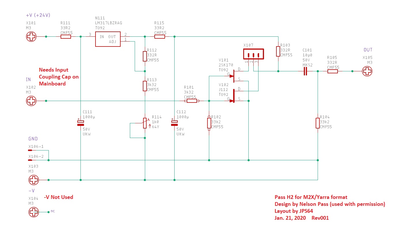

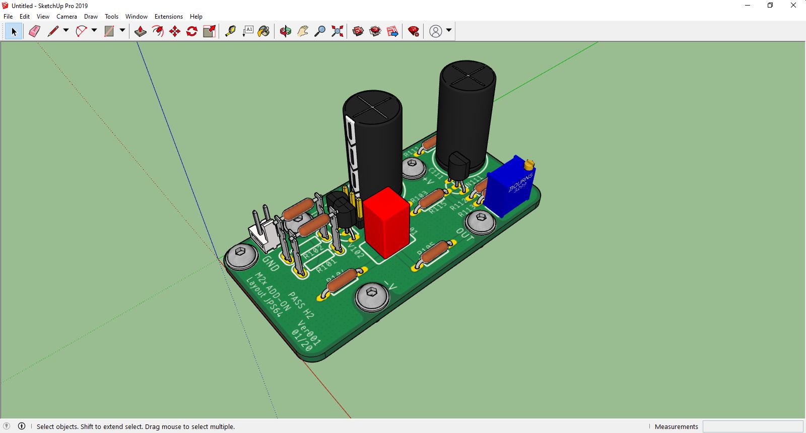

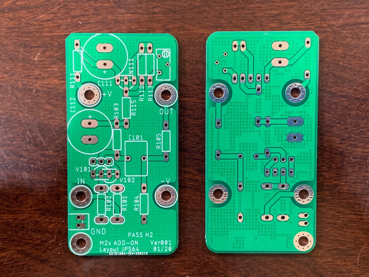

Pass H2 implemented in Yarra/M2X compatible format
JPS64 designed the Pass H2 circuit (with Mr. Pass' permission) and here are the boards - just arrived from the factory. I soaked them in diluted-bleach water and detergent for 5 minutes and dried before touching them 😀
The Gerbers are freely available for this project (send JPS64 a PM if you are interested).
824851d1584173707-h2-pba-top-jpg
attachment.php
Schematics:
https://www.diyaudio.com/forums/attachments/pass-labs/824852d1584173707-h2-h2-m2x_sch_001-pdf
Stuffing Diagram:
https://www.diyaudio.com/forums/attachments/pass-labs/824853d1584173707-h2-h2-m2x_pba-top_001-pdf
