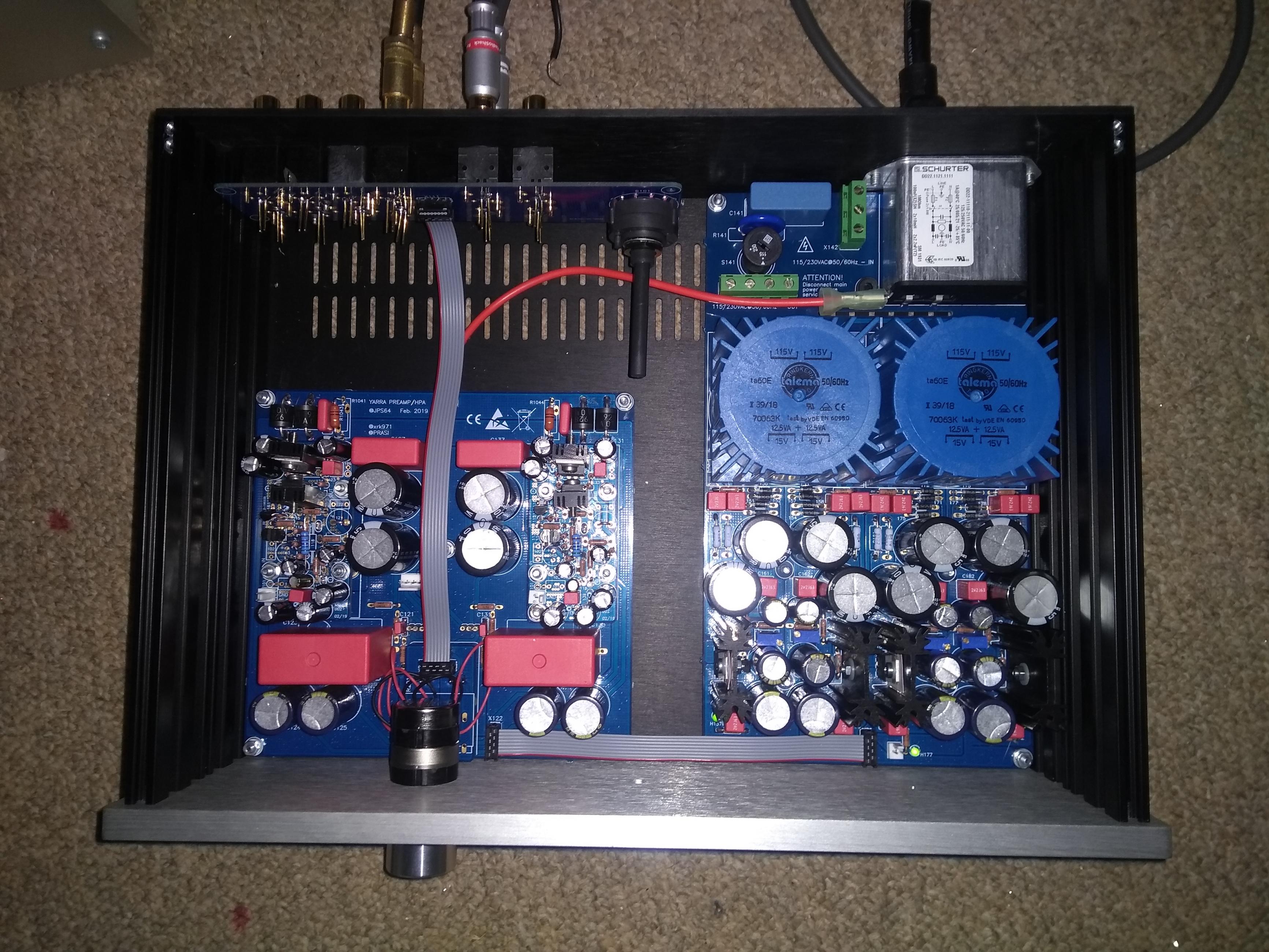

I finished mine enough to listen to it. I am still waiting on the source extension shaft and coupler to arrive, and I need to find knobs that fit.
First the numbers. Maybe someone can tell me if these seem ballpark correct. I am using 15 volt 25 VA transformers.
+- 22.8 V before the capMx
+- 19.8 V at the Melbourne board attachments.
339 mv at the Melbourne test points.
While I will wait a week before giving sound quality impressions, after a few hours I have nothing to complain about. It currently sounds rather pleasant and a little forgiving, but I am running it into the Pass M2 which is also rather pleasant and forgiving. It sounds more tube-like than solid state, in that there is no thin sound in any manner, but maybe a touch forward. The unit is absolutely quiet regarding hum and buzz, which is always a nice surprise when you first listen to your new build.
I am using a 50k TOCOS pot. I don't have anything of lower impedance on hand at the moment.
Thanks to those who have answered my questions during the build. Now I'm off to find an LED for the front panel.

Super work, Aljordan! 0.339V/8.2ohm=41mA. Appropriate bias current - could almost drive high impedance headphones.
