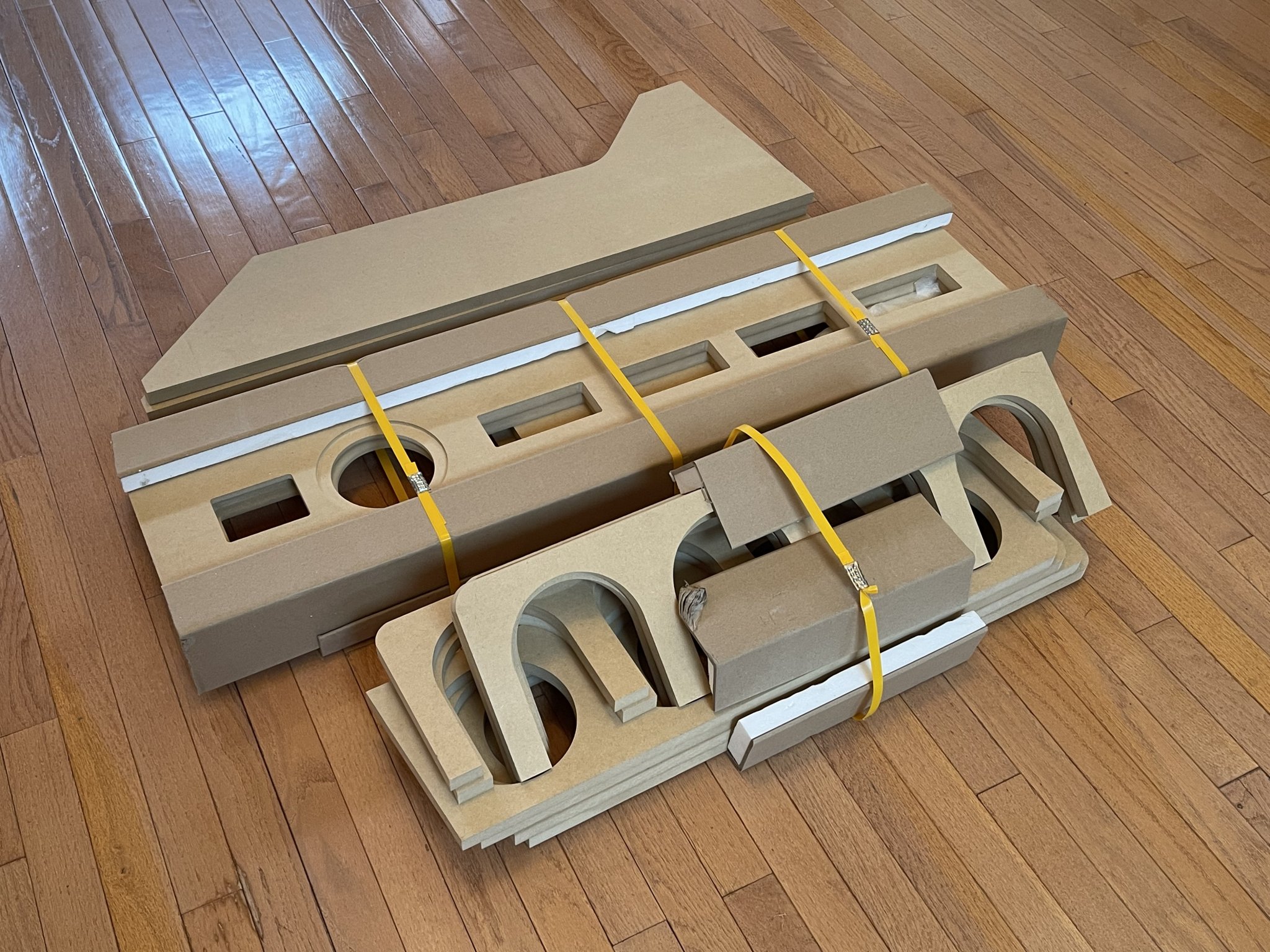

We think we can offer flat packs made of 3/4in birch plywood on the front and base plate, 1/2in birch plywood on the side wings, and MDF for the woofer array. They will be professionally CNC’d and so the fit should be perfect. You just need to do the gluing and screwing of fasteners yourself. Then finish them with your favorite paint/stain/varnish.
Depending on how many people sign up for this as a group buy, and I am thinking minimum 5 people at this point and price will be $750/pair and I am guessing shipping within CONUS from Texas is about $150 to $200.

Flatpack is here!
https://www.diyaudio.com/community/threads/xsd-speaker-flatpack-gb.397149/#post-7305850
