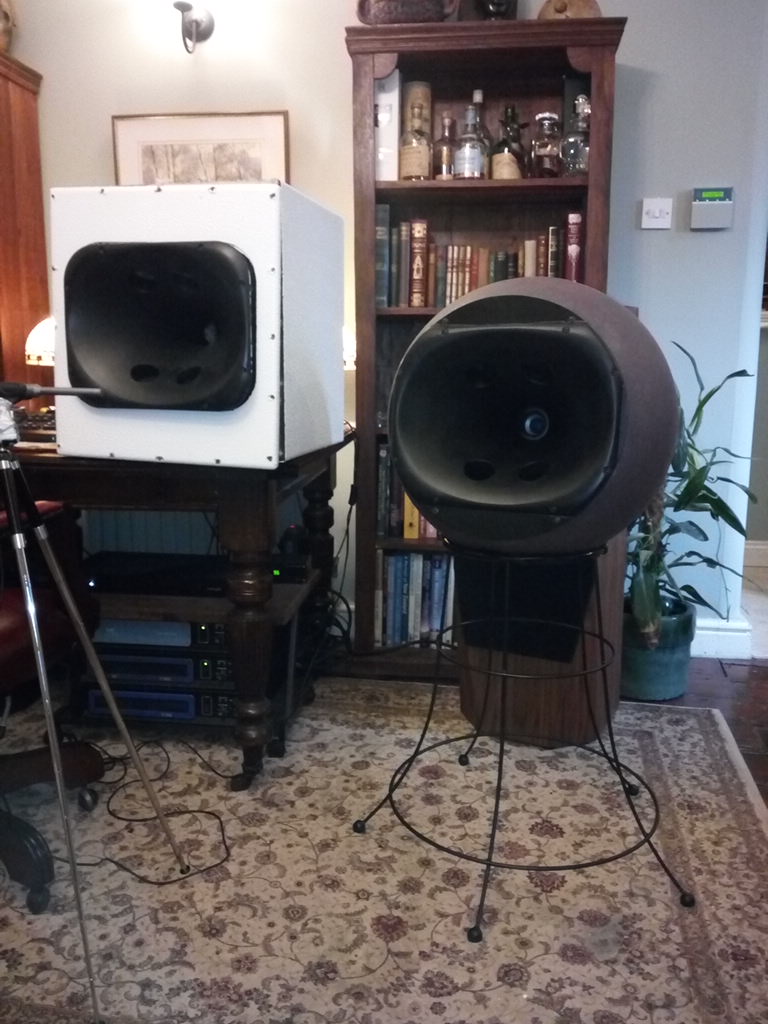

The XBush Mark 2. A synergy/Unity horn of spherical proportions
Thanks X.
There should be no mode, due to the horn which essentially cleaves the volume in half like a giant central wedge. Combined with the angled woofers the internal volume is actually not a sphere at all!

They will be heavily stuff with Rockwall as the cubes were. But given the sealed chamber of the full range driver almost touches the back of the sphere, the space is well and truly divided and not even into hemispheres given the volume of the woofers, mounting plates etc. The internal surfaces will also be lined with thick wool underlay. I have done a few other spherical builds which required some modifications, but I suspect these will be fine.

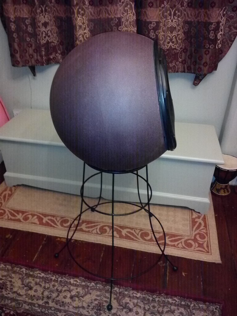

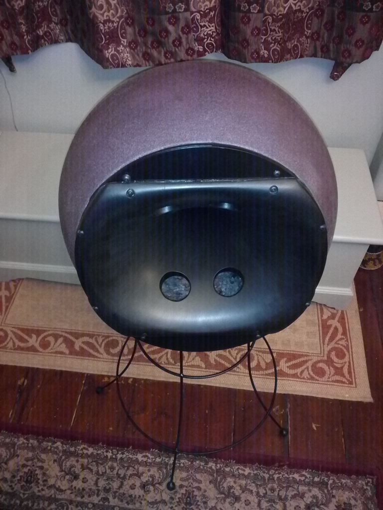

So having finished my CLD al/MDF/al baffle, it's time to look at the decoupling/damping strategy to minimise energy transmission to the sphere.
First butyl mastic tape to horn, with rubber washers and oversized holes to bolt horn to baffle.

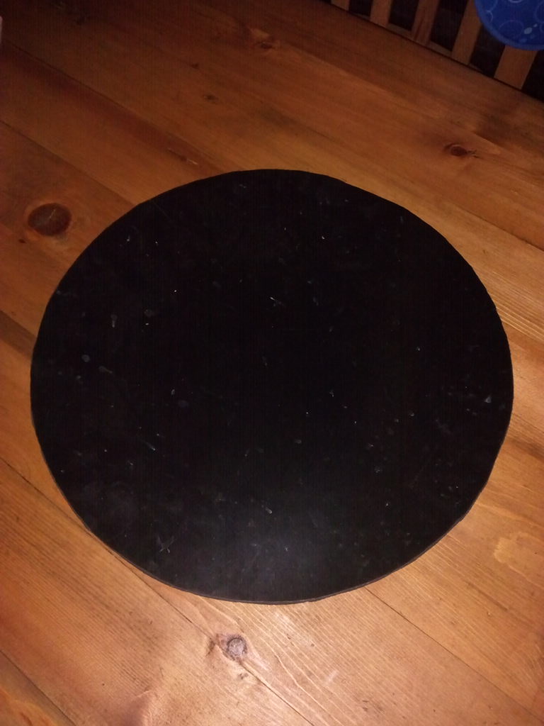

Then a giant sheet of sorbothane for the gasket between baffle and sphere....

Then a test fit with the layers- nothing done up and no drivers fitted but gives an idea of the retro look I am aiming for.
These will sit in a dedicated listening room I am building that will be a modern minimalist space.

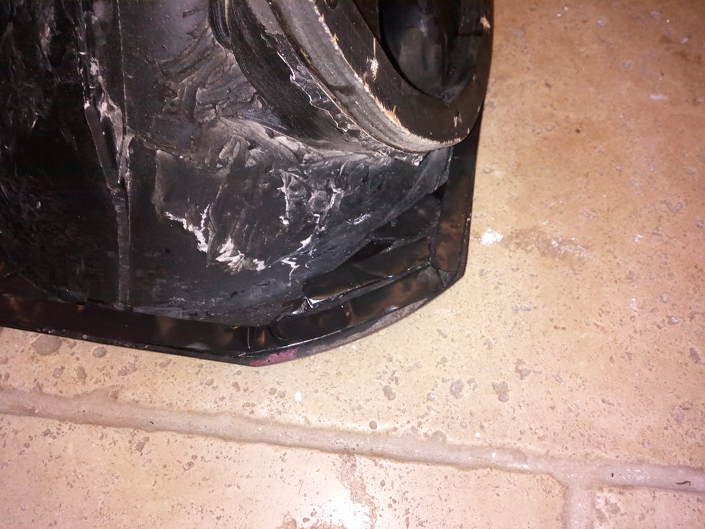

I made the synergy horn with over sized BB ply rings and about 4-5kg of two part structural body filler. Once the two 8 inch woofers and full range driver with it's enclosure is bolted onto the horn the whole thing weighs about 15kg and is incredibly inert.

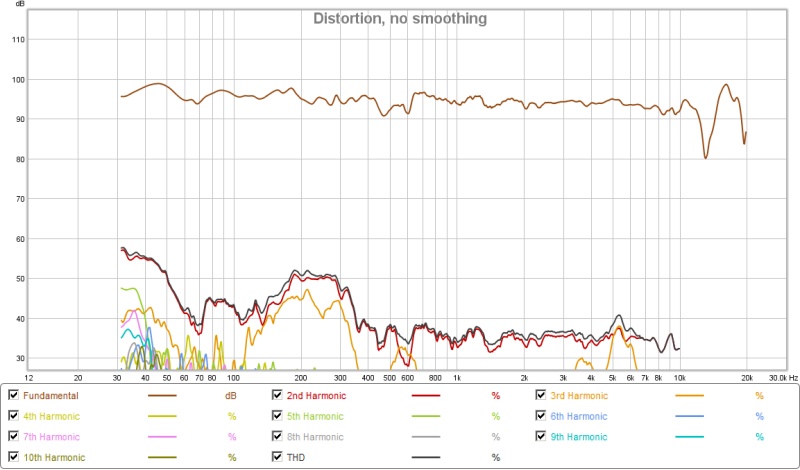

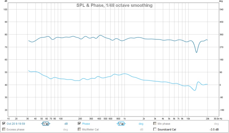

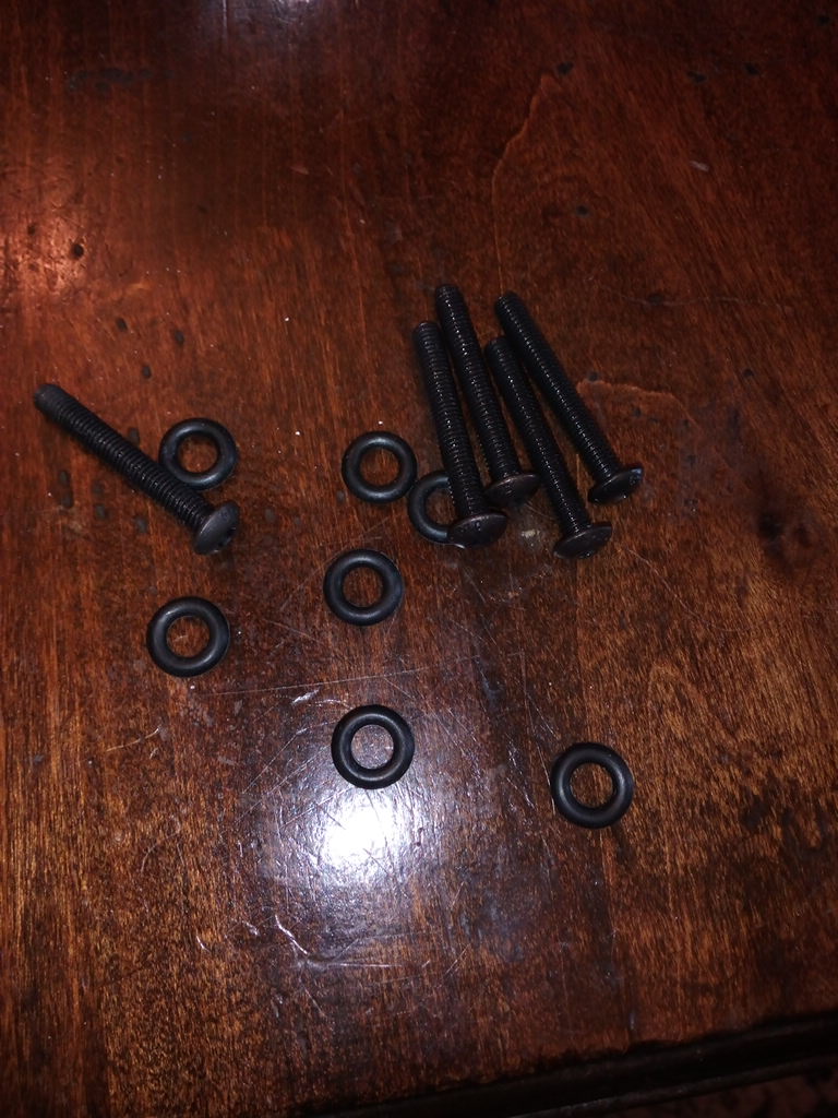

So, finally my button 6mm bolts arrived. So I bolted on the baffle and got measuring....
I am fairly pleased with the distortion - it is the lowest I have ever achieved from 500 up. I didn't think I would manage to beat the massive BB ply boxes with their magnet cradles and sorbothane supports, but it I am overjoyed with the new 'sphere synergy'!
575504d1476906500-xbush-mark-2-synergy-unity-horn-spherical-proportions-sphere-dist.jpg
The only thing is the rise in distortion from 200-300 - I have cranked this up higher and I think it is a loose screw holding down one woofer - so I am going to try to chase it down.
Will report back with some polars soon to see if the new enclosure has changed them much.

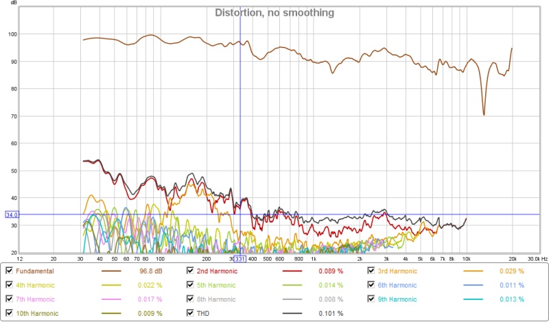

So - I had a very late night, last night - from reusing the synergy horns from XBush 1, all the woofer screws had been in and out of their plywood mounting rings more than a dozen times and had actually got quite loose.
So in comes gorilla glue into all the holes, 4 hours to dry. Then both woofers remounted.....and it has paid off:
575542d1476950534-xbush-mark-2-synergy-unity-horn-spherical-proportions-sphere-dist.jpg
The 200-300 increase in distortion has gone. Phew.

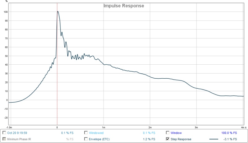

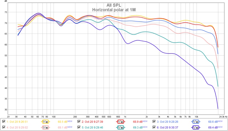

Here are some from this morning, now I have the distortion fixed.
575545d1476952513-xbush-mark-2-synergy-unity-horn-spherical-proportions-horizontal-polar-1m.jpg
