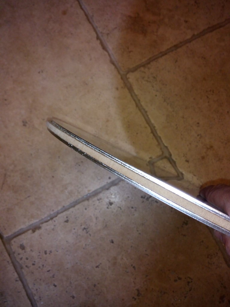

So I am going to make a 3mm aluminium/6mm MDF/3mm aluminium CLD baffle ring - looking at the various charts - they agree with bswalo and Geddes that same thickness constraining layers (3mm aluminium) with double thickness 6mm MDF in the middle appears to produce excellent damping and low transmission factors. This will give a combined thickness of 12mm and should be very stiff and well damped.
Then this will be isolated with a 3mm sorbothane gasket - looking at the literature on sorbothane - they advise against glueing it on both sides- i.e. they don't advise using it as CLD - more as a damping decoupling layer.
So I am hoping a well damped, stiff, 12mm al/MDF/al baffle, floating on 3mm sorbothane will have the best of both worlds.

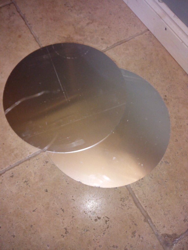

Right aluminium discs and MDF cut to size. Laminated up after lots of cuts and sanding.....

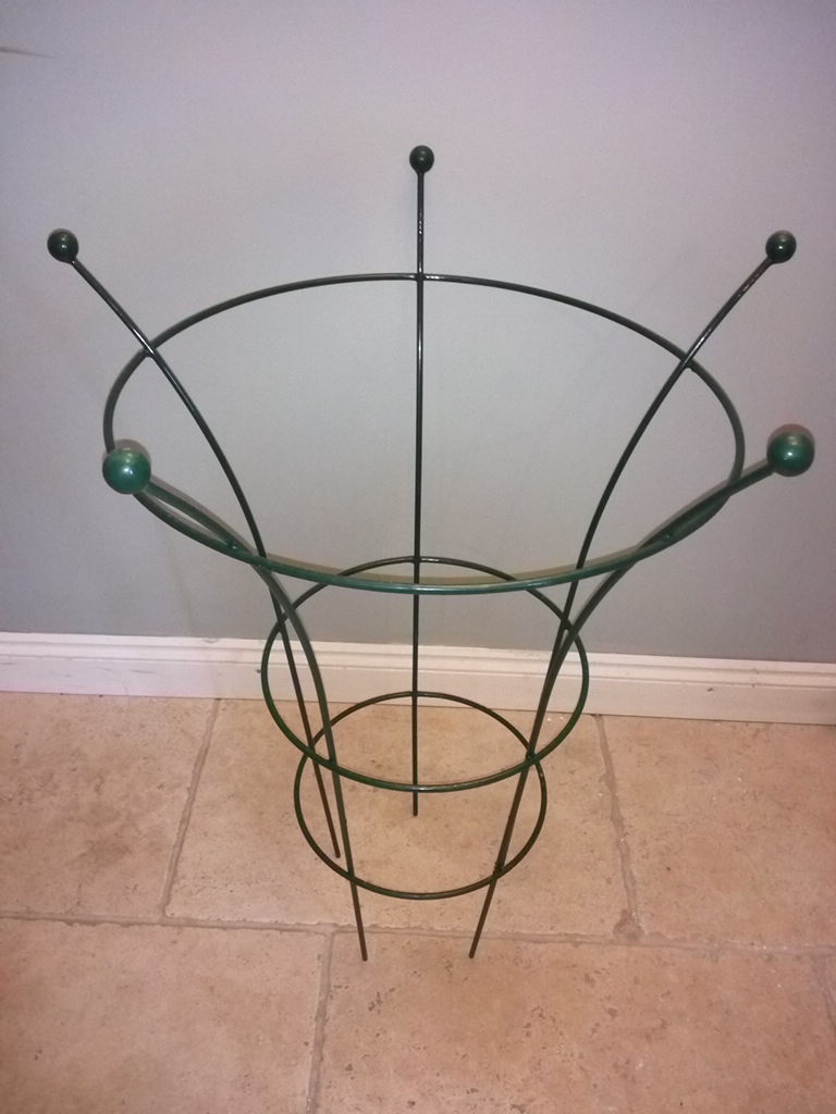

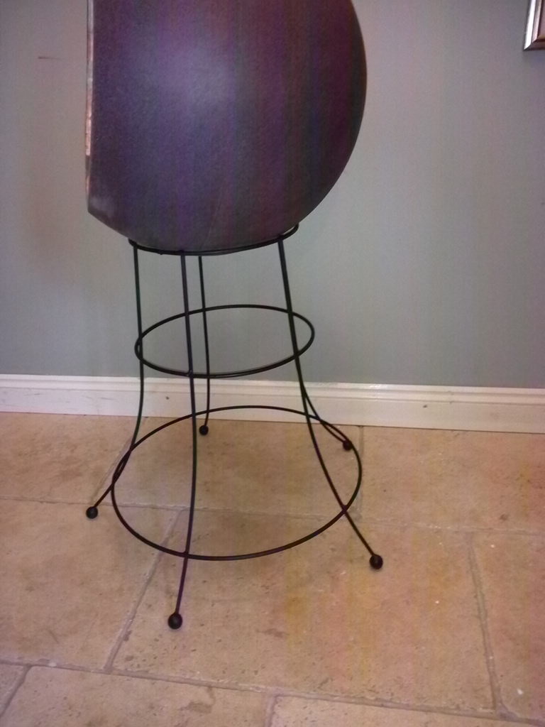

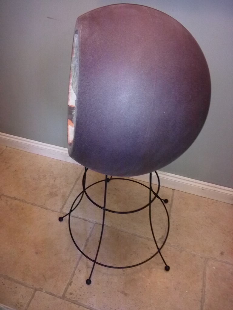

So what happens if you take one heavy gauge peony plant support, turn it upsidedown, angle grind off the legs, and spray it black......? 😁
Nice work with the plant support. How does your wife feel about you taking her plant support frame? Is it rigid enough to support the weight of the speaker fully loaded with woofers?
She was initially very pleased I had thought of her......😱
They are made from 8mm steel rod, and because of the three circles and five supporting legs are actually very strong - I can happily sit on them!
They will need isolating from the globe though - so some sorbothane rings are being cut.

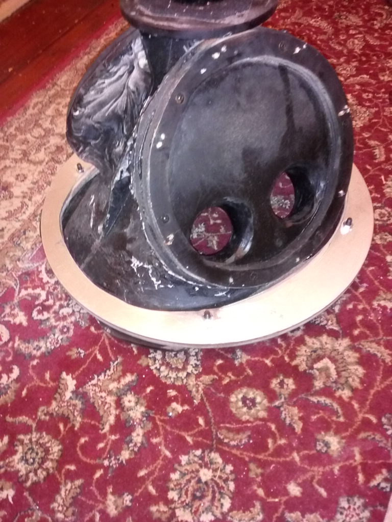

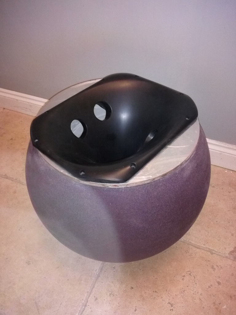

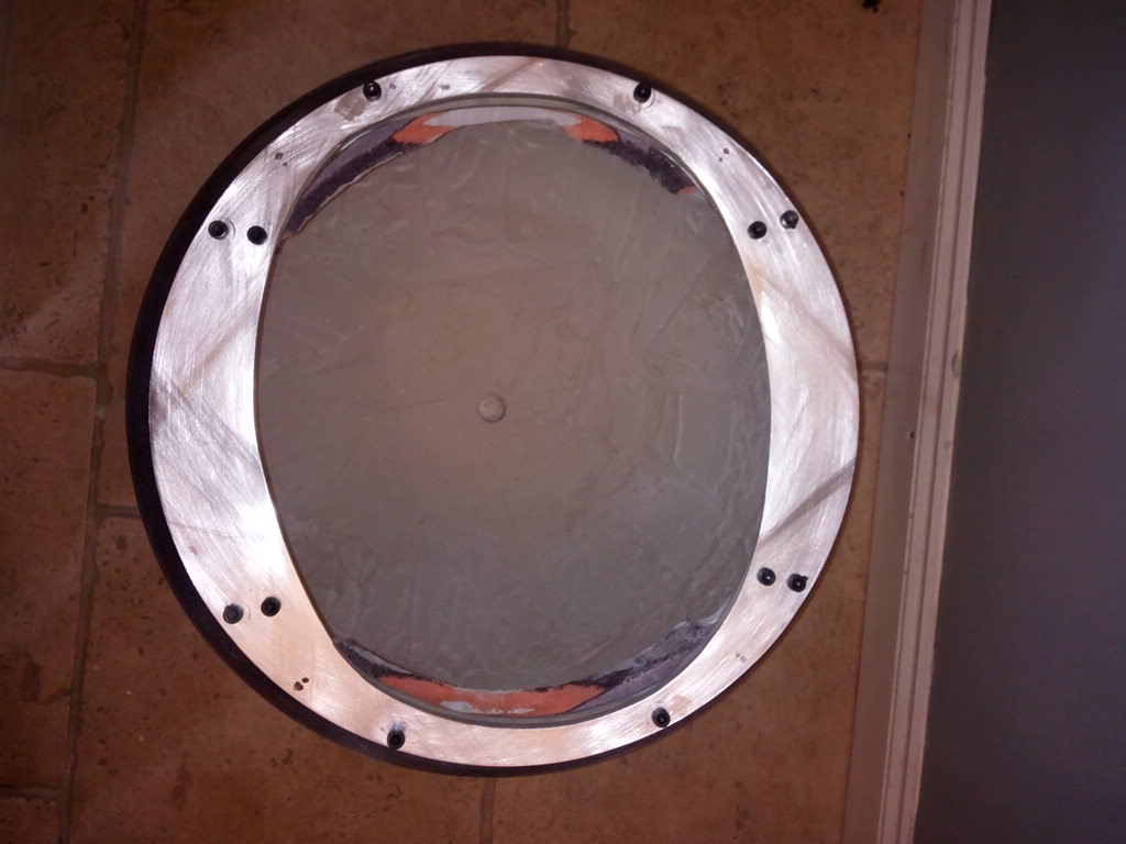

Are you making brand new wave-guides or are these the old ones? I don't see the drivers attached or the glued on bondo woofer adapter plate.
These are the old ones stripped down. Once I have mounted them on the alumium baffles I will be sanding back the overhang on the corners and making a nice smooth transition.
I think I will paint the baffles matt black - a shame to loose the aluminum, but I think it will help the horn blend into the circular baffle.

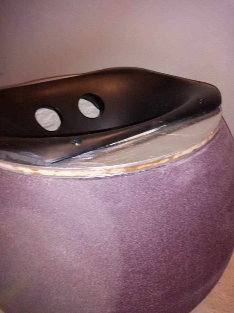

Bolting waveguide onto aluminium baffle. 6mm bolts. Will have a mastic rope gasket between waveguide and baffle. Then sorbothane gasket between baffle and sphere....

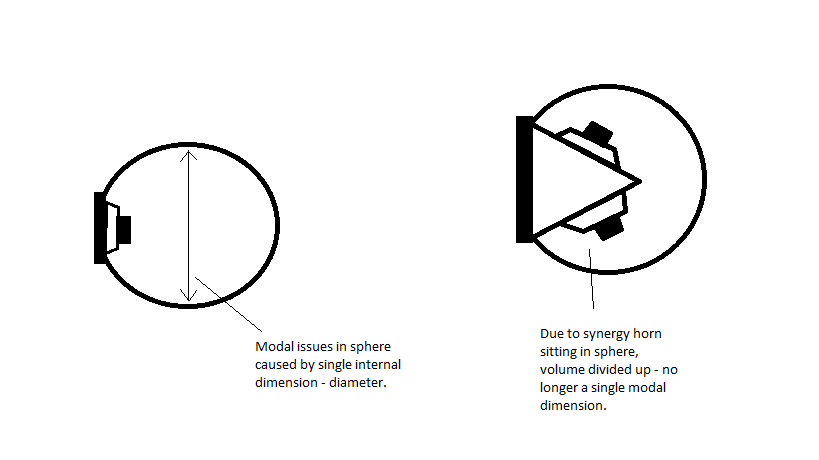

Nice work! There may be spherical resonance mode that will cause a small peak. But if you have enough damping and things to break up that mode it should be ok. I noticed a small peak on a small hypercube enclosure which resembled a sphere. If you can have a brace inside to break that spherical symmetry it will help.
Thanks X.
There should be no mode, due to the horn which essentially cleaves the volume in half like a giant central wedge. Combined with the angled woofers the internal volume is actually not a sphere at all!
If I had mounted the driver flat on the front baffle as is usual, there would have been modal issues!
