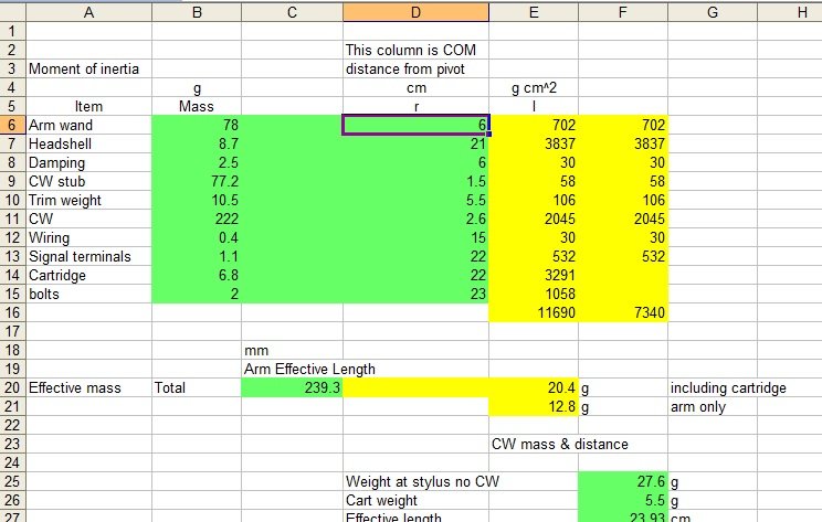

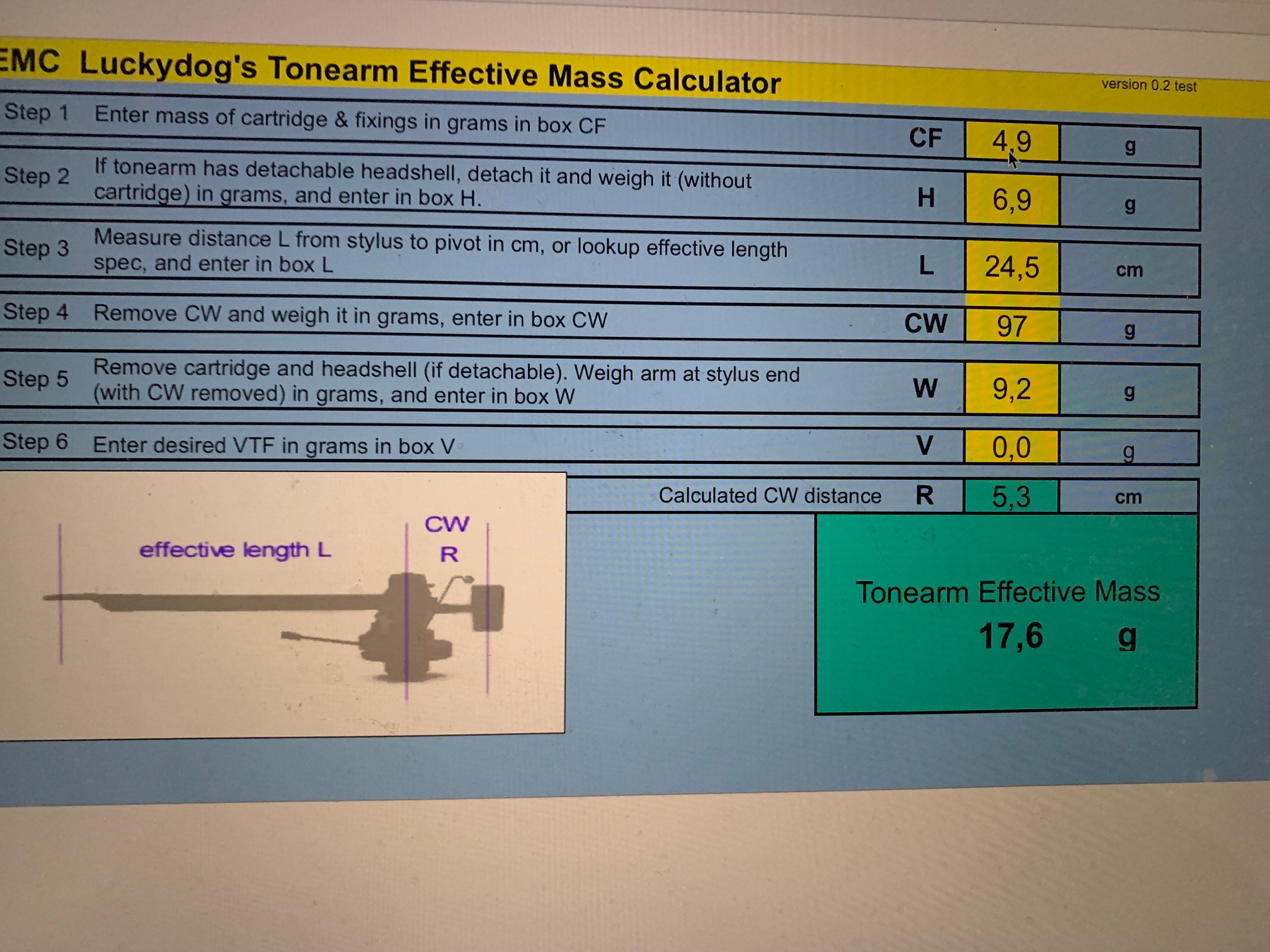

Your calculation needs to add COM distance from the pivot for every component individually. In the attached SS you see column D is the COM distance from the pivot.
Reactions: dennis h
Thanks, W. Maybe the spreadsheet i used calculates them on its own (it asks for the distance of the CW, and the length of the wand)
The results were not so different from my hand-made ones.
G -- my doubt is this (+ or - !). Huygens calculates the moment of inertia for any direction (inertial masses), while gravity acts just vertically. So how does it's component on the other directions enter into the calculation?

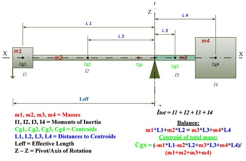

Hi Carlo,
Impressive all your TA research and execution you have done all these years including this last one. To calculate the effective mass I used the attached chart calculation, looks like yours, but not the distance CW R that seems too short ( 1 Cm ). By the way not sure this chart is 100% correct.
c
Ps - may you link that spreadsheet? seems better done than mine

The spreadsheet can not calculate COM from the pivot as this will vary with different arms and SS does not know which arm you are inputting the data. Although on closer inspection it asks to measure mass at the arm end with CW removed. But then this will measure the mass at something less than the effective length distance, and the formula squares the distance so this will introduce errors.

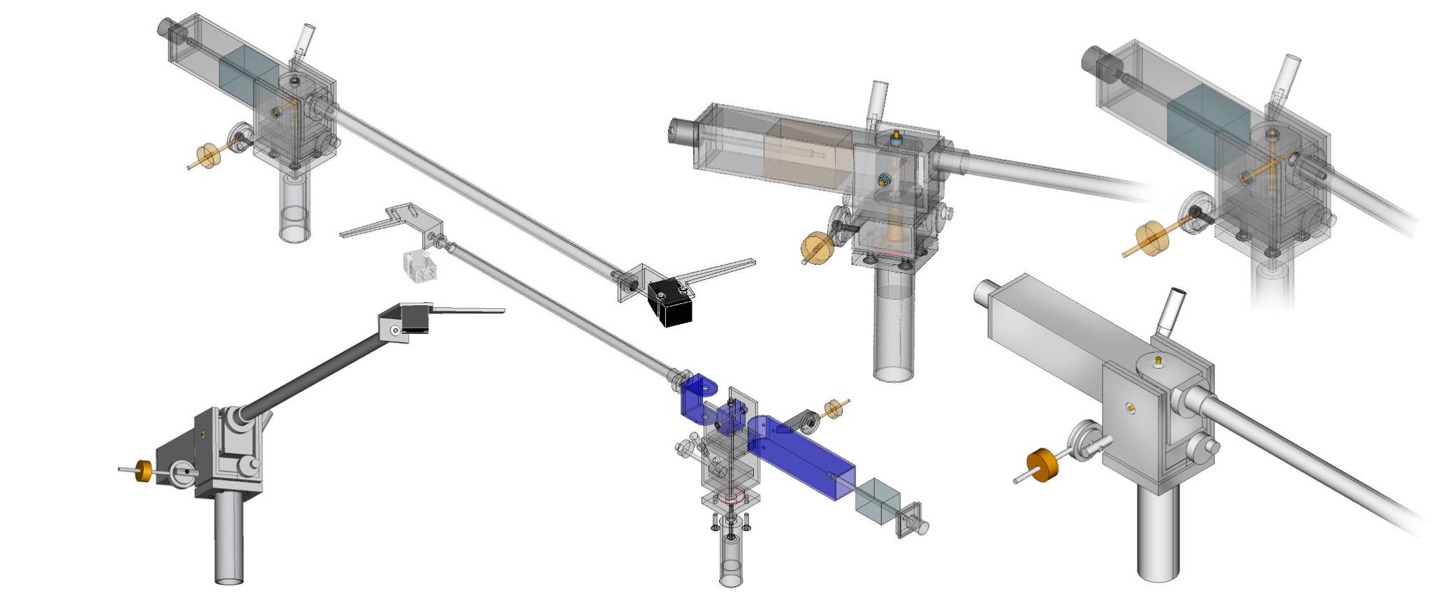

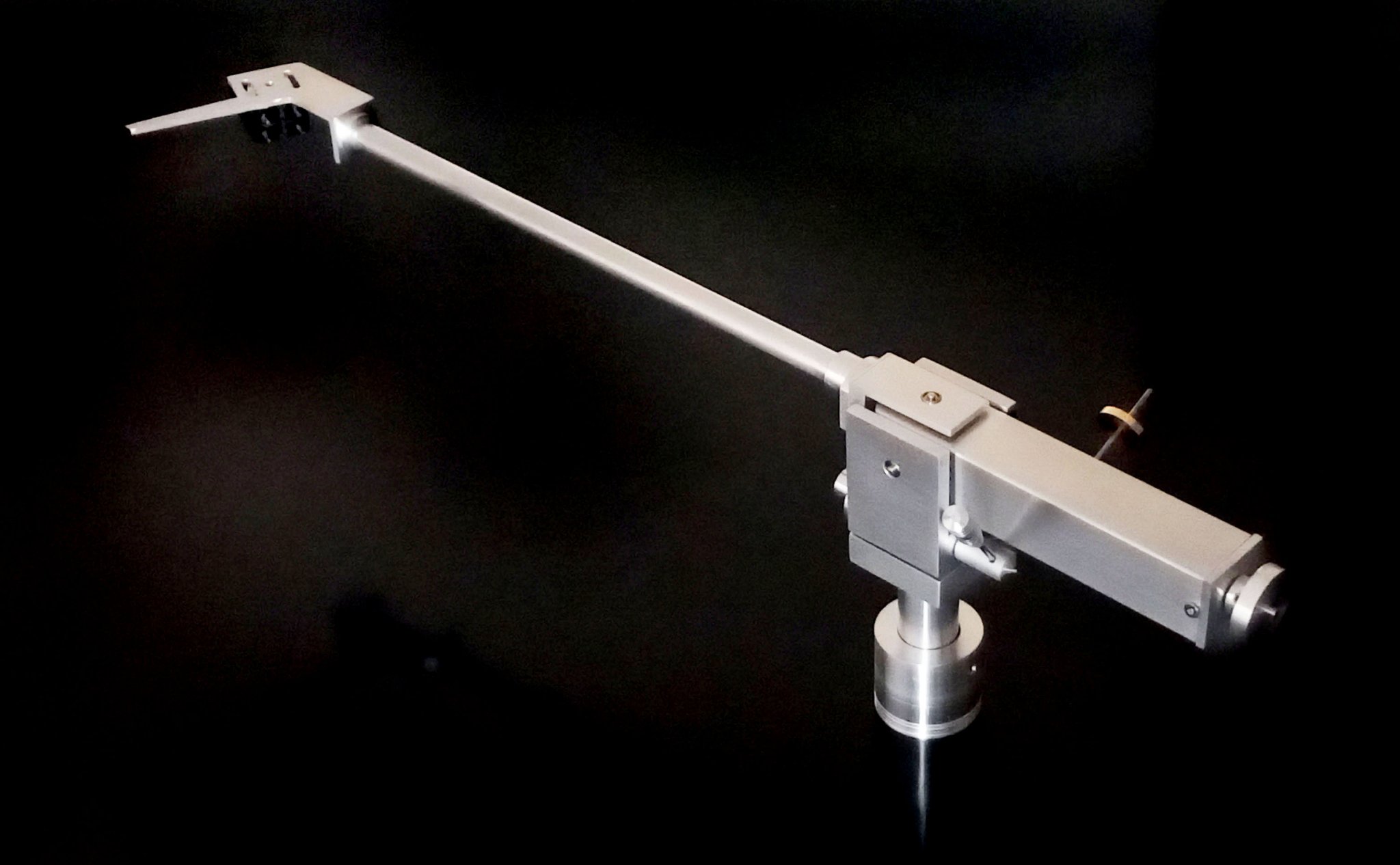

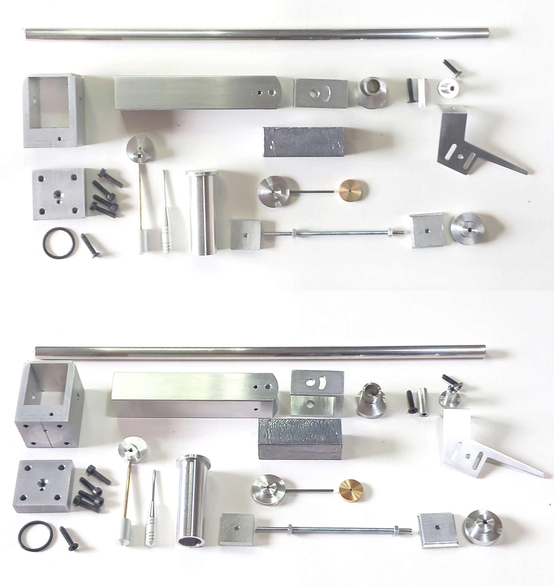

Here some details of the construction of the WTA1, a tonearm with an usual BBs gimbal articulations, but with "wrongly" inverted axis.
The construction, starting from adequate profiles (my scrap-bin became very rich...) does not present particular difficulties.
The arm works comfortably (fine adjustment of the VTF, lifter, antiskating), maybe a common user could use it as any commercial TA ; some audiophile would instead remain perplexed, seing his new arm folding in two.
My corcerns about V vs H EM compliance were almost overcome due to a careful dimensioning (weigths / distances). And the measured VTF var. < 0.2 gr throughout the entire tracking of the disc is imperceptible, at least for my ears; there are many "right" TAs - with pivot and cw aligned to wand, instead than to the stylus tip - that have a bigger one on single warps.
The video shows my usual "crash test" on a 3mm warp and + - 1.5mm eccentric - note that on the rear only the A.S. is moving a bit

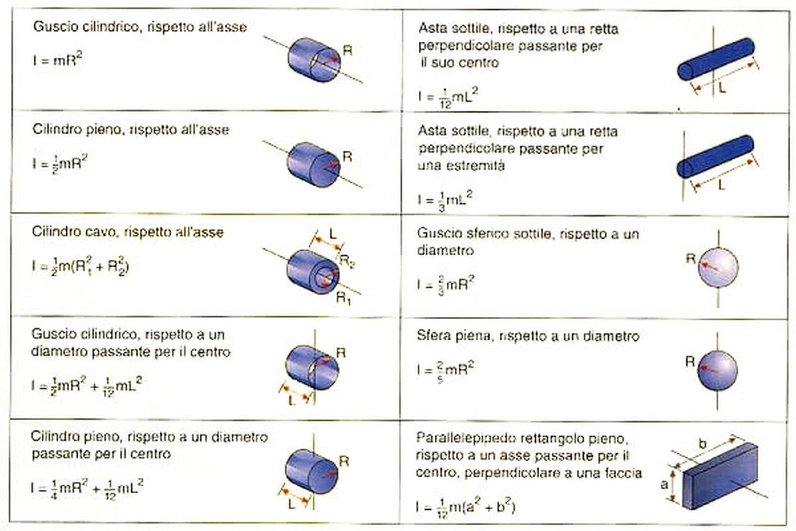

Spreadsheets, but also the formulas once found on magazines are only approximations: (for example they do not take into account the different shapes of the masses, (from I =1/2 m*R2 to 1/12 !) useful just for setting up the design. Here to understand that it was mandatory to start from a heavy CW almost stuck to the pivots. In this case a 13x13 bar lead casted, then cut to size after a few tests and mechanical measurements. (the 3d draw shows how it goes so near).

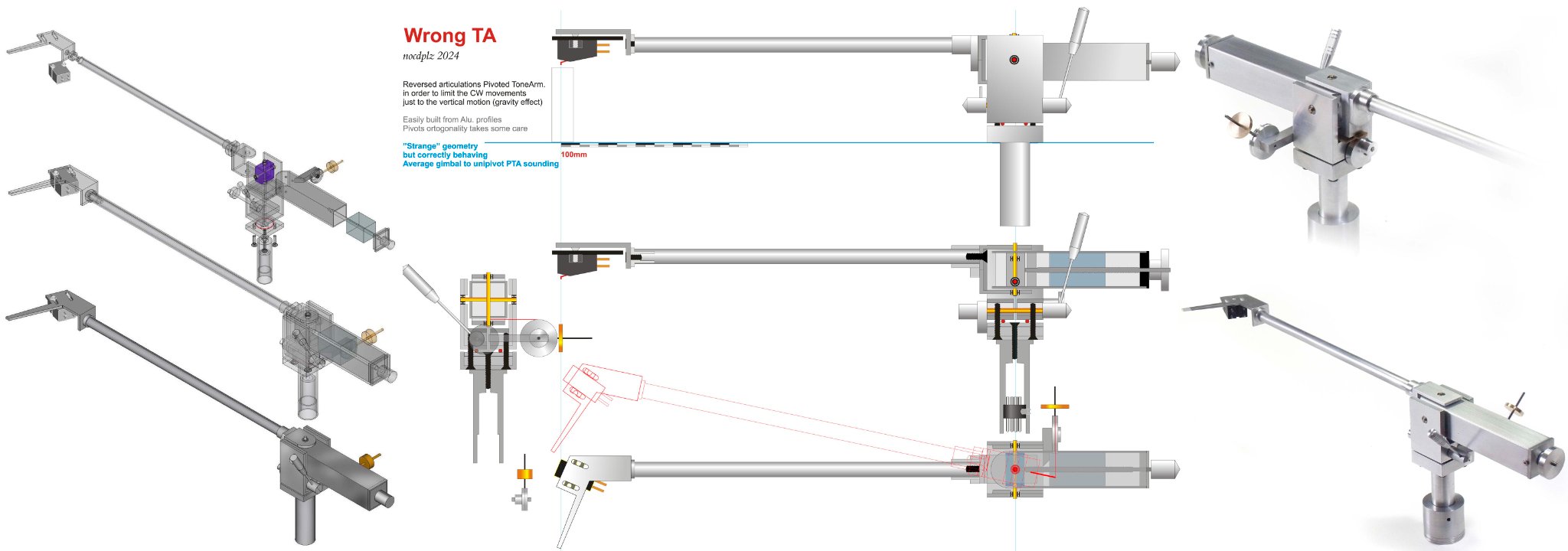

I tend to agree with warrjon that horizontal resonance wants to be about 2 Hz while vertical resonance about 7Hz. Thus Effective Mass needs to be higher horizontally than vertically.
nocdplz, your designs seem to have EM much lower horizontally than vertically.
Seems - because of what? may you explain, pls?
Having designed it, probably I cannot see the problem, and the calculations made* for the project certainly do not help me, since they, quite surprisingly for me too, say the opposite.

Because it adds to the effective mass. #36
Here instead is like having two separate entities - the vertical one represented by the entire TA - and the horizontal constituted just by the front part, up to the pivot.
Exactly this is the cause it has different effective masses in the horizontal plane - lower - and the vertical plane - higher.
In the vertical plane more mass is accelerated, obviously.

These well known graphs, and also a look at Wiki (moment of inertia etc) will not hurt anyone
